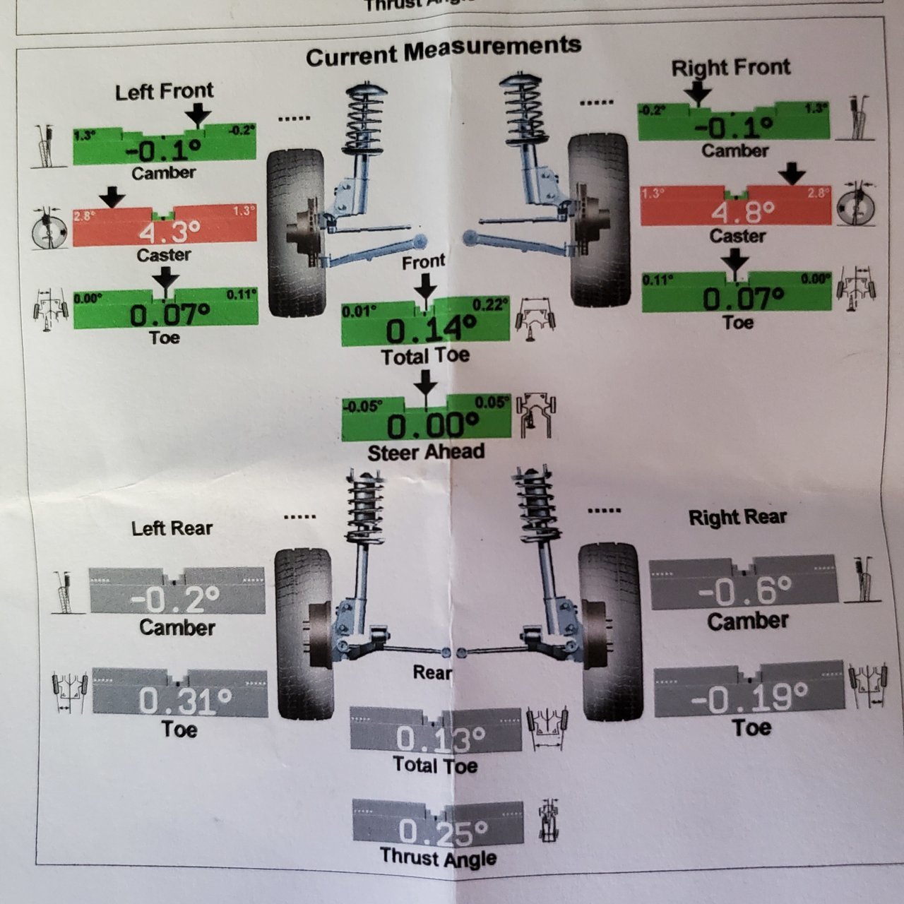

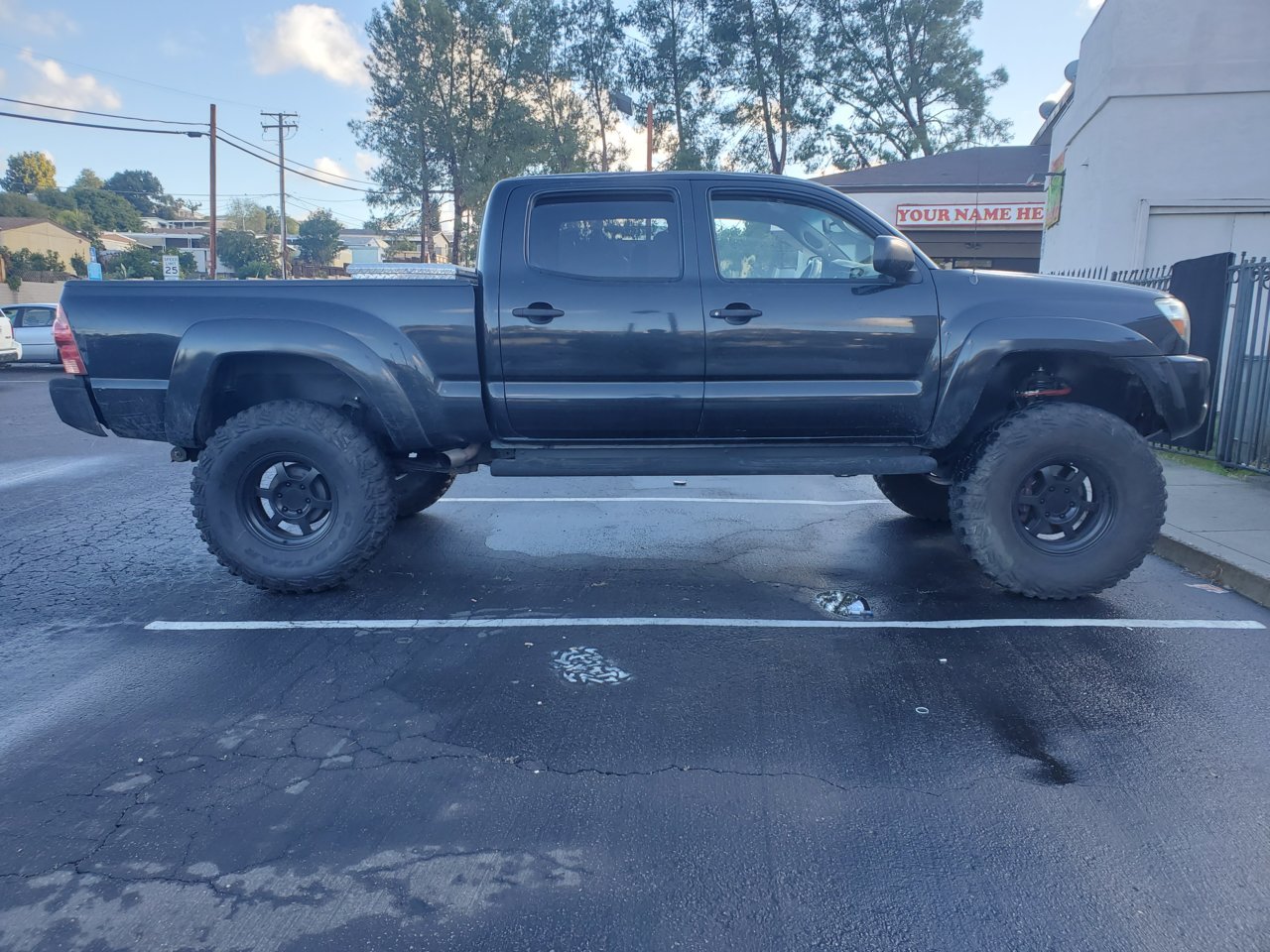

    Yesterday... got the truck aligned.
    I'm pretty happy with its stance now - bro.

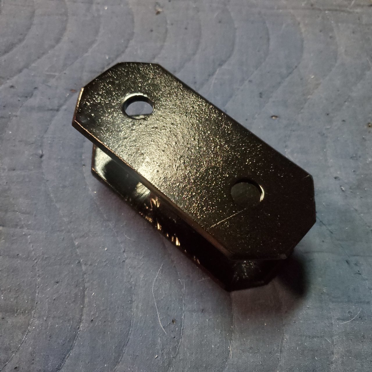

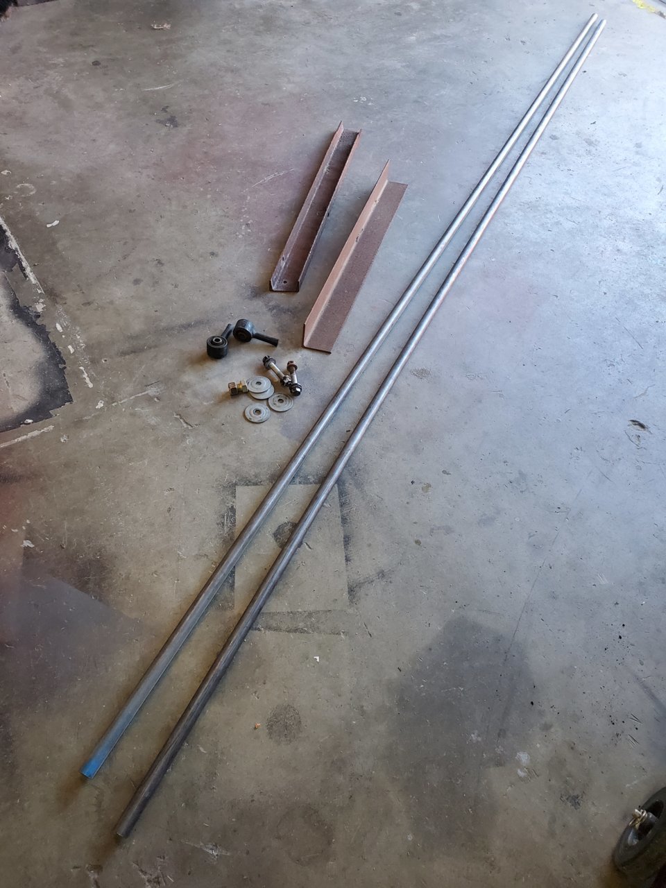

    Started making a traction bar. The rusty metal adds character. Lmao
    I got a little ways to go still lol

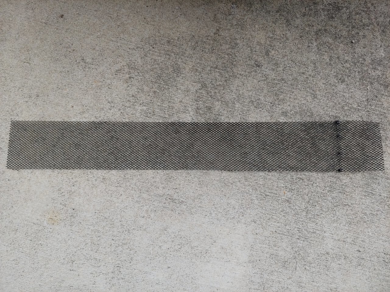

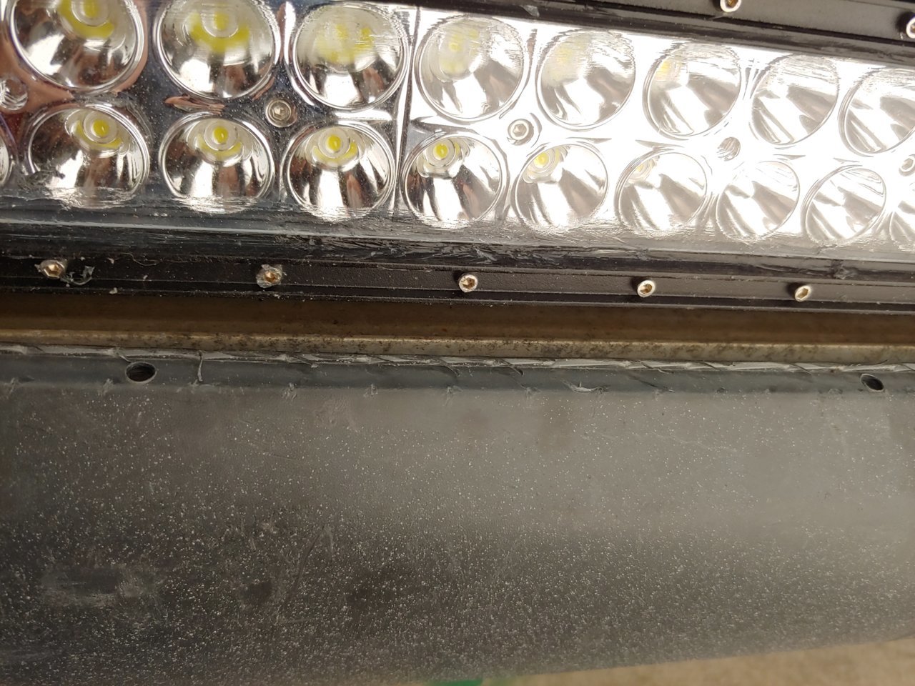

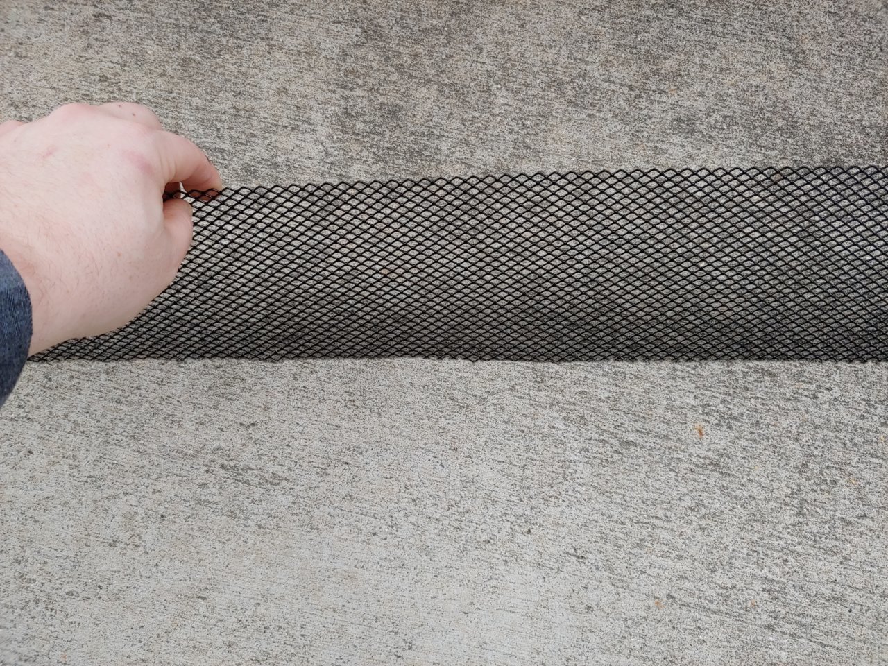

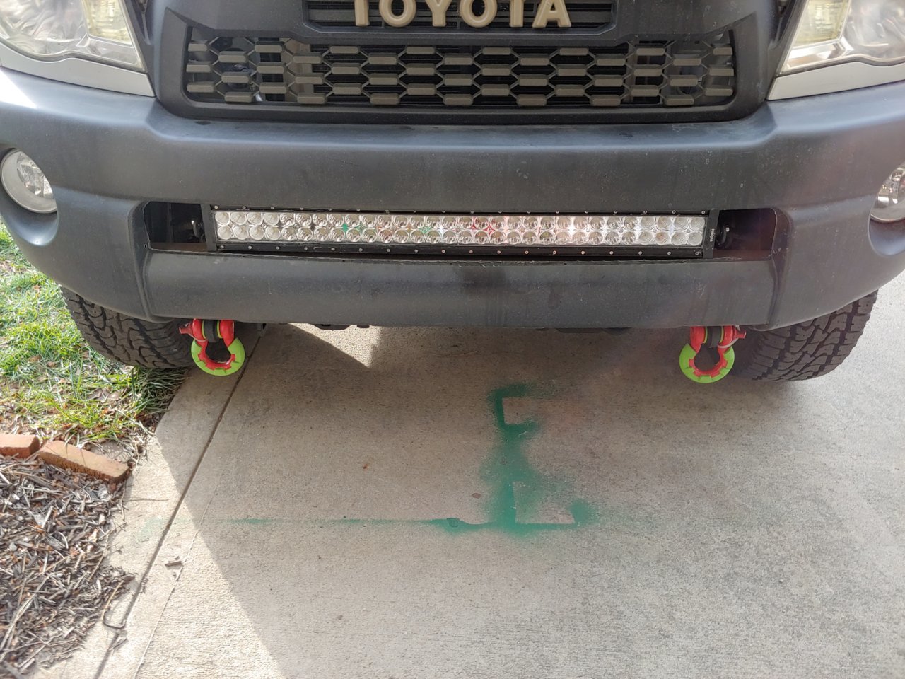

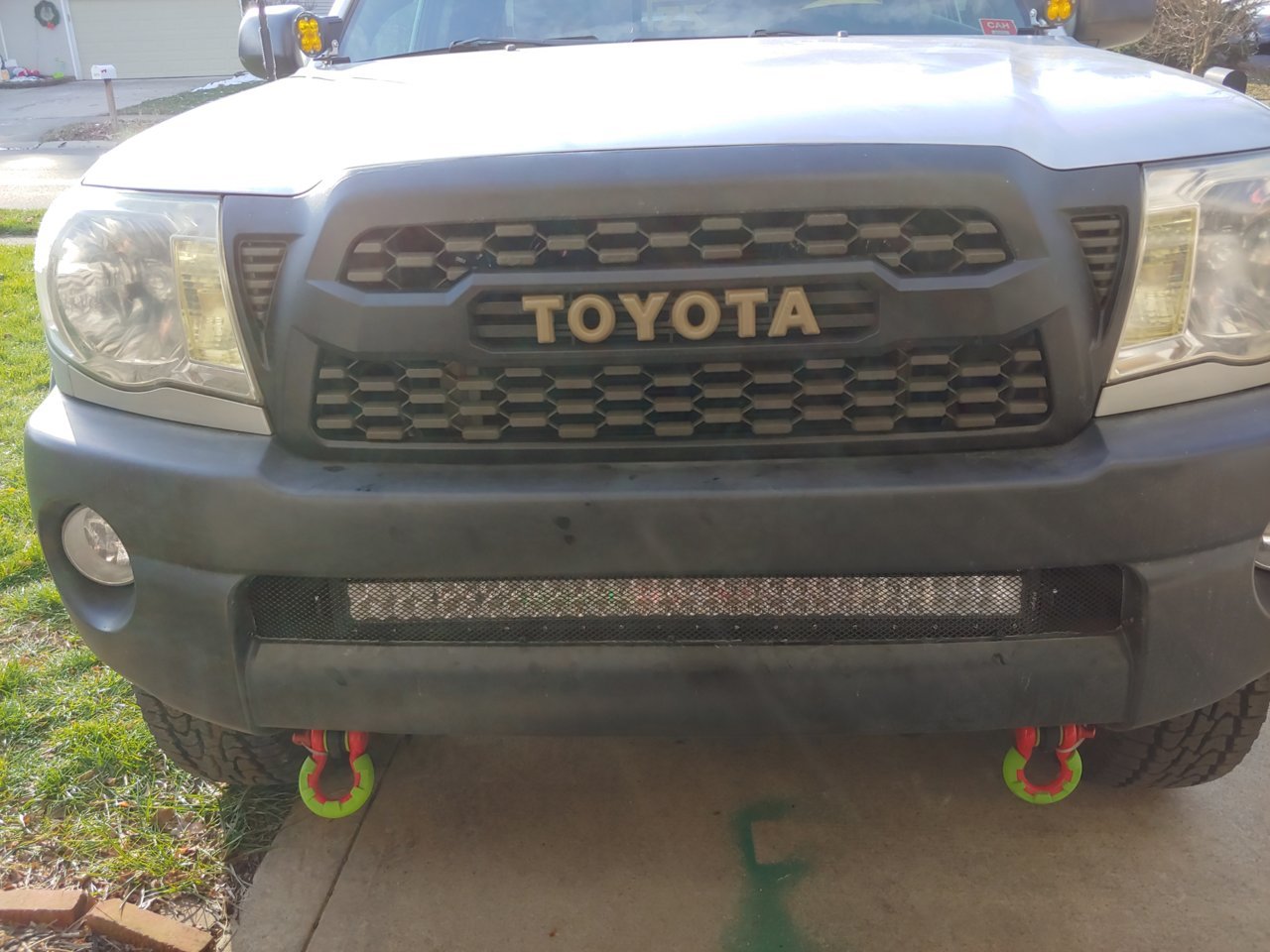

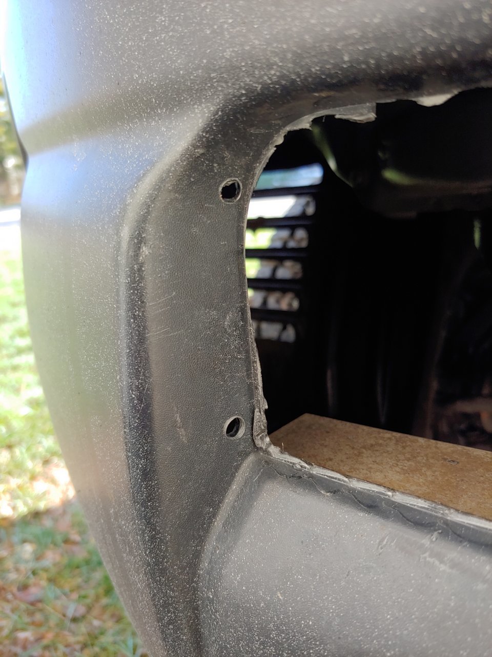

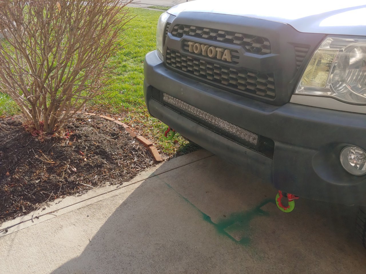

    So black friday, I ordered the wrong light bar mounts, I meant to order the stealth, I got the flush. Wasn't worth returning them, to me, so I installed them. Not quite the look I wanted. So I went to home depot and picked up some black gutter guard, two pieces for 7 bucks. The opening was 39", the guard sections were 36". Put two together to make a grille.
    Drilled some holes in the plastic bumper cover.
    Before:
    Half hour later and some zip ties:
    Doesn't mess with light output and, I think, looks way better than the open cavity. Closer to what I wanted originally at least.

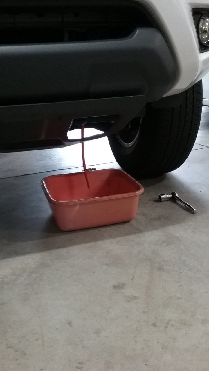

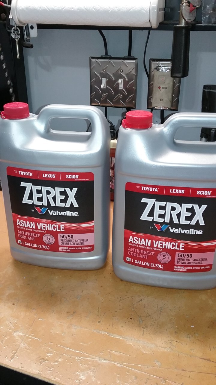

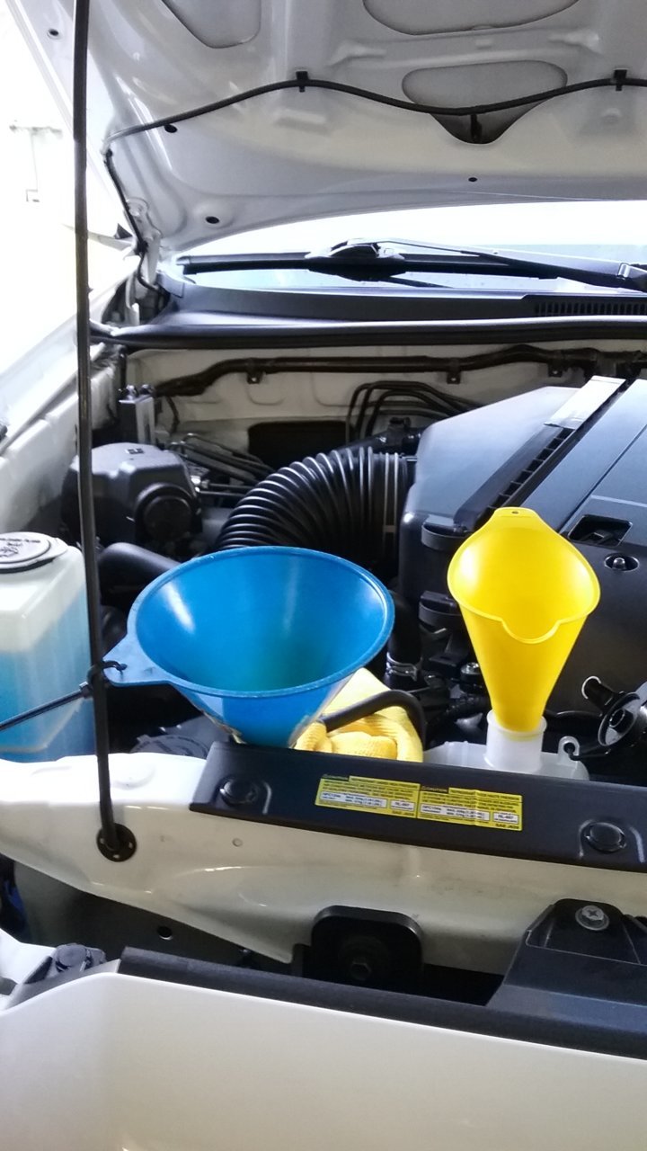

    Coolant refresh. :thumbsup:
    Tip: A 22mm socket fits over the drain peck. Just be careful tightening it.

    I ordered the stealth and got flush mounts. I just cut them down and drilled new slots and made it work. Just haveen't gotten around to installing it all yet

    Yea, that was the alternative, I didn't want to go through that trouble, because I would have had to re-seal the ends I cut, etc. Path of least resistance for me. I'm actually pretty happy with how it turned out, all things considered.
