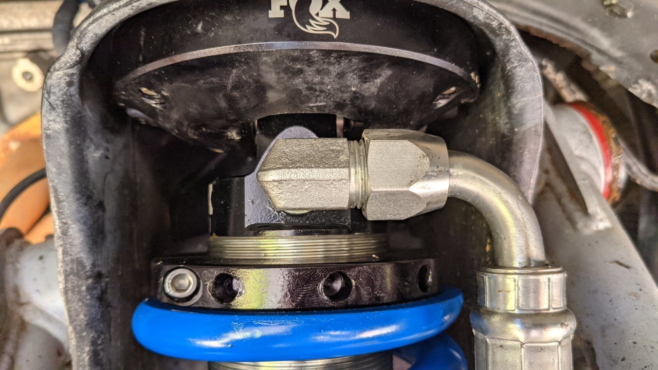

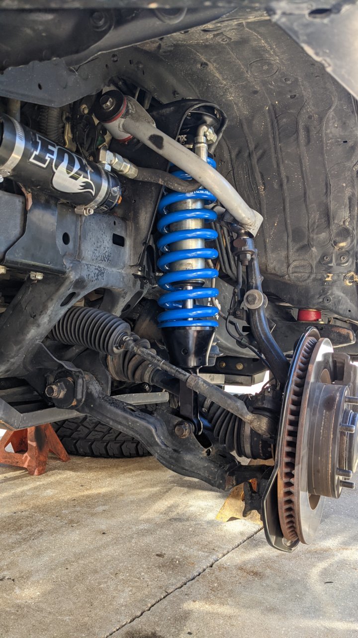

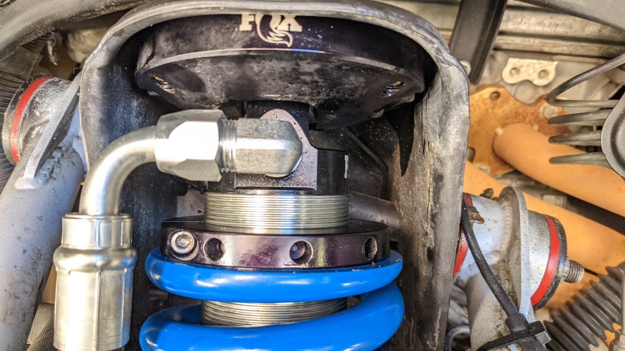

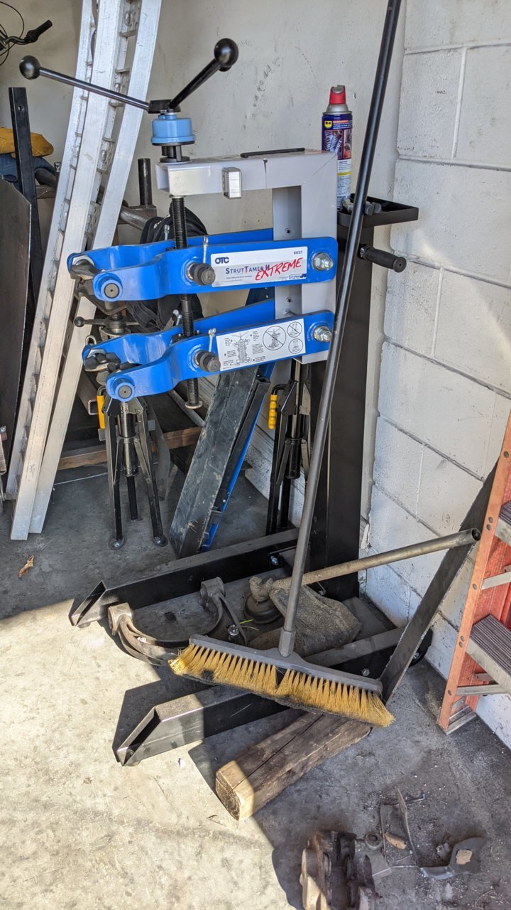

    Thanks to @Timbo's Customs I got my 14" 700lb springs on.
    After hours of research trying to find a good starting point for adjustment on pre-load and the best answer I got being "every truck is different" and or "use search and read" I decided to go with the only solid answer I had found from a thread several years old on a FJ cruiser forum:
    700lb 14" King spring pre load adjustment starting point for heavy front end being 3-4 passenger and 5-6 driver.
    I set the thread count then adjusted the lock rings so they could be loosened and adjusted while installed if ever need be and this was the result:
    3 threads passengers:
    6 threads Drivers:
    I also coated the shock body with T-9 Boe Lube spray and the spring ends and lands with Kluber anti spalling microlube for metal on metal sliding to make installed fine tuning easier.
    So far I don't think I'll need it.
    Drivers side is 3/16-1/4 higher than passengers so it should settle evenly in a week or so.

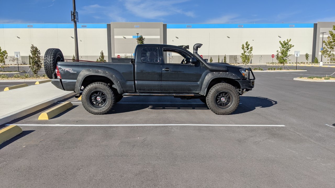

    Ride is fantastic and height is about perfect.
    PXL_20210106_201128810.jpg PXL_20210106_192733320.jpg PXL_20210106_191734682.jpg
    Thanks again Tim for access to your Extreme compressor! Gotta have the right tool for the job on these things!

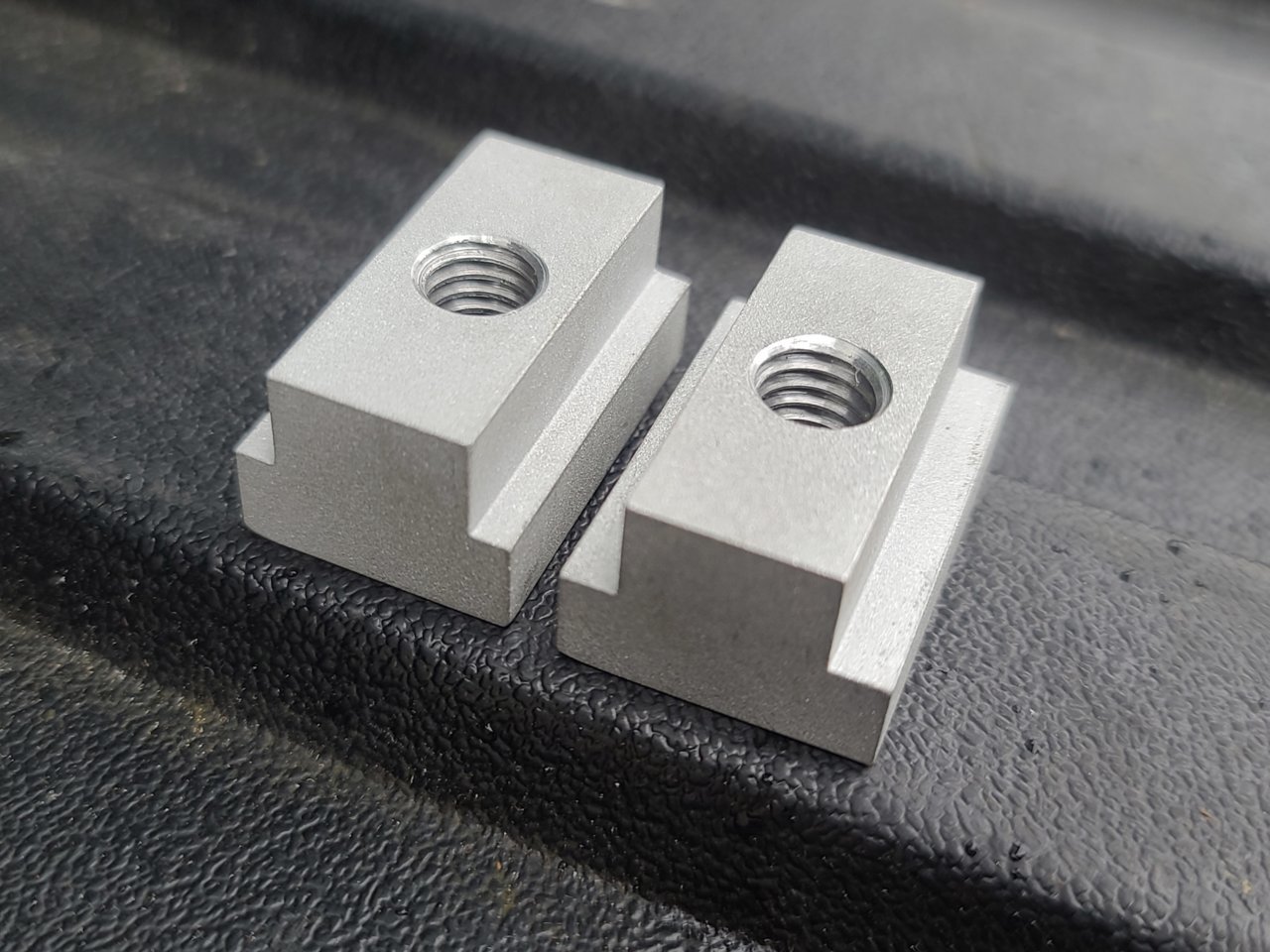

    I machined up a couple of T Slot nuts for the bed rails so I can attach Quickfists for my shovel.

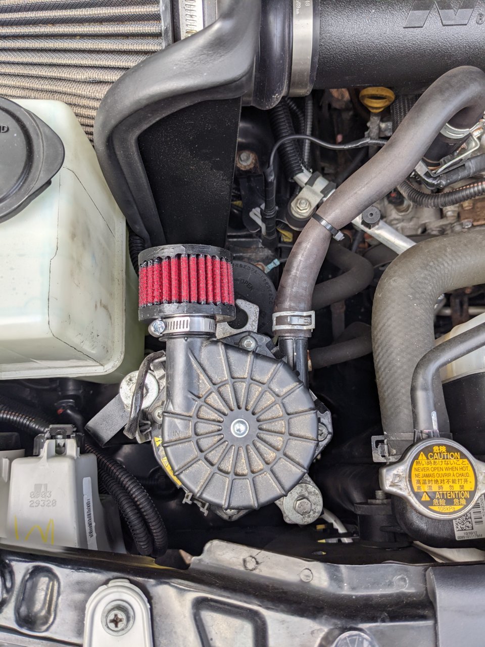

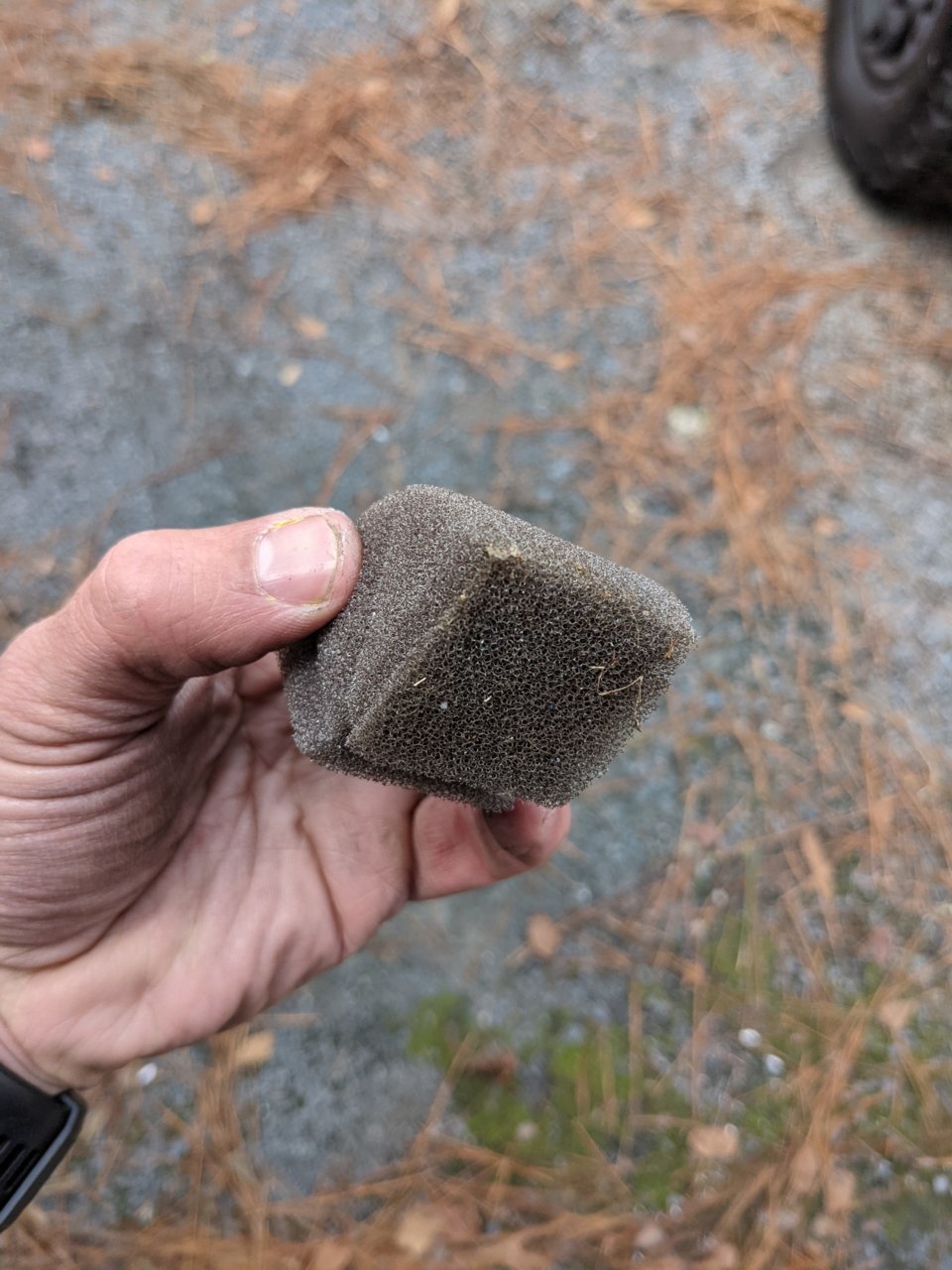

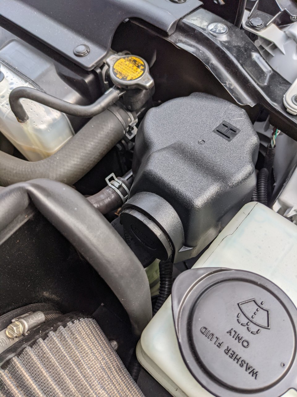

    I knocked out both the Unifilter mod and the Fog Light anytime mod today. The SAIS is relocated to the front of the engine bay because of the CAI. As far as the fog light mod, I tapped into the Batt Charge relay, and everything seems to functioning as it's supposed to. The yellow fogs will look sick when I get them.

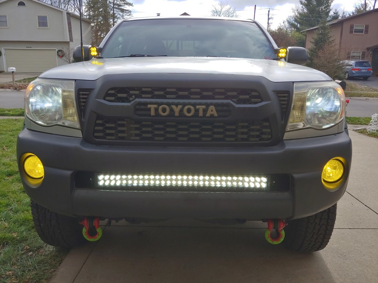

    What light bar do you have behind your lower grill? How are you liking it? Easy to mount? I've been toying with the idea of installing one down there.

    I bet a lot of people would be interested in buying those.

    The one from CaliRaised. It came with the wiring harness and mounting brackets. It's pretty easy to install, but you have to remove the grill tondo so. I really like it and it's very bright.
