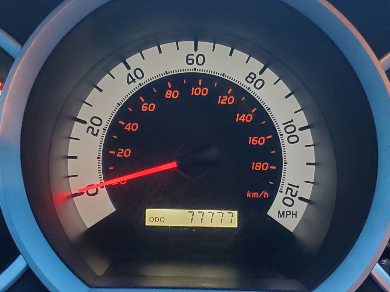

    should I buy a lotto ticket or be extra careful today?

    Do it, that mileage on a day they pull for 970,000,000 is a sign. Lemme get some kings after you win for the advice :thumbsup:

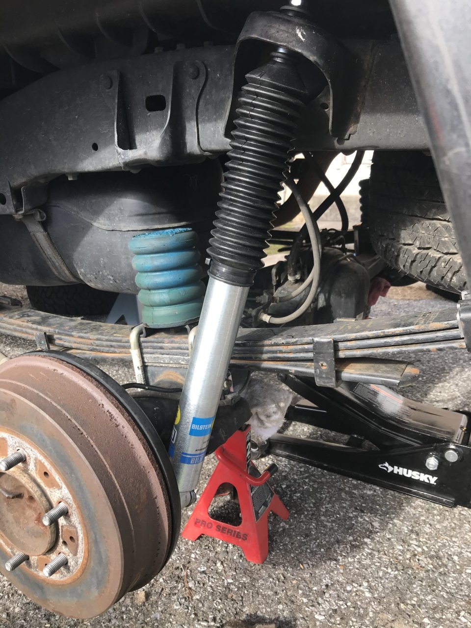

    I installed 5100’s on my rear axle. I previously installed a complete 3rd Gen OR Takeoff suspension, which has been great, but I didn’t care for the rear shocks as the back end floated too much after crappy road surfaces. The 5100s are a big improvement.
