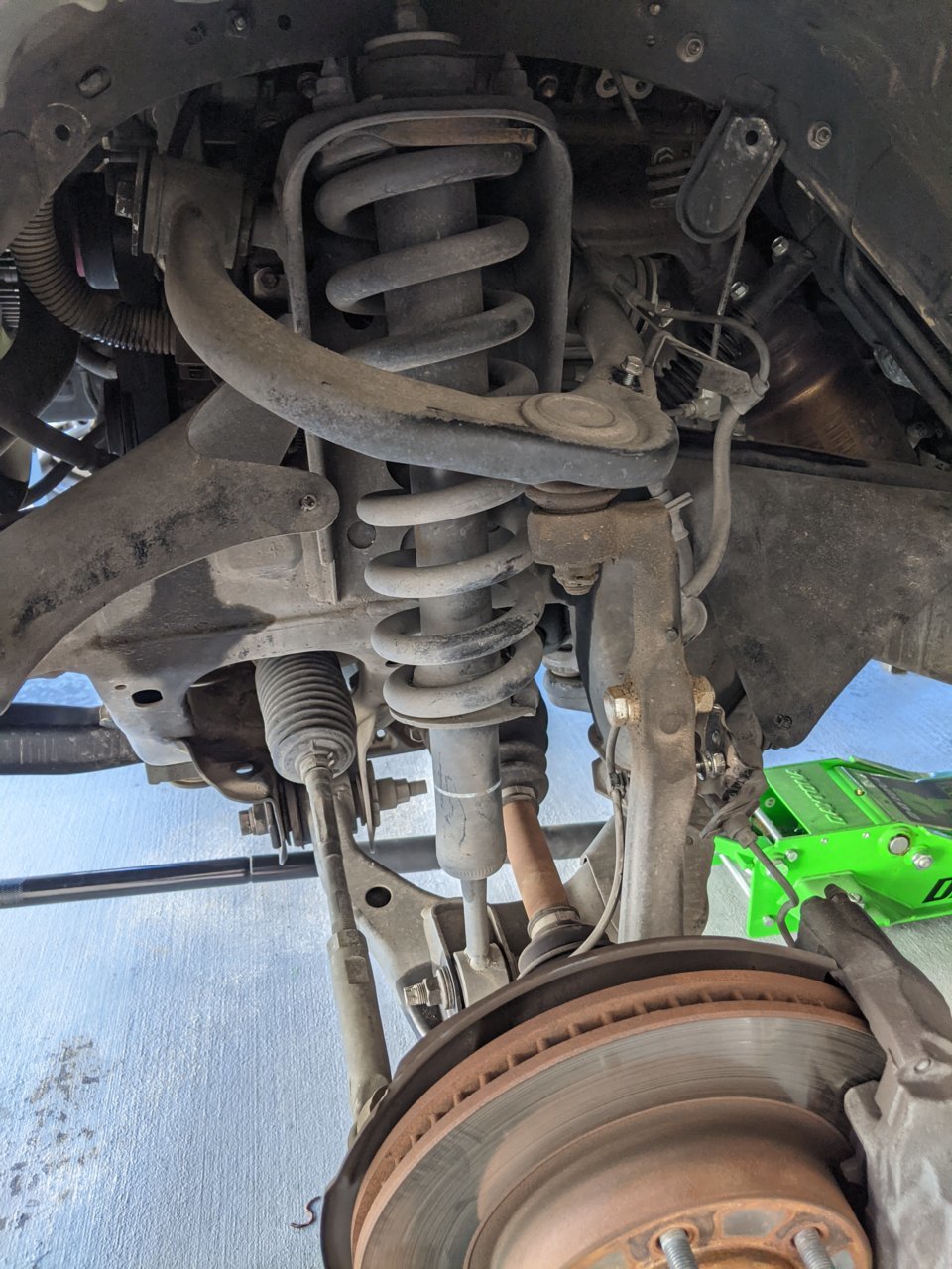

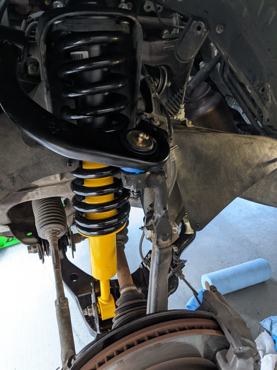

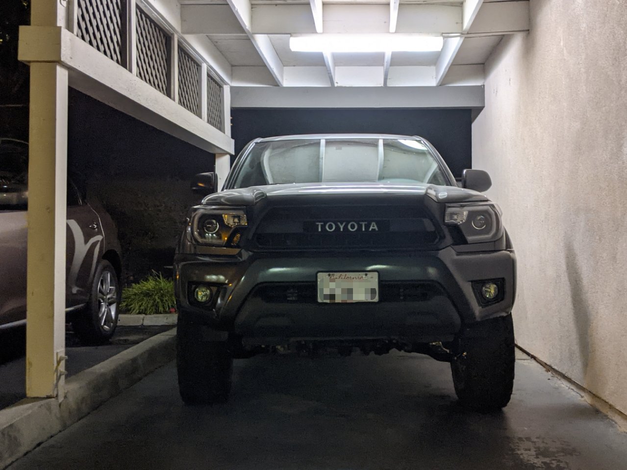

    Annnd super taco-lean fixed! I was able to get the remaining shock/coil installed after work today. Now I just have to deal with my truck looking like its draggin' ass for the next few days until I can install the new rear shocks and AAL's this weekend. :D
    Before:
    After:

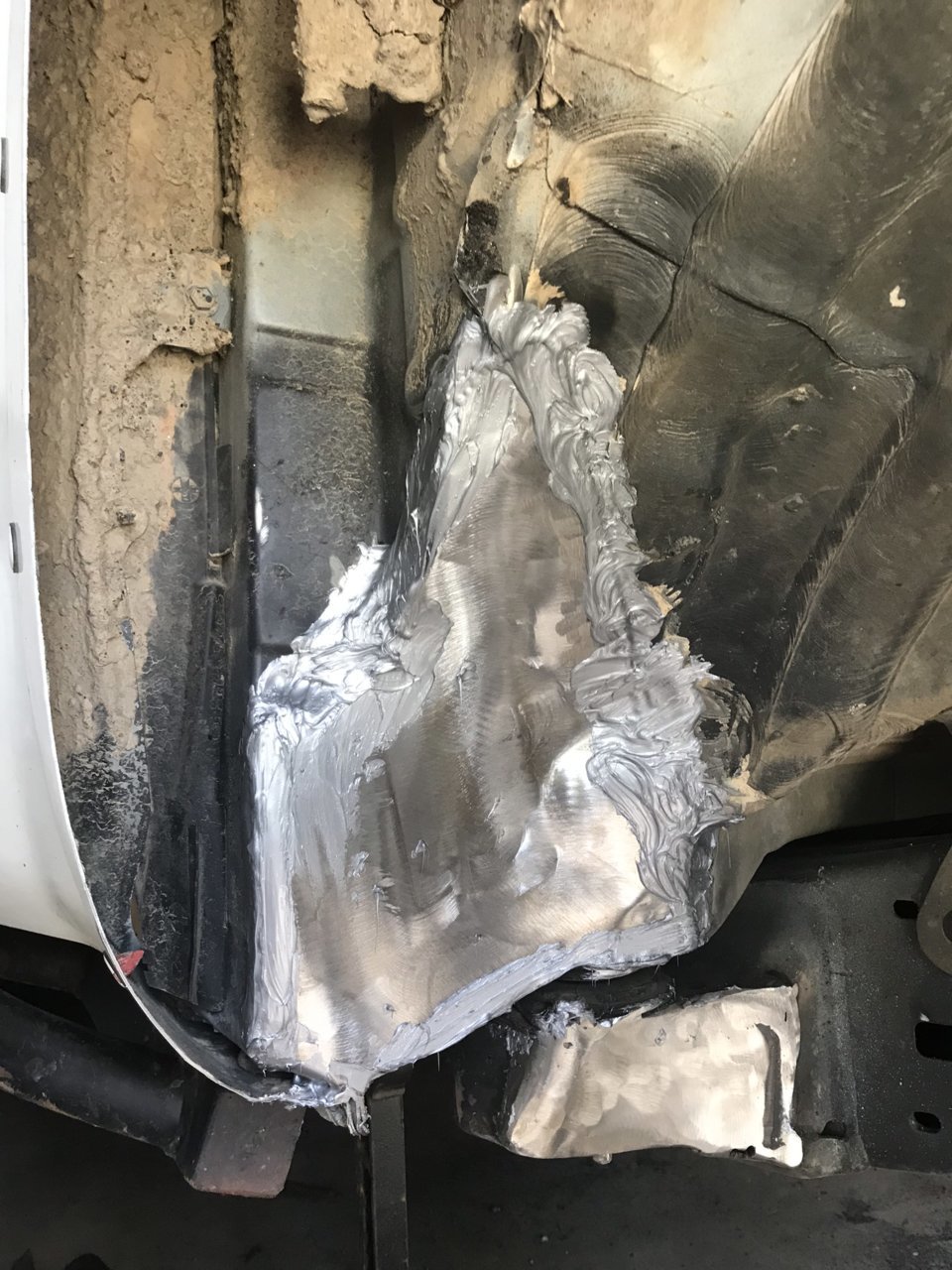

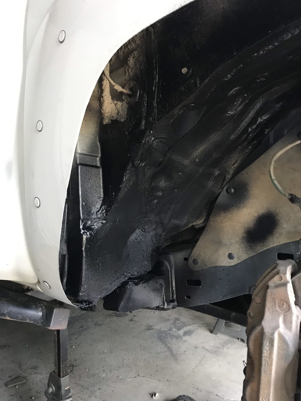

    Gonna have to cut more with these new wheels since I have an additional 1.5” of poke. I’ll relocate the cab mount and probably just start over on the tubbing, giving myself more clearance than necessary.

    pretty soon you'll be able to hang your foot out that hole while you're driving. Ram Air AC!

    Shoot, should’ve thought that through before I closed it up.

    What are you using to close that up? Did you fab a metal cover or what?

    Cut and form some sheet metal and weld it on. Then seal the shit out of it with some caulk, then spray it with flex seal. I haven’t had any leaking issues.
