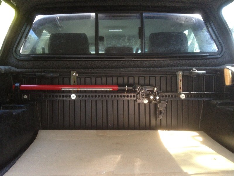

    Mounted up my Hi-Lift in the bed.
    Went for the 60 incher, fits snugly in the back, actually had to grind off about 1/8" from the end.
    Homemade mounts cost me $4.68 in hardware. I used an old t-post I had in the garage, and some scrap aluminum for the tracks. The T-post was perfect because it comes with holes already, so drilling out is a piece of cake. Work Smarter, not Harder!
    Stoked on the fitment, it's snug, no rattles, and the fact that the 60 inch bar rests on the wheelwells means im not putting too much stress on the bed track system. :cookiemonster:

    thats funny, put a bottle opener in the truck also.

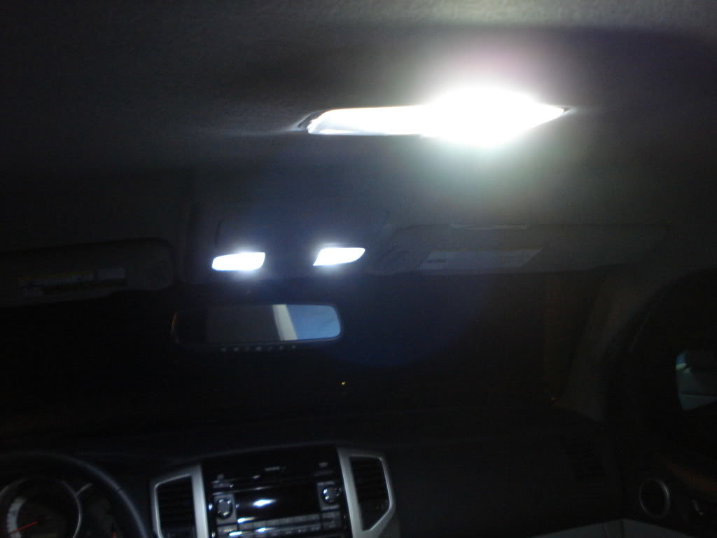

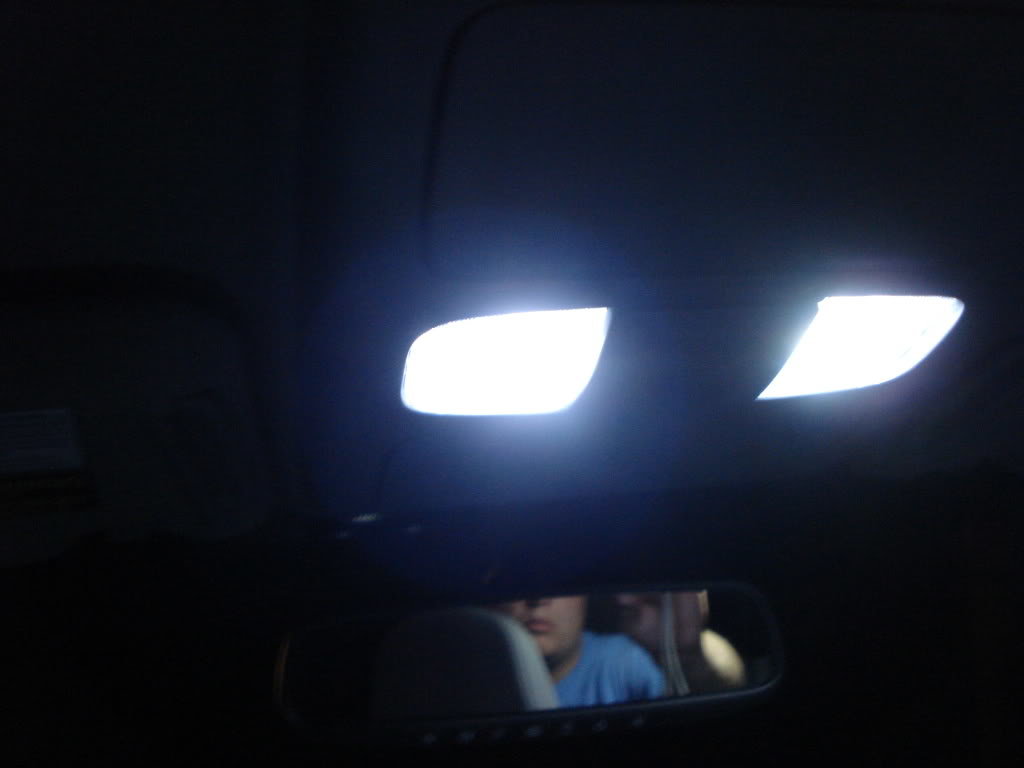

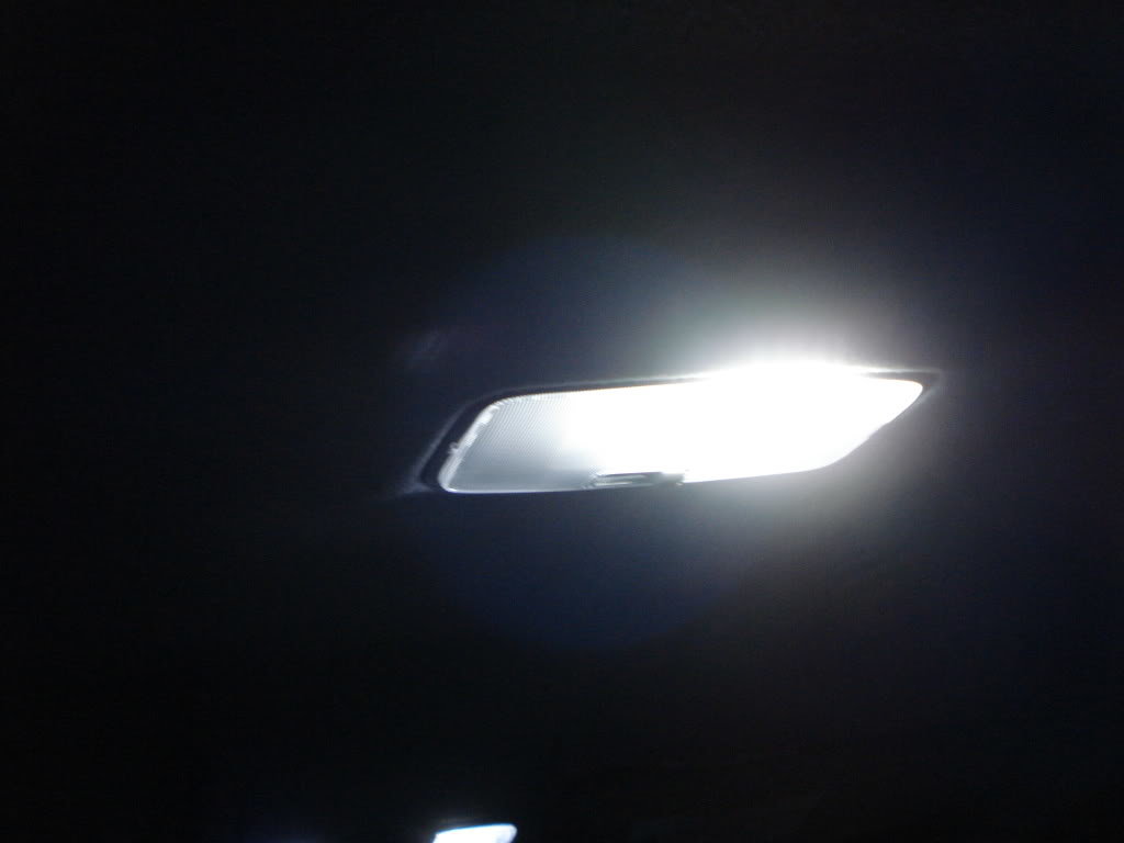

    Put some led's in ...sorry about the crappy pics ,that was the best my camera could pull off

    looks good
    led bulb #'s please

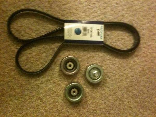

    Old vs. New Idle Pulleys
    Old
    New
    Almost ran out of gas today :D...That would have been fun.

    For both the map lights and dome light I went to www.Superbrightleds.com. The map lights I used 921 bulbs ,they are the same as 168 and 194's .I went with 921 because they are brighter. Heres the link for the map lights http://www.superbrightleds.com/more...d-bulb-12-wide-angle-led-mini-wedge-base/203/ in cool white, they come really close to touching the lenses but dont .Don't hold me to it but I think 05-11 uses a different dome light bulb but the one I used for a 2012 is a 578 and heres the link to that one http://www.superbrightleds.com/more...er-led-rectangle-pcb-lamp-w-festoon-base/839/

    my 05 is the same, 168 map and 578 dome
