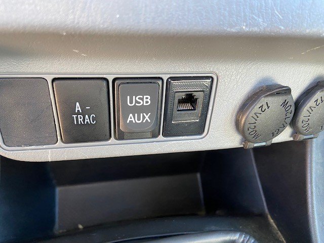

    Thank you! I’ve been trying to figure out how to fix it. Sucks that I could avoid these by just taking the whole center console apart, but I’m lazy/impatient.

    Bought it from AirOnBoard. Only took maybe 3-4 days to show up.

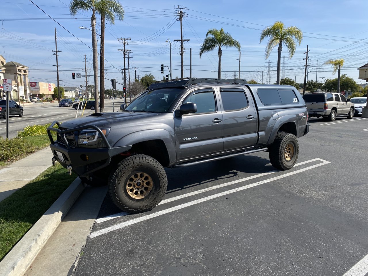

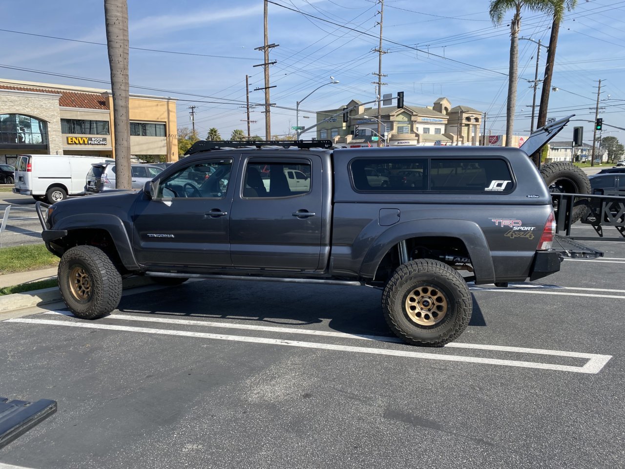

    Went and picked up a new-to-me Snugtop shell for the truck. Will get some better pics later. Super stoked to have a cap on the truck again.

    Thats my dilemma.. I'm not paying $40 for that plug, so I can get it in 3-4 days. I also don't want to wait weeks for this one. But i am saving $25 over what you paid :cool:

    I have actually been looking at those exact ones, thought they looked familiar. I have heard good things about them even though they are cheap.

    I did the same thing. Was like screw the aob markup for a 2” piece of plastic with a cheap Ethernet port, purchased off eBay I think $10 and it arrived in a week from China even though it said 2-3 wks.
    It is a piece of junk though lol. It’s a 2 piece design and the sheath over the Ethernet wires on the inner side of the switch doesn’t stay clipped in place. Doesn’t really affect anything with the actual jack though, and fits the blank great.

    I have this already, and was going to dremel out a space to fit it in a blank. Thanks for the heads up!

    You're welcome. Get the lines straight first and then smooth the surface. Unfortunately you'll need patience (lol).
    You can avoid pry marks and taking the dash apart by drilling the hole in the dummy plug first and then using a 90* pick tool inserted into the hole that you drilled to pull the dummy plug out. Some dummy plugs will have electrical plugs attached to the back so you'll want to use a deep socket or similar to limit how deep the drill bit goes into the dummy plug when drilling it.
    For plastics that have an embossed texture and the texture has been damaged in a small area the texture can be somewhat reformed by putting a similar textured plastic on top of the damaged texture (texture to texture) and lightly tapping it with a ball peen hammer. This process will flatten out the texture you're trying to duplicate so it will need to be moved around to get the full benefit of it.
