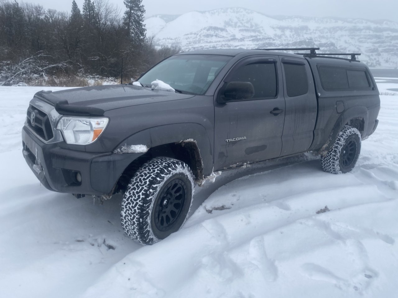

    2015 MG Access Cab
    Fuel wheels and a canopy

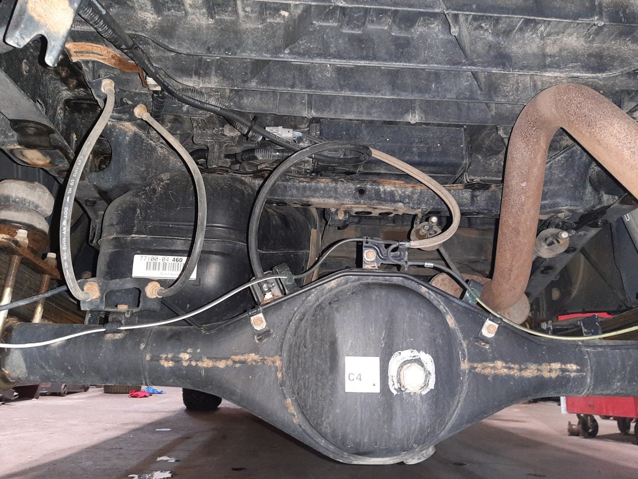

    Did a couple things
    Adjusted my ride height from 21.5 hub to center to 23.
    And finally did the rear diff breather mod.

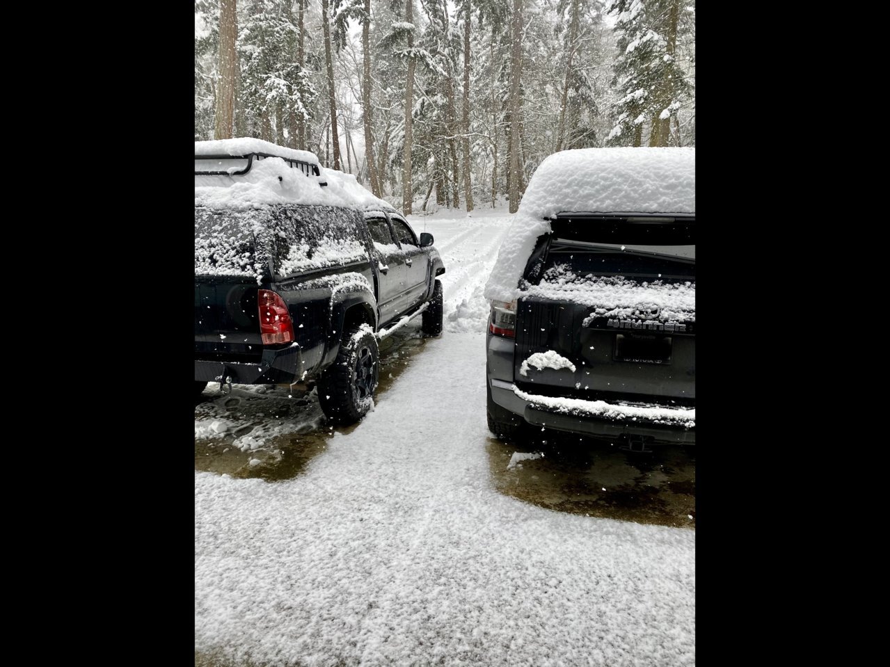

    9BC17380-2F31-4D1E-A257-F8B2D15E5821.jpg No work to be had on this day.

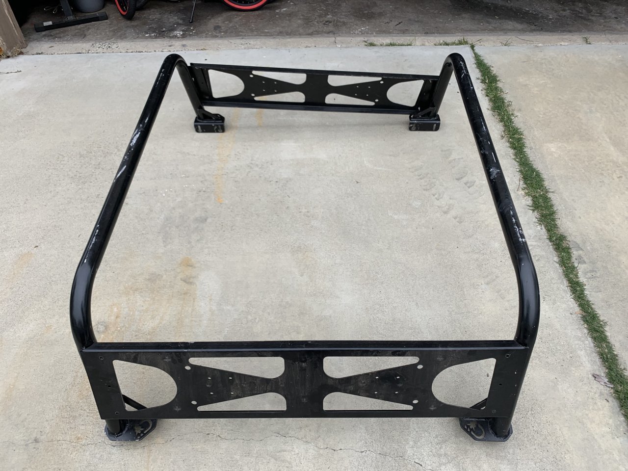

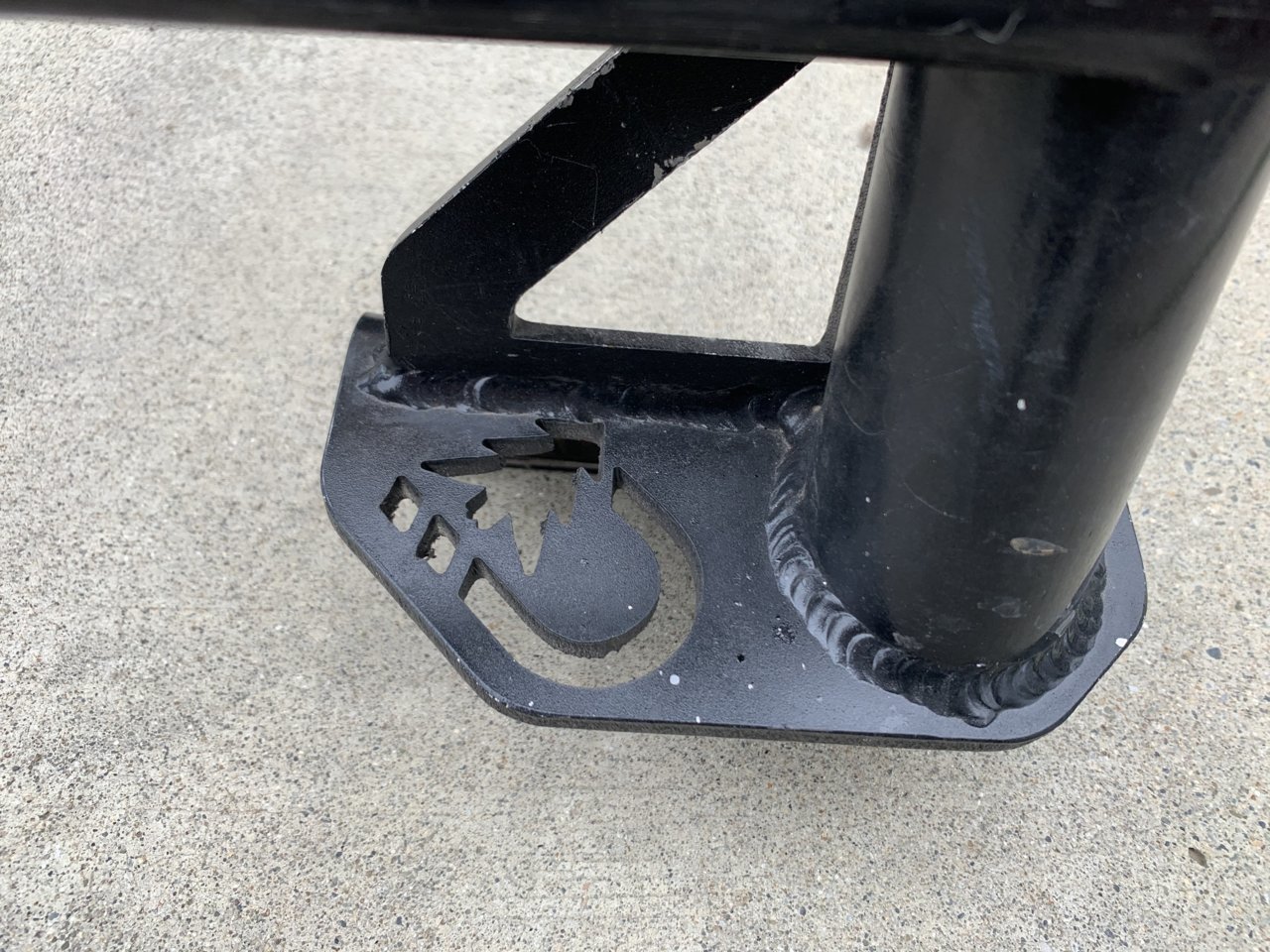

    Just picked this up from a fellow 4Runner owner for an insane deal.

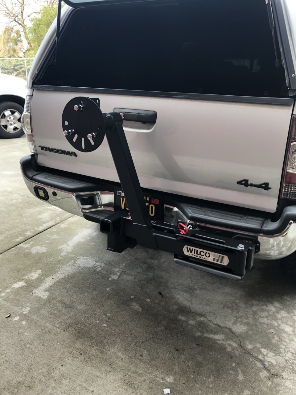

    Info on the backup sensors in your bumper. What did you use to cut the holes in the chrome bumper for the sensors and the led lights?
    srspicer likes this.
  13. Feb 15, 2021 at 4:34 PM
    outxider
    outxider Never stop exploring. Rest in Paradise Big Bro.
    May 9, 2010
    #36858
    2,081
    Sang
    East Bay, CA
    06 DCSB 4x4
    A few mods here and there and counting....
    The back up sensors were on the truck when i got it. I did pull them out before and looks like a straight cut with a hole saw. As for the auxiliary back up lights, they were cut out with a dremel. Drilled a hole in each corner and used reinforced cut off wheels. A metal file to clean up the edges. Wasn't hard at all.
