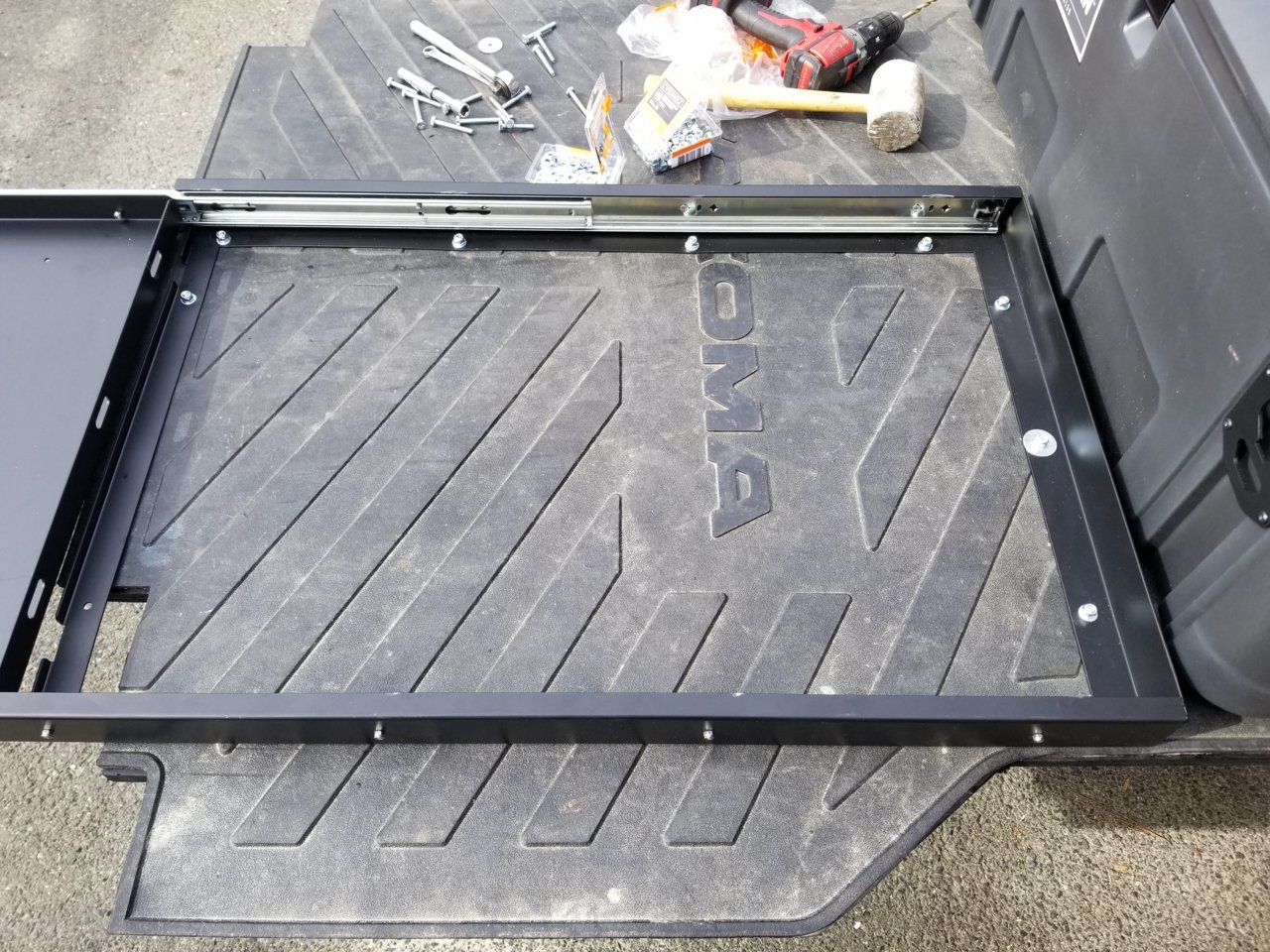

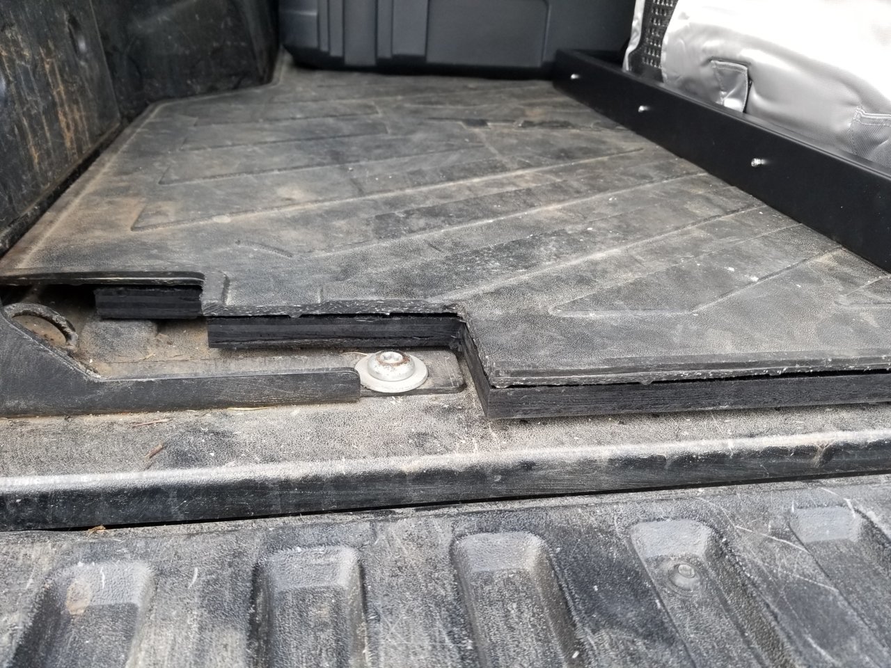

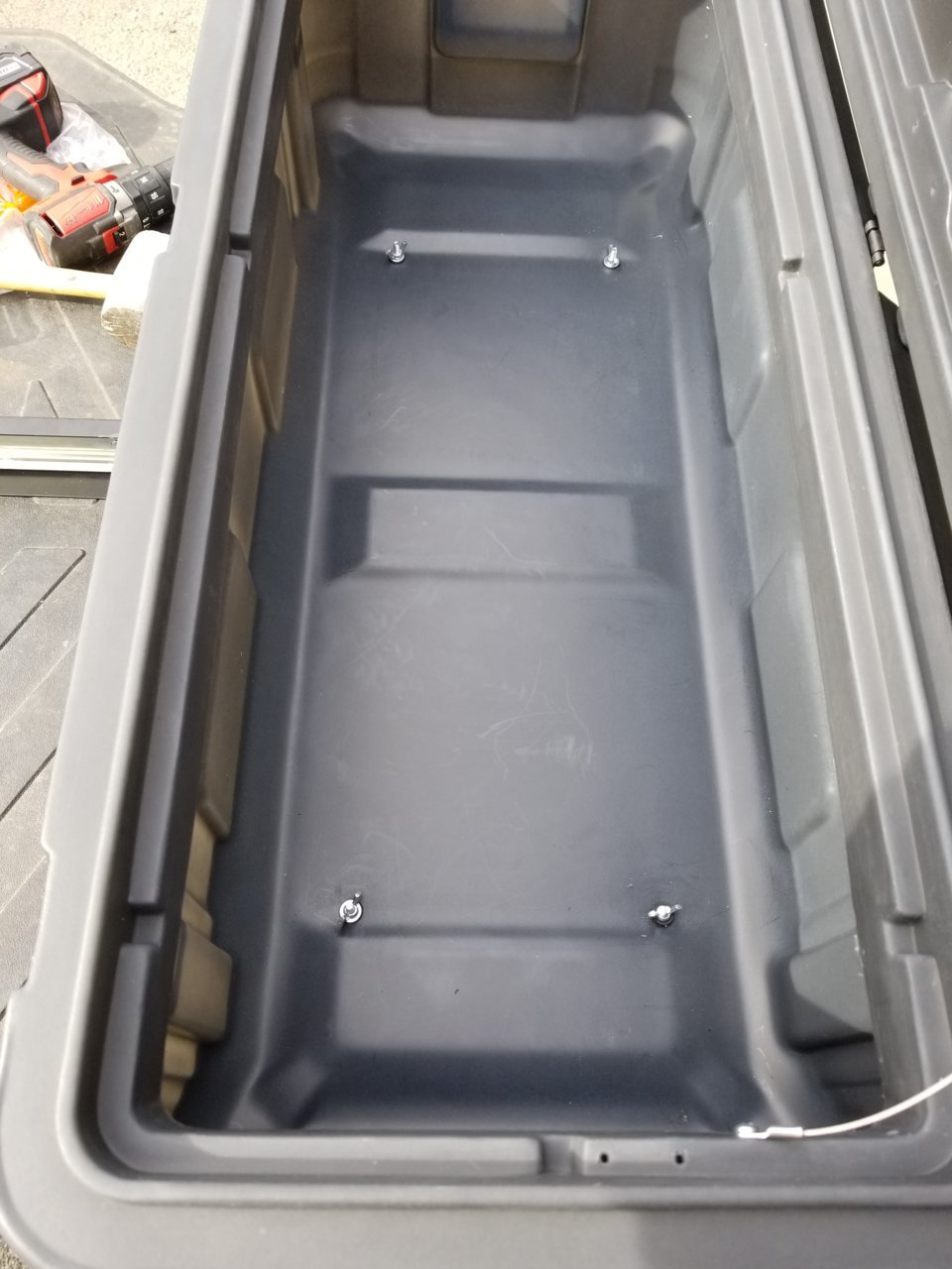

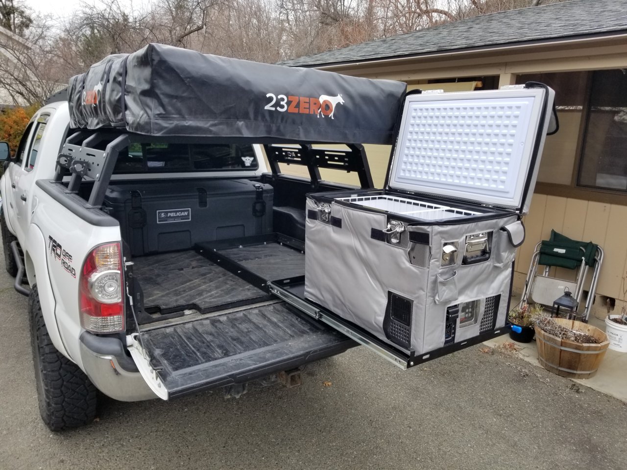

    Got my permanent recovery gear and fridge slide setup mounted! Cut up a 3/4" sheet of plywood to fit in truck bed, bolted the Pelican case and fridge slide to plywood and bed mat using wing nuts for Pelican (for easy removal to mount my water tank between case and front of bed) and locknuts for the fridge slide. Everything is super sturdy, doesn't slide around and didn't have to drill through my truck bed! Bonus awesome because space to left of fridge fits my Plano case on wheels perfectly! Everything set up in preparation for the great New Home Hunt of 2021!
    3/4" plywood spray painted on one side and spray on rubber underneath to prevent the slight sliding around
    Used 1/4" bolts of various lengths and drilled through bed mat and plywood for mounting case and slide, everything fit perfectly between the channels of the truck bed. No weird lumps and no drilling into bed
    Weight of the tools/recovery gear in the Pelican case is the perfect counterbalance for 62qt SnoMaster fridge on the slide! Everything fits perfectly with a 13gallon water tank sitting between Pelican case and front of truck bed.

    What lock is that?

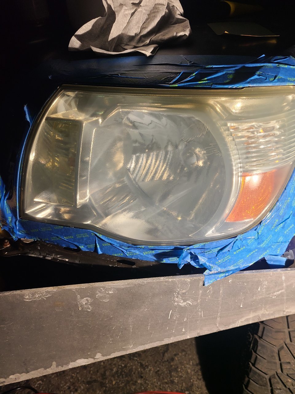

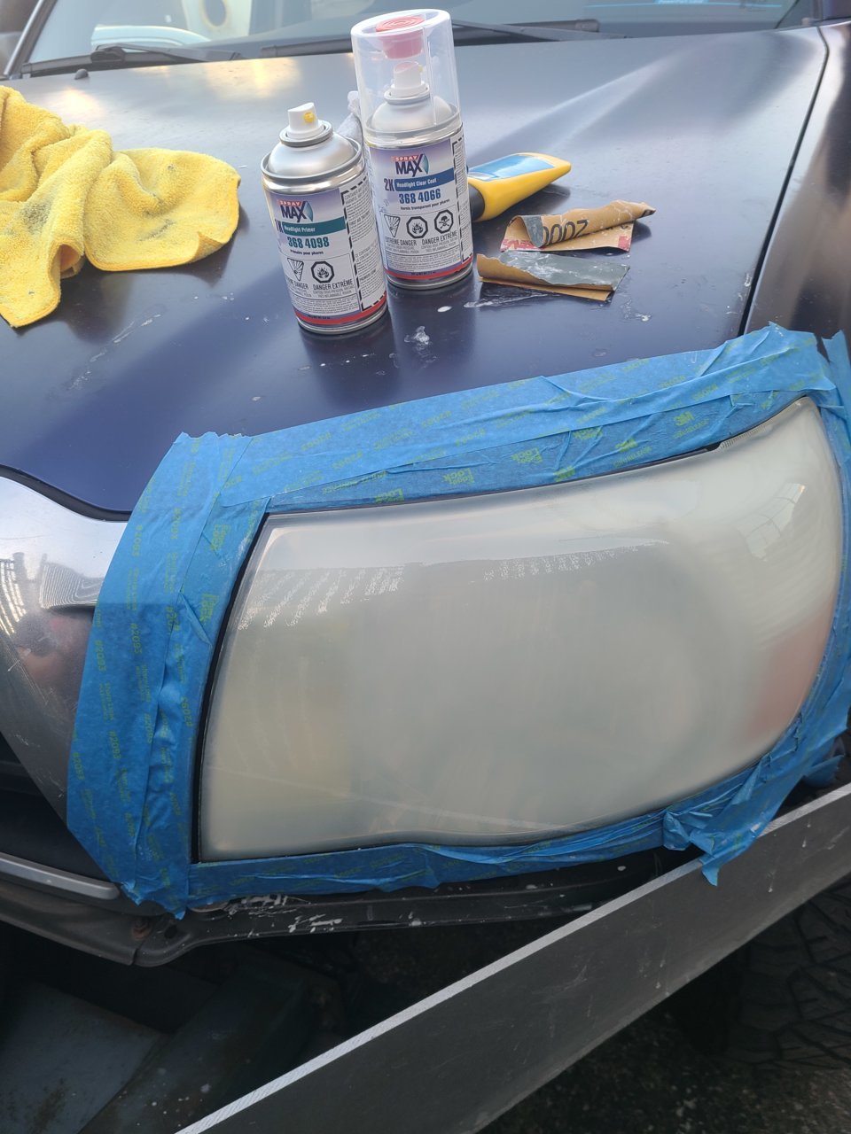

    Spray max headlight restore kit.
    Heads up, do NOT spray on a heavy coat of the clear.
    Had to redo the whole thing as it started to crack.

    I messed mine up trying to do this too. There seems to be a fine line between it turning out great and it not. I finally ended up getting new housings, but not after trying my best to restore them first.

    I've been using the 3m kit but it only lasts about a year. I'm hoping this will be more permanent. Looks good so far fingers crossed

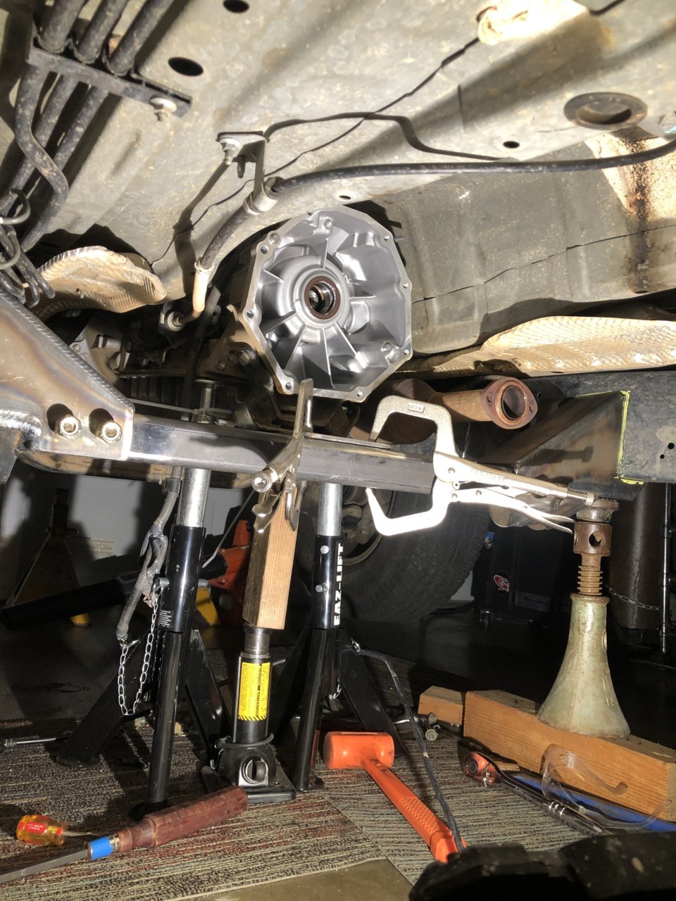

    Spotted the location of new crossmember with link mounts and continued prep on dual case install

    This is the lock. Unfortunately the 2 pack is keyed differently. I was planning on using the second one to lock up my shovel and axe.
    Obviously bolt cutters would make easy work of this cable, but it’s a nice deterrent.

    I'm just looking for a cable to lock my fridge to fridge slide. Between a cable, tailgate locked and my low profile bed rack I'm hoping that's enough of a deterrent for people to leave it alone. Obviously if someone wants it bad enough they'll do whatever to take it but a visual deterrent helps. Better than nothing. Thanks! Sucks its two different keys for two lock sets...

    Honestly I only got it because it was the cheapest one, with enough reviews, and was eligible for same day delivery..... there’s probably better ones. But I’m impatient.

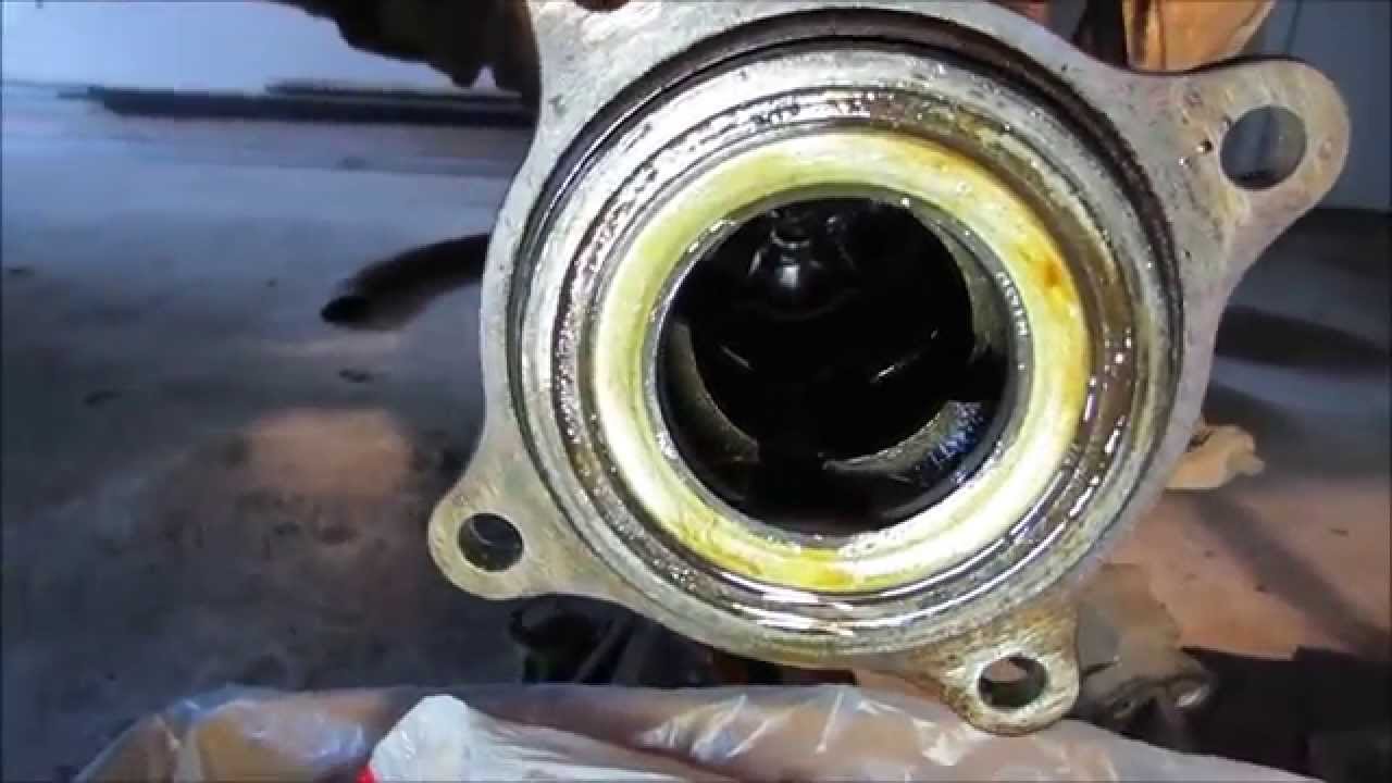

    But this will be my first time doing it! I’ve watched a couple videos and it doesn’t seem difficult at all. The only part that Worries me is properly seating the new seal. Here’s a link and video I went over to get a better understanding.
    https://www.tacomaworld.com/threads/rear-axle-seal-replacement.288348/
    https://youtu.be/gRgkaYlrWLU
