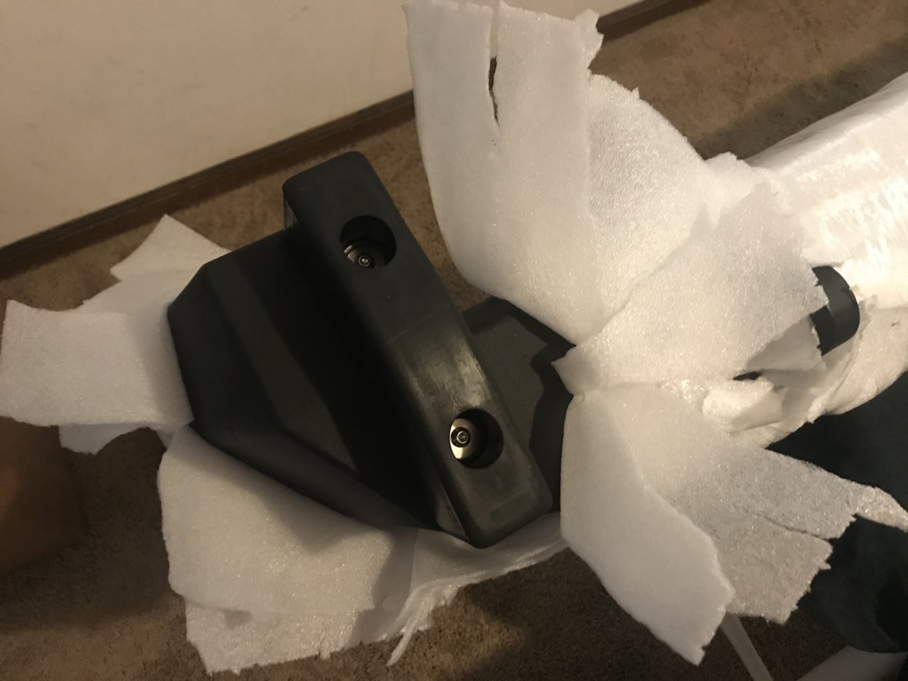

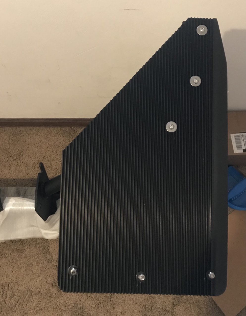

    I went the "inexpensive" route, and they are beefy AF (read: don't move even at 70mph) - I re-coated them with rattlecan truck liner before mounting them.You can get an idea of how thick the steel is in the first picture (I apparently never took ACTUAL pictures of them prior to mounting my Sports)
    https://www.amazon.com/gp/product/B07HXS8QBP/

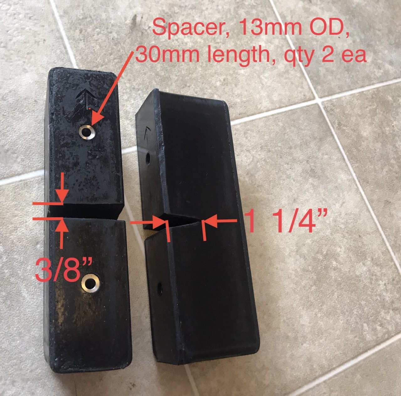

    Thanks! For sure..
    -M6-1.0x 20mm screw
    -M6 lock washer
    -M6 washer
    -Larger washer <- match size to the large washer that comes with the truck
    -Handle
    -Larger washer (already on truck)

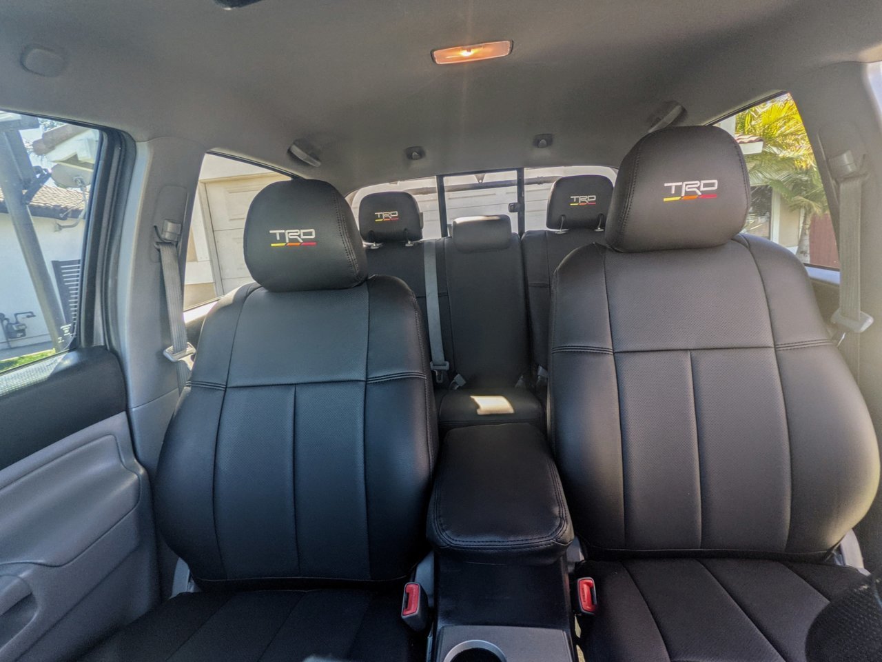

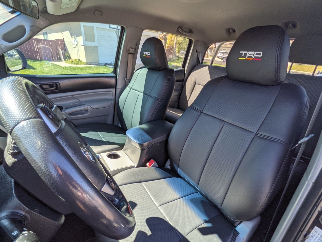

    Light Bar and Clazzio leather Seats! Nearly 100k miles on my 2015, and it fees like driving a new Truck around today (for no reason other than to test out my new seats)

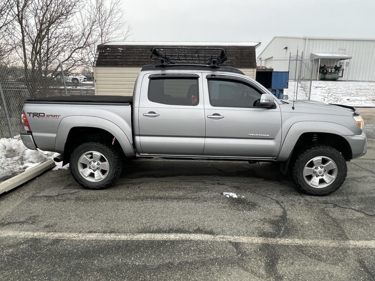

    Finally I have something worthwhile to post. :). Put my Eibach pro lift, set on 1 with deaver AAL’s. And I couldn’t be happier. They are much firmer than stock but not rough.
    inky issue I ran into was one of the rear struts was seized and the pin to hold the shaft in place broke off so I had to cut it off. Also had to cut each of the leaf pack bolts off.
    Still need to decide on tires and maybe wheels- but it is a start.
