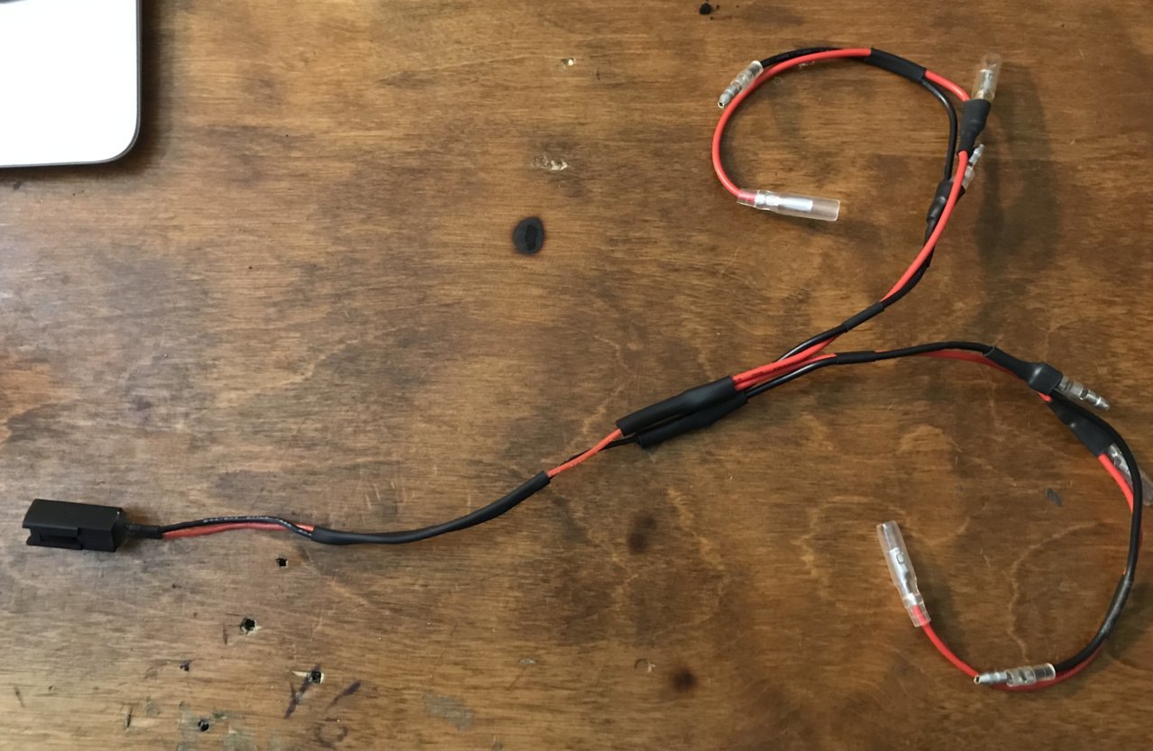

    Do you have a write up on how you wired your meso third brake light?

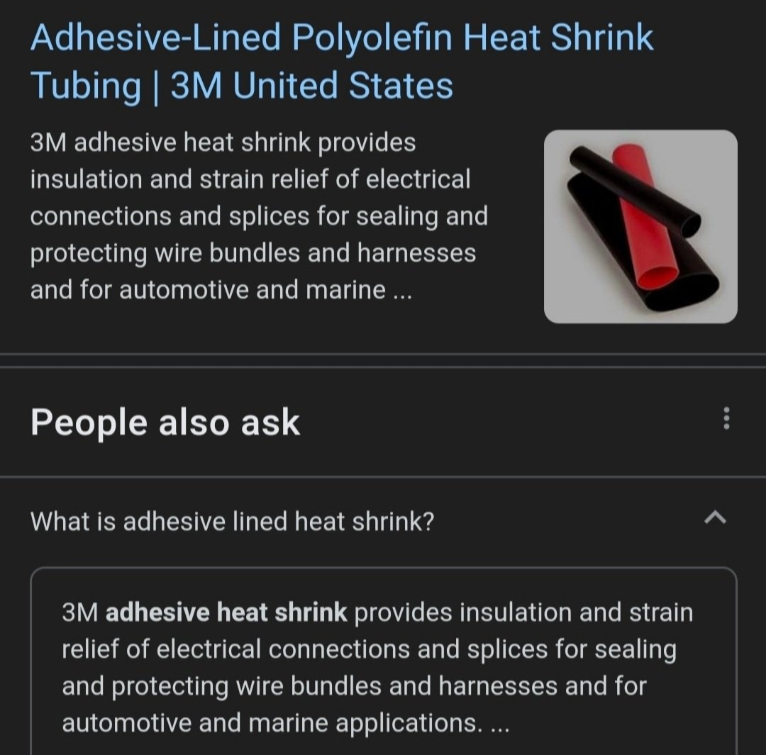

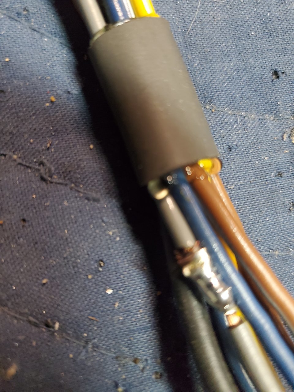

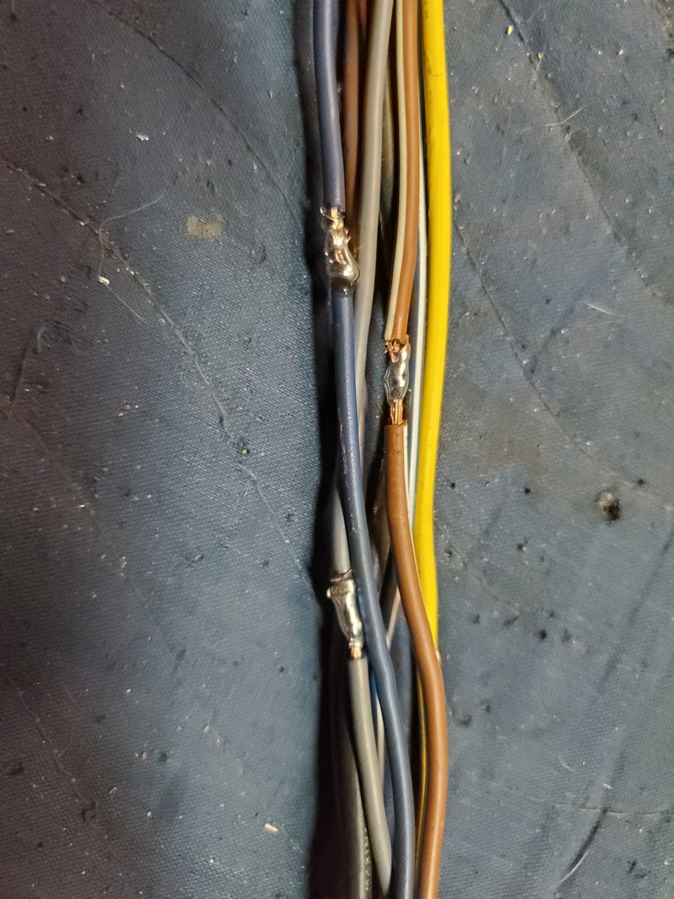

    Hey you have a bad azz truck and you do great work...
    Stagger your electrical connections
    and use
    and the wires will be totally sealed in any environment and it'll totally hide all of those connections
    you can see the glue at the end of it
    and it'll last for freakin ever.
    But I gotta apologize because I'm actually out of adhesive heat shrink otherwise I'd have covered all of them and I gotta apologize for my connections looking like crap but I'm having a hard time twisting wires right now lmao
    I KNOW YOU'VE BEEN THERE LOL

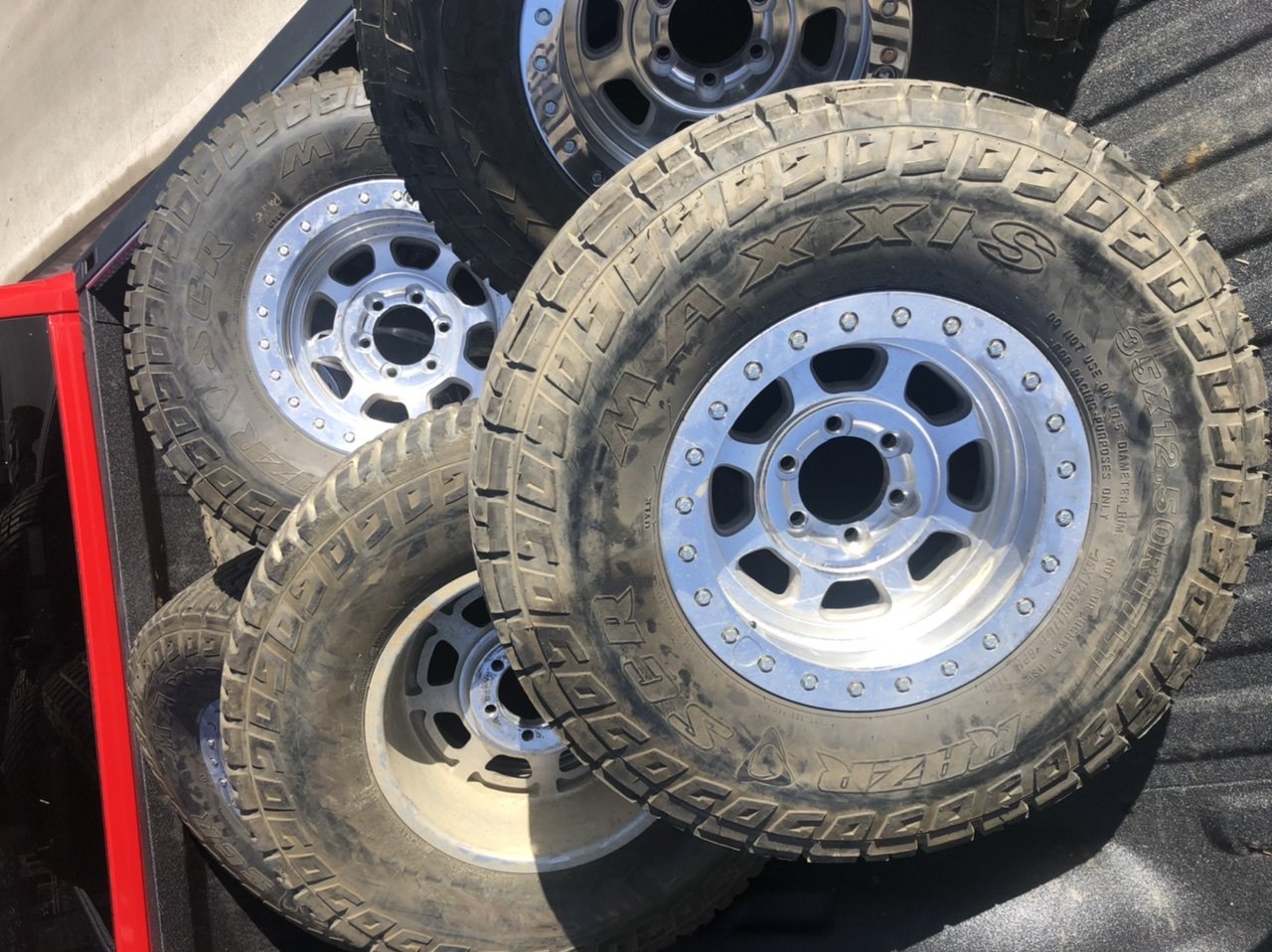

    Picked up and test fit some new wheels/tires. Gonna try these out this summer in the desert and see how the short course tires do.

    No writeup yet, but the idea behind it is fairly simple. Solder together a y-harness (1 wire to 2 wires) until you have enough connections for all your lights. Not a refined approach, but it seems to work well.
    *EDIT*
    @TheBlueBeast15, here’s a picture of the wiring harness on its own. I used the pigtail connectors included with the KC Cyclones, the plug and wiring cut off the previously-installed cheapo Amazon third brake light, and a good bit of heat shrink.

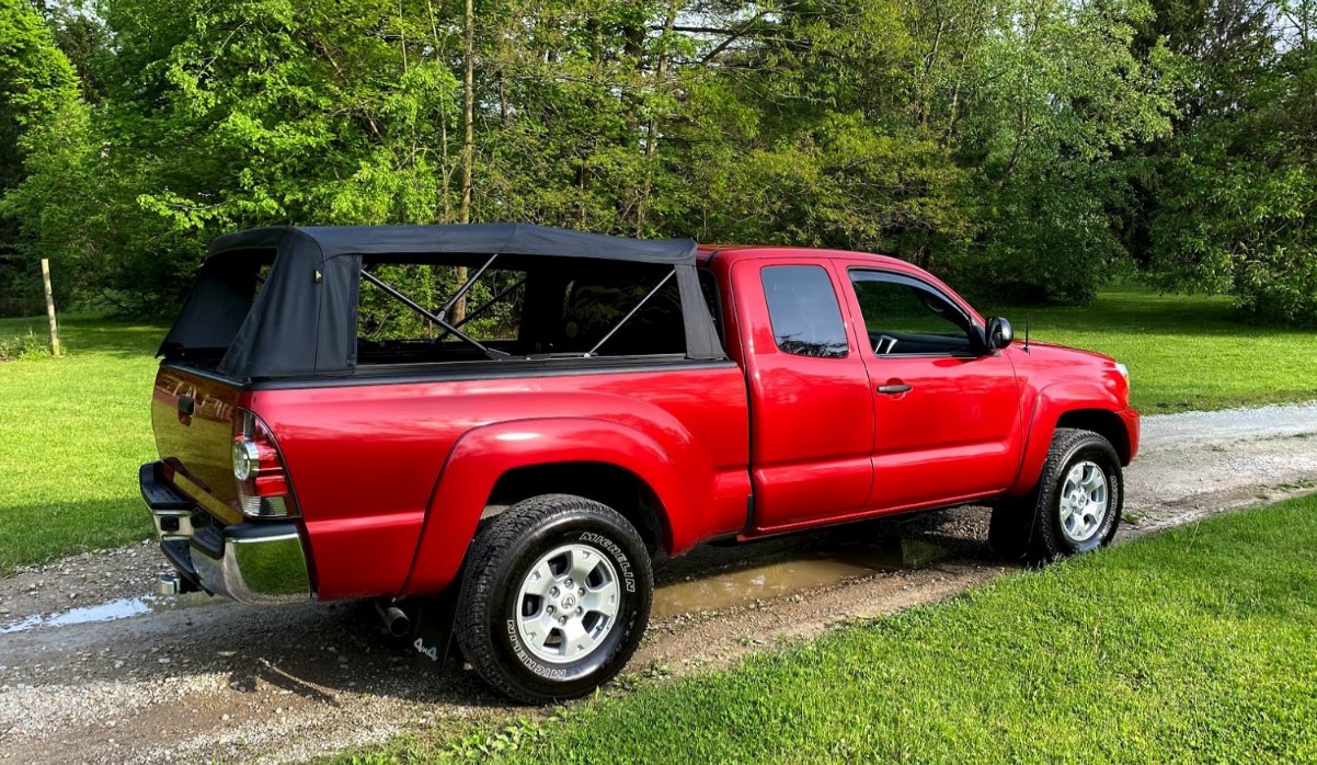

    Yup, I do the same. It's on for a a bit, then gone for a bit. Nice thing about a soft top...takes a few minutes but it's simple to convert.
