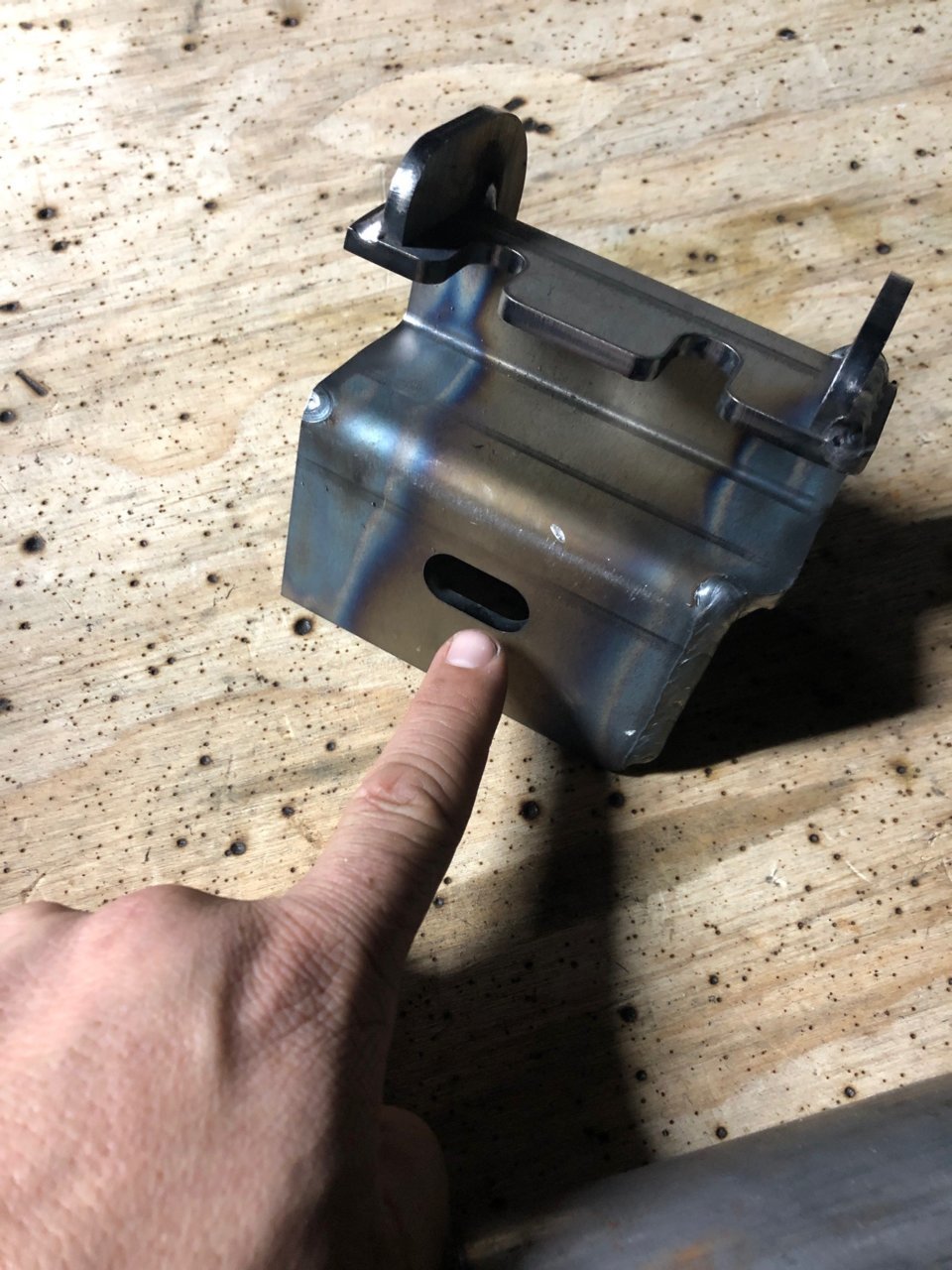

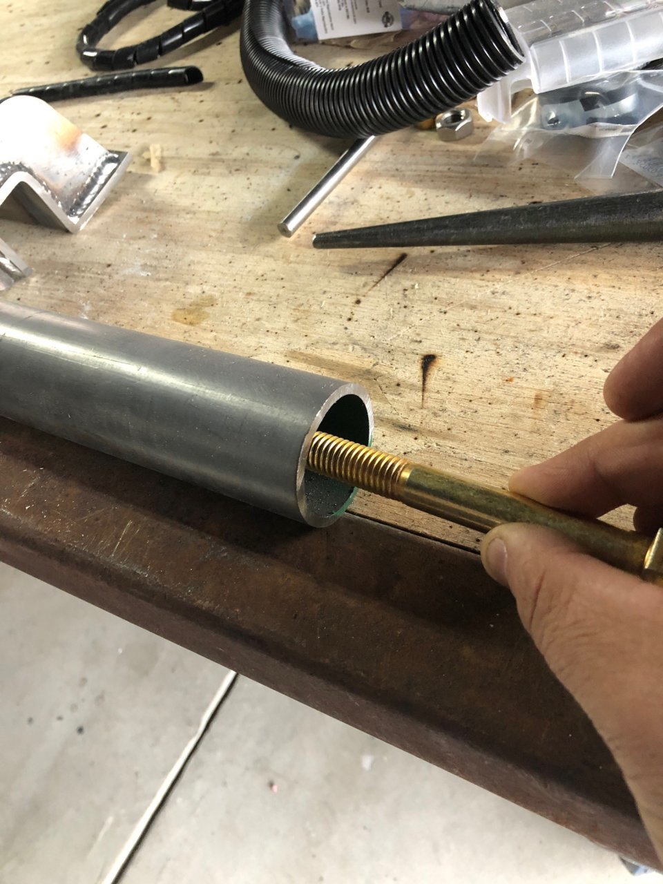

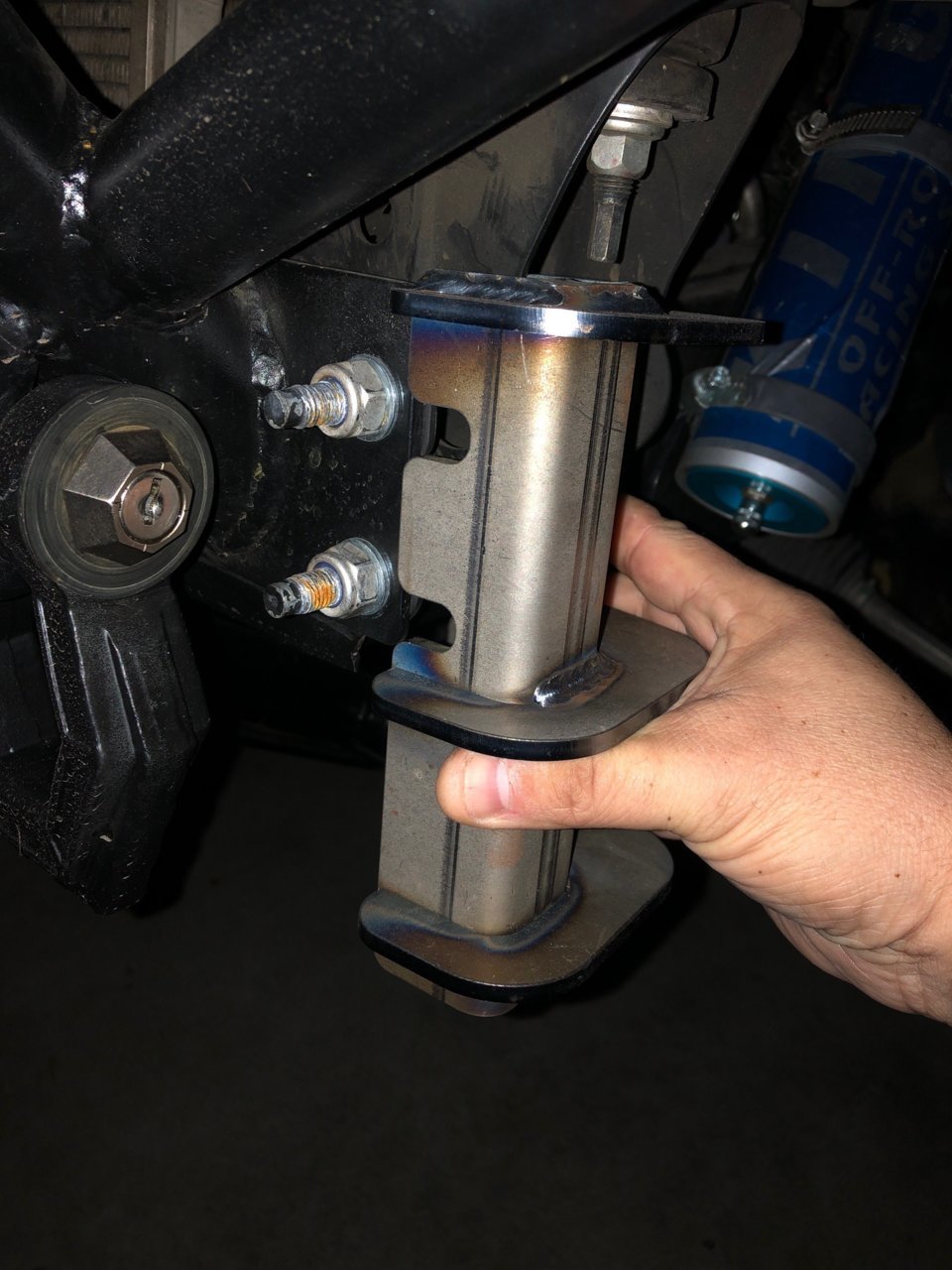

    I purchased some BAMF Front bumper reinforcements to strengthen up my recovery points on my prerunner tube bumper.
    Since I cut off my factory crossbar to get my bumper as high clearance as I can, I chopped these in half. Additionally, I was thinking since these bolt to the frame, how cool would it be to have a support bar connecting them acting as a new crossbar? I was thinking of welding a 2" piece of DOM tubing right where the bolts would go.

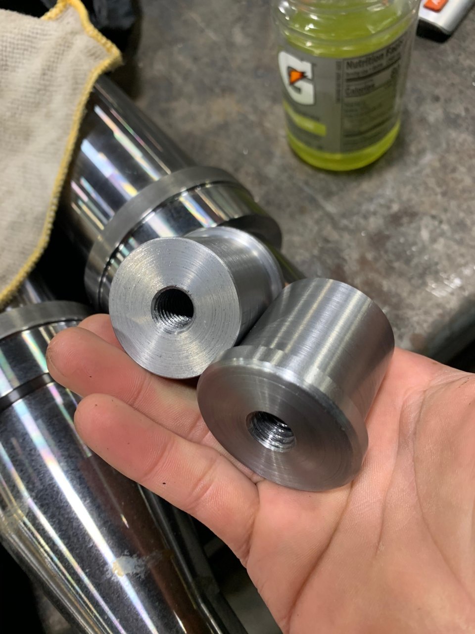

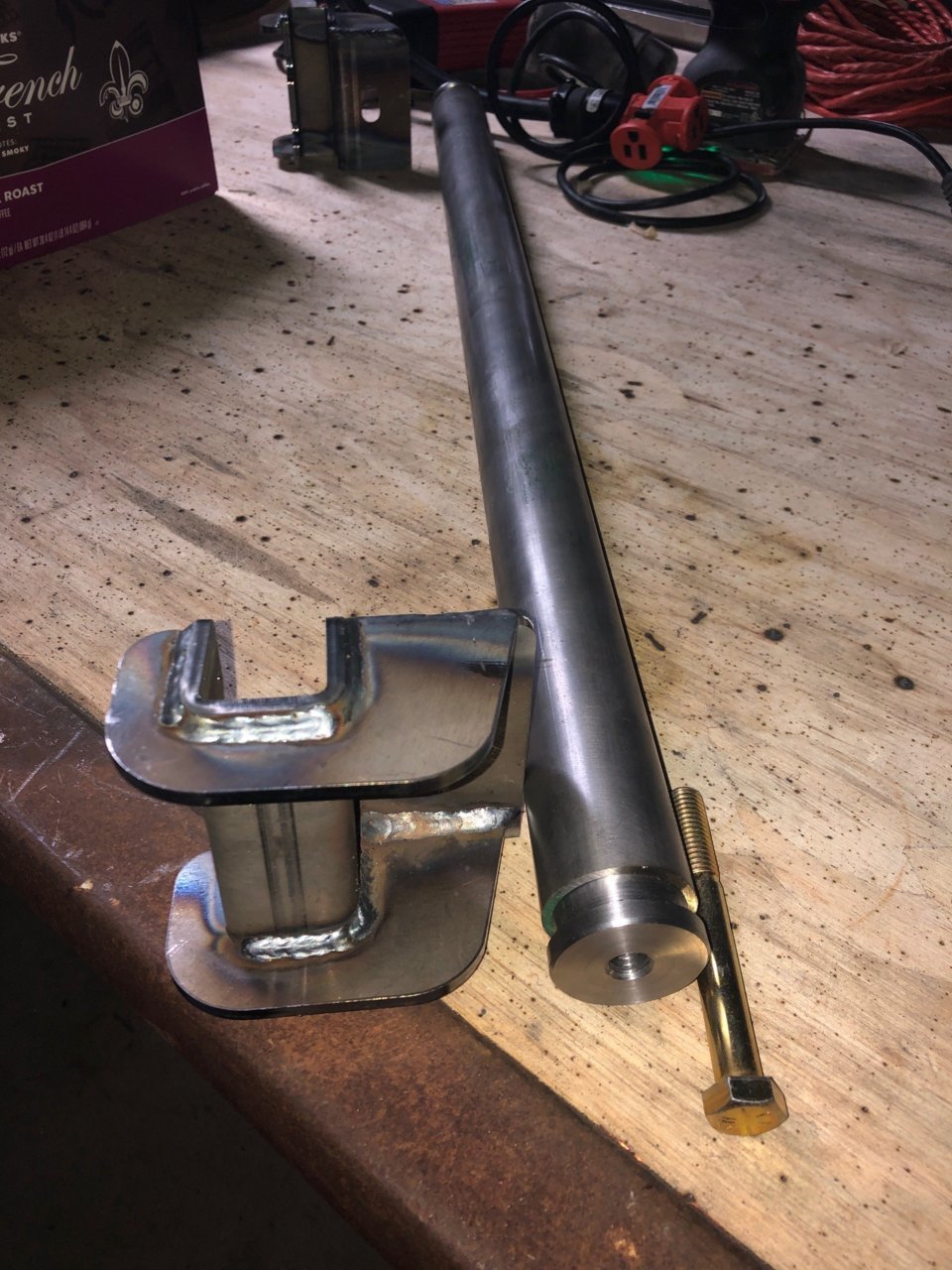

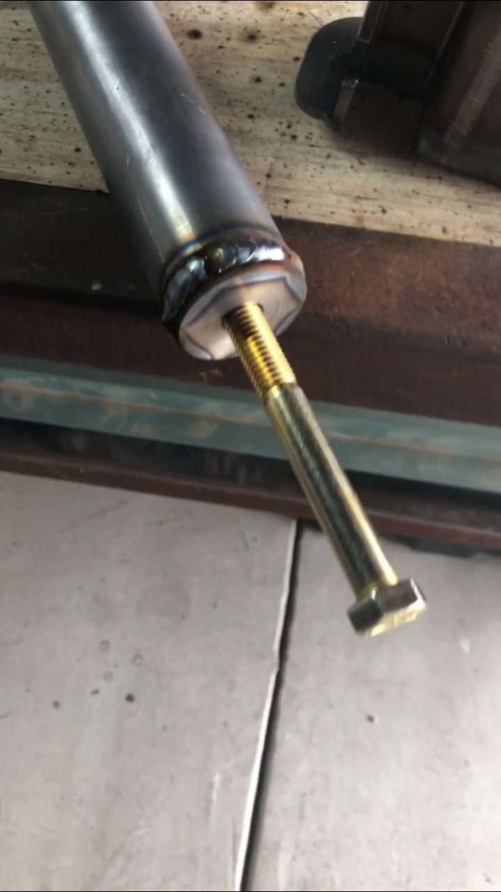

    So I had some threaded bungs made, measured and cut a piece of tube for the new crossbar, then welded everything up

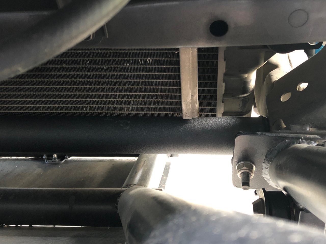

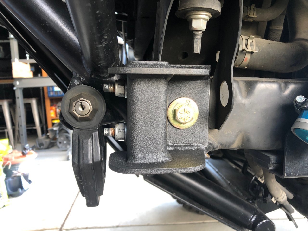

    Here is everything powder coated and installed.
    Overall, I'm extremely satisfied with the end result. Extra support for the frame, and removable if I ever needed to make changes.

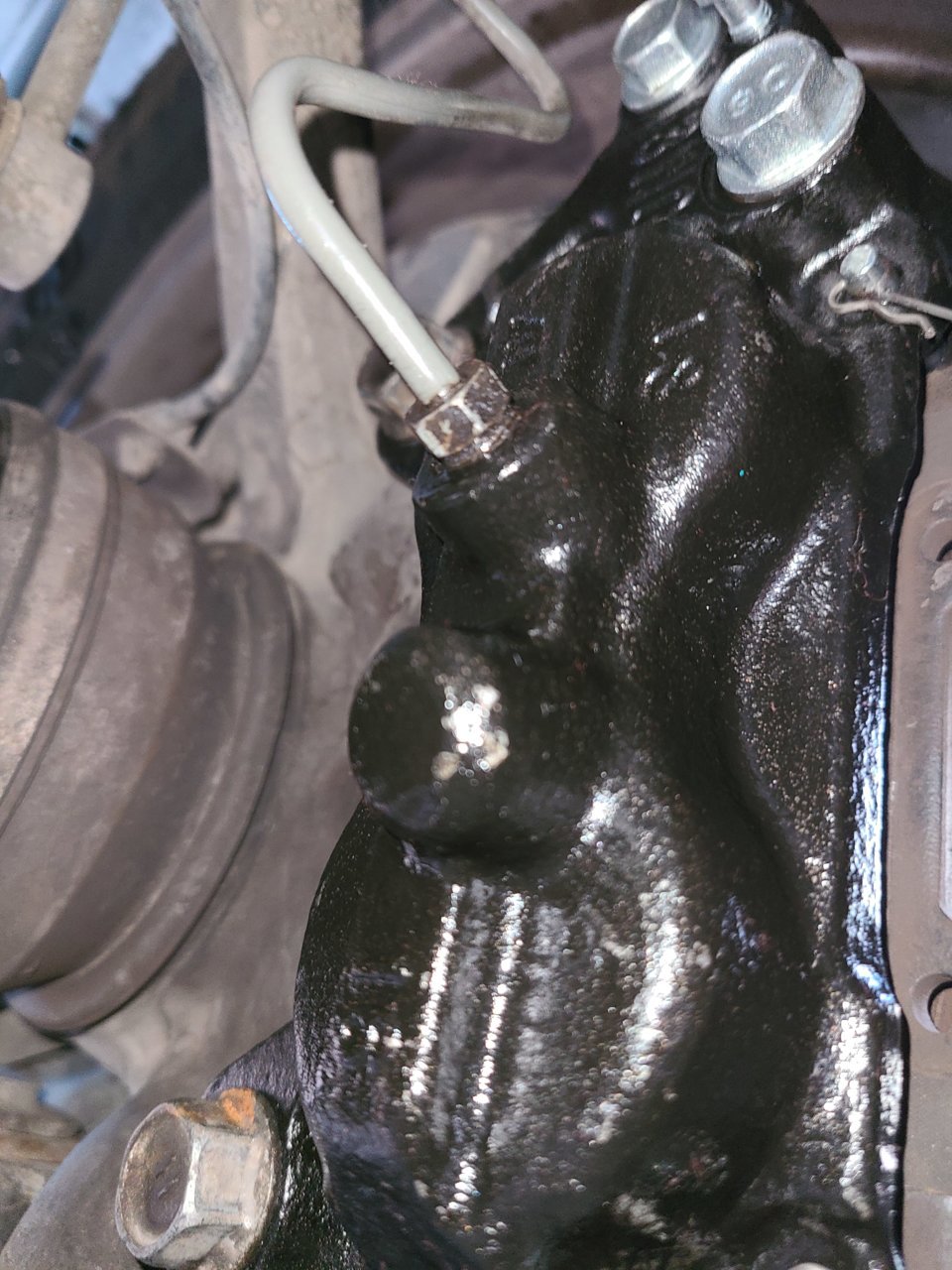

    Changed out front calipers. Broke the hard line at the connection. Just barely.. Took me a while to figure out why air was still in the system...

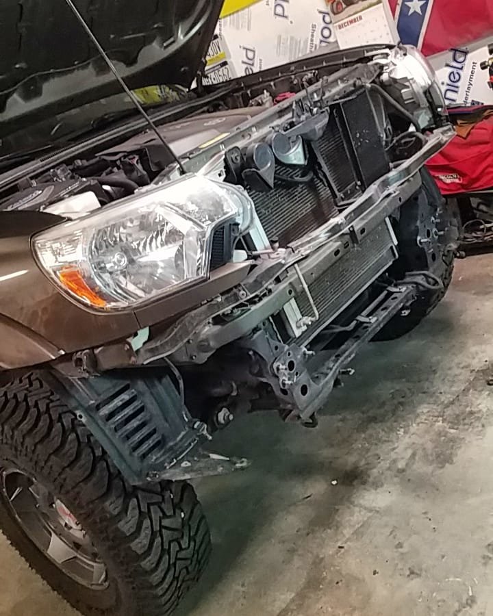

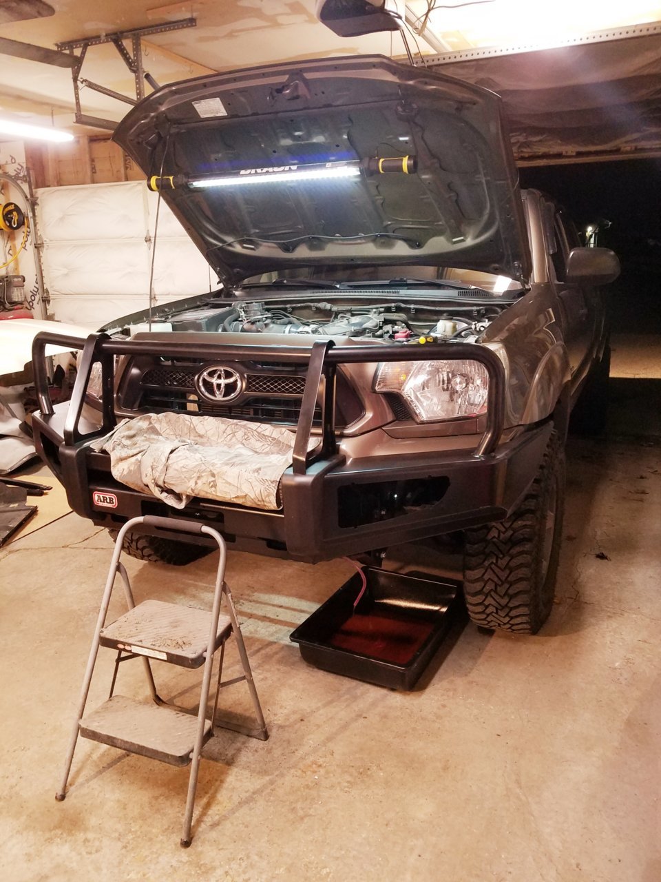

    coolant, hoses, thermostat, waterpump, idlers, tensioner & belt in the works.

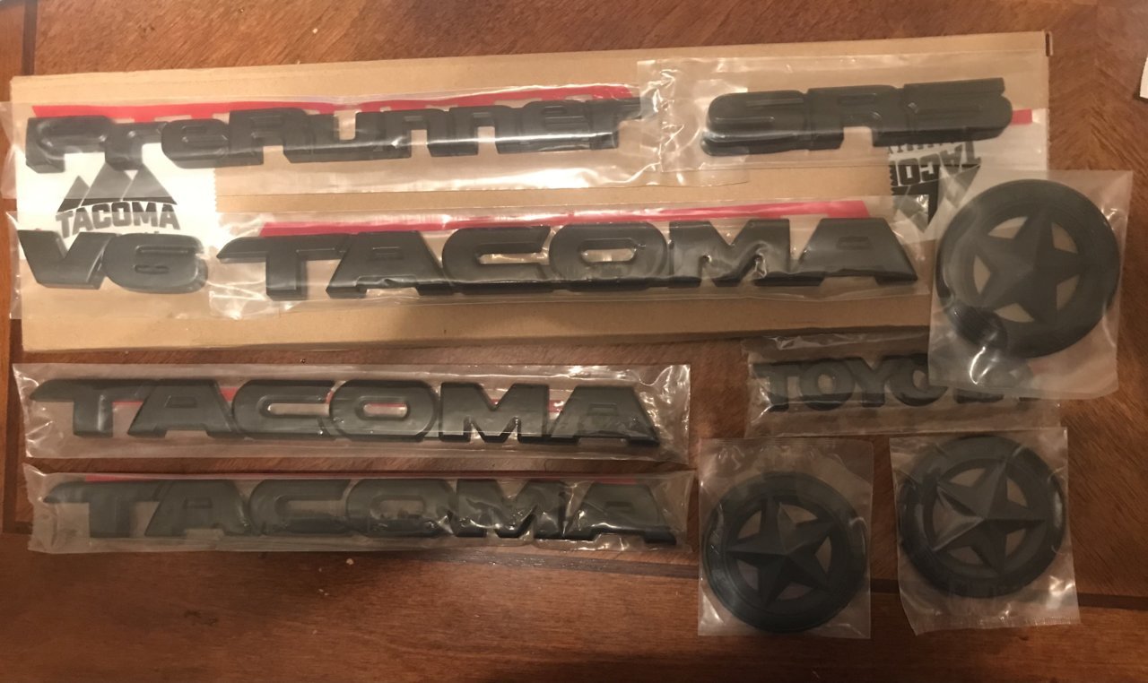

    These arrived today. Now I have something to do this weekend. BCD1C2B0-A70E-47F5-8B1C-702264D8FC8B.jpg

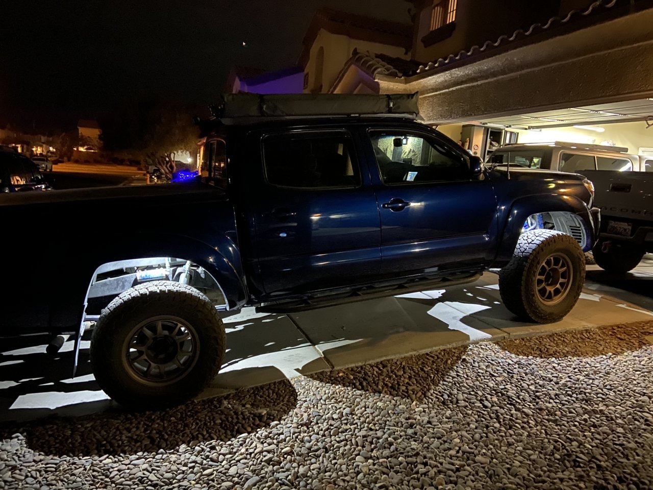

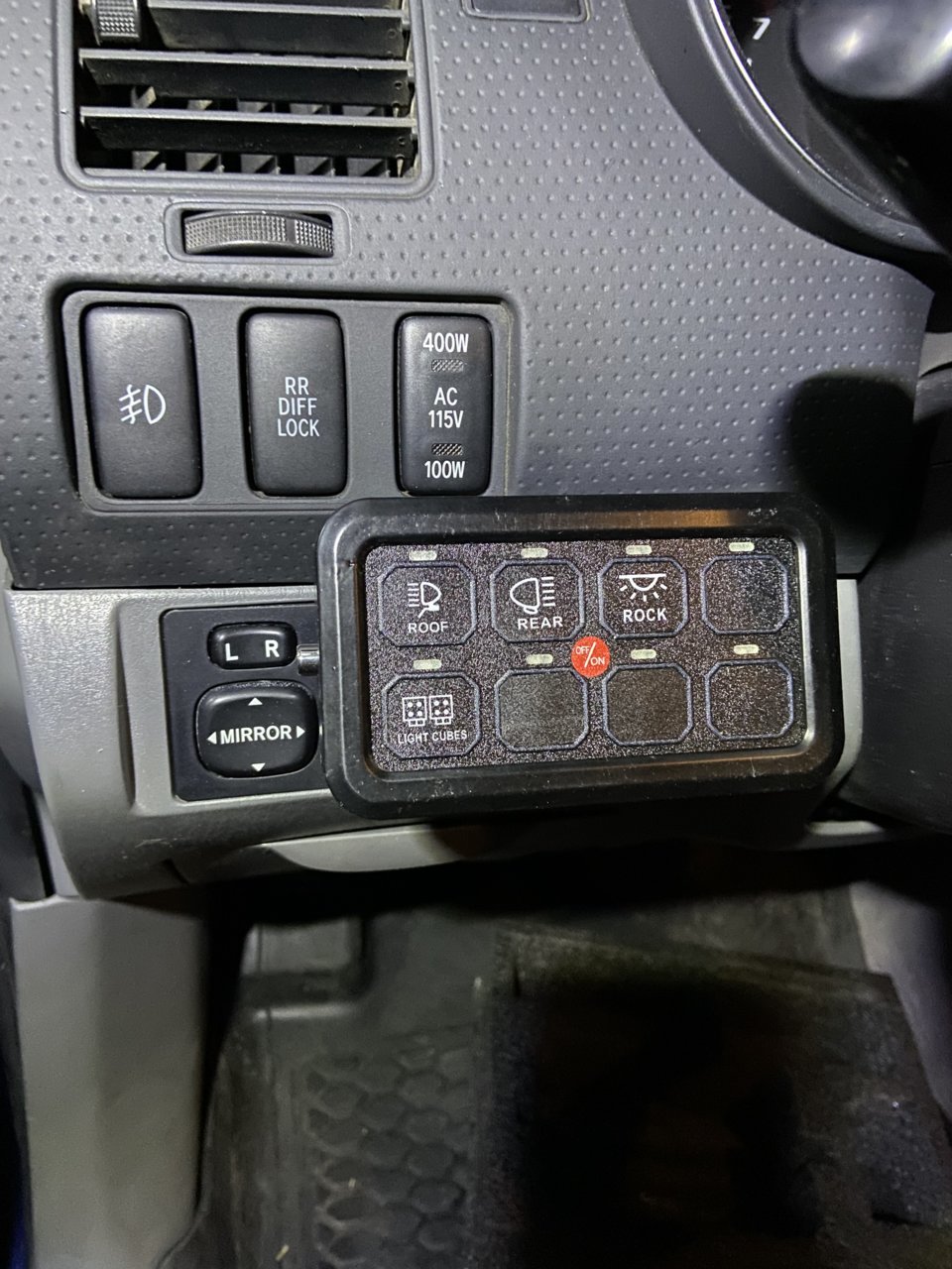

    Installed a budget Amazon switch panel and rock lights.

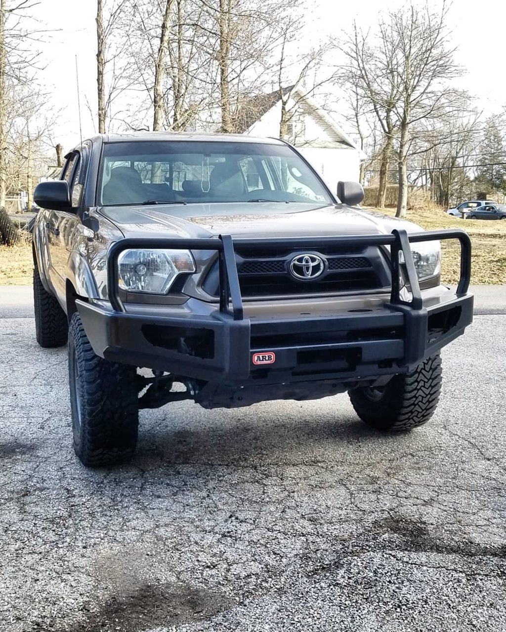

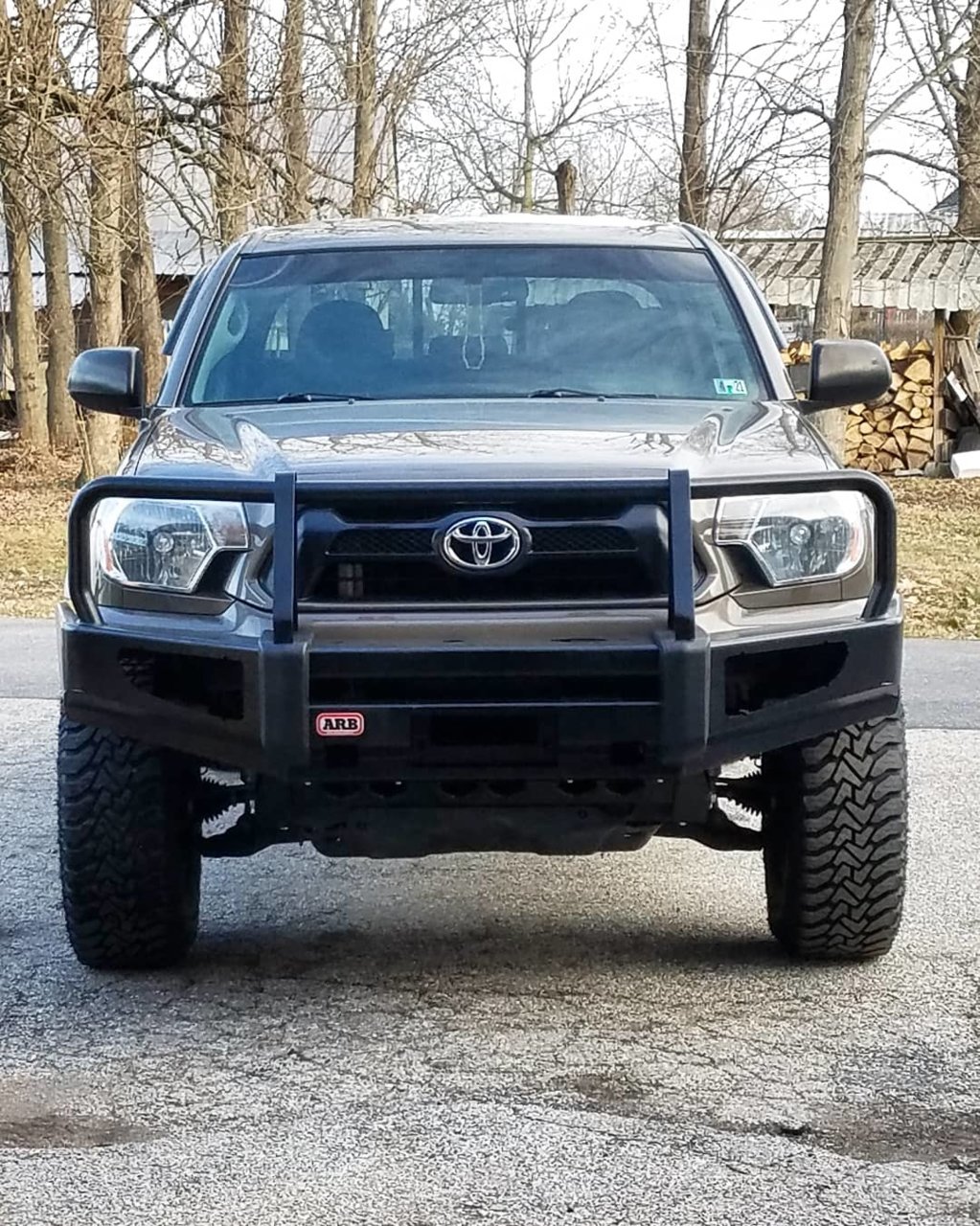

    ARB looks sweet!
