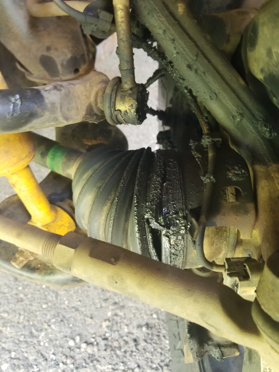

    Definitely reboot/rebuild if they're OEM see if you can find the better aftermarket longer silicone boots and do the slide mod where you stretch the boots out a little and clamp with a hose clamp so the pleates don't rub each other.
    I plan to buy new OEM to replace mine slide mod them, then rebuild my current ones with 240k on them as trail spares.

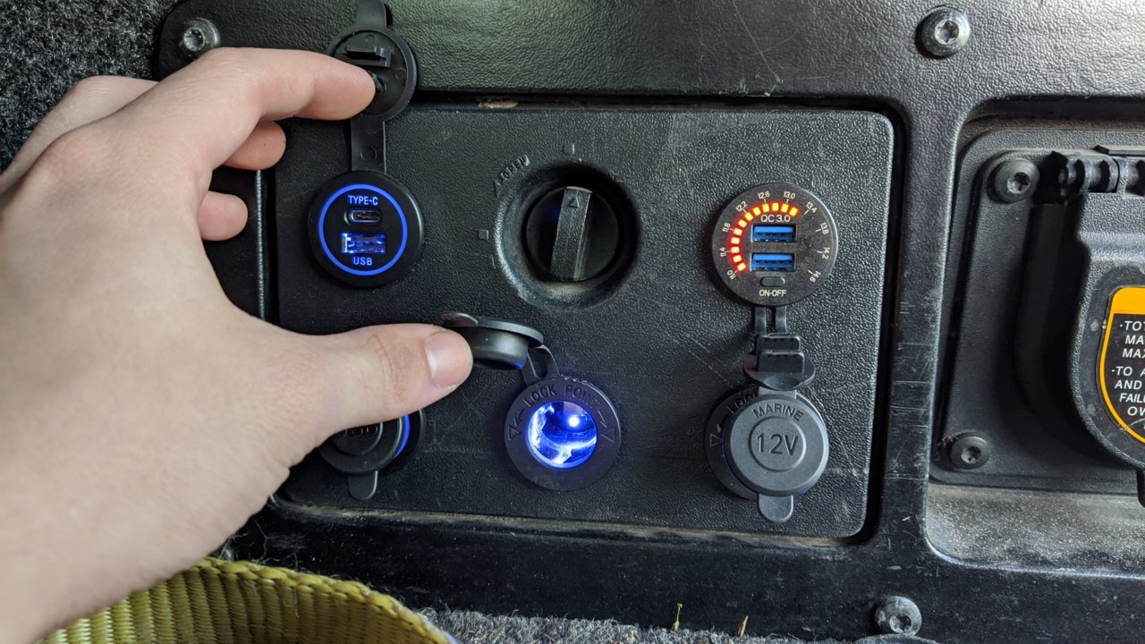

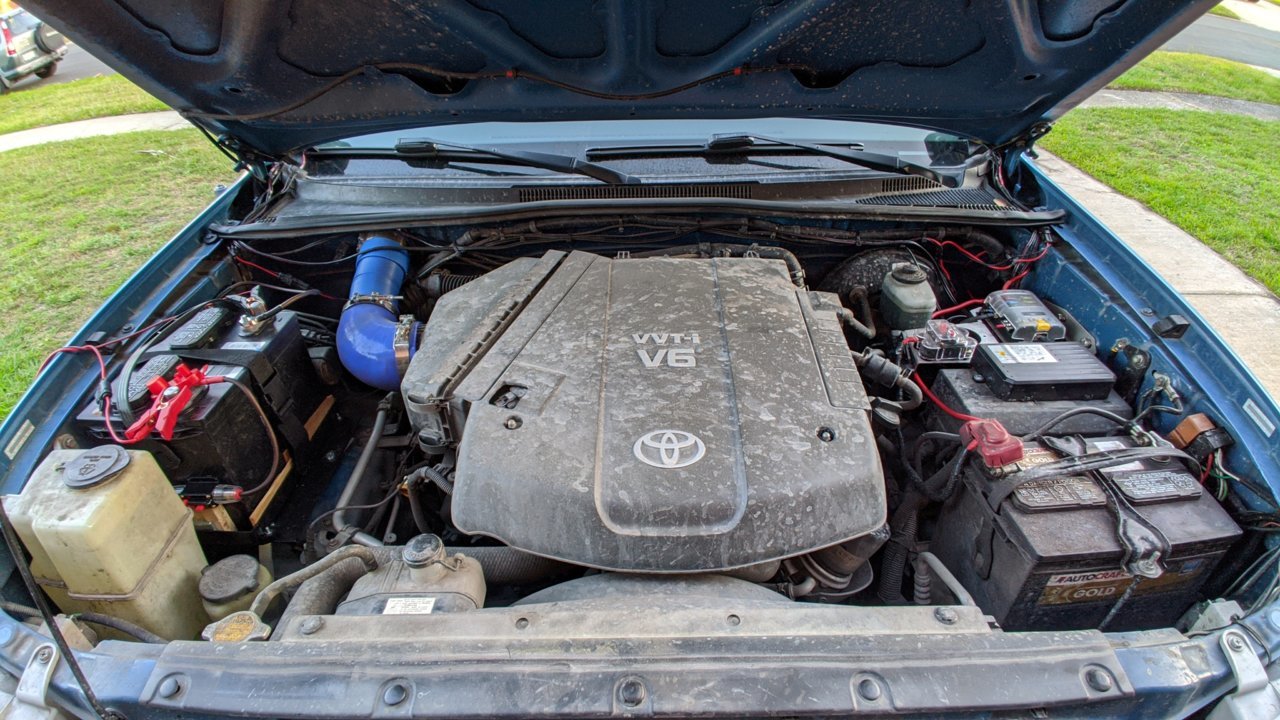

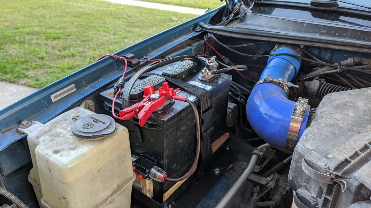

    Started my dual battery setup, I haven't seen anyone else do a dual battery setup like this so hopefully it's because no one has tried it and not that they always burn down... Added a power panel in the rear cubby for charging devices or anything else my heart desires. Have to add a VSR to charge 2nd battery off of alternator charging the first and hook up my switch panel power to 2nd battery for lighting without worry of draining starter.2nd battery.jpg Power panel.jpg Dual Battery Setup.jpg

    I think most people don't because they have the emissions equipment there, I know the 2012+ do for sure.
    My 2010 has a nice battery sized hole there been thinking of putting my 2nd battery set-up there as well like yours.

    It has been a week
    All the grease has not leaked out
    And no vandal got under the truck to inject an ounce of gritty sand with a syringe into the joint
    If it does not click, and does not have any more abnormal detectable play than the opposite side axle, then I personally would put a new boot kit
    $20 for a boot is cheaper than $600 for an axle

    What intake are you running? I've never seen one like that. Looks like you have to do a little cutting

    Cowl induction snorkel, you can see the thread for it here "https://www.tacomaworld.com/threads/cowl-induction-snorkel.525314/". Requires 3 holes to be cut but all in all takes about 30 minutes to do.

    Looks like a pretty typical cowl "snorkel" has the benefit of cleaner air given the intake is no longer pulling from the wheel well but it can still intake water if it comes over the hood and there's some negligible restriction drawing from there but the benefit of not having a snorkel on your fender if you don't want that.

    Why toyota abandoned this idea I have no idea. I love it.

    Cost, was deemed unnecessary.
