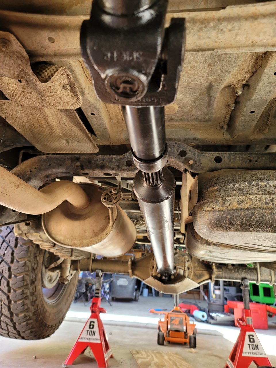

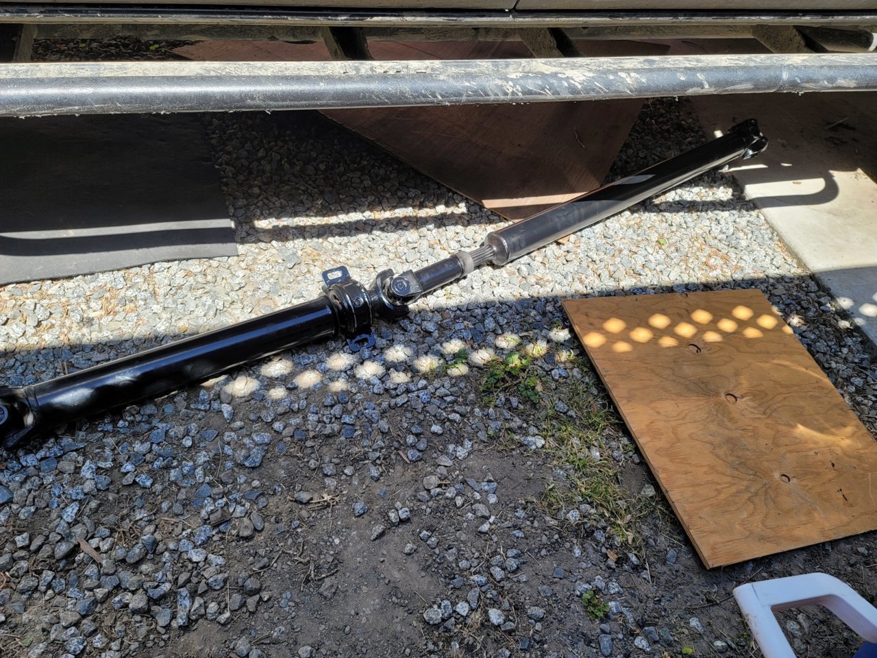

    No center support?
    What shaft is that? Dobinson?

    Looks like you need a fuel tank skid.

    It's from ecgs

    I do. I had a pelfrey one I bought off a member, buy gave it to my friend with an offroad model because he had the correct gas tank straps and I didn't want to mess with getting those, plus it was heavy as shit and I didn't think I needed that much beef there. I'm already very heavy.
    Was looking into this:
    https://trailtoys.net/products/uhmw-gas-tank-skid-plates-2005-plus-tacoma-dcsb-and-access-cab
    Anyone got feedback on it?

    You talking about the carrier bearing? Not following on center support.
    Photo of the whole thing below. The rear propeller shaft was built from scratch (thicker gage steel, smaller diameter, and longer splines). Got new u-joints all around, but kept the rear/front flanges, carrier bearing, and front propeller shaft. It was built at a driveline shop in my area.
    Now to remove the rear drive shaft, all I need to do is disconnect the rear flange and pull it out. I don't need to separate it at the u-joints and carry a u-joint tool to put in a spare; or carry a spare of the entire rear driveline to avoid the pain of u-joint disconnection/connection. I'm going to have him build me a cheaper spare too. To do a trail repair it will be four bolts, pull out, grease, put spare in, four bolts, torque, and done. 20210409_122839.jpg

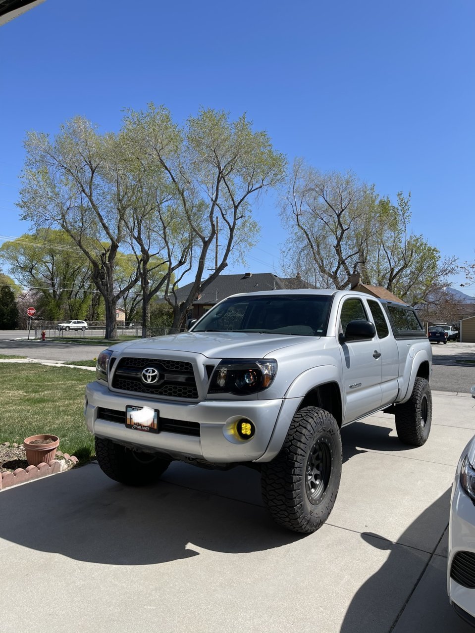

    D2D6D35E-63EC-43DC-B3C9-AC57A22C68F5.jpg 1294DF1D-A0D6-4513-A7AB-6CC25CF4ED83.jpg
    Just got done retrofitting my headlights today

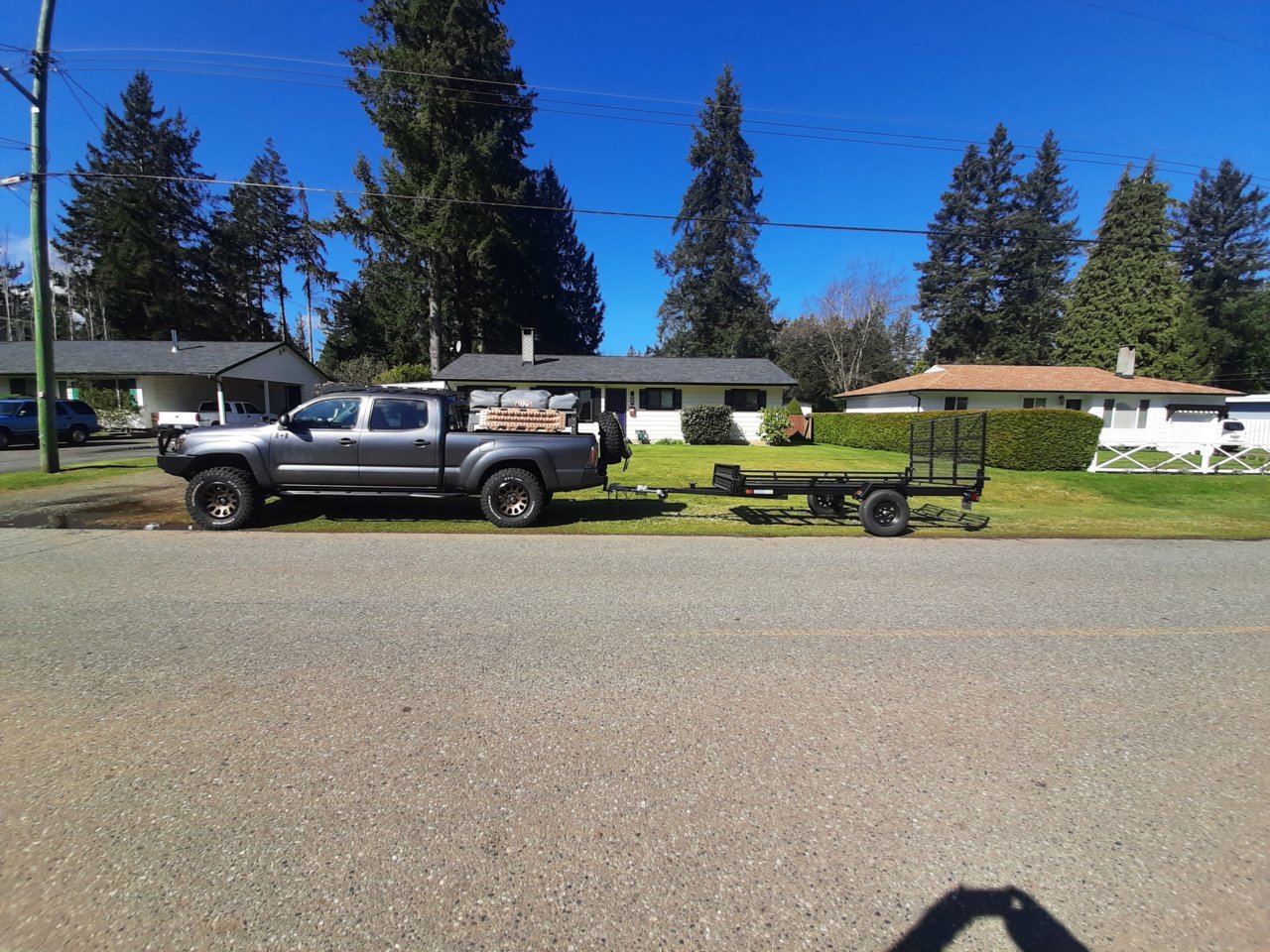

    I picked up a trailer to haul my ATVs around.
    Rear is sagging because I have my deaver leafs in the bed still

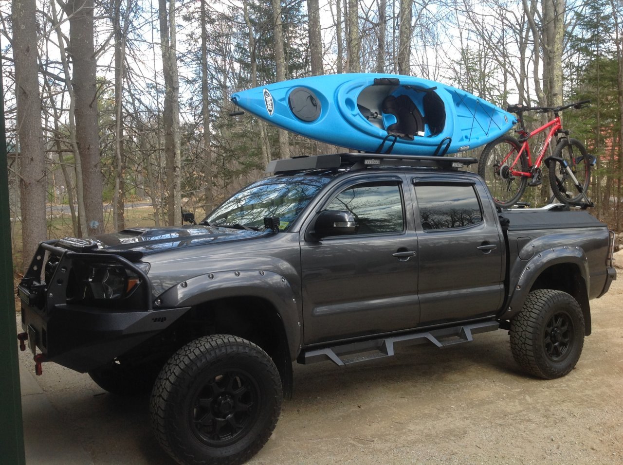

    Installed my bike and kayak racks to make sure it all worked together camping trip soon.IMG_2110.jpg

    Nice! I’m looking for a new bumper where I can use my current hitch. Can you use it with this bumper?

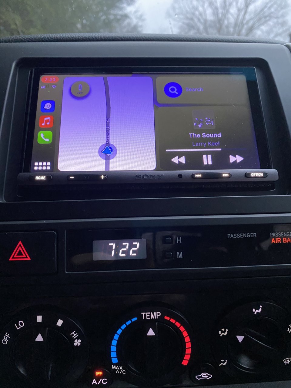

    I put a new grill in today and a new stereo and wheels in last week. I’ve had this 2012 DCSB for 6 years. Just paid it off and fixing things that were going bad or didn’t work.
