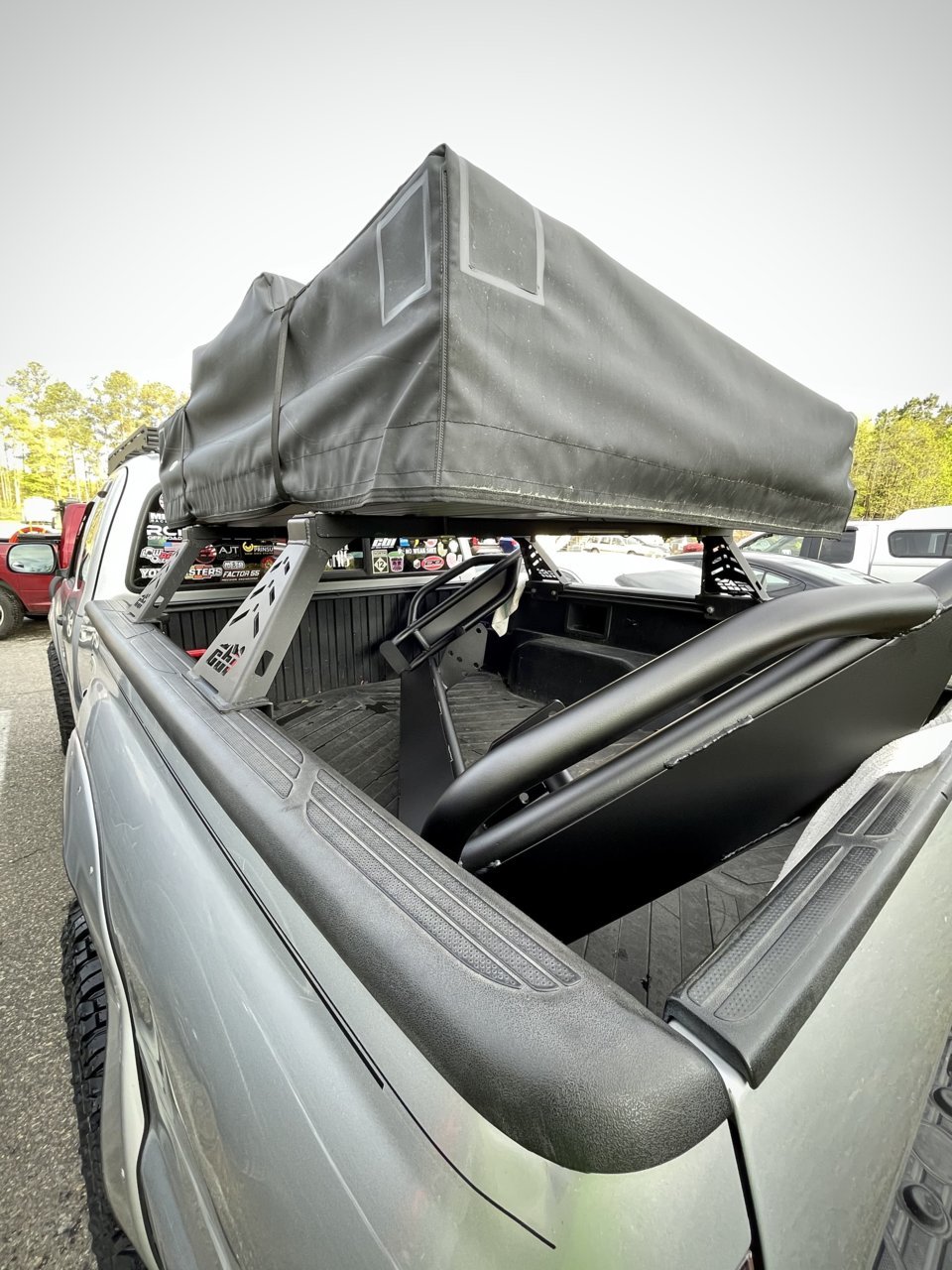

    Just a tip, instead of hacking it straight off cut about 2" below where you need to then heat up the paint a touch (just hot enough to touch for a few seconds don't burn it, use a heat gun on low or a hair dryer) and carefully fold/roll that section up to the point you need it makes a much nicer cleaner edge and hides any unevenness in your chop.
    Thanks to @Brian422 I believe for the idea, if it wasn't him it was his truck twin.

    That’s actually an awesome idea. I could use a little bit of cleanliness on my bedsides lol. I appreciate that.

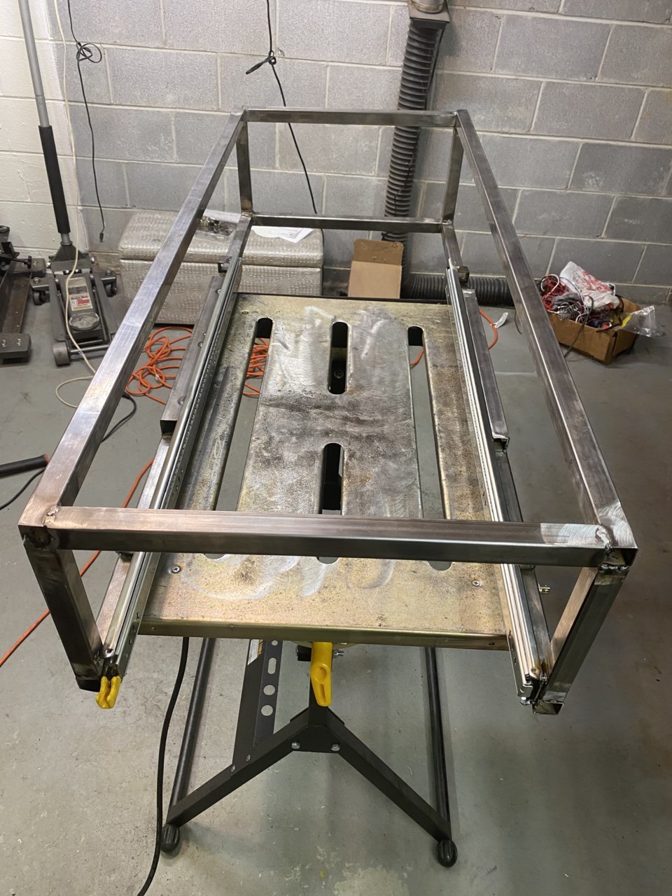

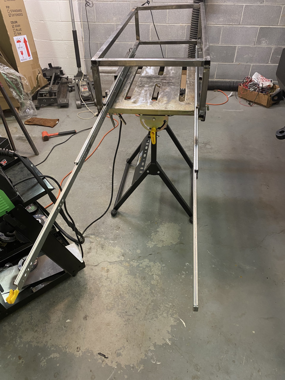

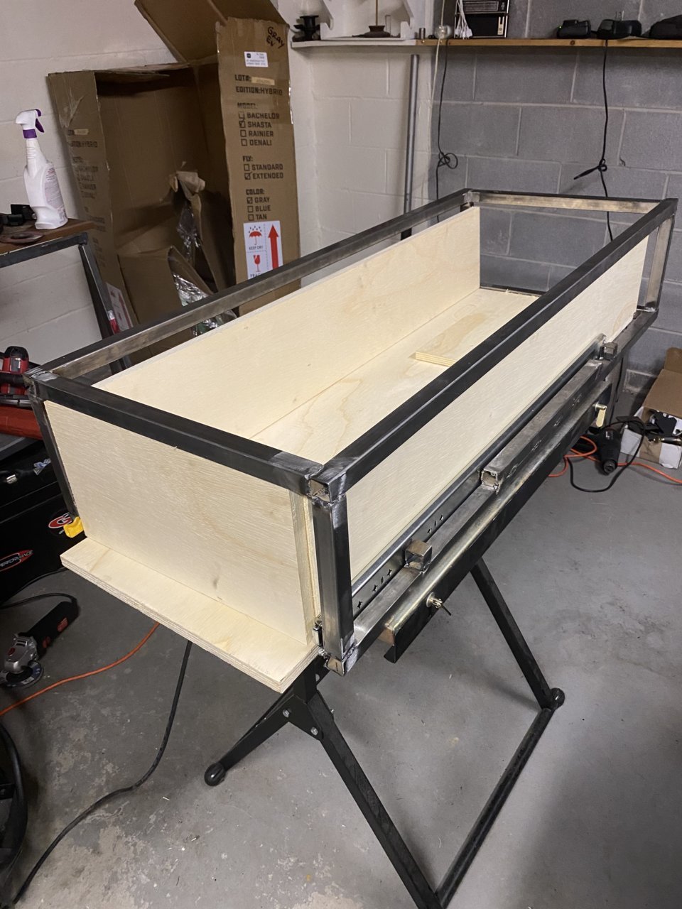

    Made progress on my drawer system. Frame made from 1/16 steel tube and drawer is going to be made from 3/4 inch sanded plywood. drawer not nailed down yet.

    Or cut straight? :rofl:
    It’s pretty easy to get a nice straight cut across the rear fender with an angle grinder.

    It pertains to a cleaner edge, instead of having a cut edge it will be smooth.

    Phew man, there's no way I would be able to roll the sheet metal well enough to look better than a straight cut. Sheet metal can be a motherfucker.
