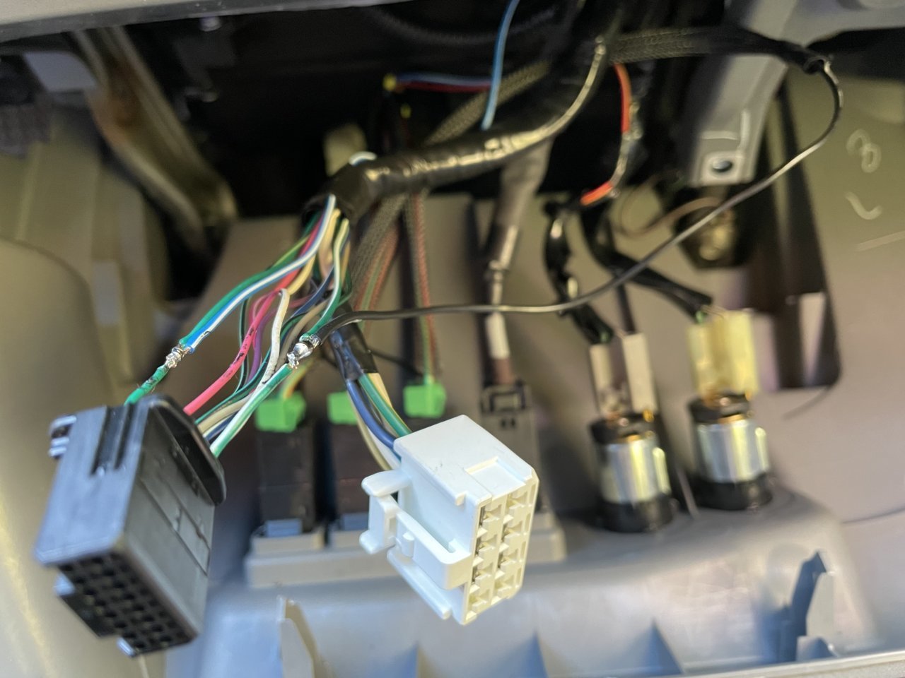

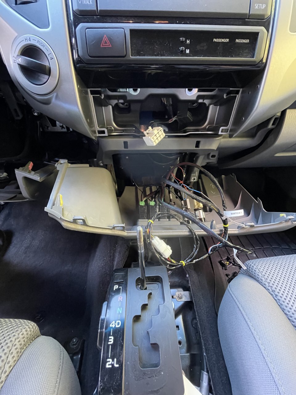

    There’s a saying- “We do it nice cause we do it twice”. On the way to work this morning, I discovered that I wired the dash illumination to my new switches wrong. They were full brightness!! I forgot that the dimmer controls the ground for the lights (green wire w/ white stripe). I knew that already - but when you start getting old, you start forgetting things. Pisses me off. :mad:
    Anyways I had to disconnect all the black wires for the CH4X4 switches from the ARB harness & wire them to the green w/ white stripe wire in the center dash. GTG now.

    you were able to take the lower center console part out without removing the radio and trim around the radio?
    Just the cubby and the glove box?

    Removed center console. Unbolt & and lift out lower part of radio surround. Break loose lower valance below steering column. Remove metal bracket behind that. Then lower center dash can be removed. Its a lot of work.

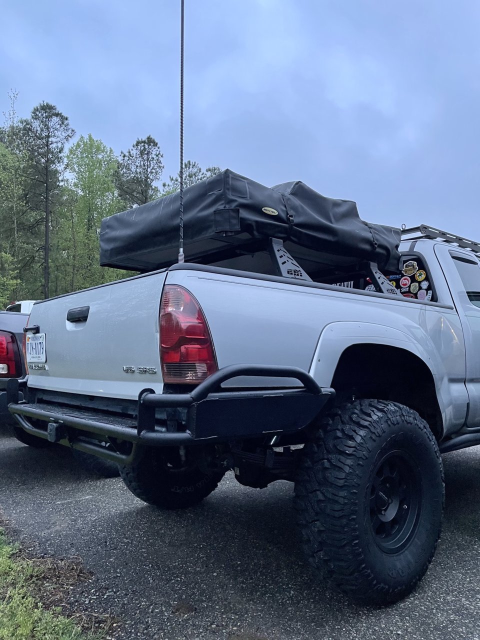

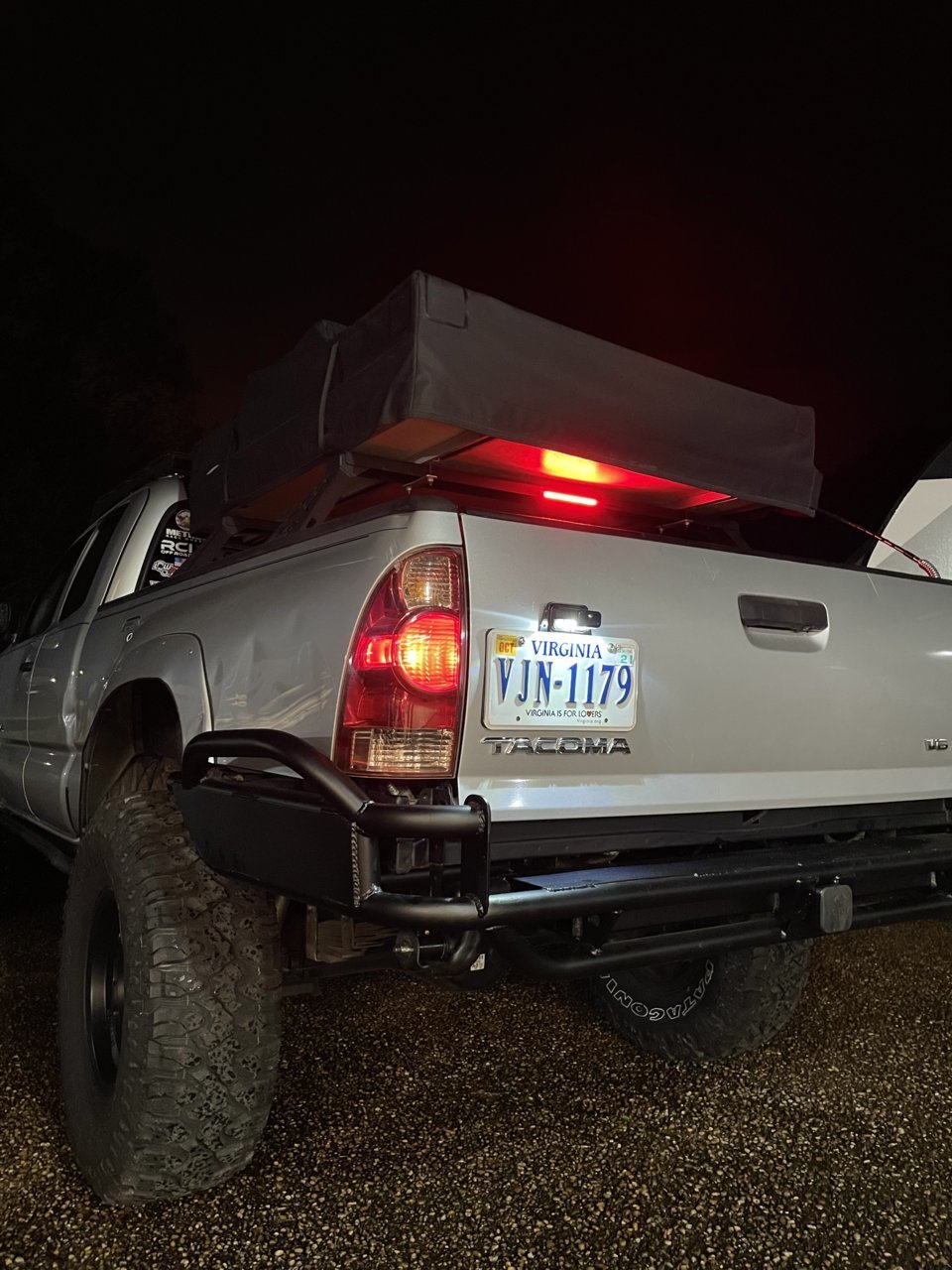

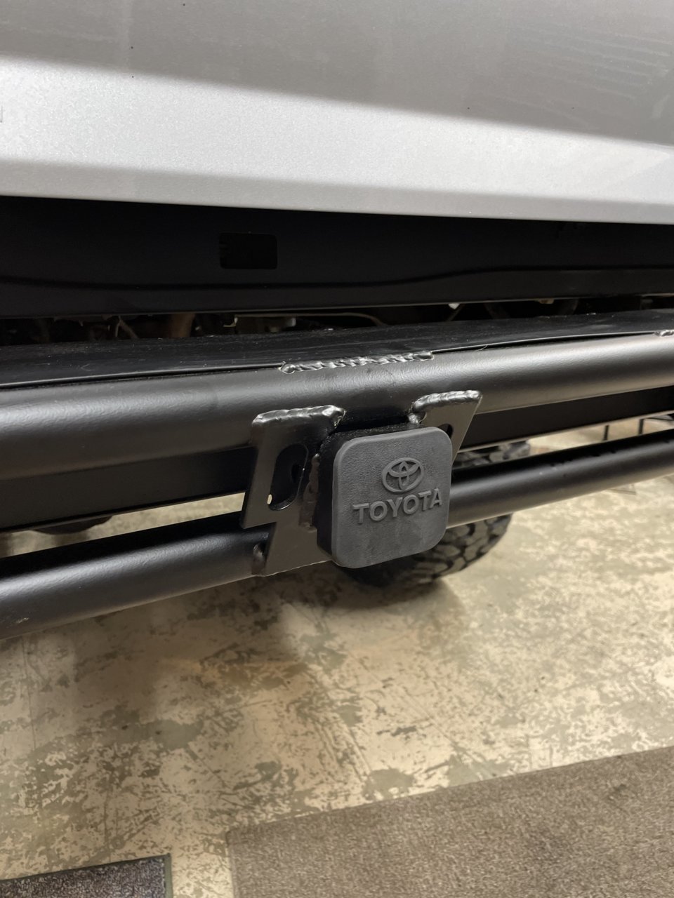

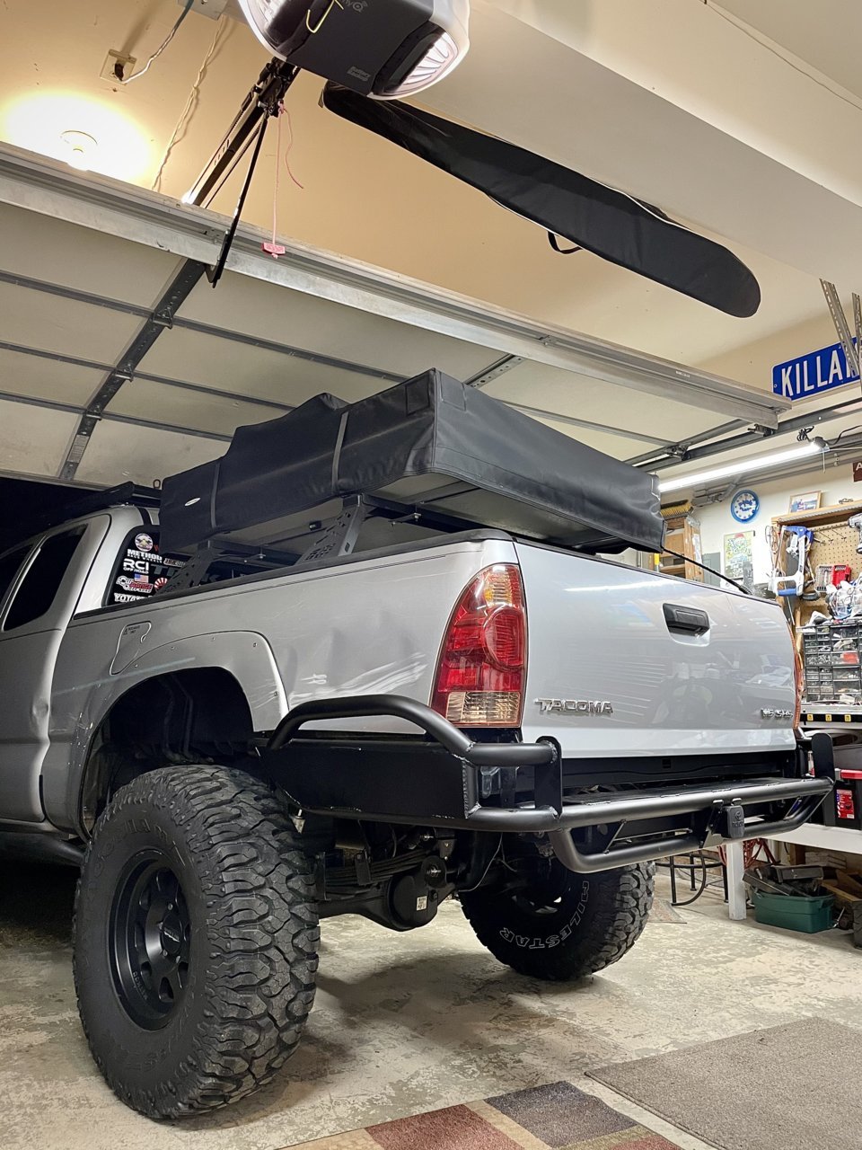

    Got the bumper on tonight. I was over thinking a way to mount the bedsides in order to prevent them from flapping and a friend came up with a great idea while we were texting about it. Left a tab from the original bedside behind and tapped it into the wing on the bumper. Very solid hold. Still have some adjusting to do and mounting of the license plate but so happy with the way it looks. Such a solid piece.

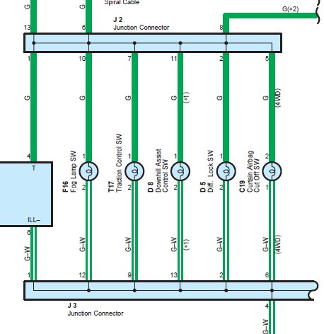

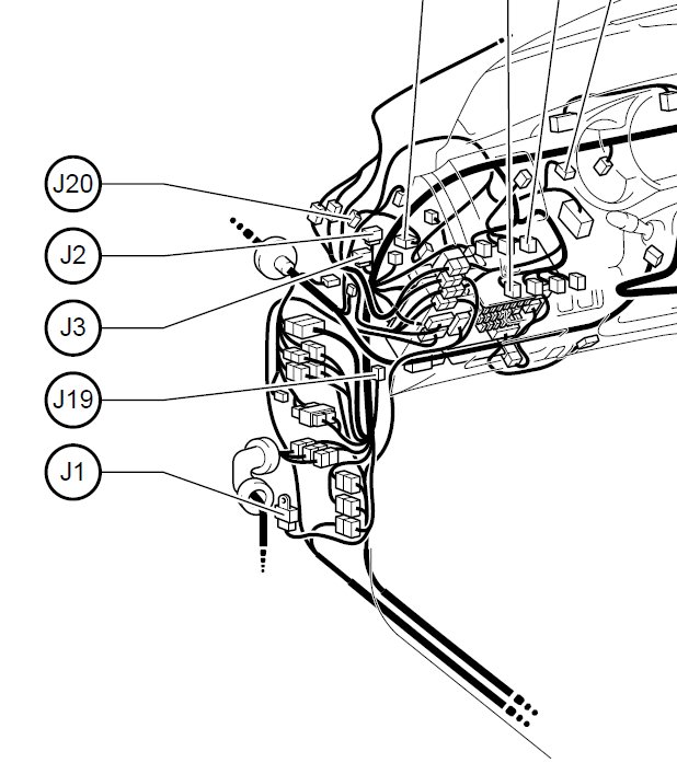

    There are two junction blocks (J2, J3) where the power and ground side of the illumination circuit are.
    I bought two terminal repair wires and used an empty slot in each to get my switches to light up.

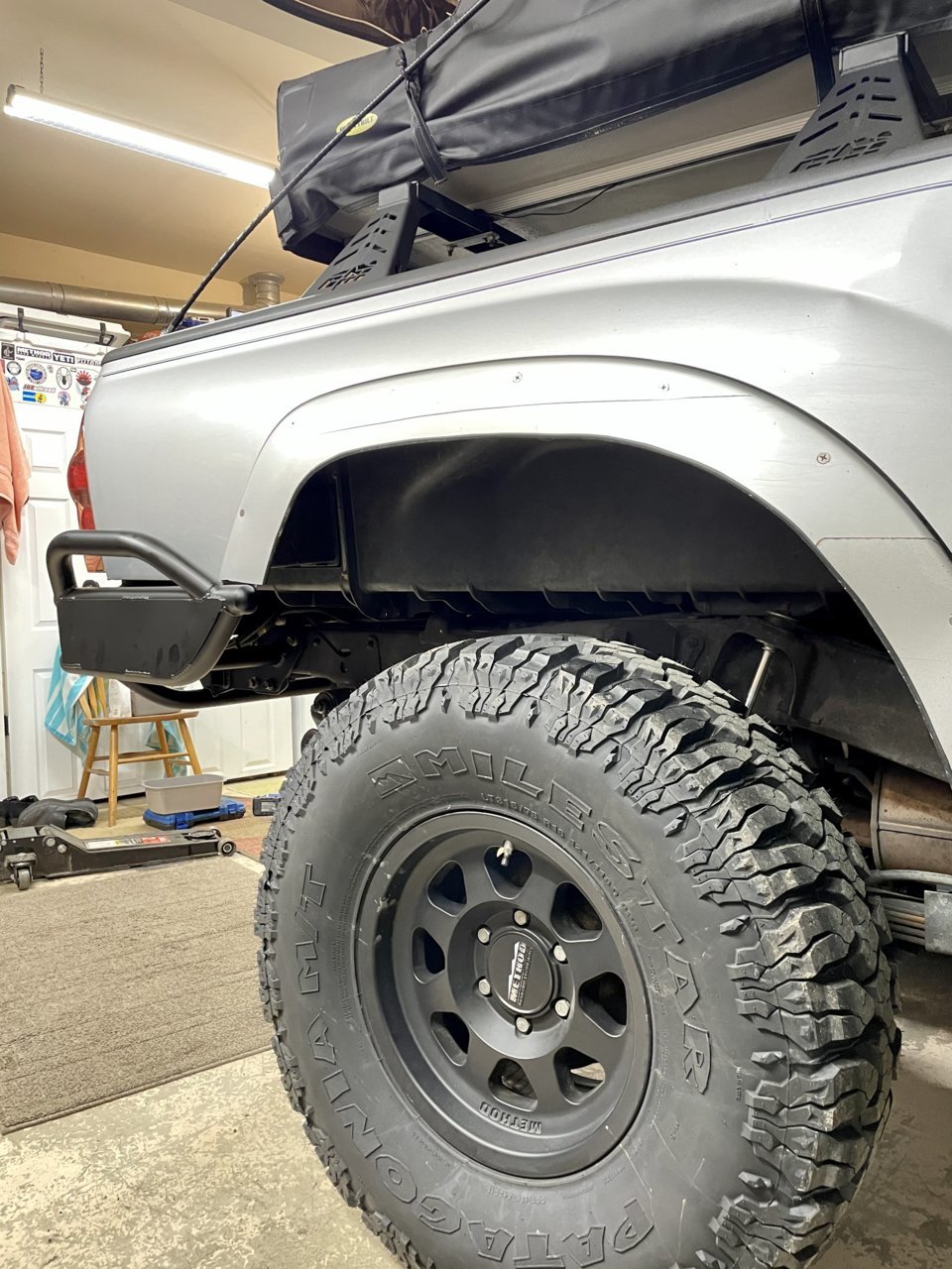

    Got the license plate lights wired up this morning. So happy with this bumper.
