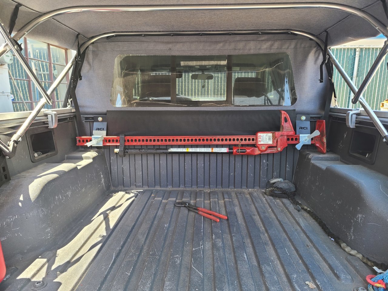

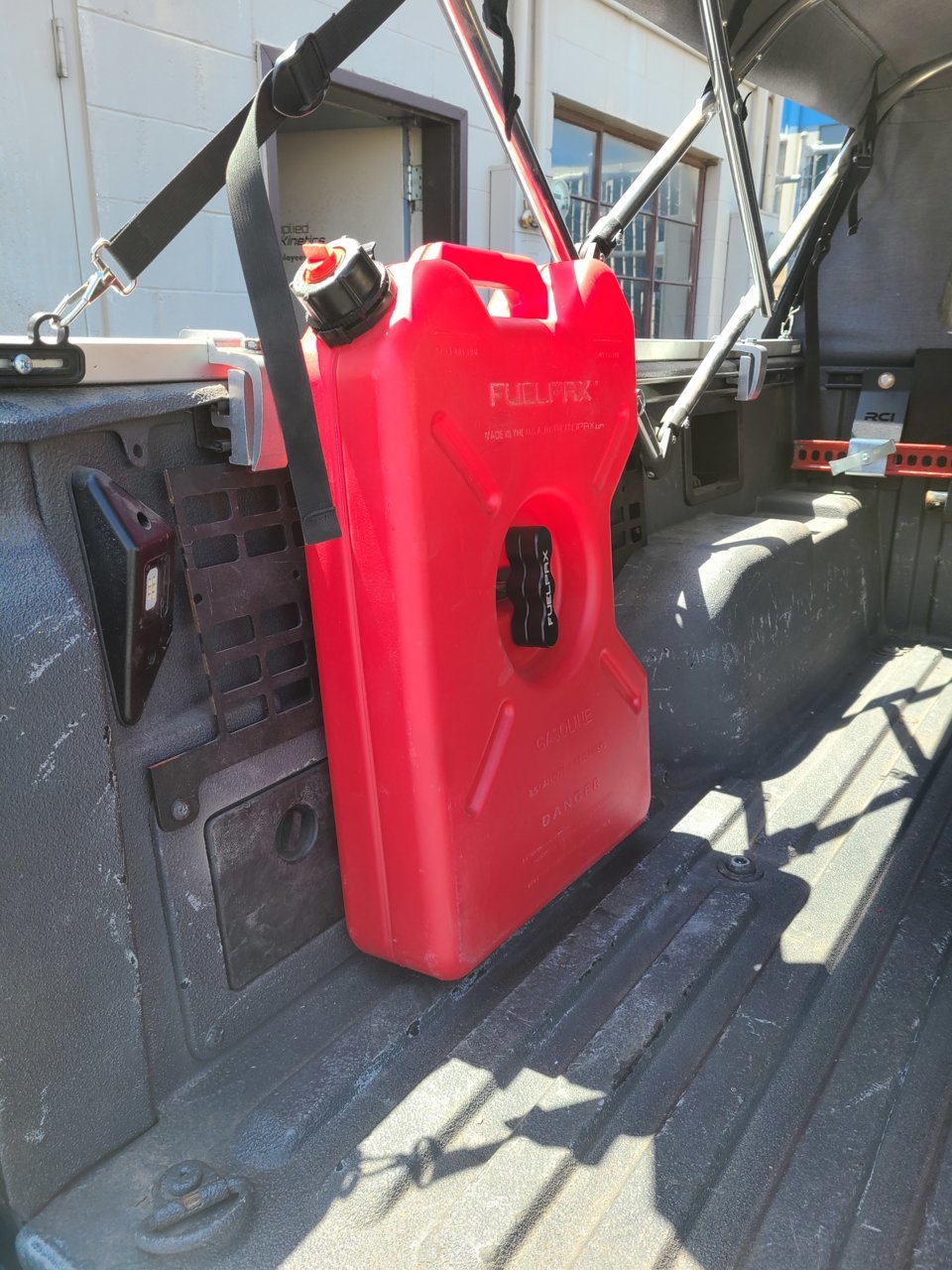

    Installed an rci high lift mount after years of just throwing it in the bed. Had to cut a few inches off the lift to fit it sideways.
    And just in time for a mojave road run this week, finally installed a fuel pax I bought last year on black Friday. Still will bring a Jerry can of gas lashed to the bed though. Don't feel prepared in mojave with just 3 gallons.

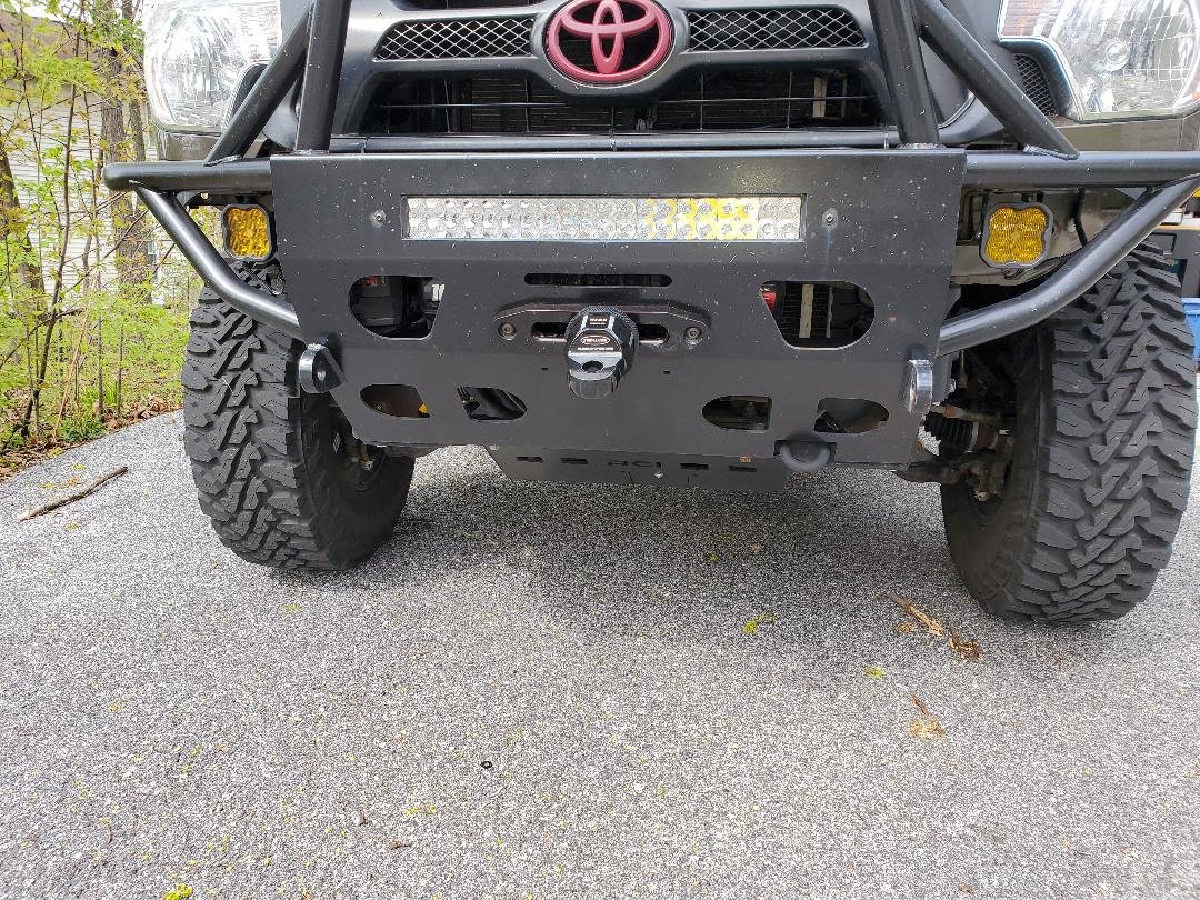

    K&N cabin air filter. Finally got my winch line pretensioned and installed a Smittybilt winch line thimble.

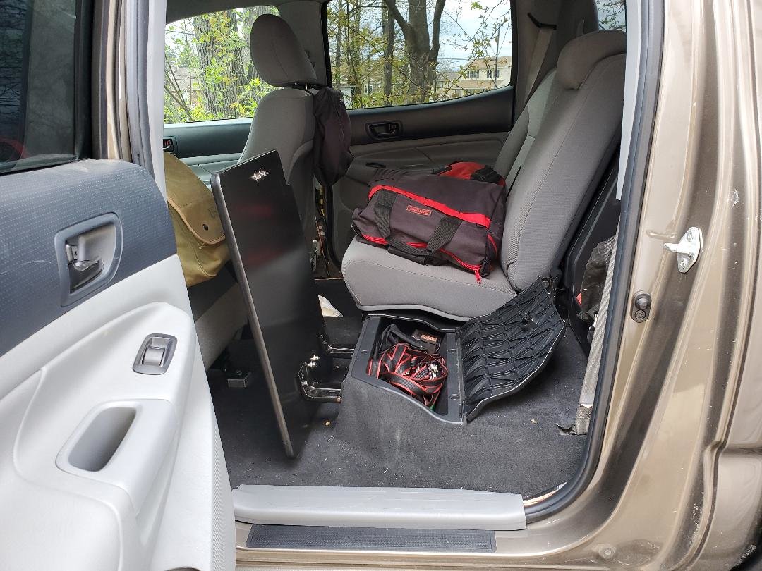

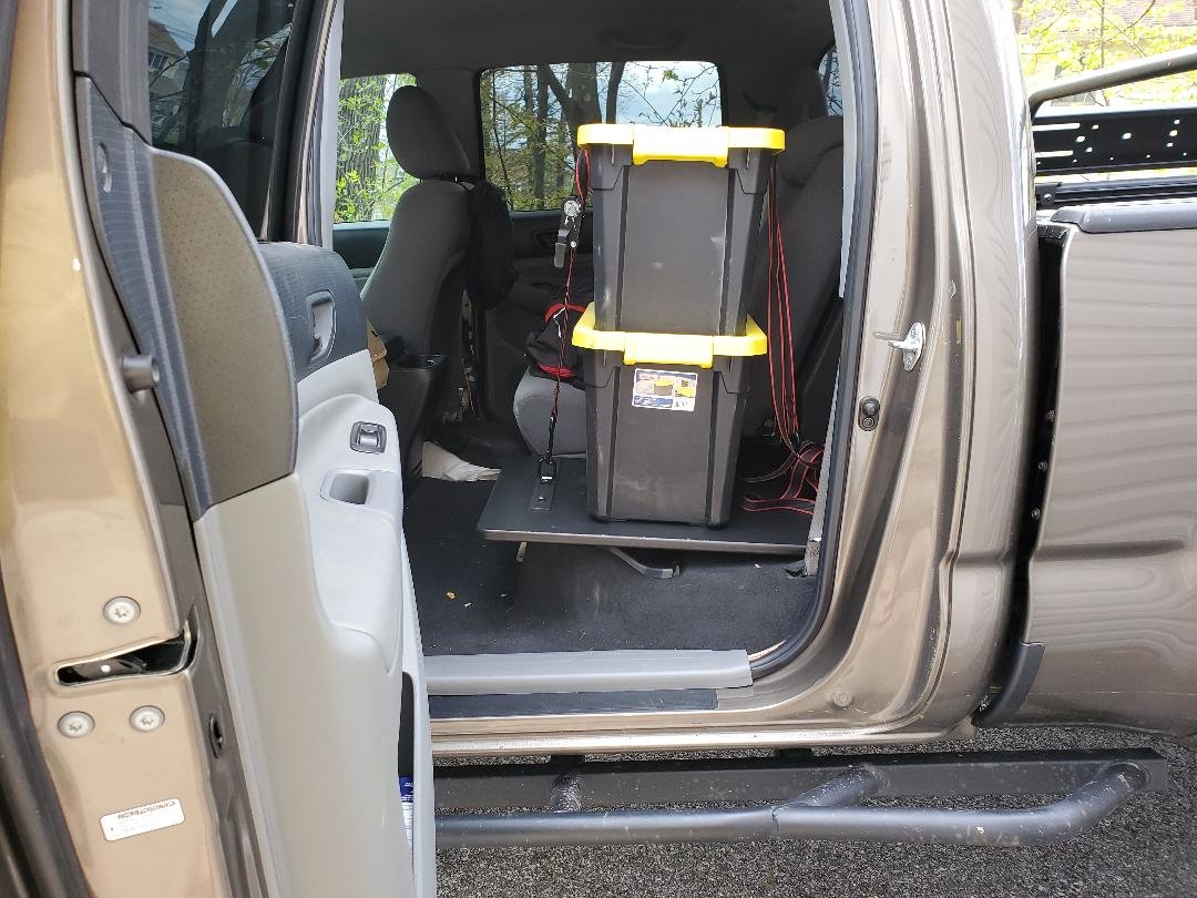

    Also got my platform installed. Mainly built it so I can strap these 2 bins down that I use to carry my noncold foods for camping.
    Used the factory seat hinges so I can still access the factory storage cubby.

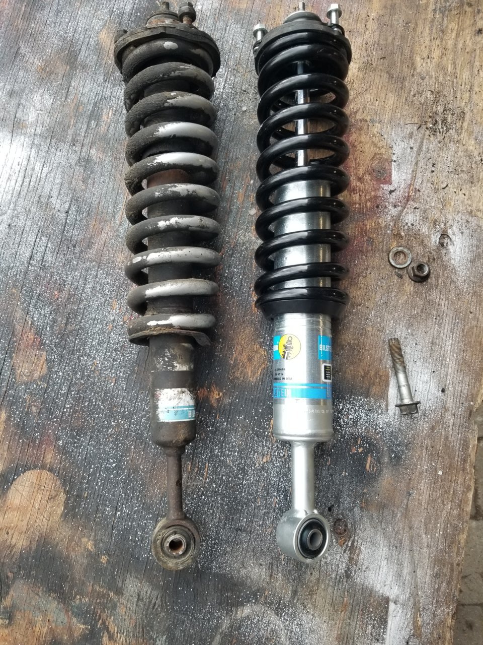

    9 years and 180K Km later, out with the old & in with the new. Galvanic corrosion where 1/4" aluminium spacer met shock hat. Applying lots of antiseize this time around. 16186957822401677281884381888186.jpg

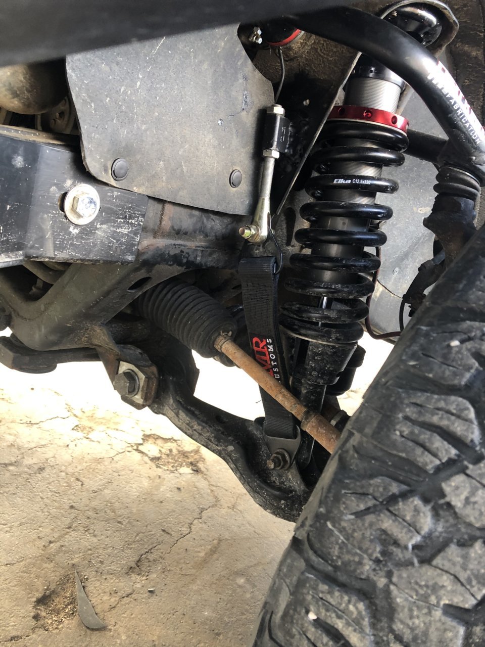

    Limit straps added

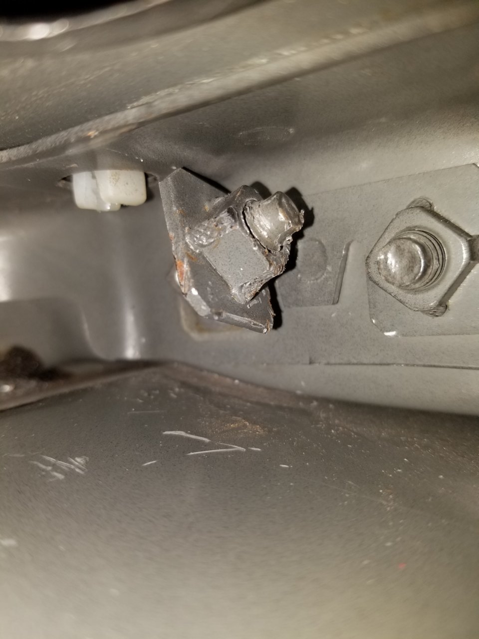

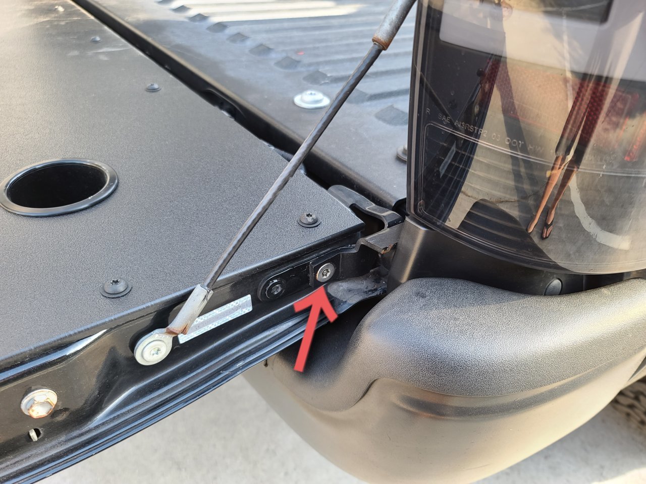

    That screw on the gas cap door was one hell of a stubborn bitch. I had to drill mine out because I later found out it was welded on for some crazy stupid reason. The torx screw on the right side of the tailgate was even worse.
    :facepalm:
    (Inside the gate)

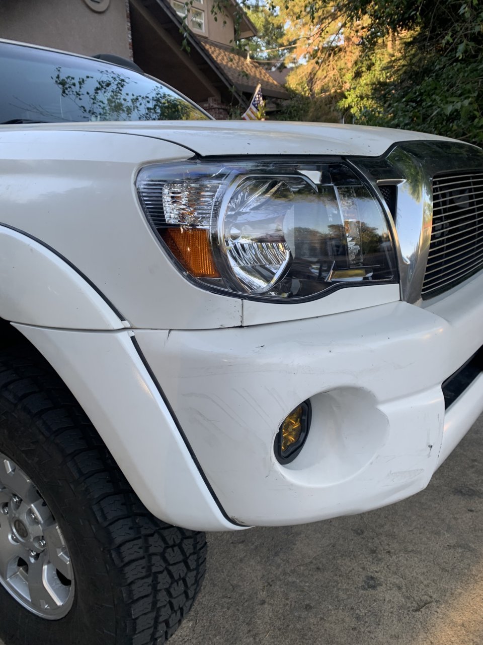

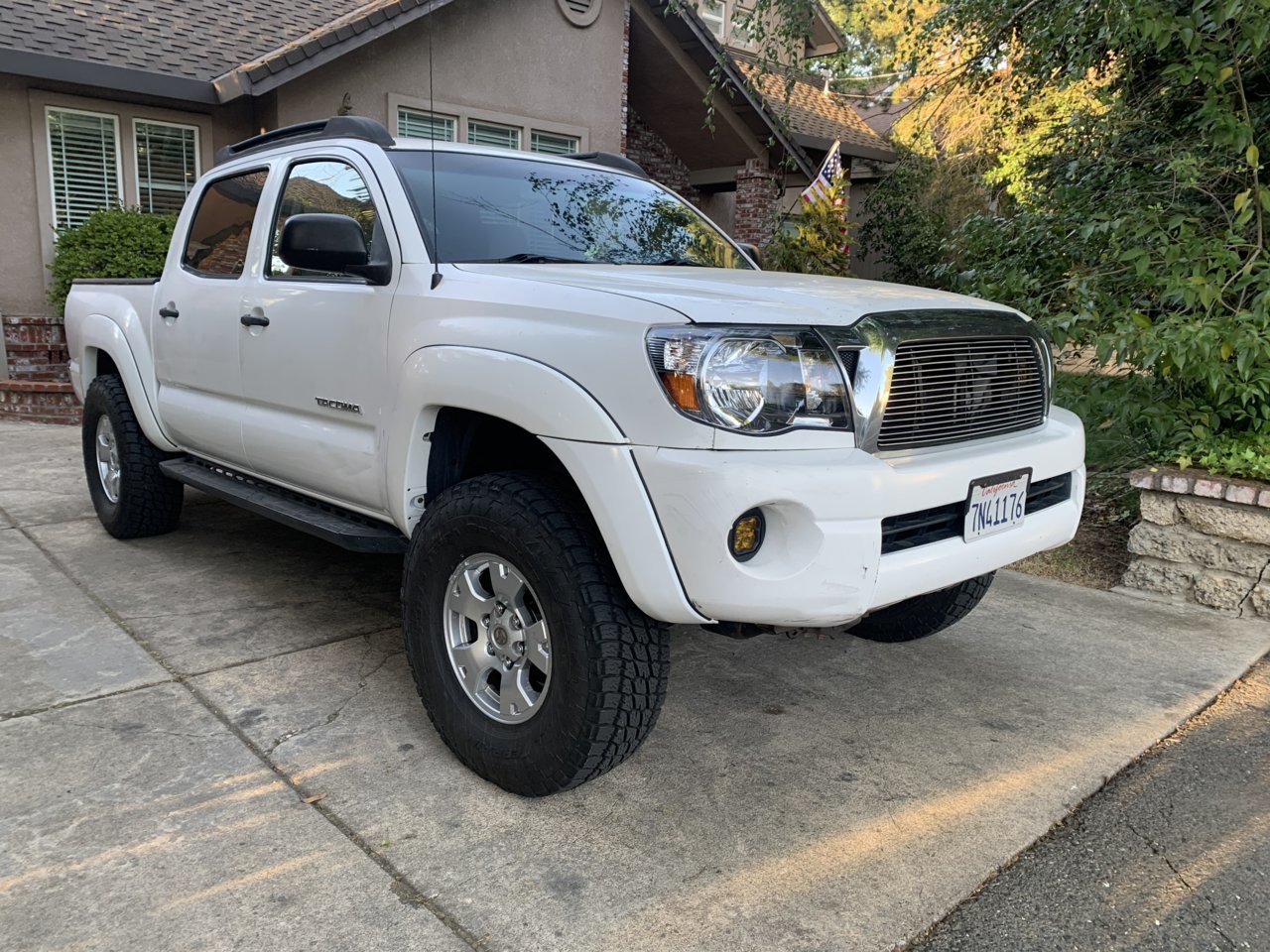

    Boys, the Yota Coma is fixed. After a month without it :amen: 9CB0AA1D-57E2-4690-8F6A-430BAE1B3480.jpg755CE915-79F6-4537-8727-8A329028BB88.jpg59AE2664-90A9-4B6E-B69C-5E18F62B418A.jpg

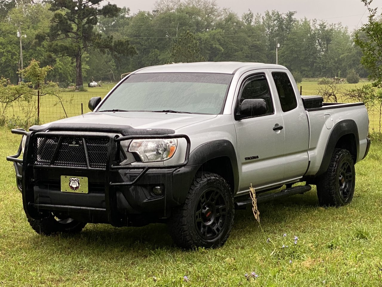

    All I did was take a pic of it today.

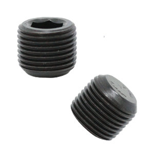

    A small tip that I just thought of. You can get some Allen set screws the same thread as the bolts. You can plug up the hole but not have the bolt head protruding above the sheet metal.
