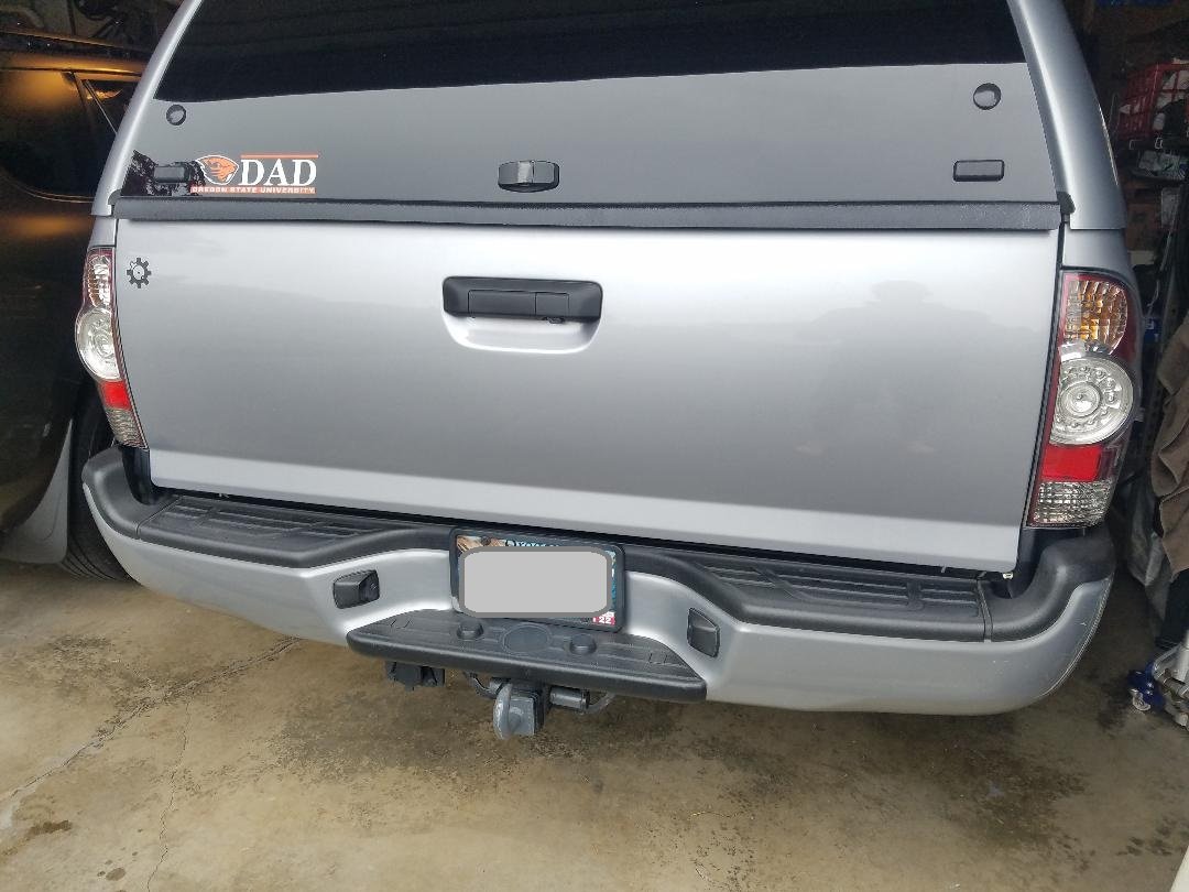

    Today I started to debadge my 2014.
    Pretty simple so far, light heat gun on badge, 30 lb. fishing line easily cuts through adhesive. Then a little goo-gone, Mcguires Ultimate Compound and done. I did order a new set of matte black badges. Will decide what if anything goes back on.
