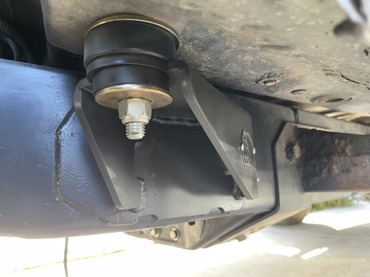

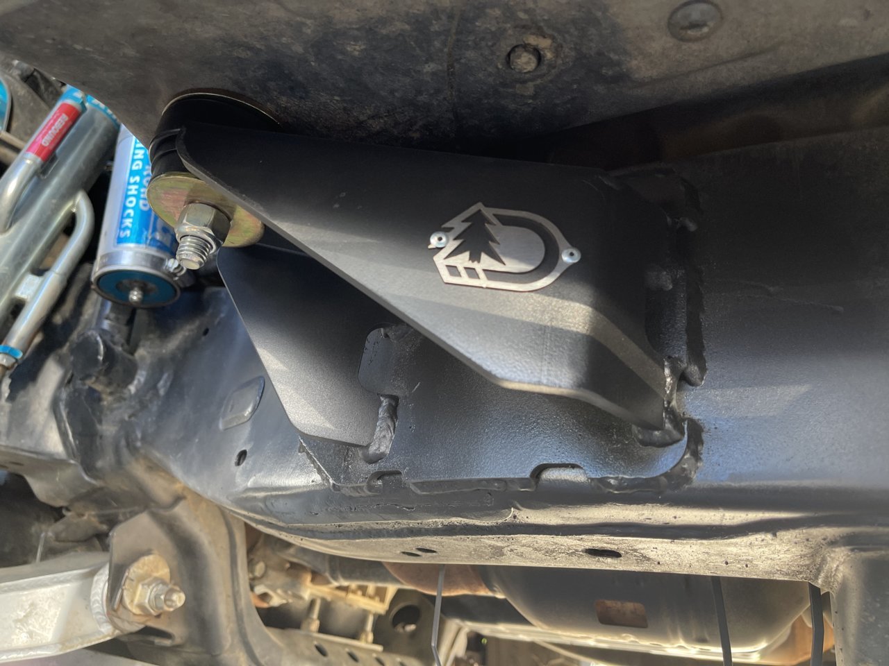

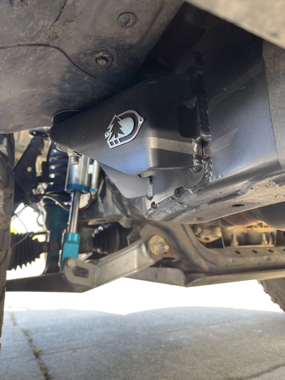

    Update Alpine reached out and last weekend I had the mounts fixed. They added a new much beefier and larger design. One not copied by others. It’s twice the size of the original. pretty sure it was weight of the truck and likely the person who installed it last time ( not 100% but careful to not grind the frame too thin). Welded up and repaired the frame and added a frame plate as well for extra strength.
    Also using new upgraded synergy bushings. Truck feels 1000% better and even sits a bit higher. Possibly they were also mounted too low before.
    3AAA5936-DE7B-41EE-9EED-FFB125AFE621.jpg D0687721-C189-4B93-A4F5-E7A534CFCE8B.jpg FA62BE16-152E-400B-803C-6049F1A8BF6A.jpg

    That was my truck W.E.W. posted and this is the updated mount from Alpine. It's twice the size, fully formed, and more mounting points. It is also wider to help. Def add a frame plate behind it and make sure not to grind it too thin or ensure the shop doing it does not. That likely will help with failure. The other big feedback when chatting is that as our trucks have been getting heavier it needed some revision. Alpine reached out and decided to go up there and have them fix it up and weld new ones. This gave them some R&D time to see the results and weld up a new set. This was not an issue with the mount and they did not install them last time but figured it would be good to have them do the new setup.

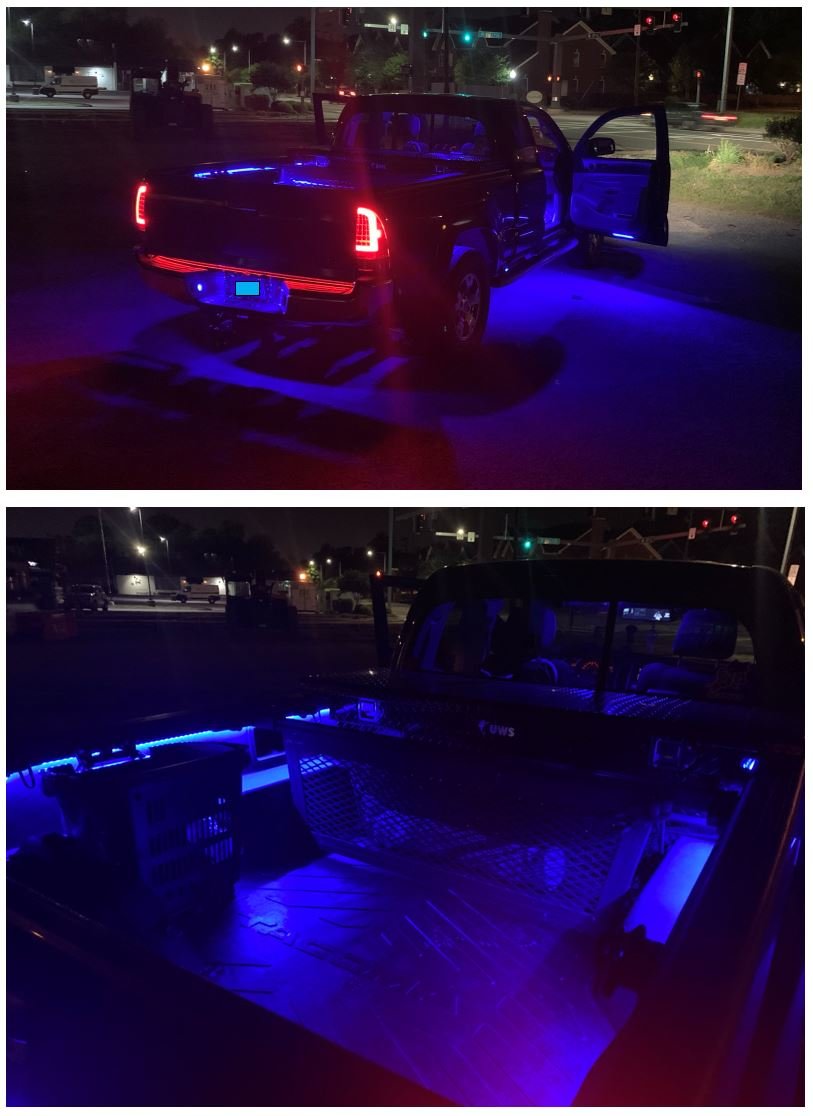

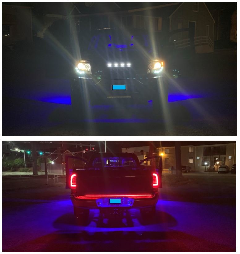

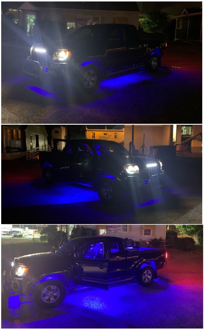

    Had a little fun installing rock lights this weekend;

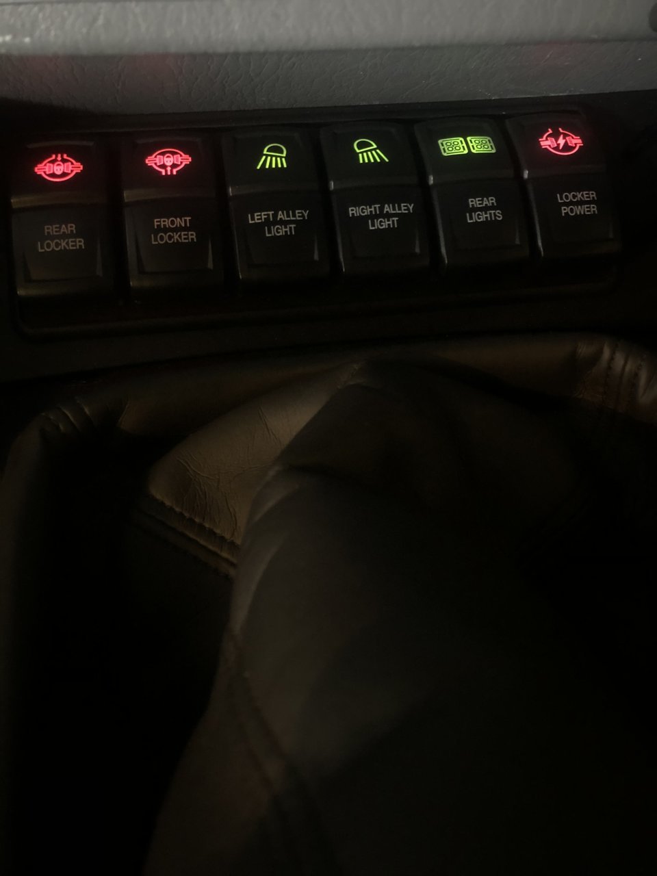

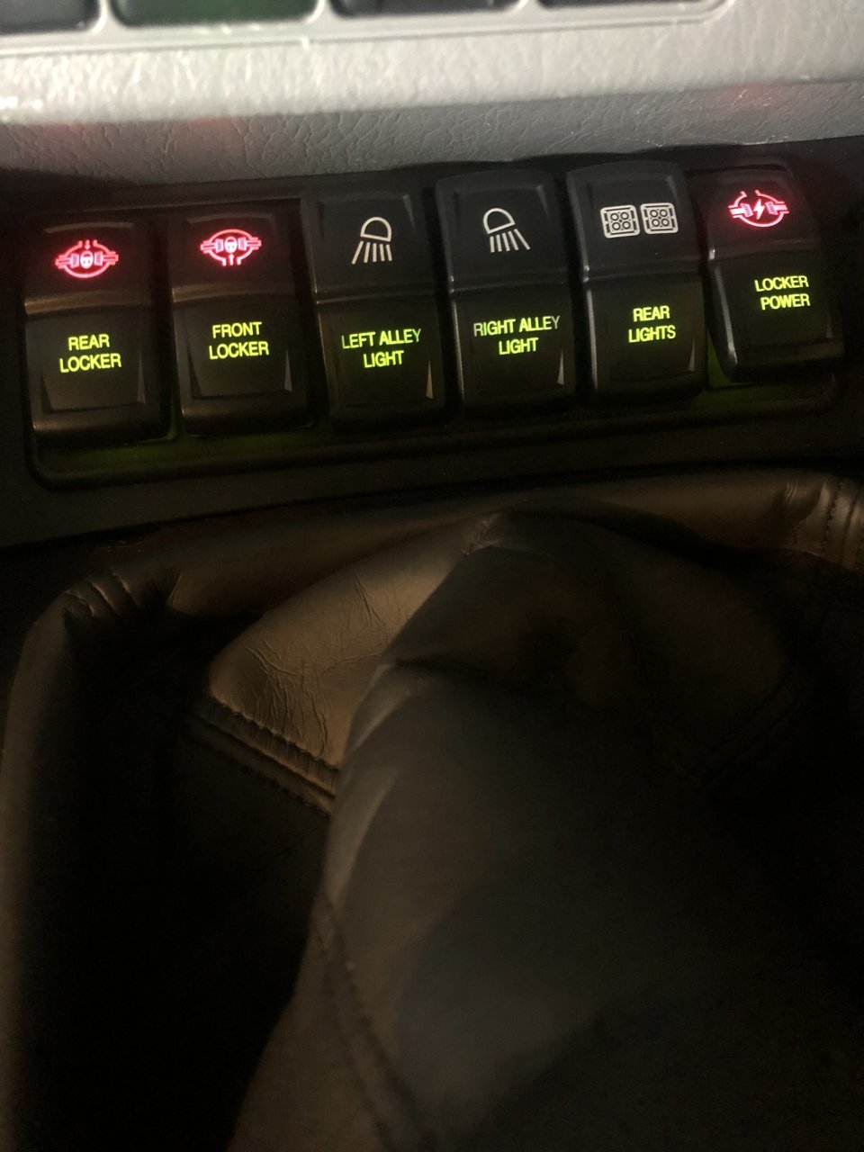

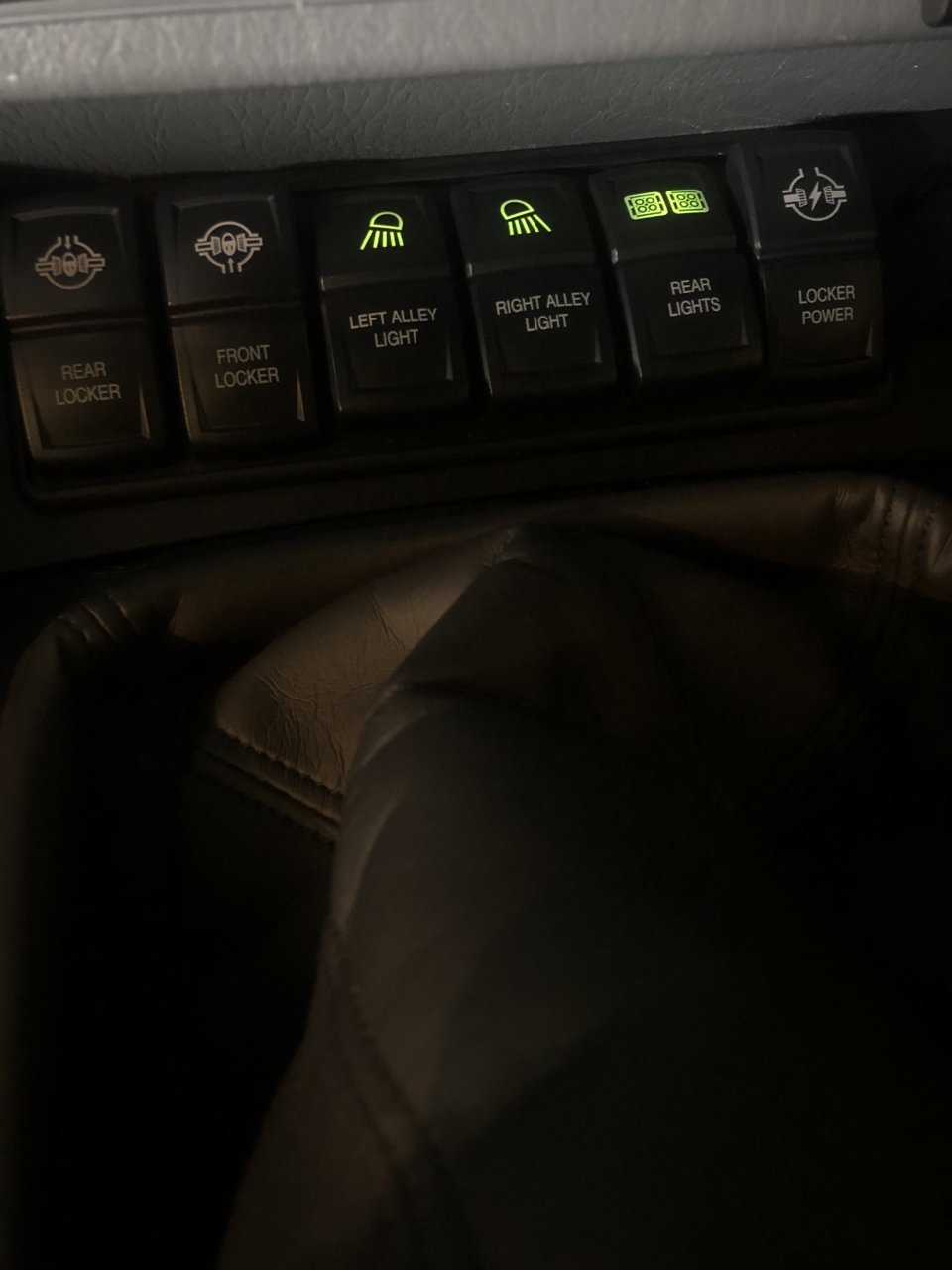

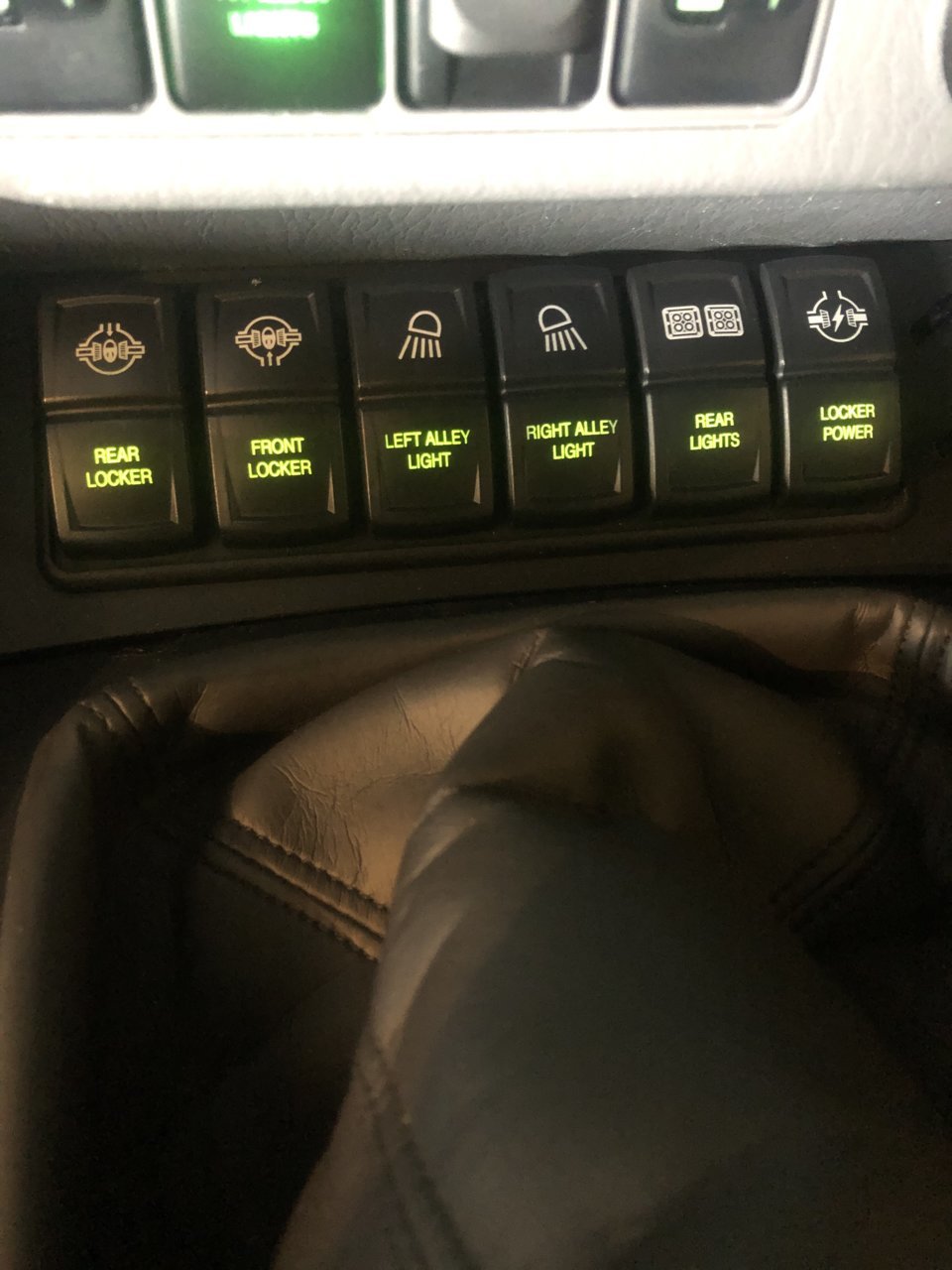

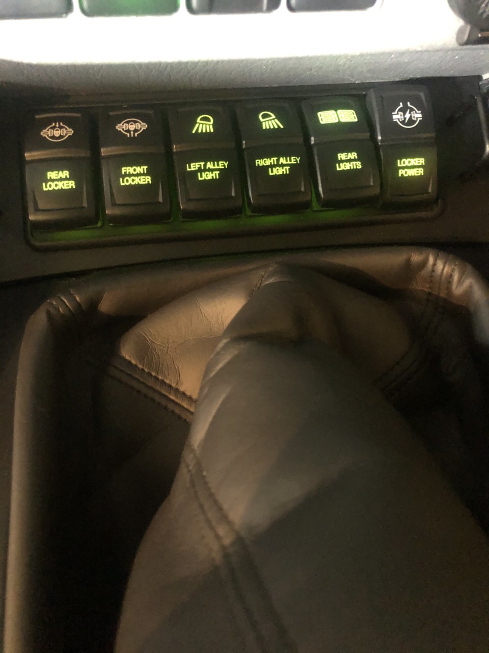

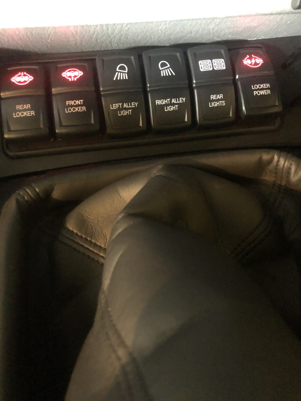

    Finished the in cab wiring for my Iggy switch panel. Lower independent lights so the bottom lights up when I turn on the lights (dimmer wires run to the hvac plug). Upper lights up when the switch is turned on. Wired the front/rear locker switches to the locker power so they don’t accidentally get turned on.
    Back of switch panel
    Lights turned on
    Lights on, switches on
    Lights on, light switches on
    Lights on, locker switches on
    Lights off, switches on
    Lights off, light switches on
    Lights off, locker switches on

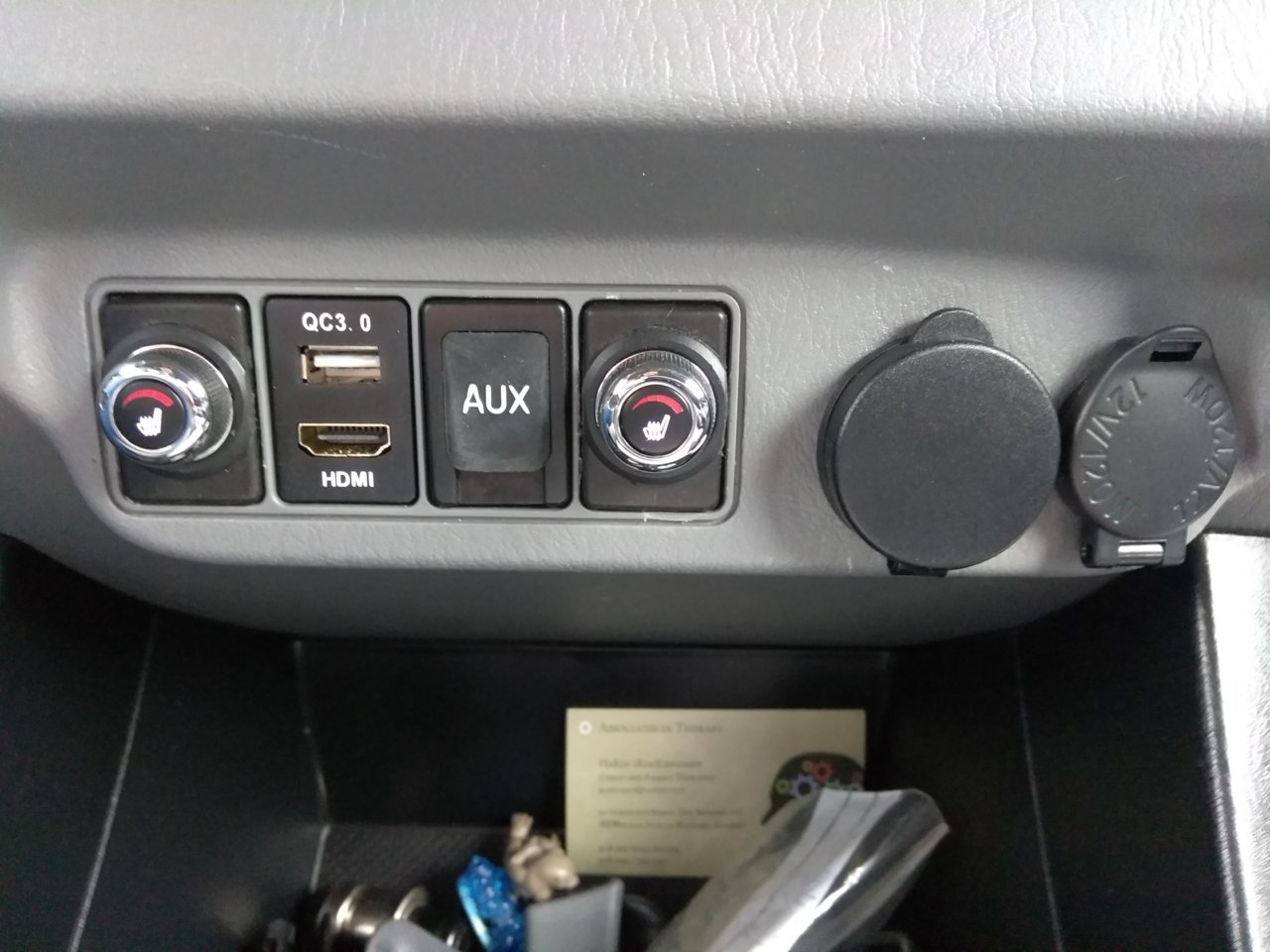

    Finished my new dash! Got the switch blanks from meso custom and ground out the hole for the heated seat switches.

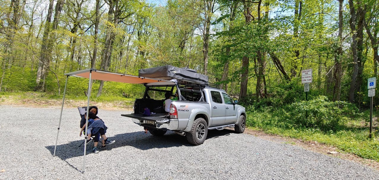

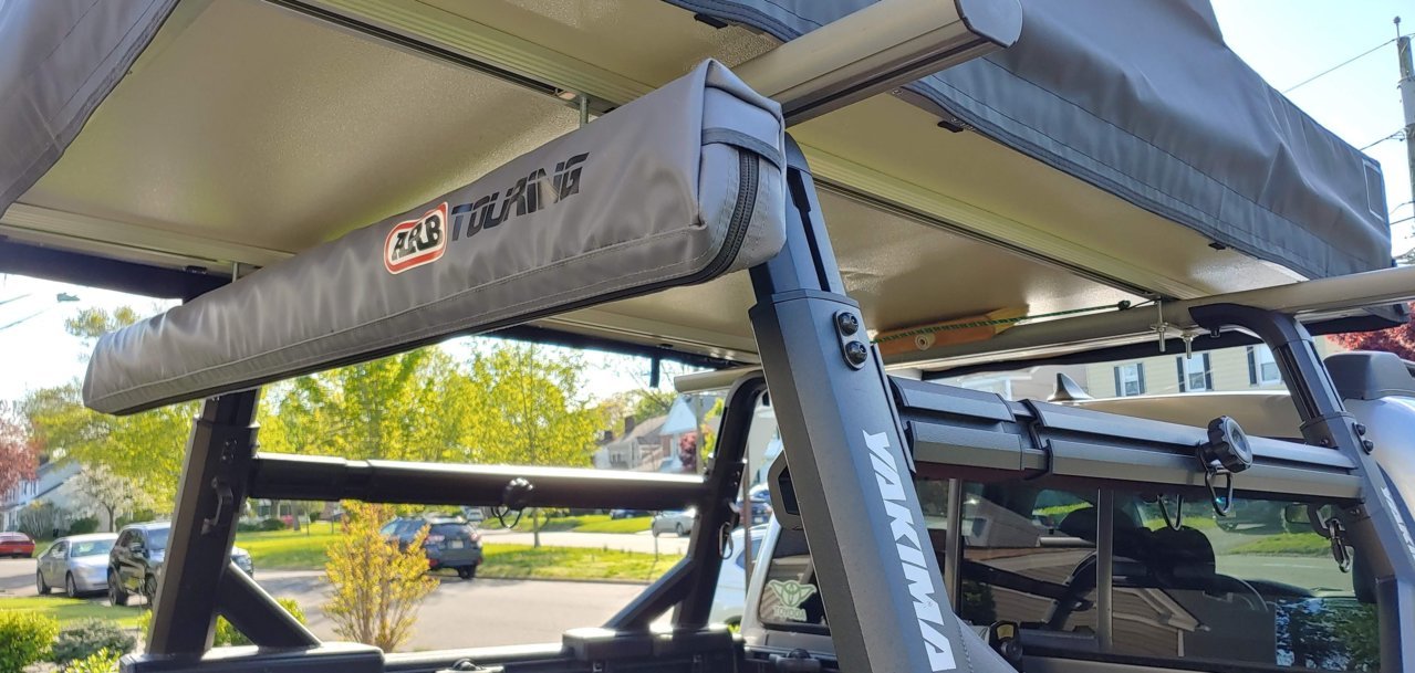

    3rd brake light installed on the bed rack. Tubing clamps I ordered were too big so it's just installed with some large cable ties for now. Thinking about installing an awning on the bed rack, so it may have to move eventually anyway.

    Nice. I did the same thing for my rear locker, only gets power when my compressor has power. It's a fun little project and clean with the daisy chains.

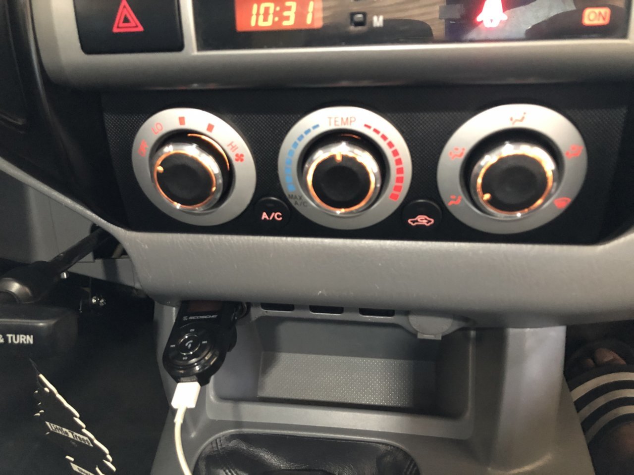

    Just received my knobs. I bought 2 packs of 3 because I wanted the 4x4 knob to match.

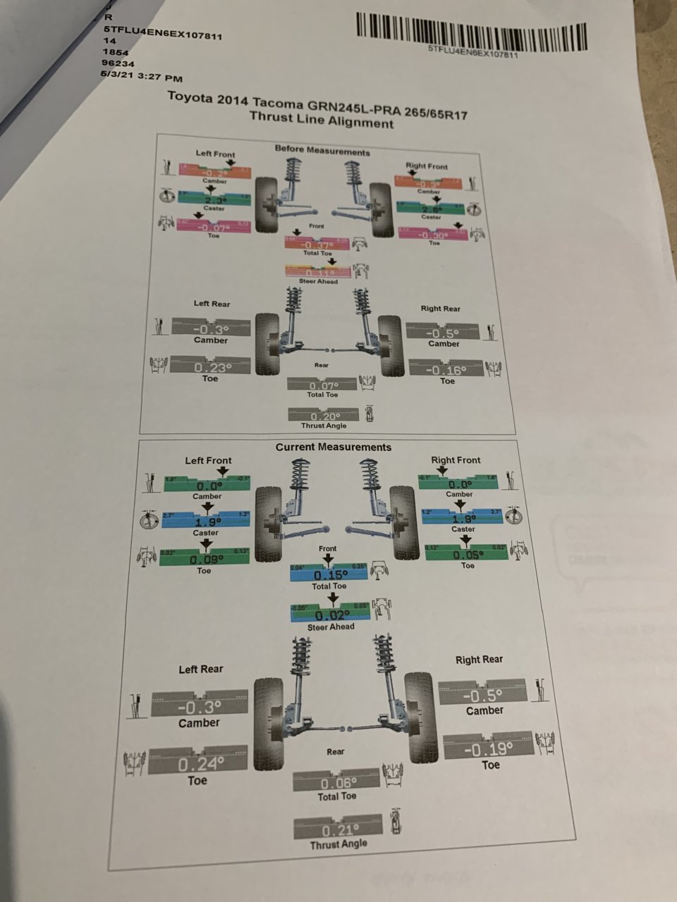

    Dealership visit.
    inquired about paint then got
    Oil change, Brake Fluid flush, air cabin filer replaced, fluids replaced on drive line and front and rear differential.
    they gave it a wash
    and an alignment.
