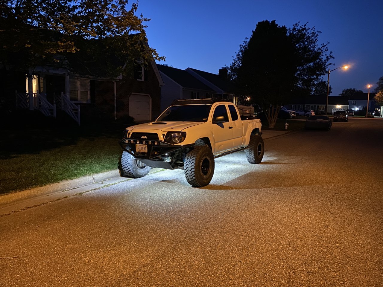

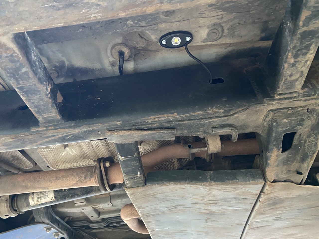

  1. May 6, 2021 at 6:19 AM

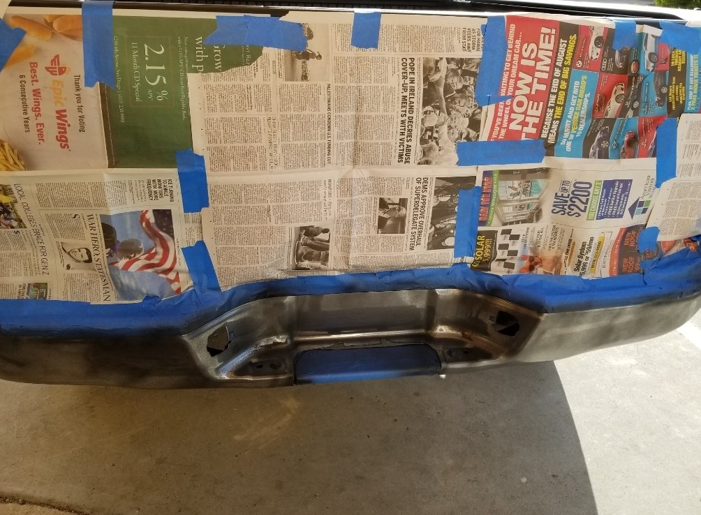

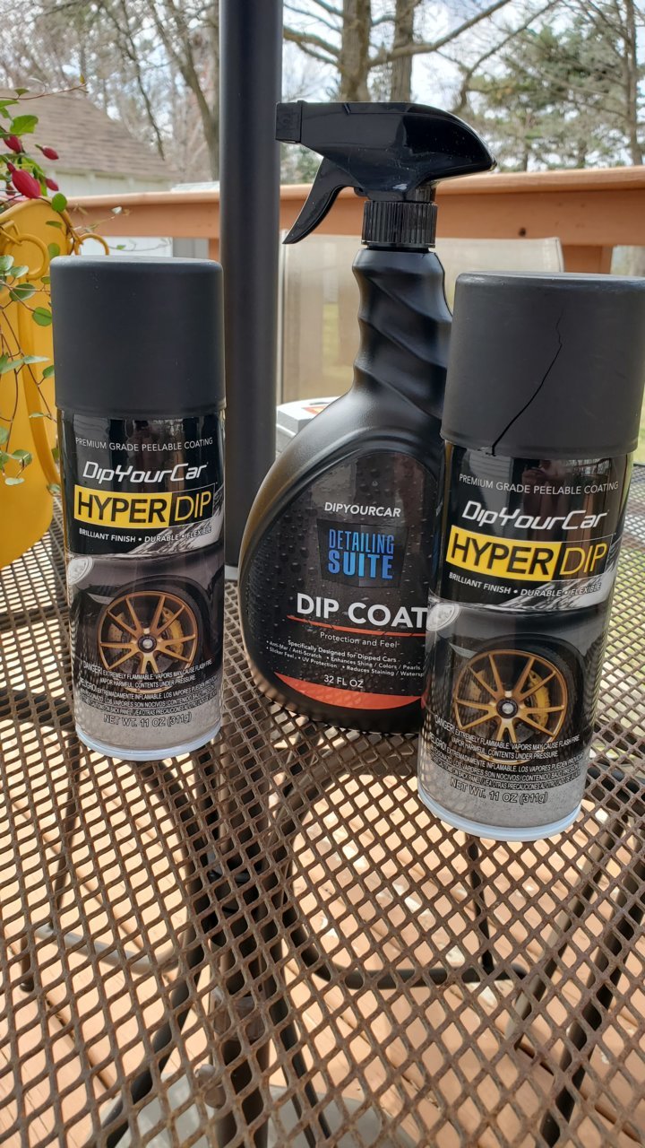

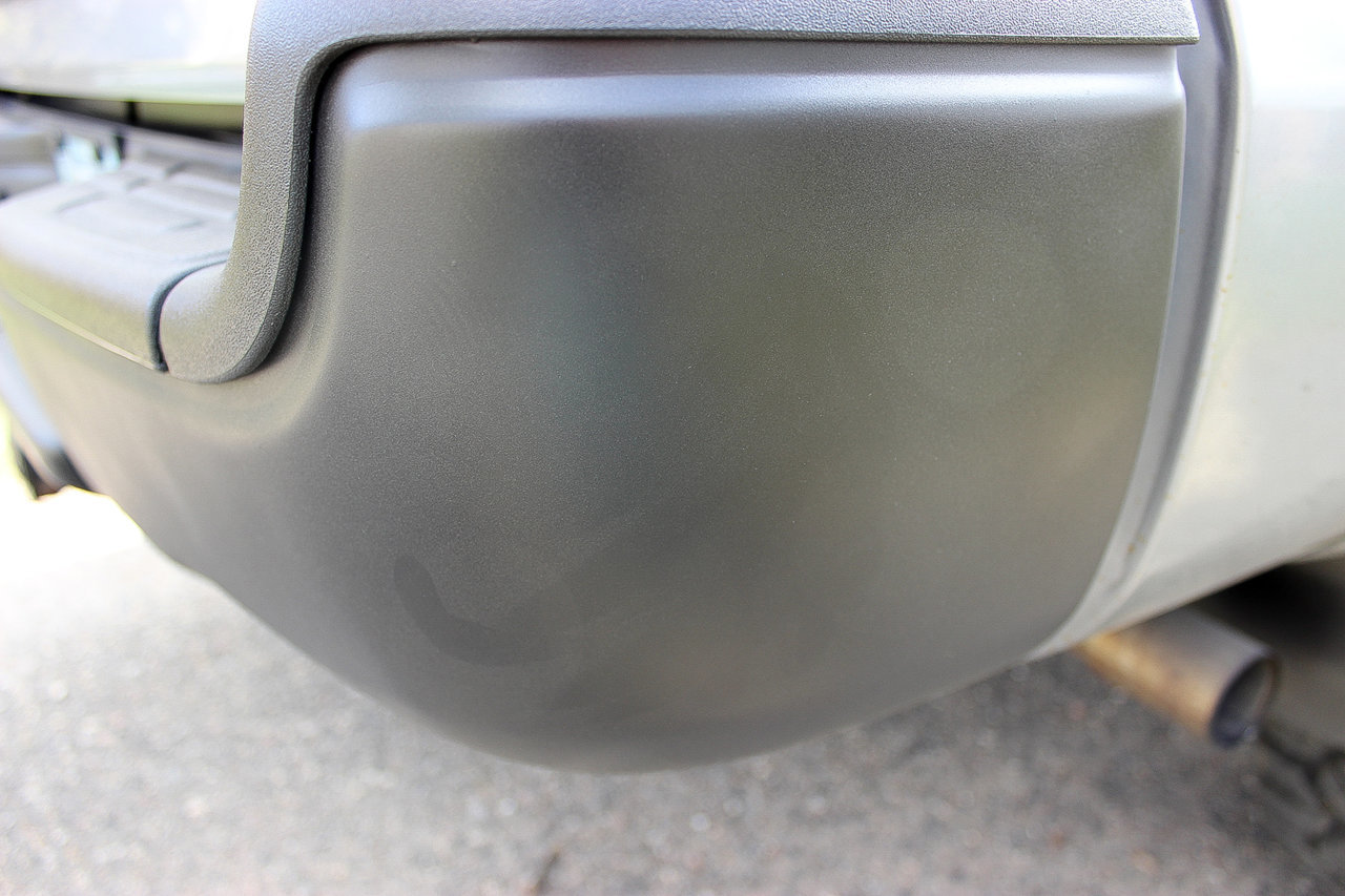

    I kicked around the idea of BumperShellz but got all fixated on salt/water getting trapped under them and rusting everything, so I decided to dip the rear bumper.
    I used Hyperdip and finished with Dip Coat to seal it. The taping off part was tedious but it went OK once that was done. On the first pass with a new can I got a lot spattering and was at stage 1 of "why can't I just do a truck project that works the first time". Total panic. After that the can settled down and I was able to cover the spatters with the rest of the coats. 9 coats total then waited a day for it to cure and put on the Dip Coat which hardens it and gives some scratch protection. We'll see how it holds up.
    I also tried some Griot's Garage Black Satin Tire Coating. It was pretty shiny the first couple days because I think I put it on a little thick but it calmed down eventually to a nice satin.

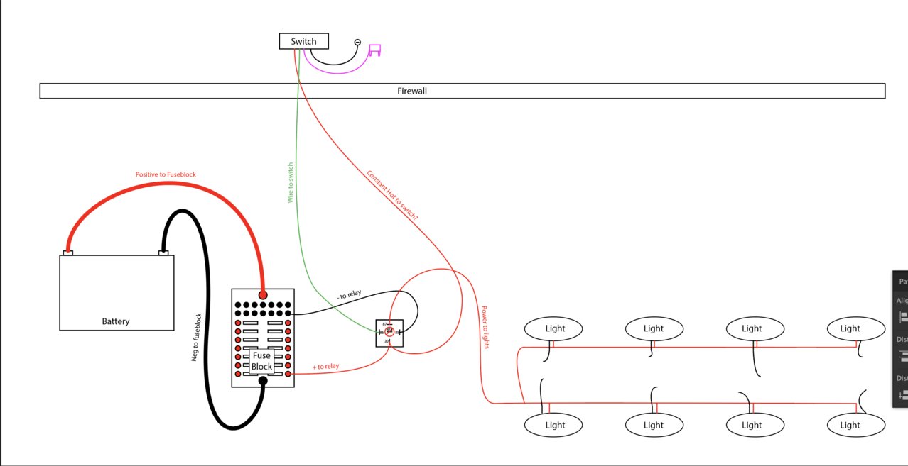

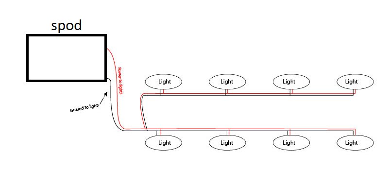

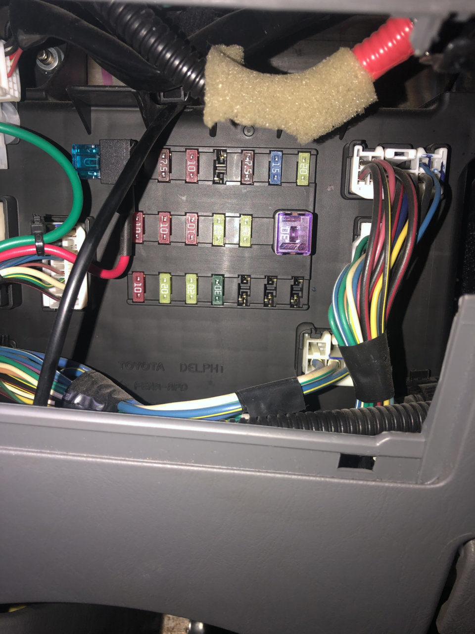

    Sorry for digging this up - but which fuse did you tap into for the switch? I have a similar diagram drawn up but thats the only thing I have yet to figure out...

    Thanks, 9 coats for me was about 1.75 cans.

    What did you do for prep? Sanding or just a good cleaning?

    I have an spod switch system. What's your diagram look like? I can help you pick out a fuse. Are you just looking for a switched +12v?

    This is my diagram:

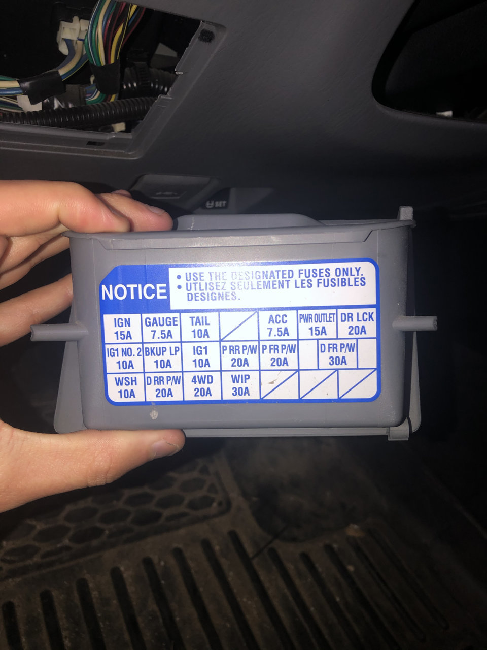

    and these are my open fuses inside the cab...

    Scrubbed good using Dawn. Make sure it's 100% dry and there's no water left to drip out from under the plastic when you begin spraying.

    That looks good to me. So it seems you're looking for a fuse for switch illumination with your dash lights? If that's the case, use the TAIL fuse.
    The only thing I would suggest changing if you want is to tie all the grounds together and run those up to the fuse block as well. It'll help reduce the chance of bad/corroded grounds in the future and with electrical gremlins. That's how I did mine.

    Thats funny... I originally had my diagram looking like this and someone told me to just do individual grounds :rofl: Is this how you did yours?

    Yeah pretty much, except I used an spod which takes care of the relay and switches and stuff. You have the right idea though.

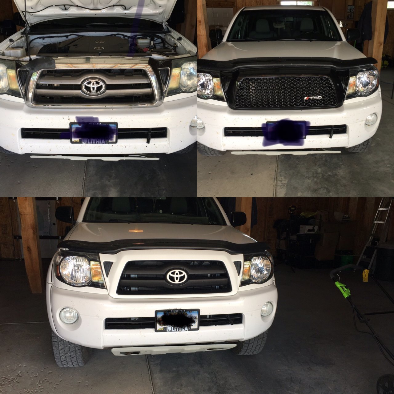

    Finally color matched OEM grill. First photo original chrome trim, second temp grill until I had both time and decent weather, last ... final look.
