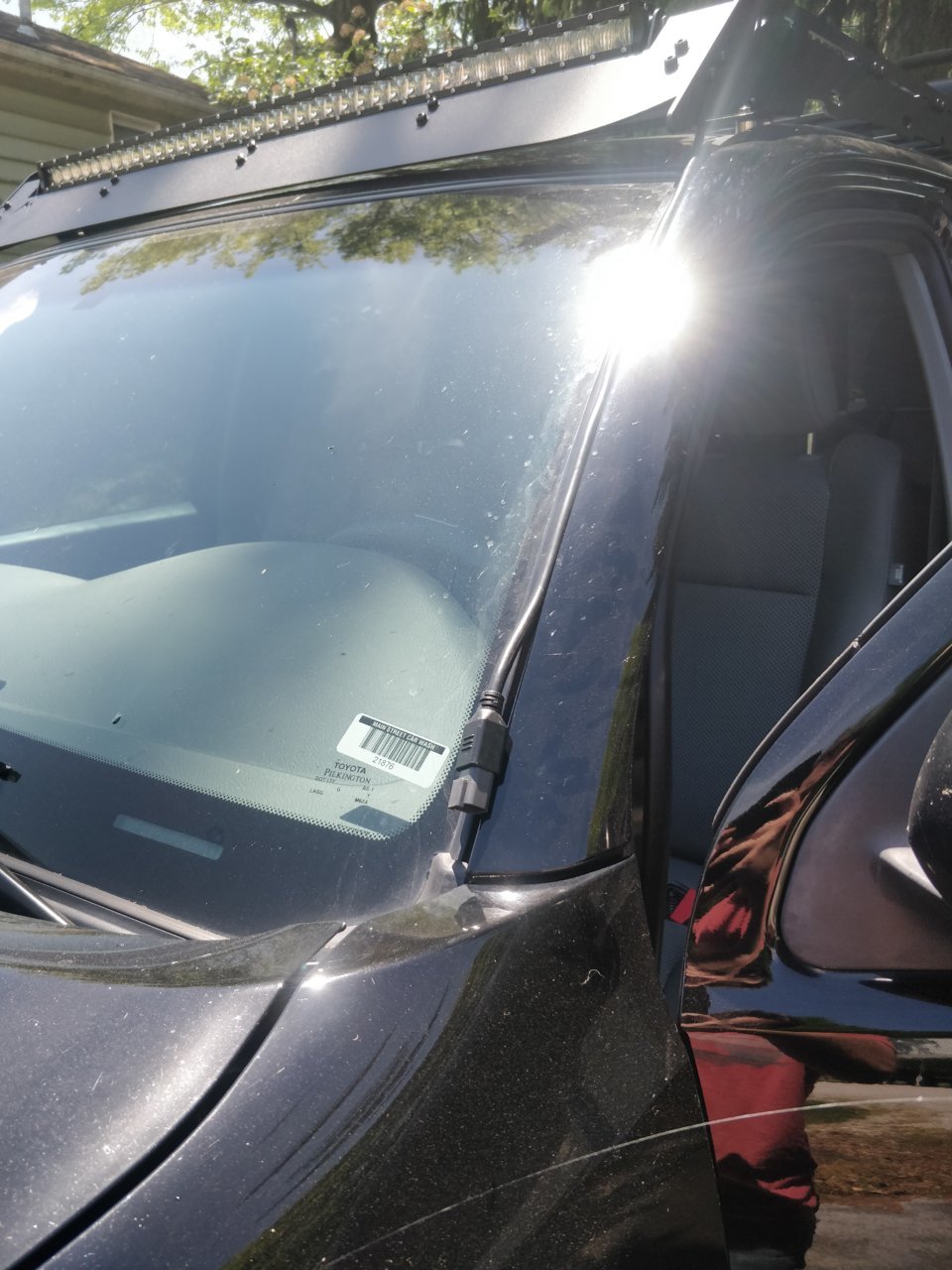

    Continued along with the roof rack and light bar installation. Can someone give me some tips on dealing with this ugly wiring? :bananadead:

    I cut my plug off and moved tot the top, then ran the appropriate gauged wire for positive and neutral inside heatshrink to the top. I was able to tuck it in pretty well into that side channel. I did put a couple spots of sensor safe sealant to hold it in place underneath. Looks clean enough I forget its there. I have seen people use an aftermarket little channel piece fitted over this but to me it sticks out and I dont care for it.

    Or if you dont want to cut it, you can loop it back and forth up top behind the wind guard and zip tie it to the underside of the first crossbar.
