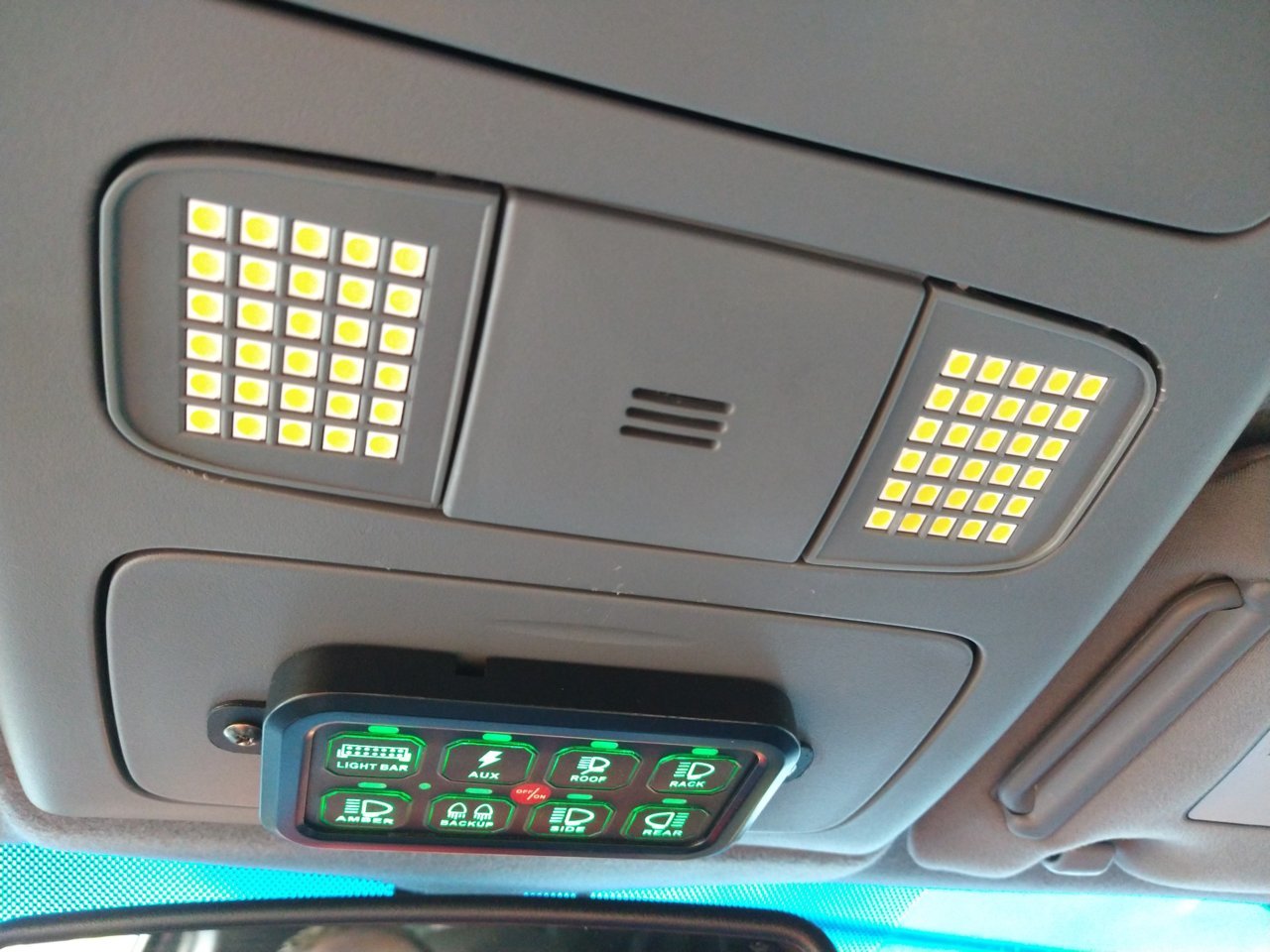

    It’s just a simplified, non adjustable version of that mod.
    The magic smoke. I’m pretty sure meso uses an array of 3V leds. The reason the 3mm leds work in aftermarket switches is the current limiting resistor bleeds down the excess voltage to under 3V. Without that limiting resistor it’s just the sum of the forward voltage drops of whatever leds are in series(parallel only affect total current). Usually leds are current controlled since that can vary greatly with small changes in voltage. No resistor and an increased voltage (even .5v) can let out the smoke. Once they start to go it generally cascades since there are fewer leds remaining to drop voltage.
    Although the arrays blacking out is a concern my main reason for asking meso about it was reports of other issues since the timer delay off for the dome happens elsewhere(presumably an $ circuit board)and lots more light usually means at least some extra current even with leds. I got them because I truly despise weak lighting but I’d rather dim them a bit than have random stuff failing. I never heard back and yet it’s been almost 3 years trouble free for me. Then I see a post like this and wonder what is wrong with his and right with mine or is it just dumb luck. Not a big fan of that.

    Yes, I have an Agm and a dip switch. FWIW I poked around at the back of the circuit board with my 12v probe and a couple lit back up. I thought along the lines it’s probably just over driven Chinese leds and never really bitched. Honestly the 3 leds are about perfect but sometimes they start to strobe and flicker. That started to bug me so I put in the onesie got in a trade.

    Any computer system should in theory regulate the supply on the board. Automotive power is notoriously dirty but the lack of certainty is my concern. And even if the various major circuit boards are protected you can see that it’s not well regulated system wide by using a voltage display. Regulation may only be limited to capping voltage spikes. Maybe Caribe Makira knows more.

    There is a thread on here somewhere that shows how to have the map lights connected to the dome lights so they operate at the same time triggered by when the dome light comes on.....I will edit and link the thread if I can find it but someone will probably beat me to it.

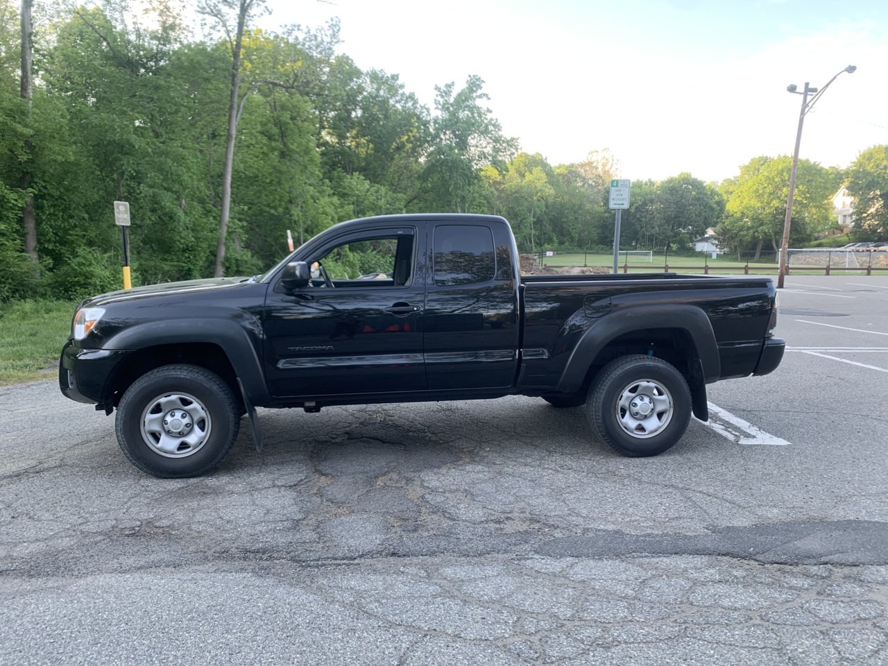

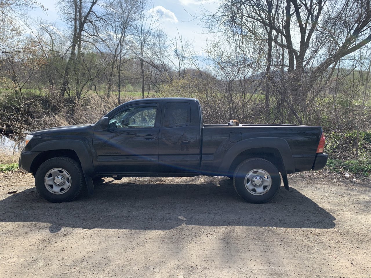

    I also put 3rd gen OR shocks on mine too. No ad a leaf though. I think 3rd gens sit bout an inch higher from factory too... lol

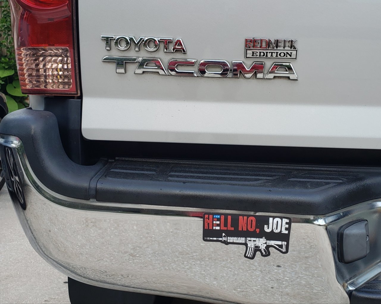

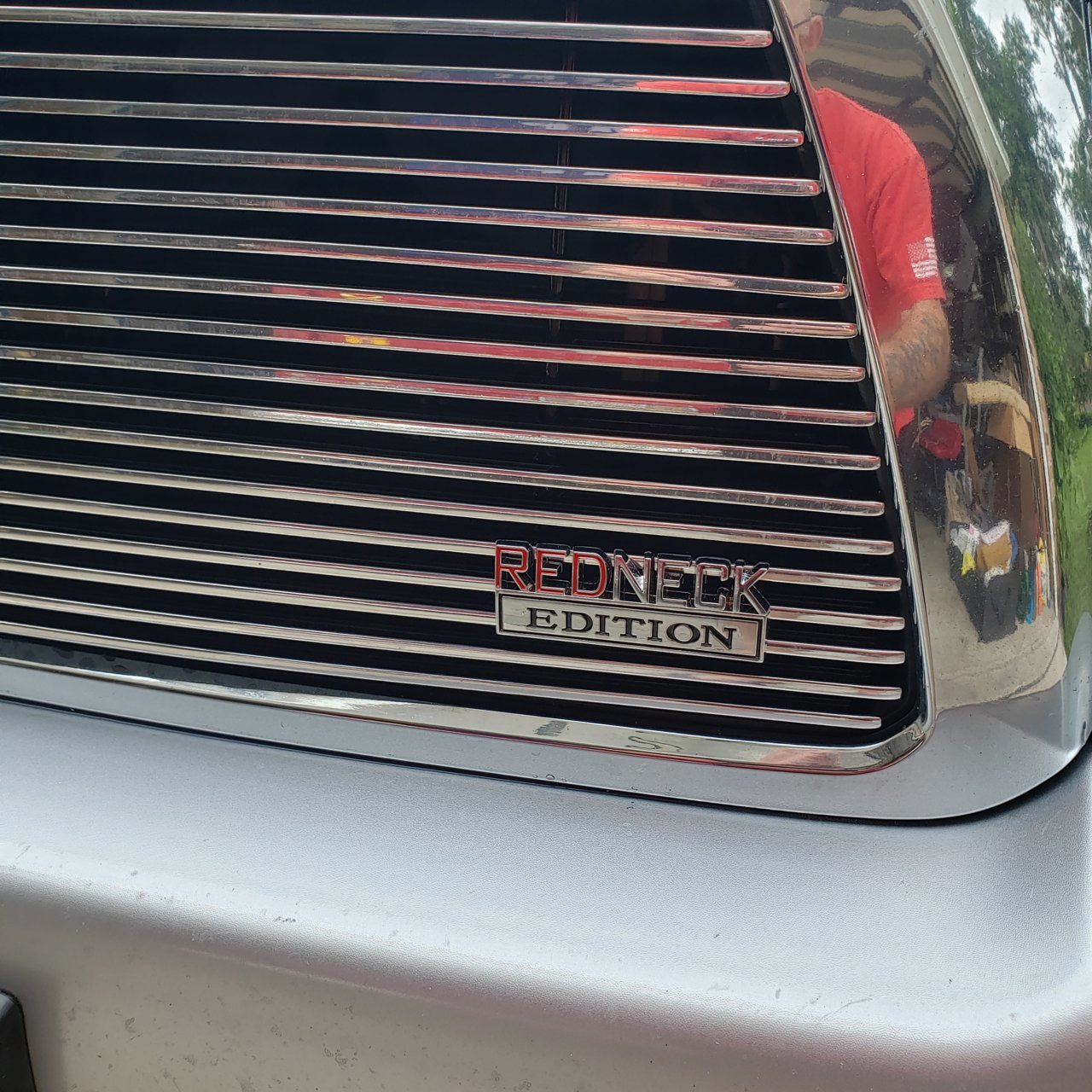

    Added my REDNECK Edition badges today.20210521_185155.jpg 20210521_121208.jpg

    Looks good with that bumper sticker.:thumbsup:

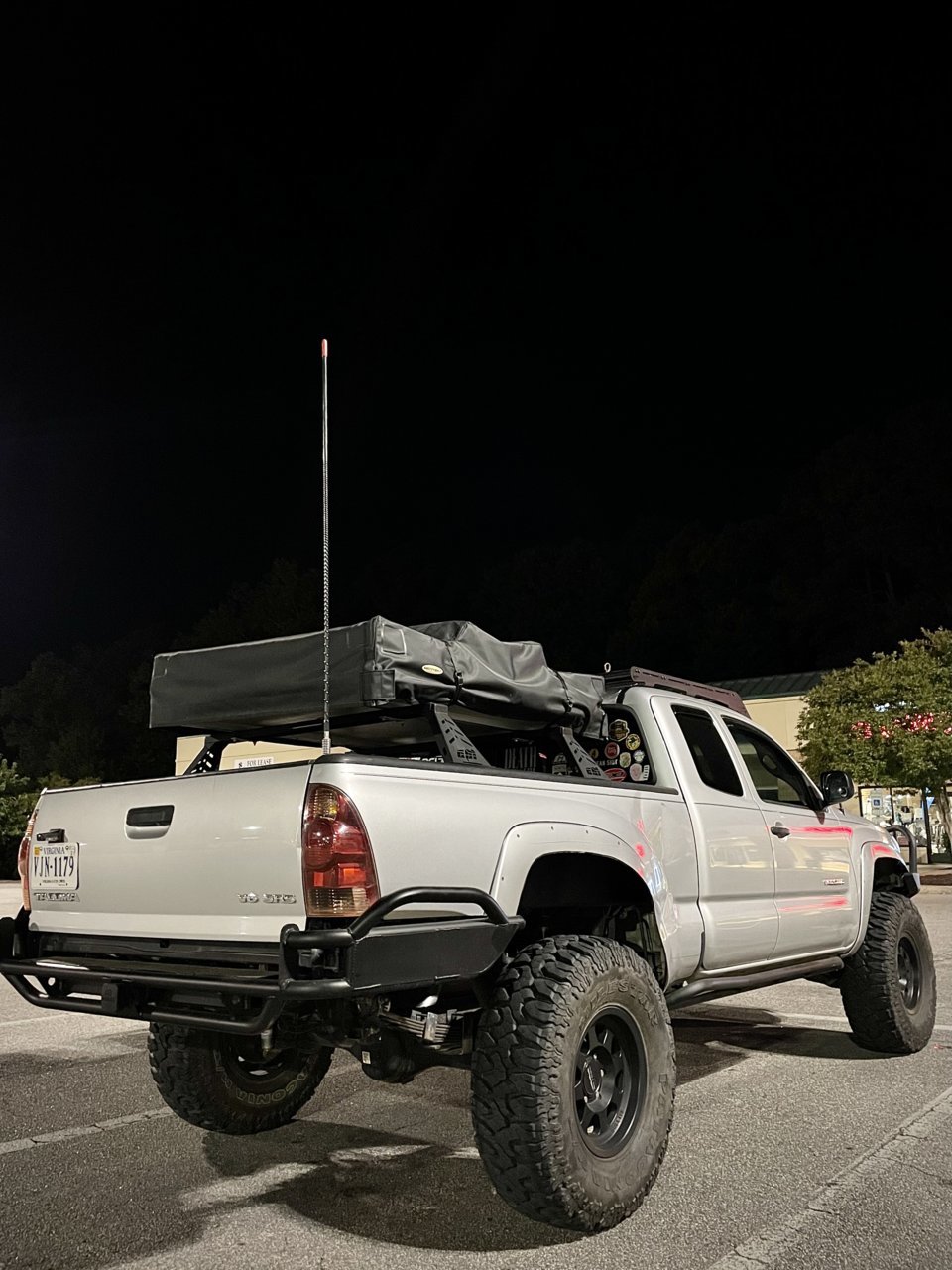

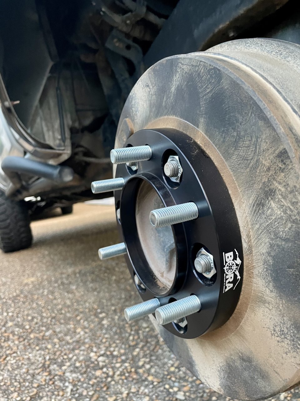

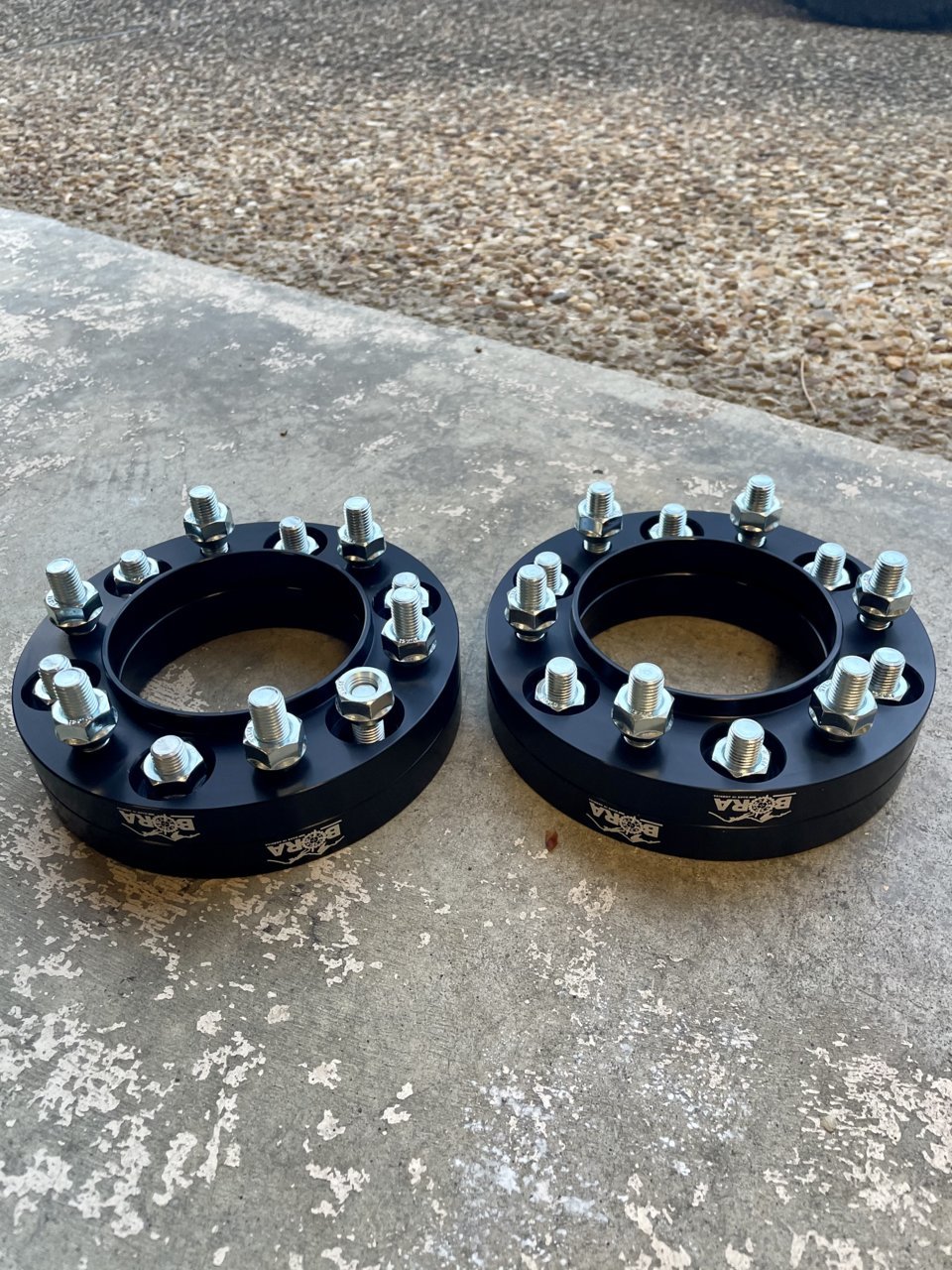

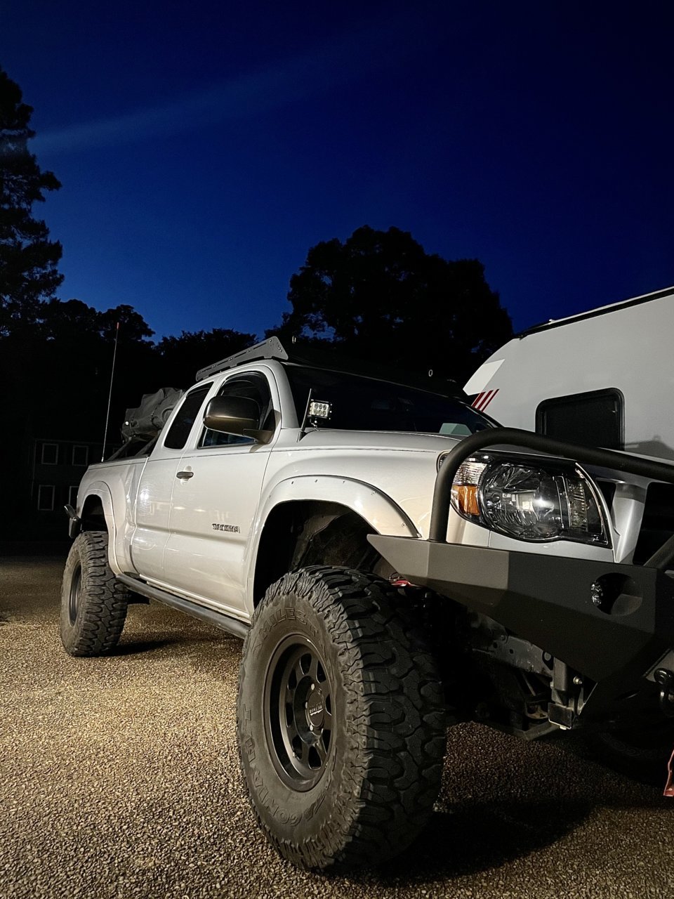

    Was rubbing the UCA up front and finally got my .75” bora spacers in. Threw them on today and happy to say the 35’s do not rub anywhere.
    AC738E5F-8CAC-41EB-A254-9B18F20F8DB2.jpg 80BD6A04-0A1D-4A98-91CF-8536007F1395.jpg F97F333D-1659-45A2-9EC2-9E2B624DAD3D.jpg

    These meso lights are crazy bright. I just couldn't remember if they came on or not. It's probably a matter of dragging the power (neg) over to the dome and tapping in.

    I just put 35s on & was immediately rubbing on my anti sway bar. So I deleted that. Now I rub my frame on the passenger side at full right-lock. (Driver’s side is OK).
    My backspacing on my FN wheels is 4.25”. I’m considering 3/4” Boras. They are great quality. I’ve had 1” ones before - but I hate using spacers. I hate rubbing worse though.

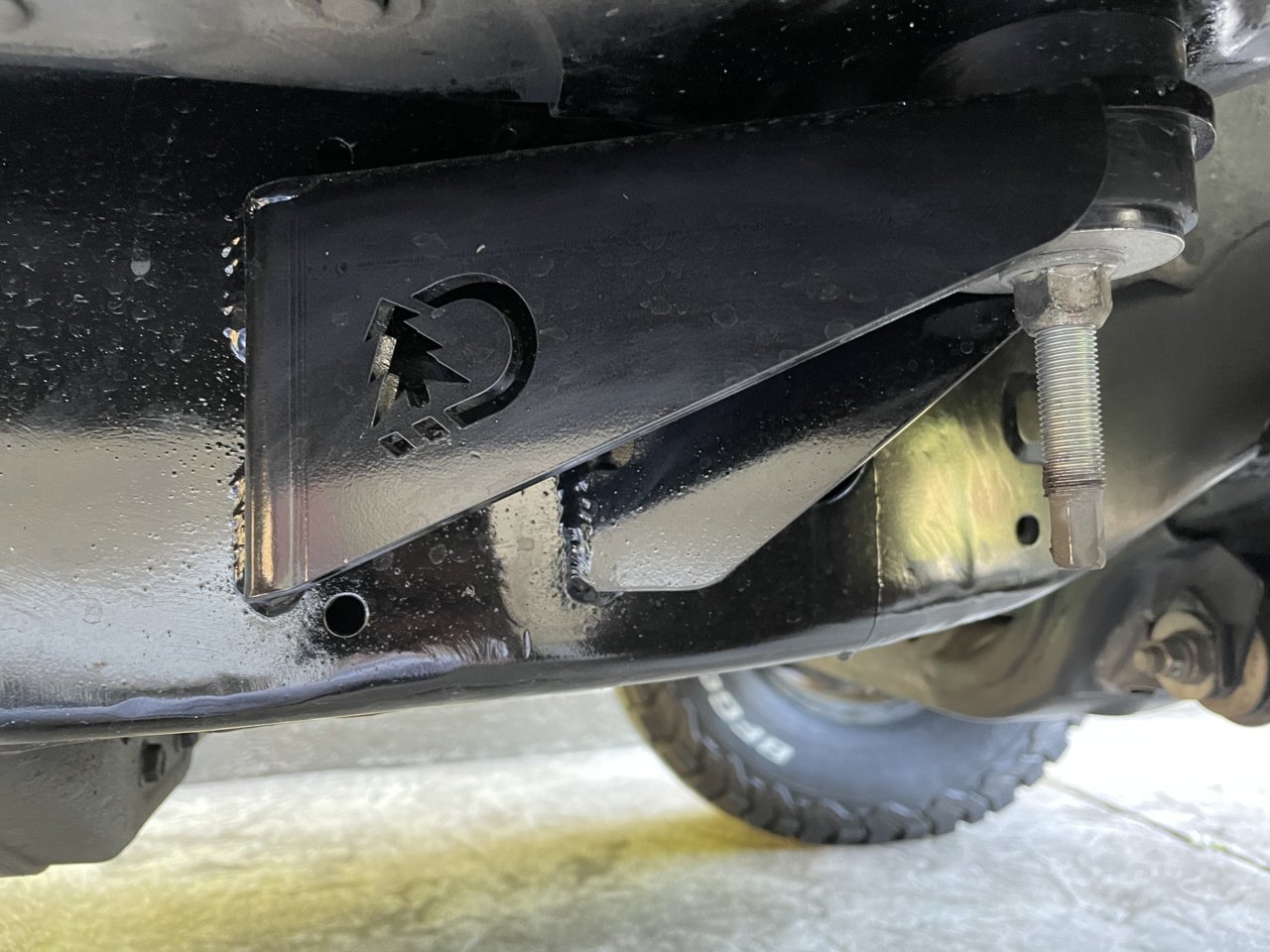

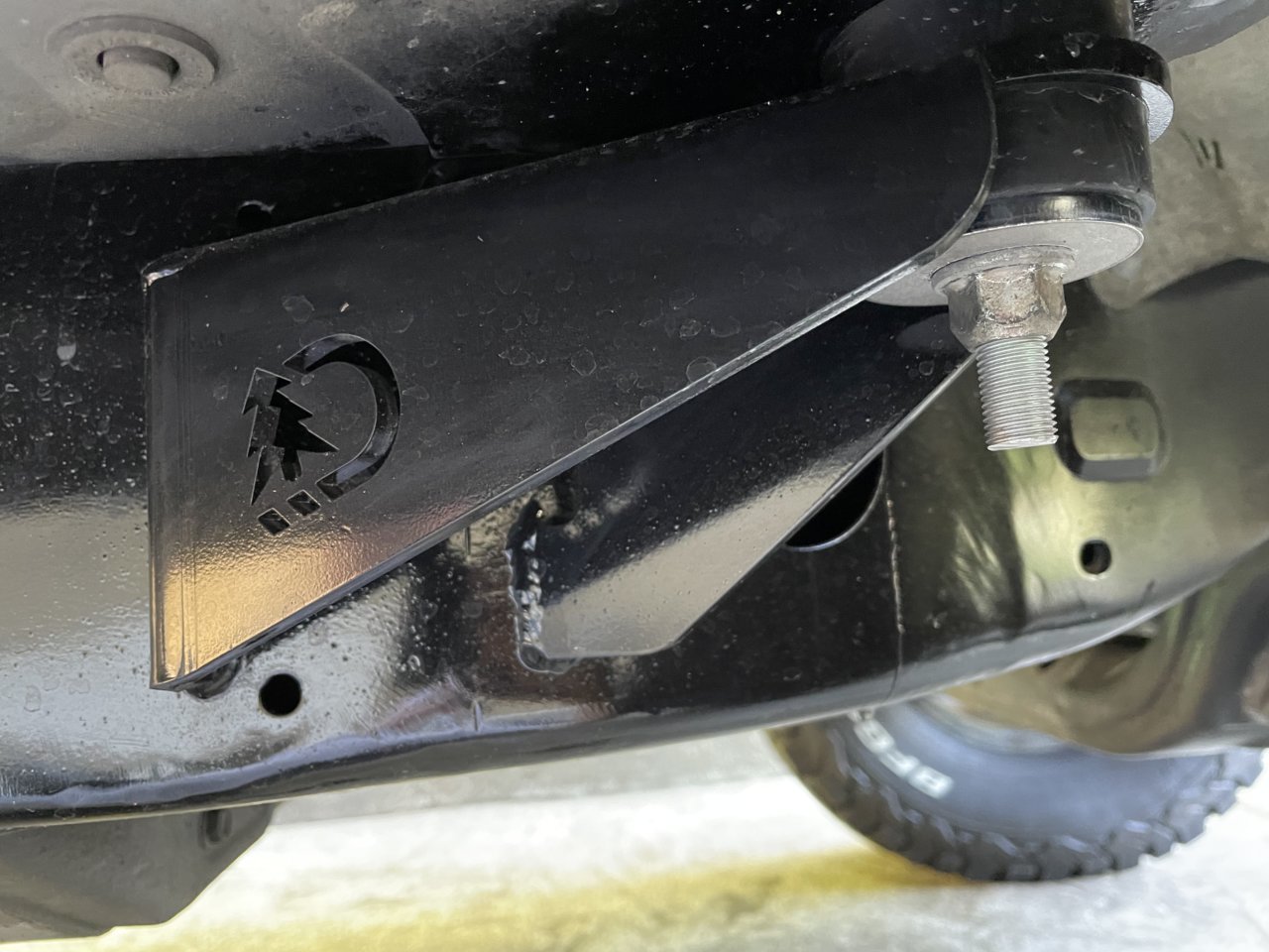

    I cut the cab mount bolts shorter.
    26938AF4-10A6-4549-962A-D418F4089504.jpg B08B10AD-0B34-4FFB-BEA4-9DD3A89D96AE.jpg

    How you like them tires?
    Matt's recovery speaks highly of them even though they seem to have vulnerable side walls.

    I have always been the same about spacers but as you said I hate rubbing worse. Mine was rubbing the UCA with hardly any movement of the wheel at all so it needed to be done. These are very quality and I love how they come in at under an inch.
    I love them. Perform great in daily driving and awesome on the trail. I’ve also tested out the sidewall pretty good and it didn’t give so I’m pretty happy with them.

    What size is that? Looks too skinny for a 12.50.
  20. May 21, 2021 at 7:26 PM
    T.Barn
    T.Barn Well-Known Member
    Sep 1, 2020
    #339422
    695
    Todd
    Hampton Roads, Virginia
    2010 AC 4x4 6MT
    They are 315/75/16
