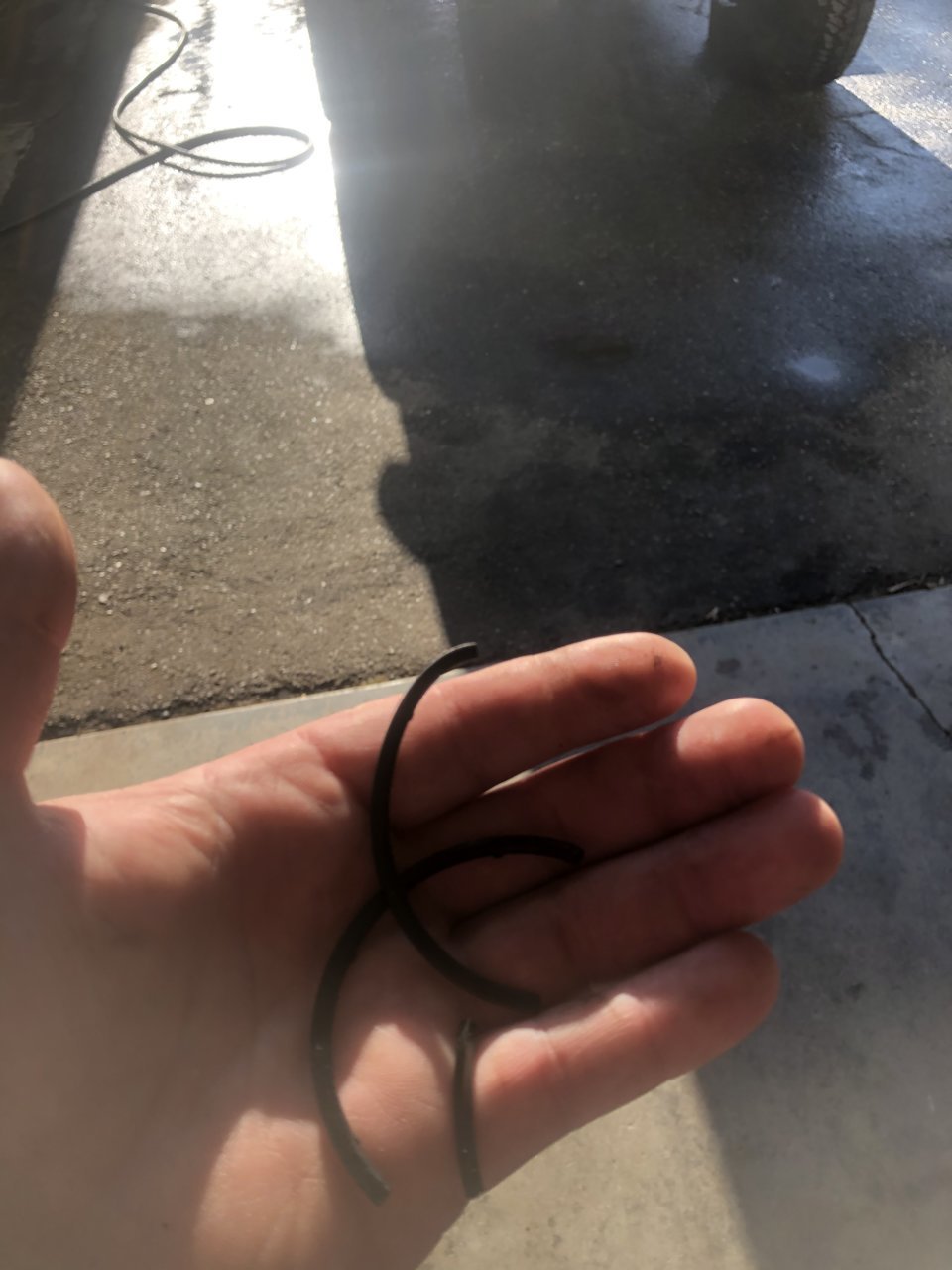

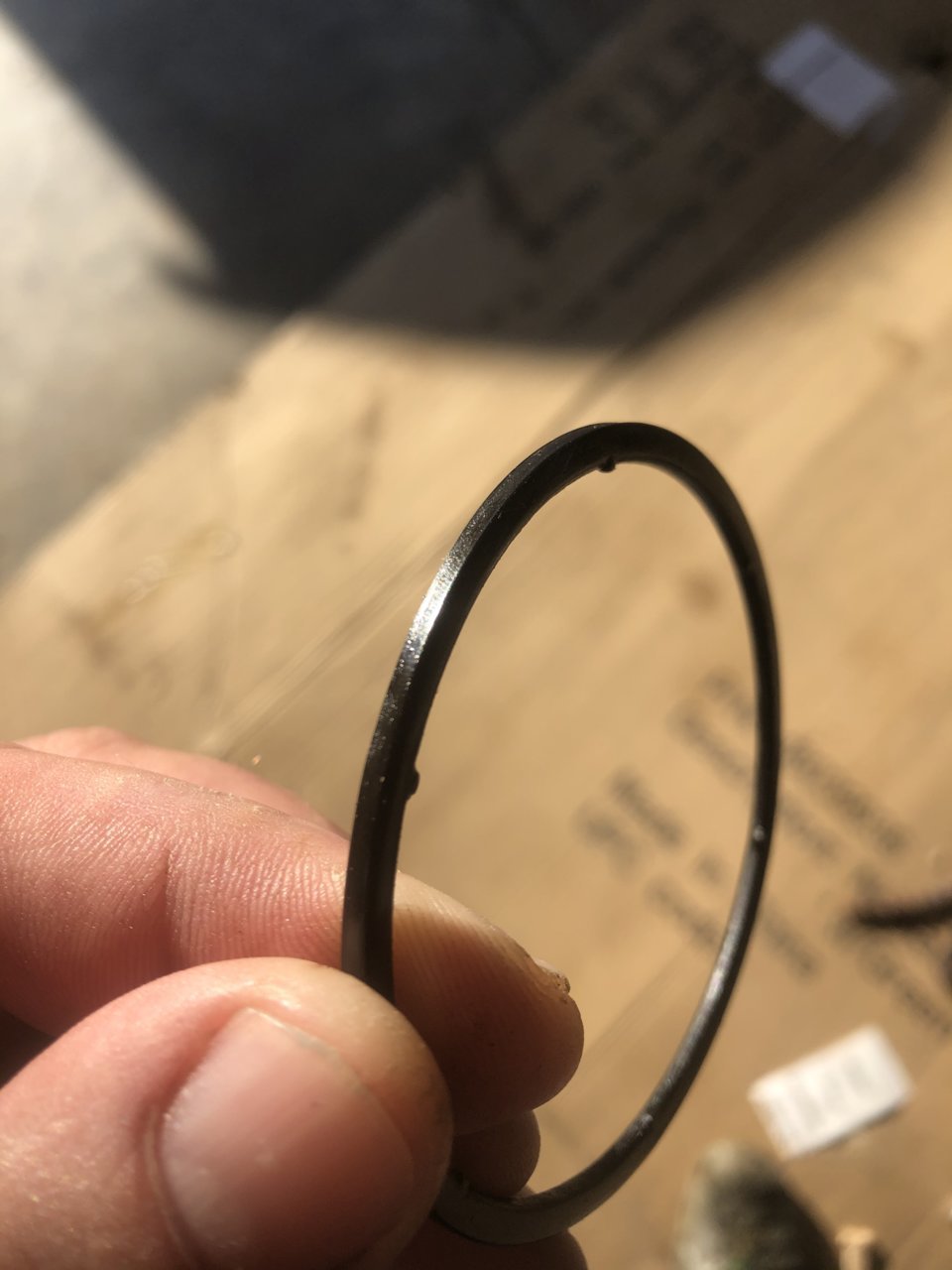

    9753B36B-3C6C-4115-B3F8-CE57ECFB58C4.jpg 37A05E98-3474-4AC8-8B9F-EE925722D470.jpg Changed out this o ring today... any guess where it’s from?

    Copy. You never used NVGs. Red is the anti christ to NVGs. That is why we use green or blue lights with our NVGs. Red light affects the rods in your eye more than green or blue. This is the reason we use green or blue in the military with NVGs.

    That's not the thermostat housing gasket is it?

    It was the o ring under the oil cooler.
    I was pretty surprised how brittle and smashed flat it was. I thought for a second the dealership sent me home with the wrong part. The truck had a tiny oil leak. Took a couple days to figure out where because I thought it was leaking where the oil filter housing meets the block and didn’t realize there is an o ring under the cooler.

    If that's the case I have not seen one of those.
    Good knowledge to keep in my back pocket though, would have figured the oil cooler would use a tapered thread and been self sealing.

    The oil cooler has that bolt through the middle that has a little o ring. ( somewhere in there I never actually saw it, I pulled it out, swapped in the big o ring and torqued it back together) This is the big one where it sandwich’s together underneath. There’s a little grove it tucks into. The leak was more of a seep. I caught a little drip forming on the nipple that drains the oil. I stuffed a little chunk of paper towel in way down there and went for a drive and found some fresh oil on it. I was going to replace the o rings for the housing unit I watched a YouTube video of a guy swapping in a oil cooler in his 4Runner to get a better look at it. He flipped his cooler over and put the o ring in it and I was like no shit that’s my problem. I had no clue and couldn’t find anything on TW about it. Everything here points towards the timing chain cover, but this was really high and the belt had been flinging it all over not helping pin point it.

    Good find mate!
    I think this is the first I have seen of one of those jobbos going belly up before too.
