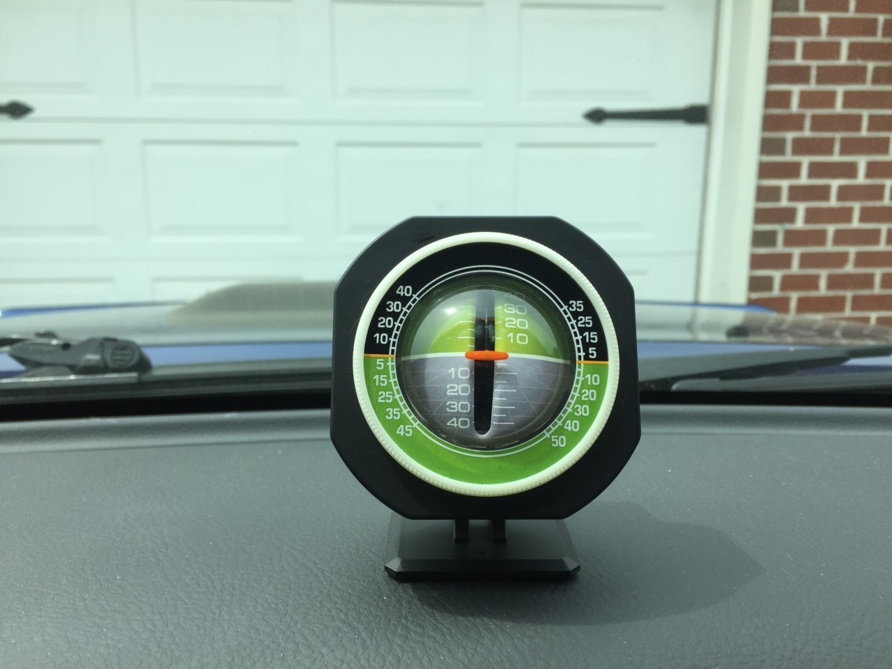

    I wonder what Andrew St. Pierre White would say about the TPMS.
    His review on the ARB one is good (the review is good, not the product).

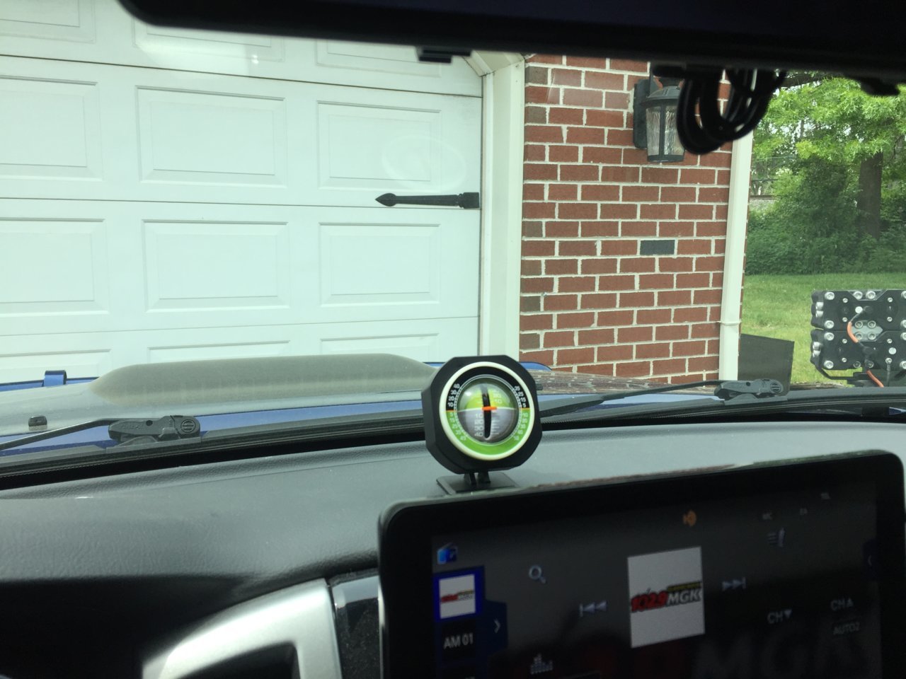

    Its filled with fluid of some kind. Seems pretty stable. Have not gone off road with it yet.

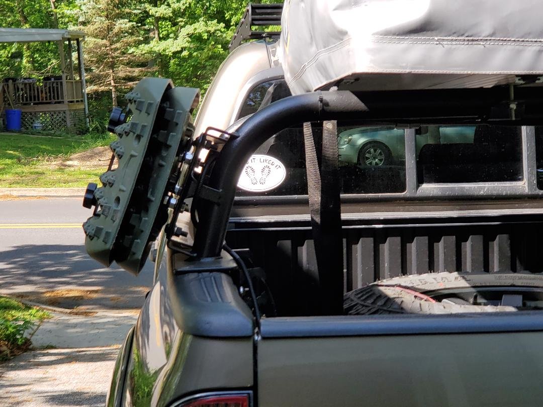

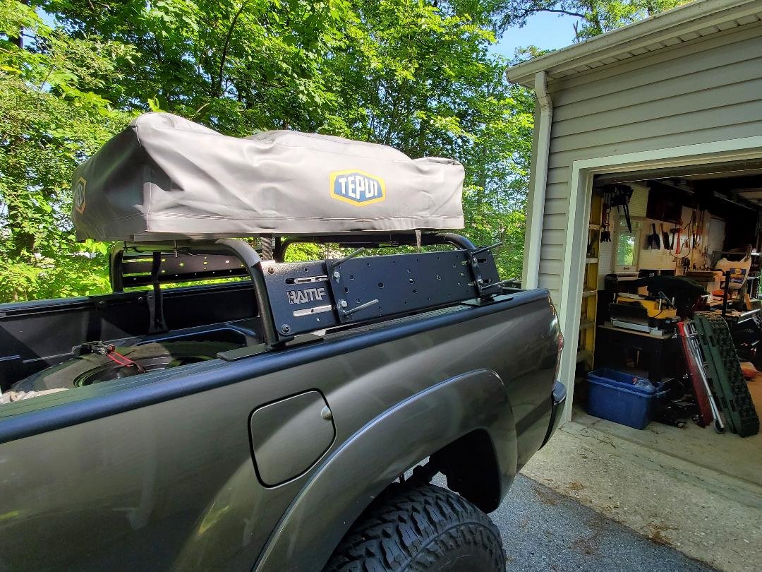

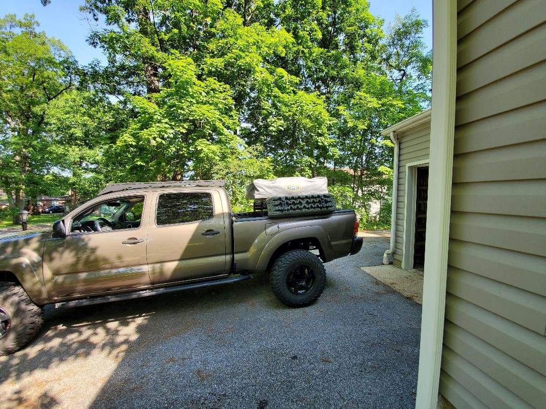

    Driverside hub/bearing assembly replaced. Only took about an hour. Ordered a second one, figuring that if ones toasted the other probably isn't far behind. Will try to get to that next weekend. Cut up my traction board mounts to install them on the bed rack. Not sure if it's permanent or not, but It'll work for now.

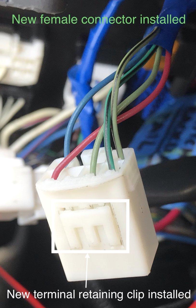

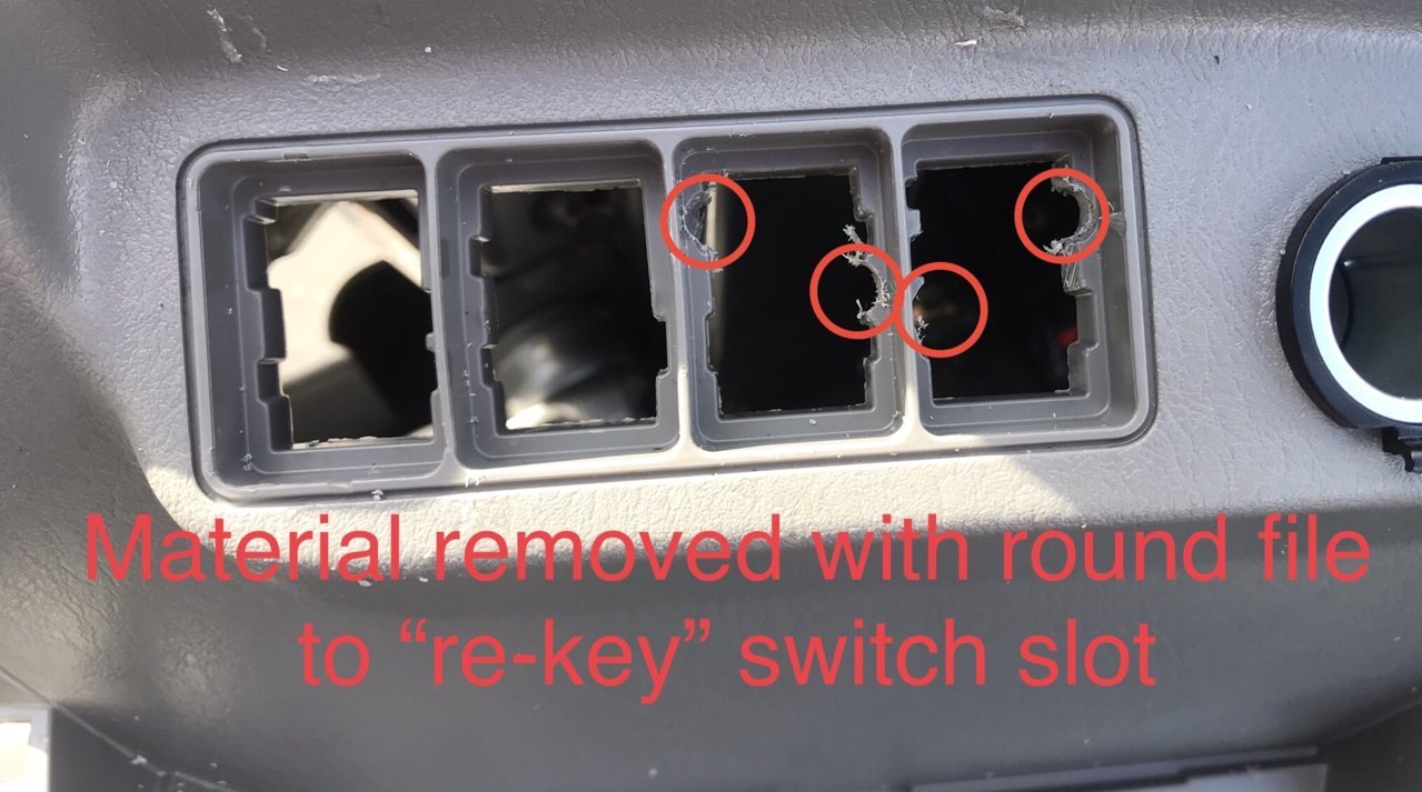

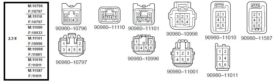

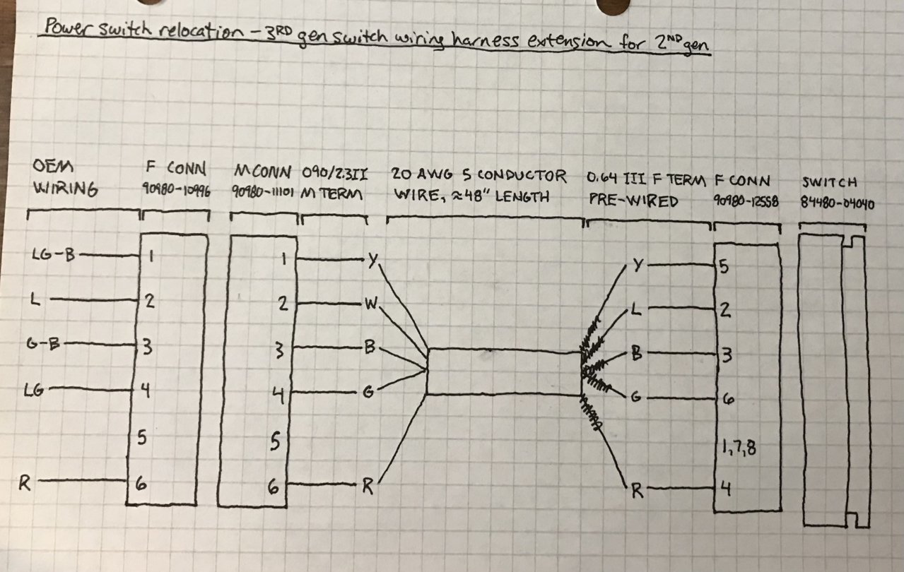

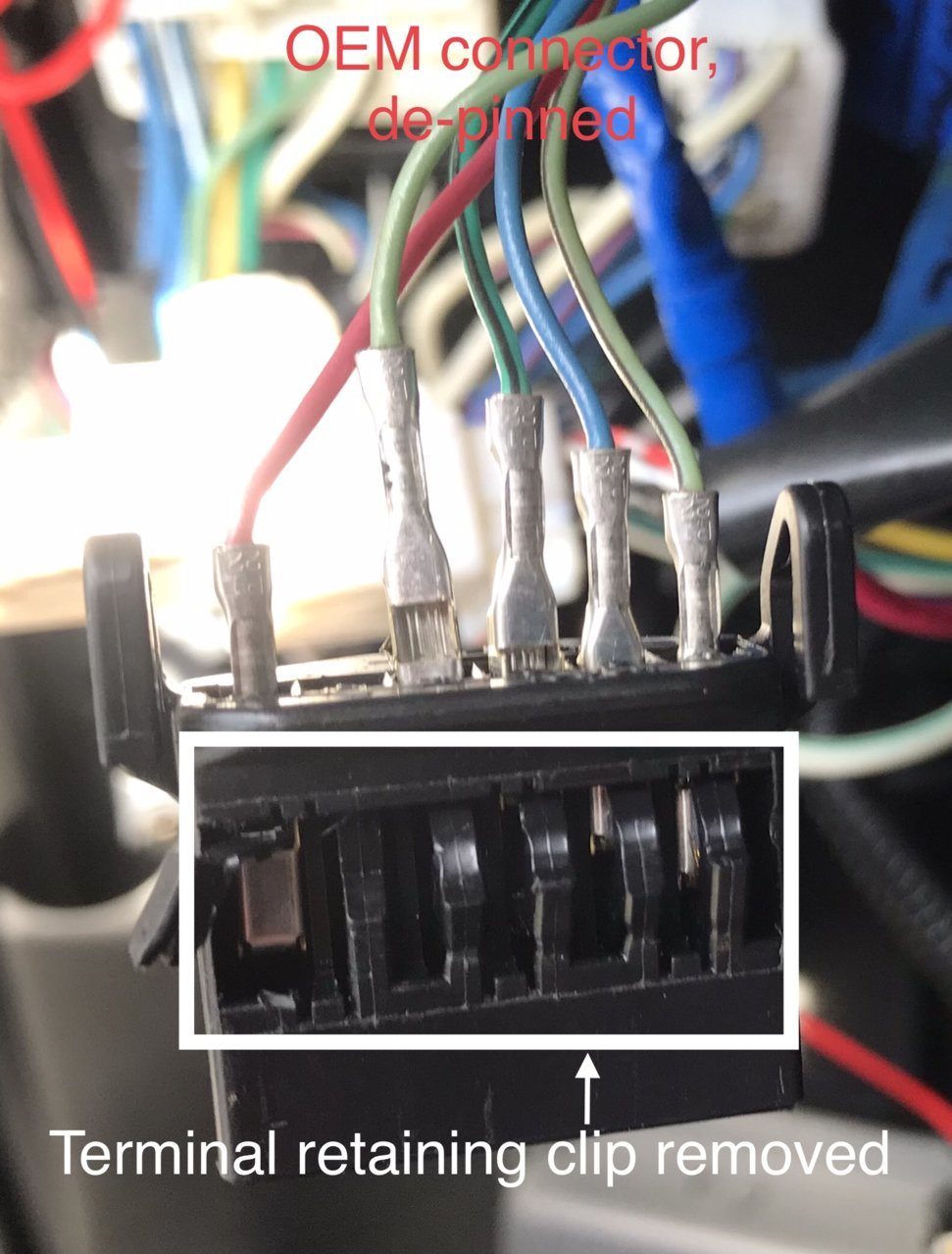

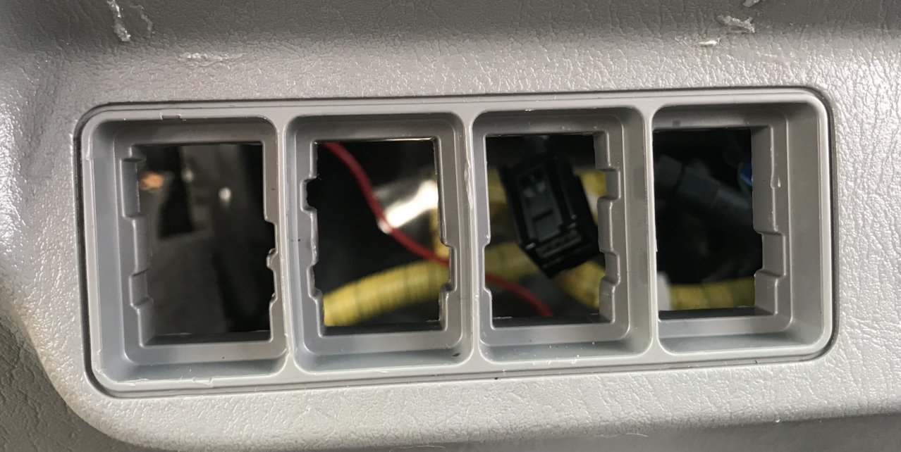

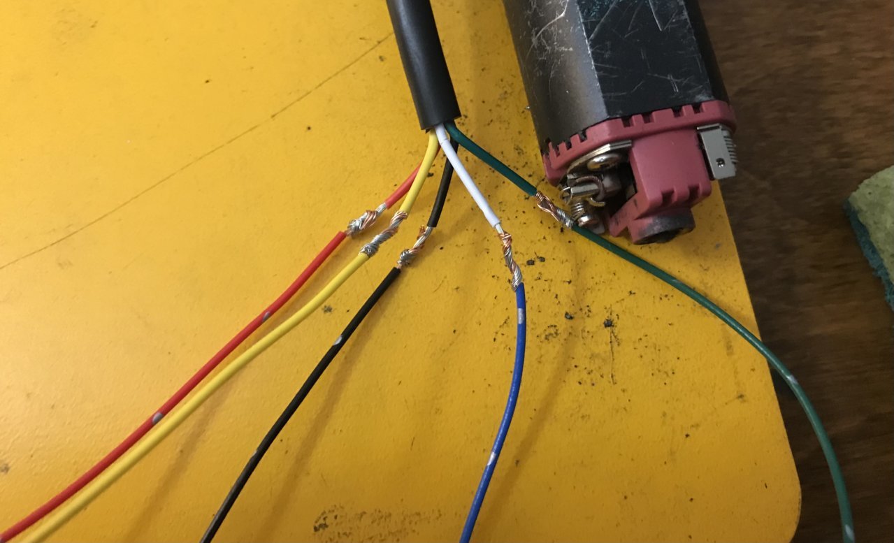

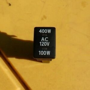

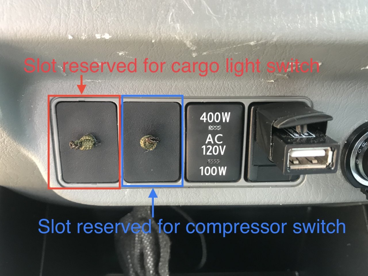

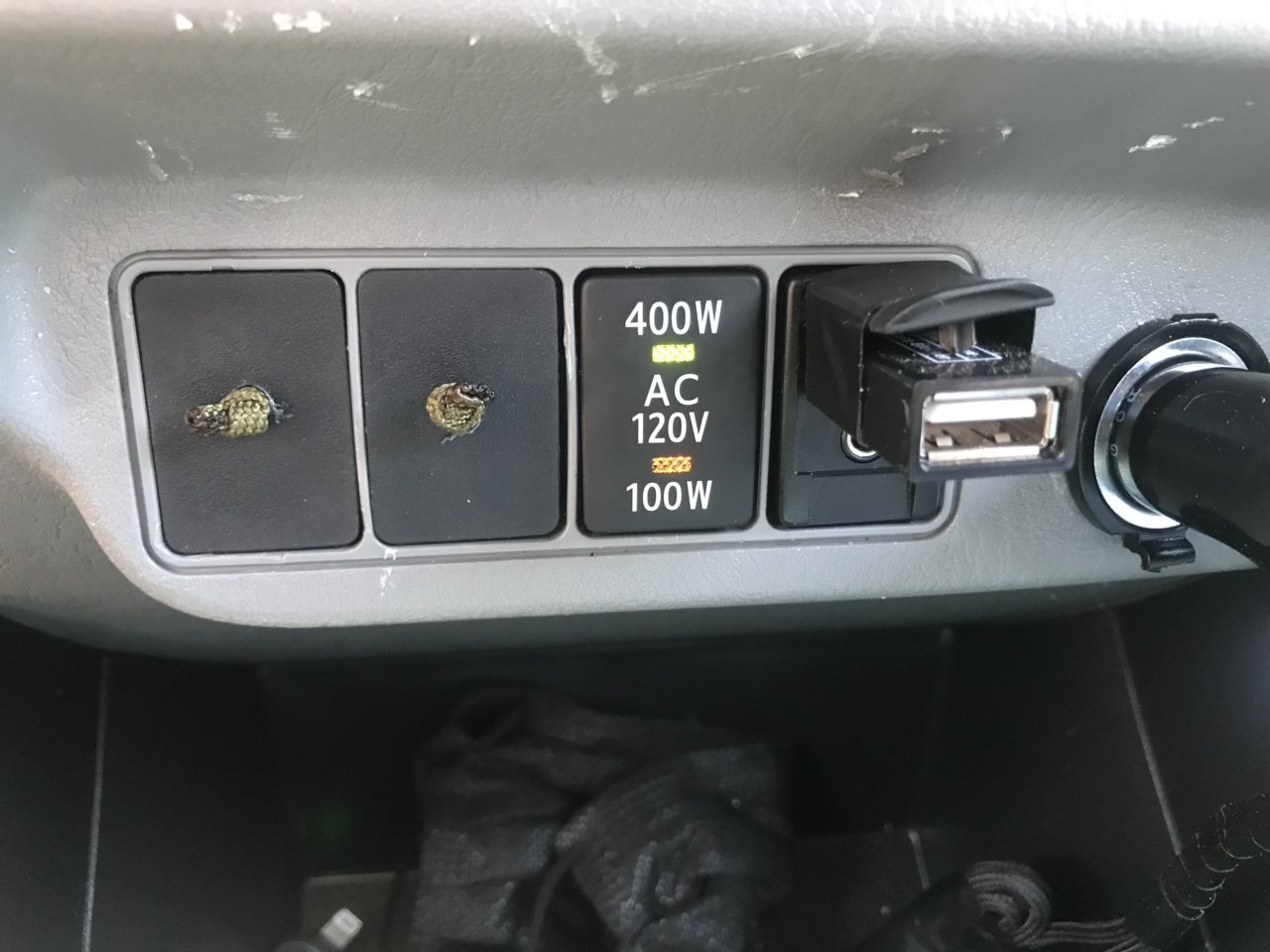

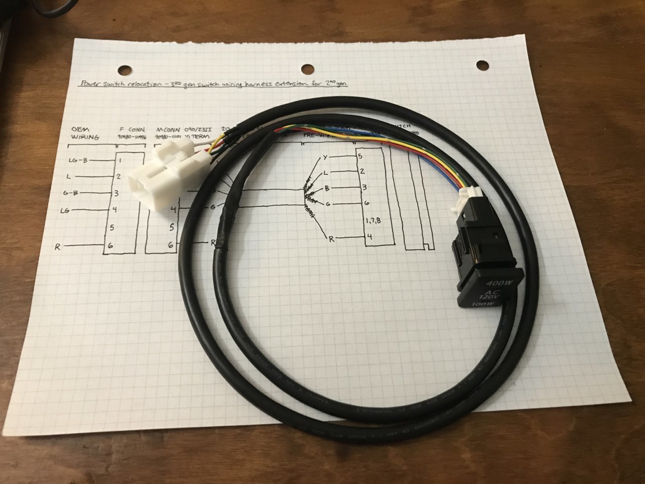

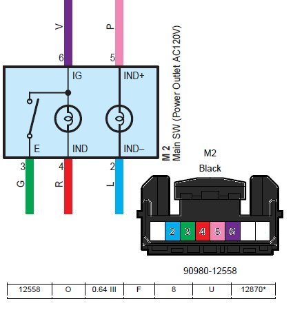

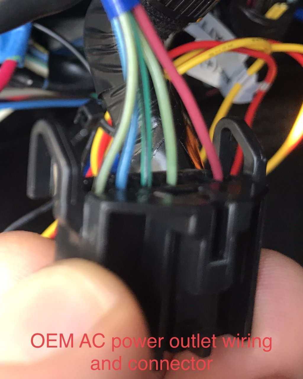

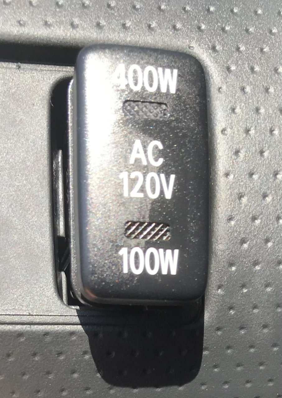

    I now fully understand why most people don’t mess with the small switches under the head unit. Gaining access to them is really not a fun process.
    I did accomplish what I set out to do, although it took a solid 4 hours. I moved my USB and aux-in one slot over, ran some paracord through the wire route I’ll use for my next 2 small switches, and relocated my AC power outlet switch using a 3rd gen switch and wiring harness conversion.
    Thanks to @caribe makaira for the electrical specs… and of course, @EatSleepTacos for emotional support.
    I’m gonna have a beer, then I’ll do a writeup for anyone who’s interested.
    *Edited to add*
    Writeup:

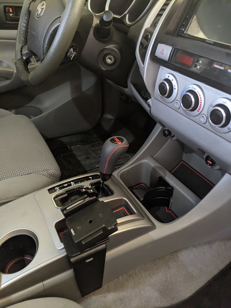

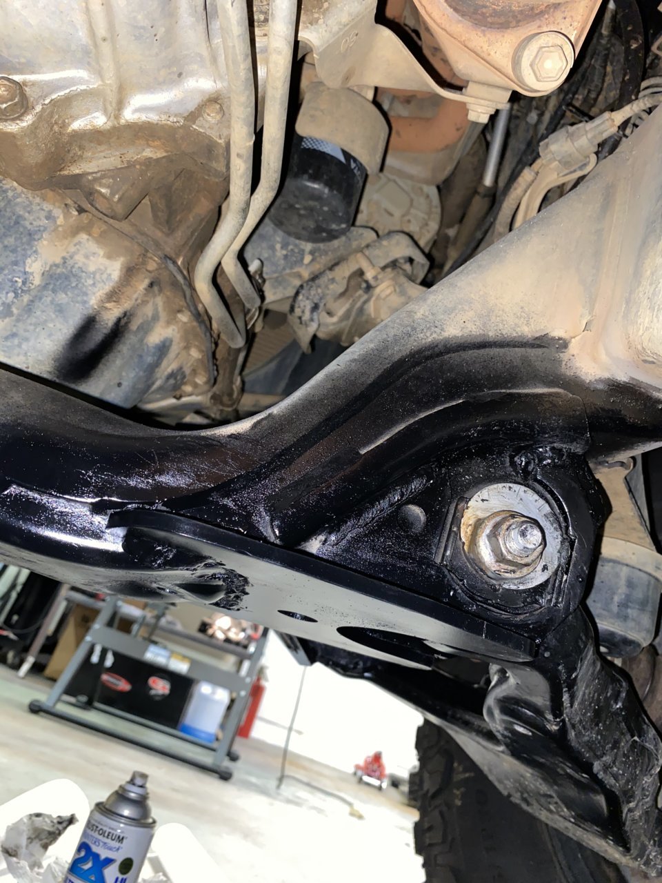

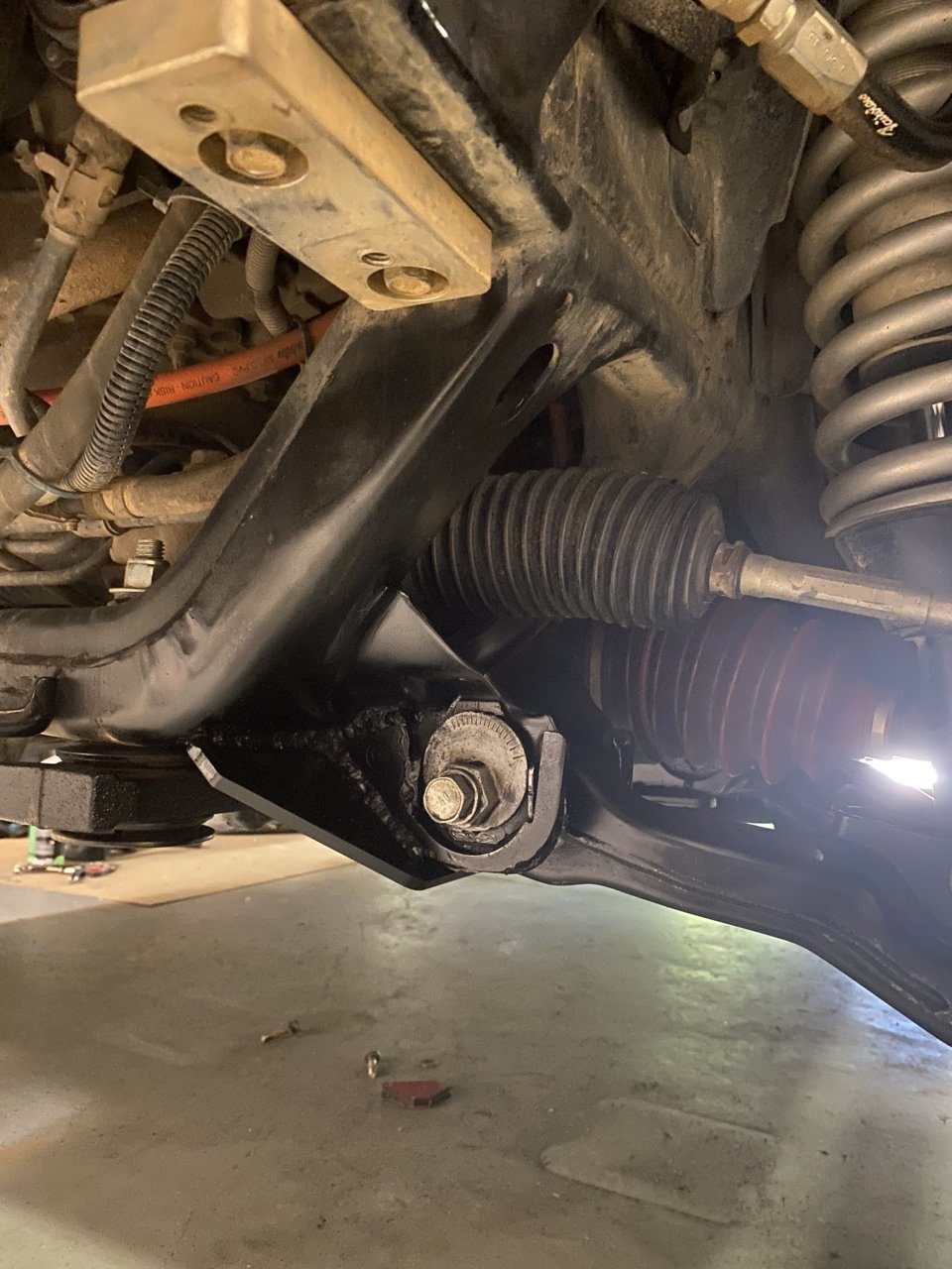

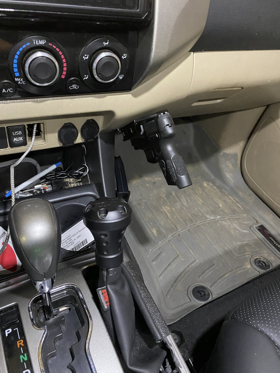

    Installed the marlin crawler gussets. PITA if you are on the ground welding. But non the less finished. Also mounted up the Vulcan quick draw.

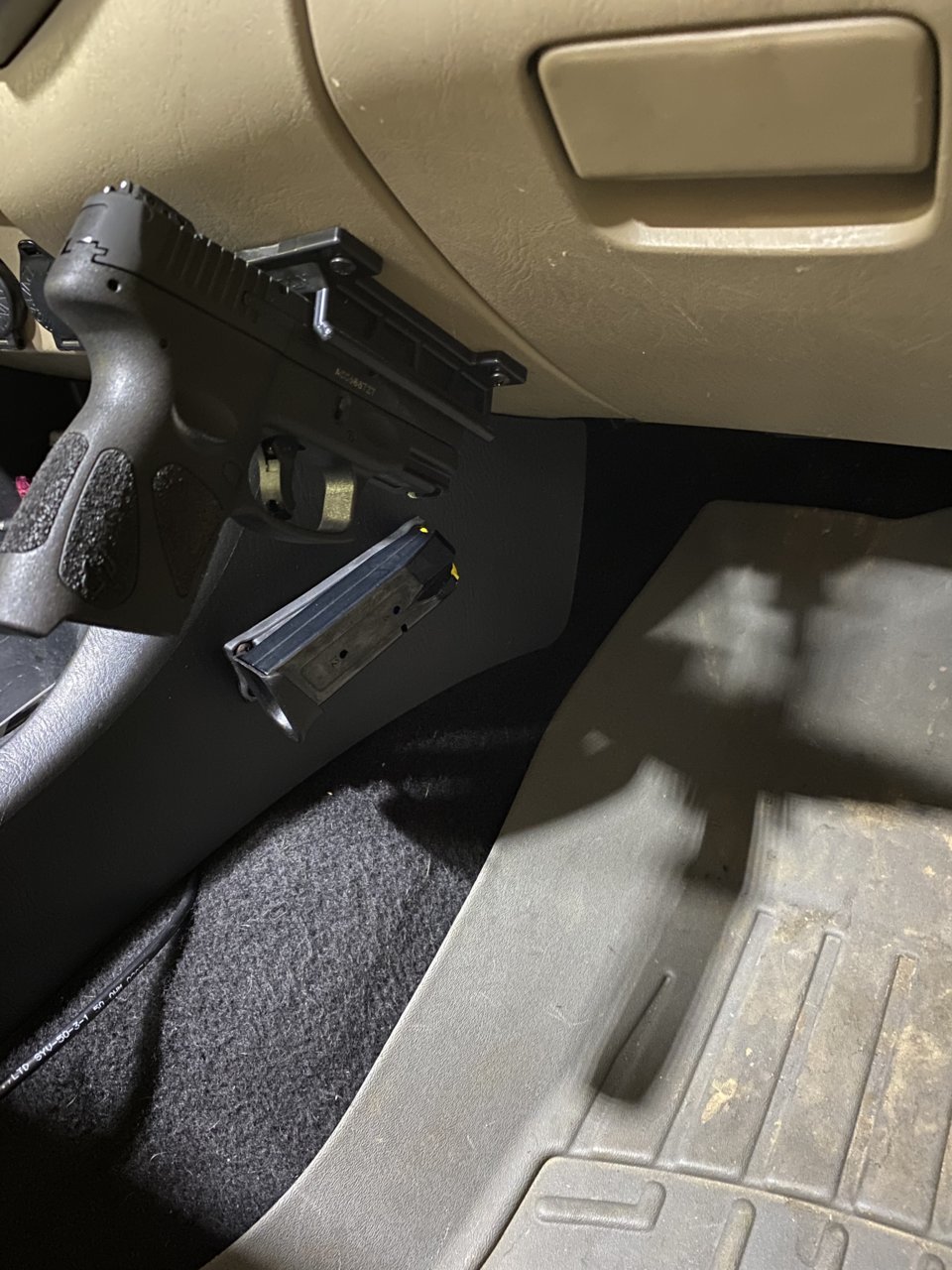

    So like... What do you do with the hole puncher when you're not in your truck?
