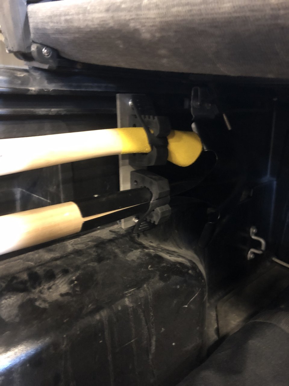

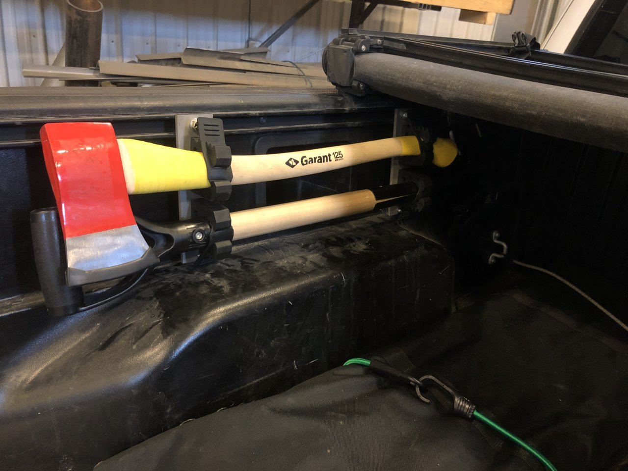

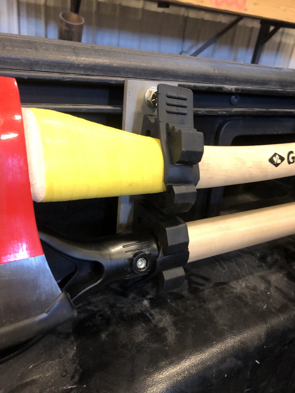

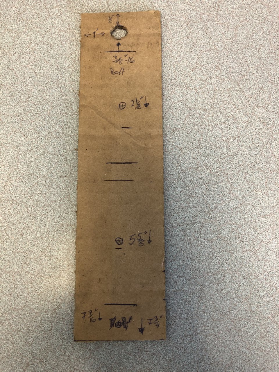

    Homemade ax/shovel mount. 1/4x2 FB, some holes, bolts, hose and quickfists.

    Simple and effective, like it!

    Thanks man! I was going to do some fancy cutting/bending and just thought, what am I doing. Keep it simple, stupid.
    Anyone looking to do something similar in future, I would recommend adding something for dampening down at the bottom. I used some old hose, didn’t want anything rubbing the bed.

    I was wondering what the hose was for in your description lol

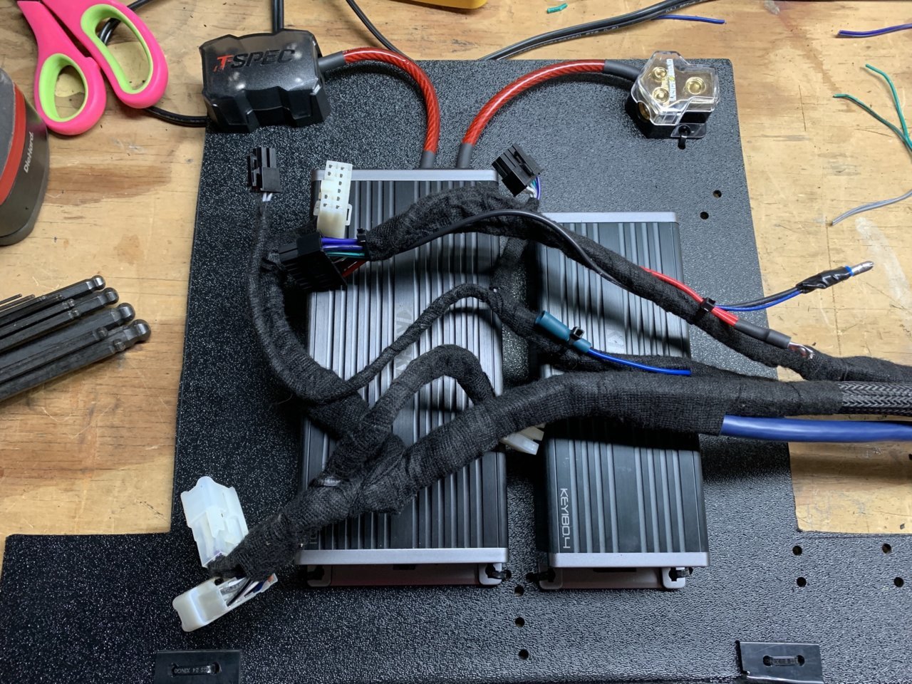

    Finished the harness for my Kicker Key 180.4 and 500.1. Just need a dry day to drop it in.
    After a second thought I added a little toe guard to the amp rack to keep kiddos from kicking the wiring. Also drilled spots for securing the wiring down with zip ties once I get the harness snaked through the dash and center console.

    Is this going under the passenger seat?

    Driver. Seat spacers look like they’ll give me plenty of clearance, and the amp board only lifts the amps enough to clear the floor vent.
