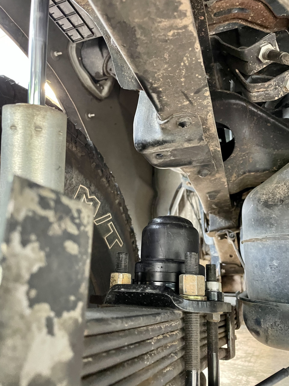

    Cycled the suspension after getting the @ARCHIVE u bolt flip kit with the superbumps and came to realize that I need to space them up a little bit with the extended shocks. Got the superbump 3/8 spacer and ground the bolt down that they offer just a little as with the low profile kit archive makes, the bolt bottoms out.
    Before:
    After:
    Got the Poly Performance taco tab kit to eliminate having to align my truck every time that I go wheeling. Now will just have to adjust toe. This will also eliminate the cam tabs from becoming bent.

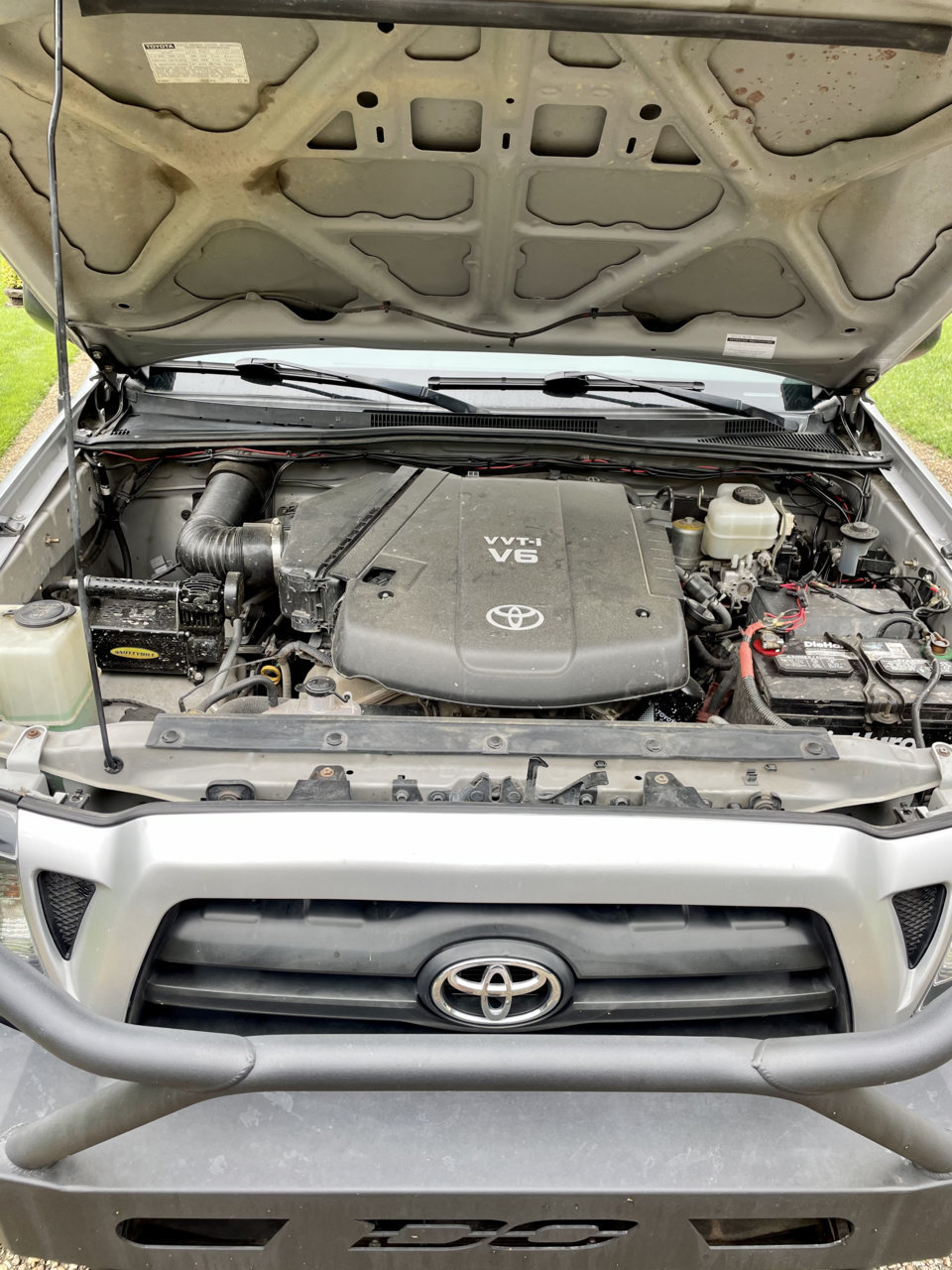

    While I had the skid plates off doing maintenance, I went ahead and gave the engine bay and where the underside doesn’t get to see the sun a quick wash with some degreaser. I also replaced the serpentine belt while I had easy access. The original one (I’m assuming) hardly showed any signs of wear with 130k but good piece of mind to have a new one. Toyota oem parts are some of the strongest/longest lasting parts I have come across while working on all sorts of vehicles.

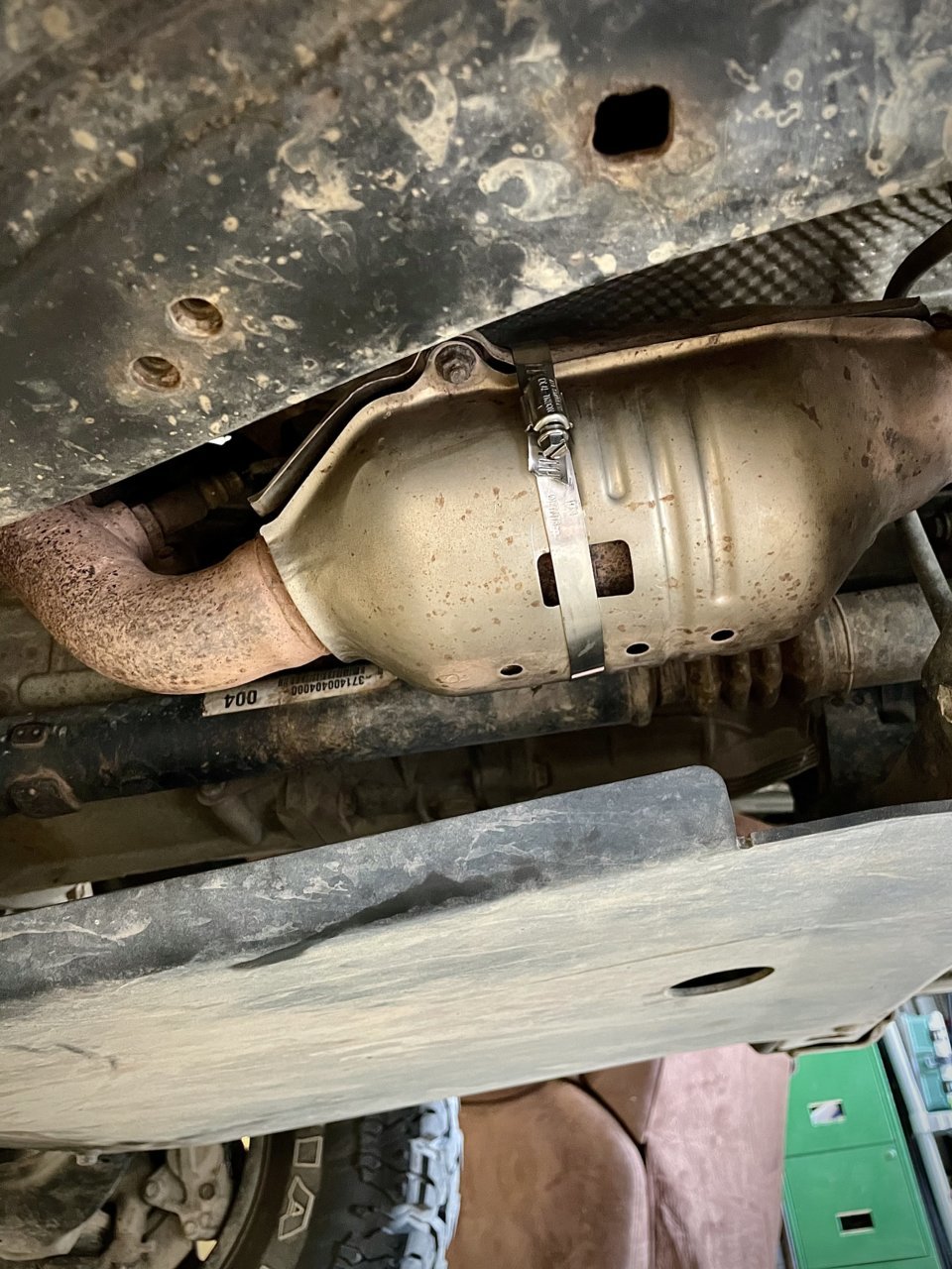

    I tracked down my exhaust system rattle to this heat shield with a missing bolt/nut. Secured it with a hose clamp for now and has appeared to do the trick. I will probably just let this ride, as is.

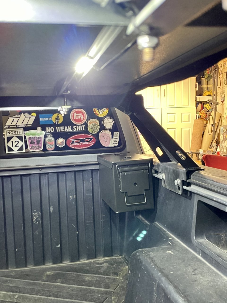

    Mounted an ammo can to store some recovery gear in, so that I can free up some space in the cab toolboxes.
    28170533-B912-4DDA-BD09-6CB3B879EBD6.jpg 2096AABE-F711-4EBC-A616-46F10A7D4038.jpg
    Removed the Cali-Raised side shooter pods in prep for the long awaited Baja designs s1’s. Also got some of the flush mounted S1’s for the rear bumper.

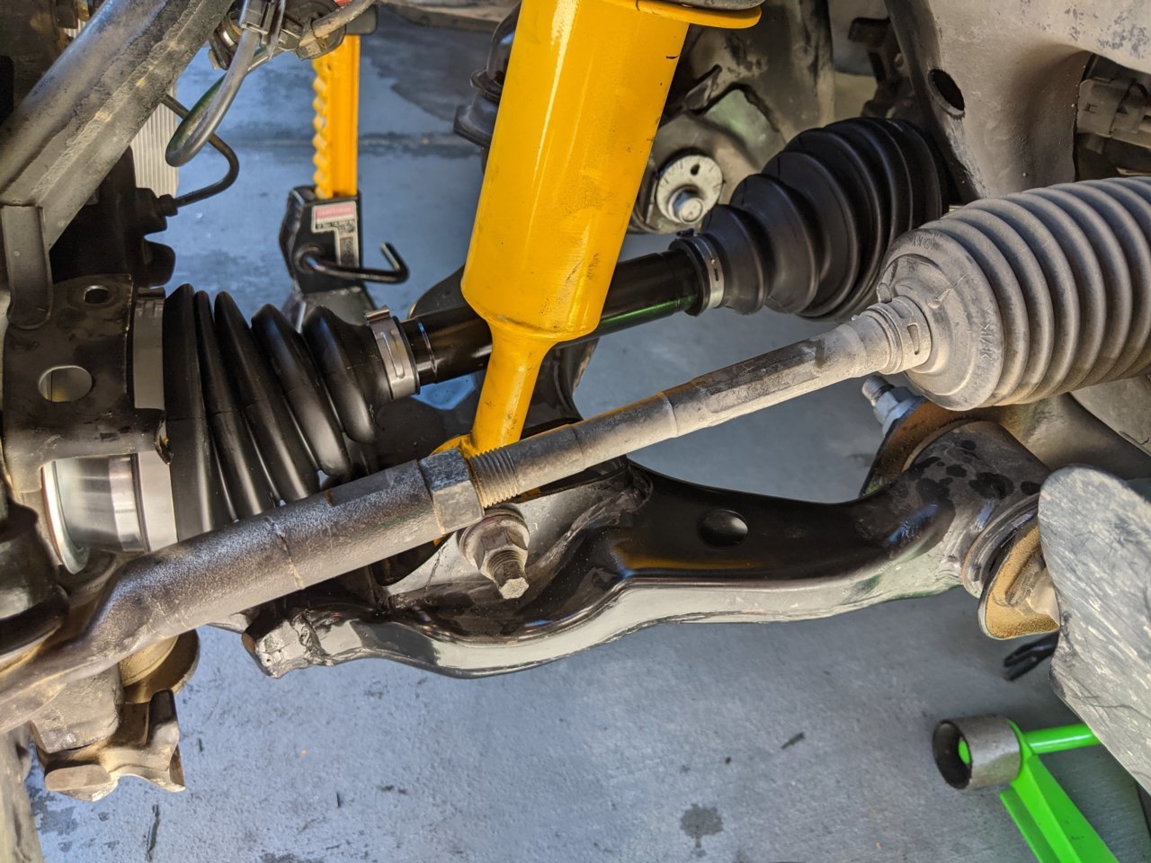

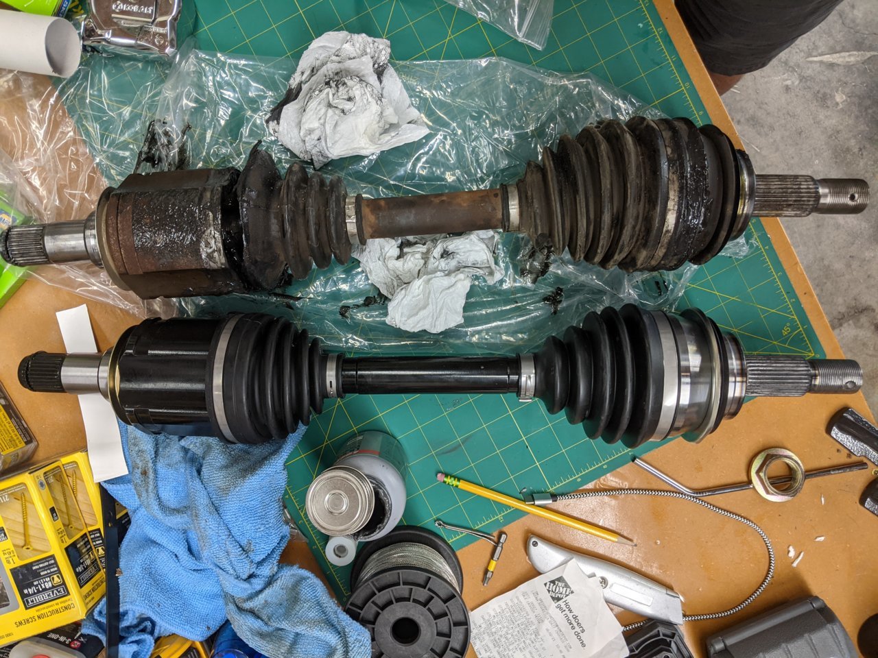

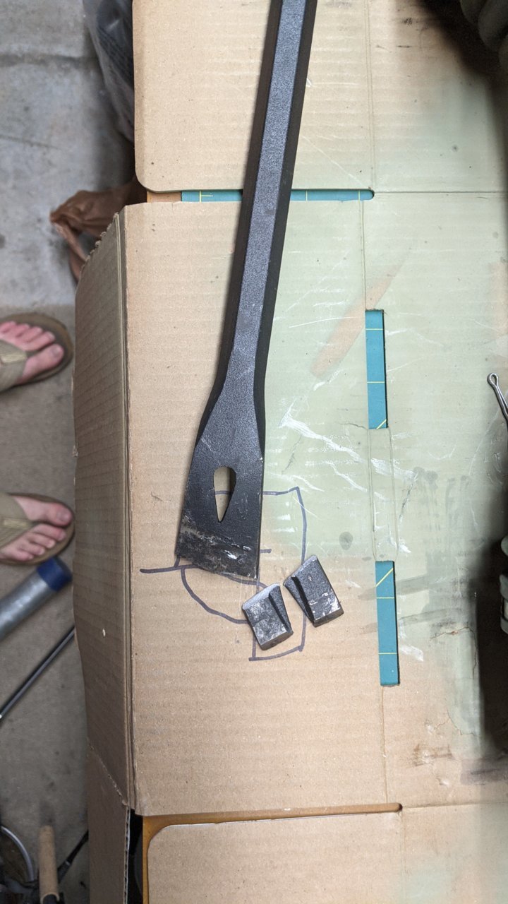

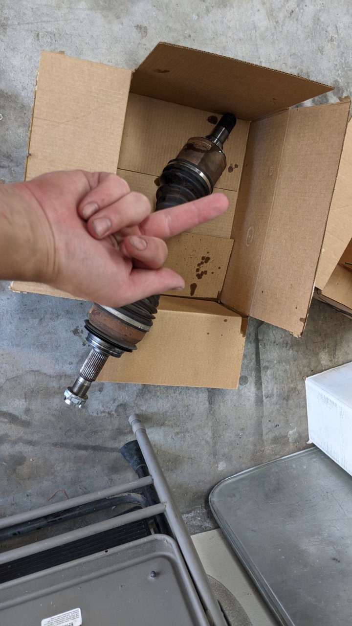

    Replaced my driver's side CV axle.
    I replaced the PS CV axle (as seen in my quoted post) after it failed while wheeling a little while back. Turns out both my PS and DS CV axles were non-OEM (and upon inspection, had some questionable dimensions... which could have explained the failure). So I decided to replace the DS axle as well to prevent a similar failure on that side.
    The DS stub shaft REALLY, REALLY did not want to come out of the diff. The PS came out fairly easily. The DS took about two hours just to get the stub shaft out and broke my damn crow bar while trying. Finally got it out, but jesus it was a huge pain in the ass. Fun stuff. :goingcrazy:
    Shaft out:
    And new DS side axle installed:

    For future reference, I ended up getting some 3mm diameter 900ib strength rope from Amazon to pull these out. Good to have for the trail as well and takes up no room. Tie one side off to the back of the cv on the diff side then tie the other end off to a sledge hammer. Hold the axle straight then swing outwards and it pops out with a couple swings of the hammer.

    That's a good call. I tried to use that method with some 1/16th braided steel cable (stainless, 370lb breaking strength)... Snapped the damn cable on the 3rd or 4th swing. Definitely need a larger diameter for next time.
    In the end I got it out with a chisel, a BFH, and some well placed blows on the ridges on the stub shaft tulip cup.
    Thanks for the input!
