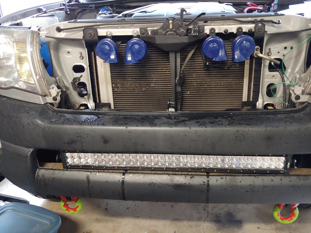

    What kinda horn is that?

    They are all hella supertones

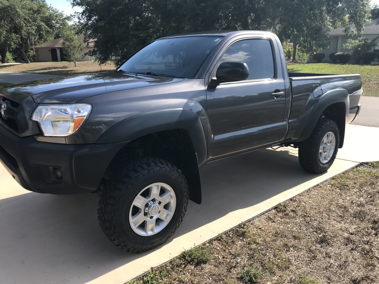

    Sharp single cab. No gingerbread needed. Well done sir. :thumbsup:

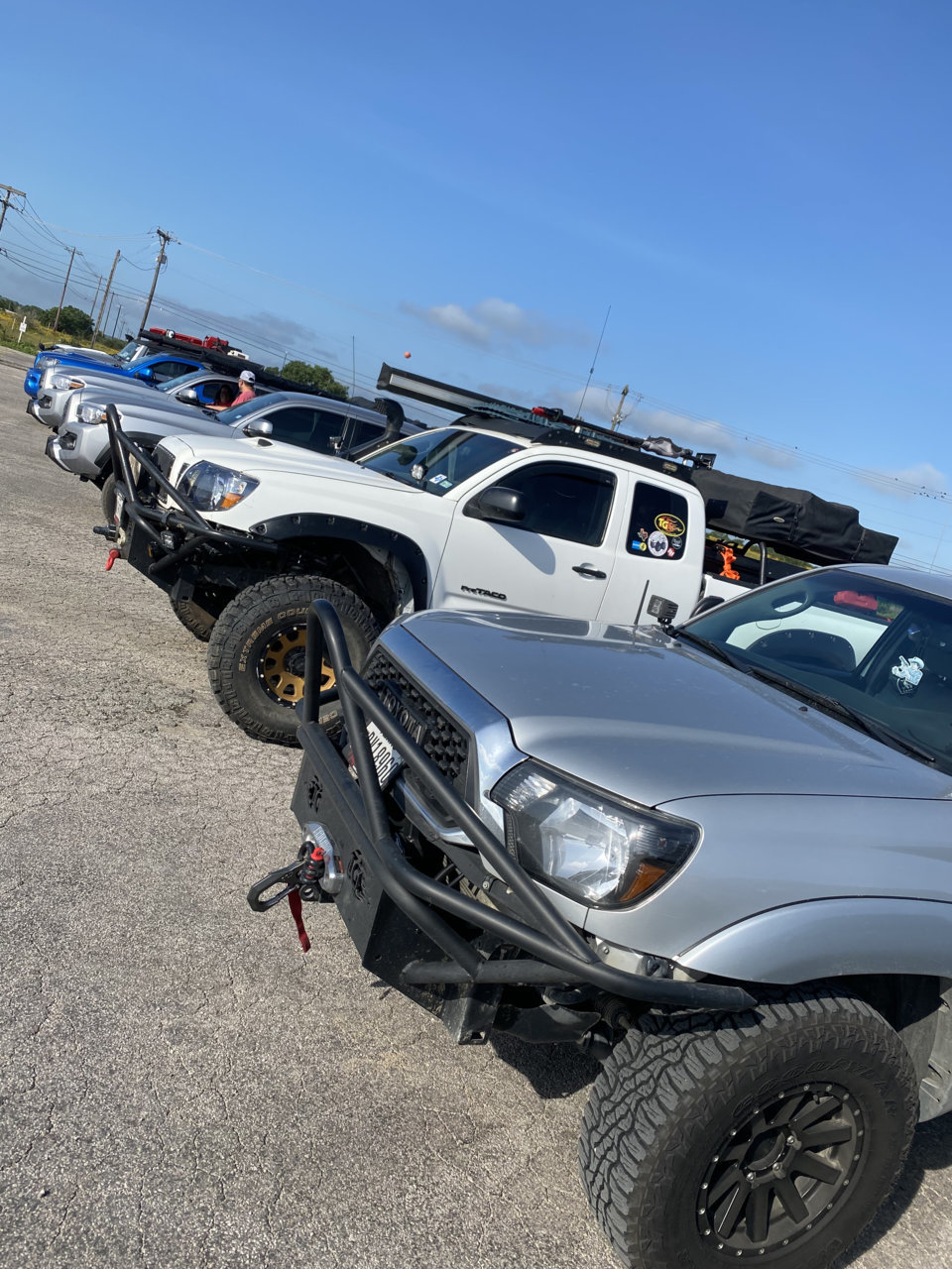

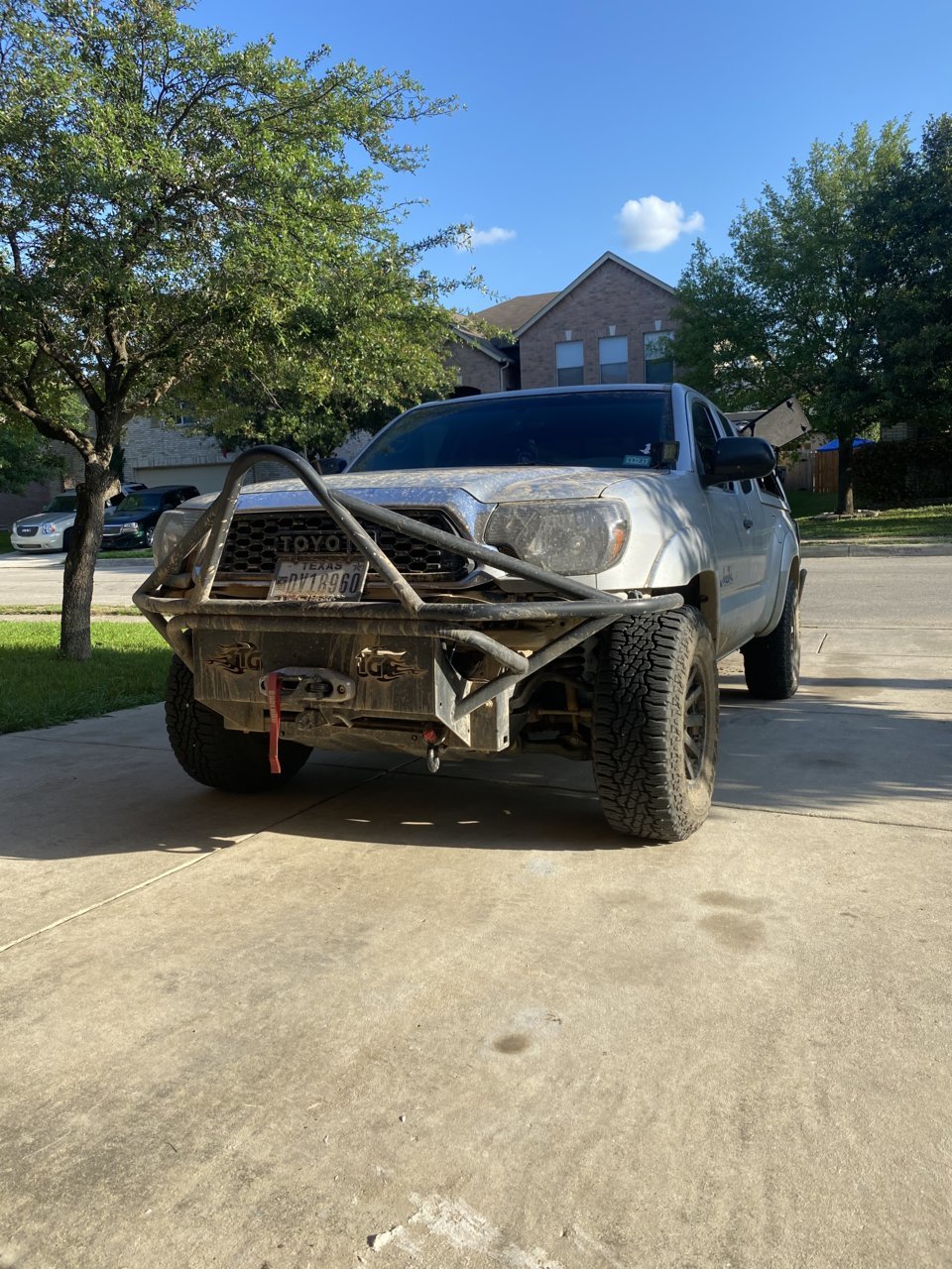

    Went on a long trail run yesterday with a great group of people. My Tacoma impressed me more and more everyday

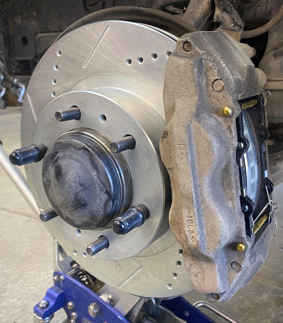

    No pics for now, but I had the brakes done Friday at 158k miles. New rotors and pads, serviced calipers. They informed me the rear drums should be fine for another 20k or so.

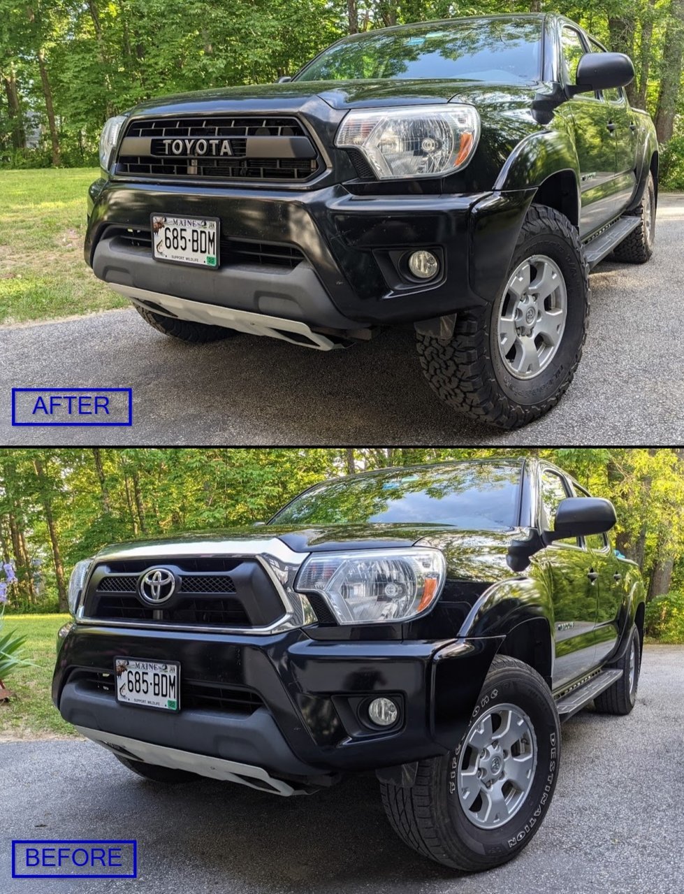

    Added fake pro-grill, swapped chrome grill surround for black, upgraded tires to BFGoodrich A/T KO2s (265/75R16).

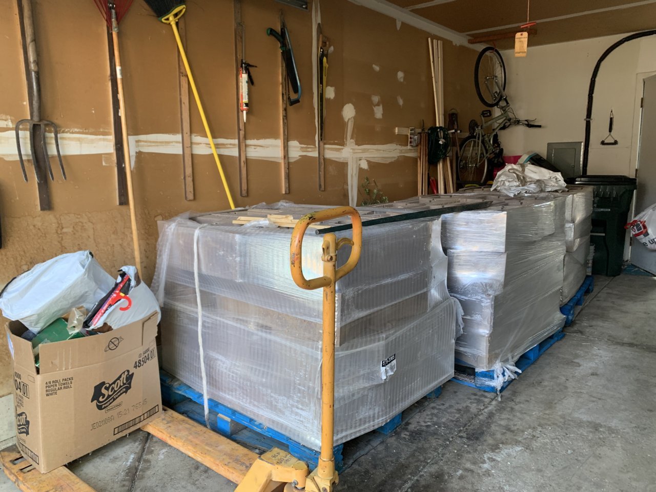

    What a weekend.
    Put her to work yesterday hauling stone. Maxed out the towing capacity; first load two pallets and the last load was just one. Definitely felt the load and the difference between two pallets and one was definitely noticeable.

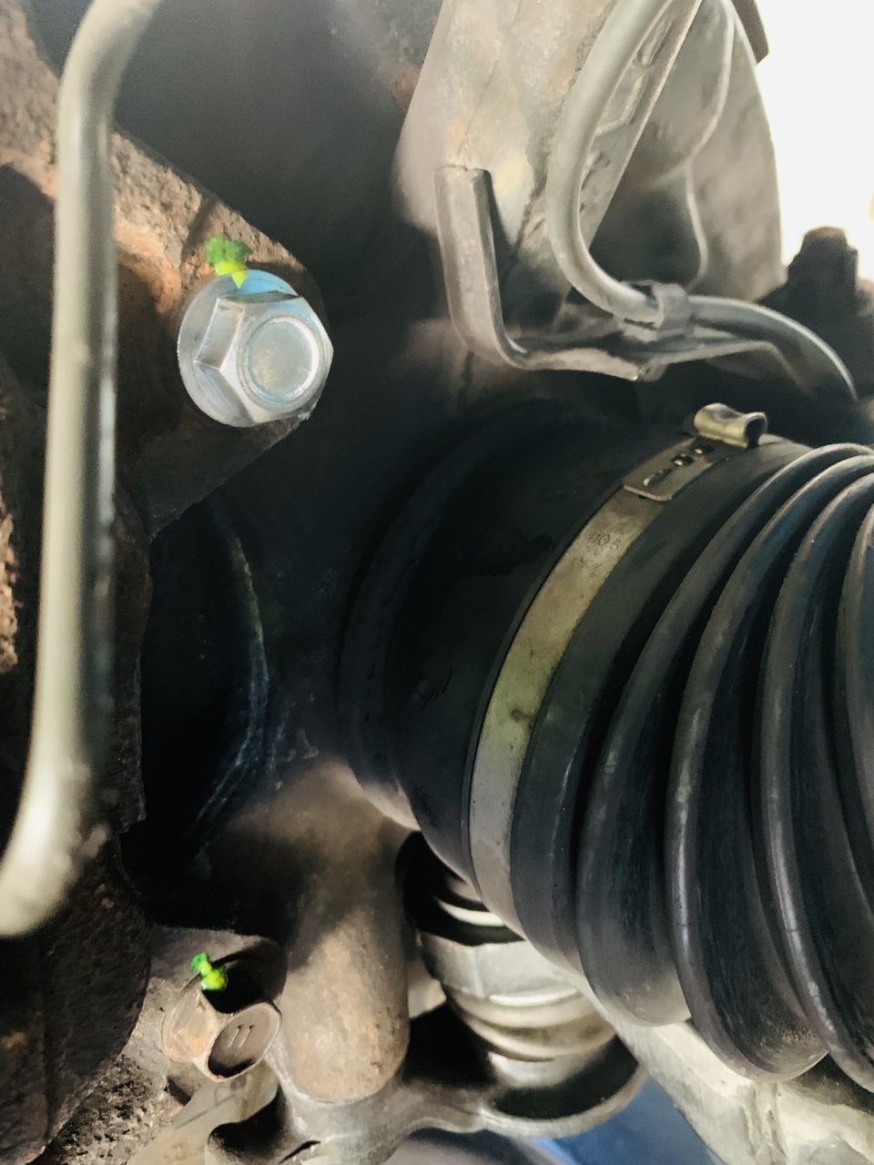

    New brake caliper bolt installed. Found out Friday afternoon after a clunking noise under quick and heavier braking. Temporary fix installed on Friday, grabbed the bolts from the auto parts store, installed them today, torqued and marked.

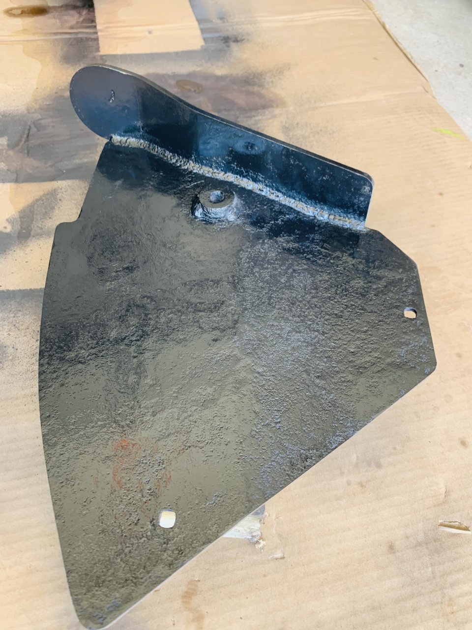

    Last up was cleaning up the BAMF LCA skids. WHAT A MESS. Like the gas tank skid last year, CHUNKS of steel and dirt came off. Nothing crazy to where I would question running them again. Since they're only skids, I didn't waste too much time cleaning them up and getting them prestine. If it was something more important, I would spend more time on it. Considering how long it has been since they were installed, they are in pretty decent shape. Really a testiment to the build quality of BAMF's products. I'm getting them painted up with Rust-Oleum rust barrier right now. Plan is to coat the inside with Rust-Oleum high performance enamel and coat that with anti-seize. The outside will just be Rust-Oleum matte black paint for ease of touchups.
    Before:
    After cleanup:
    Paint:

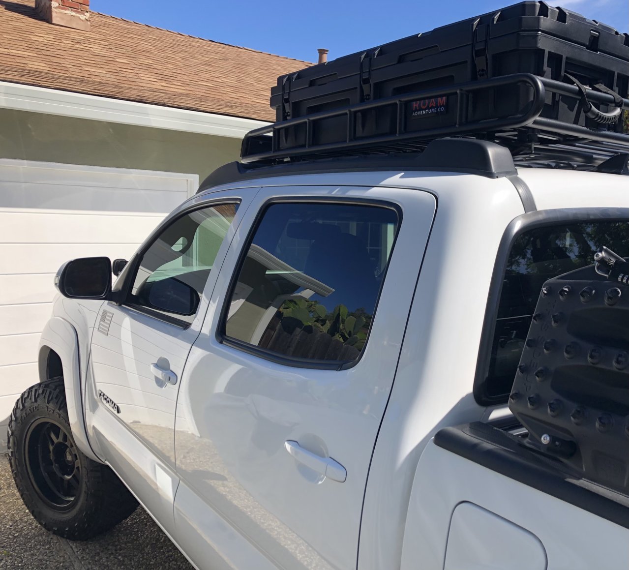

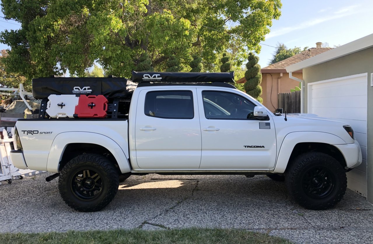

    Added some rotopax the other day and decided to give the roam cases a try.

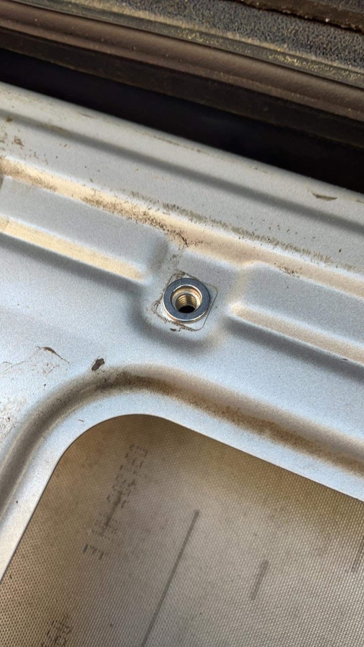

    Replaced the stripped out plastic screw retainers for 1/4-20 rivnuts and button head bolts for the tailgate.

    Nice light setup
