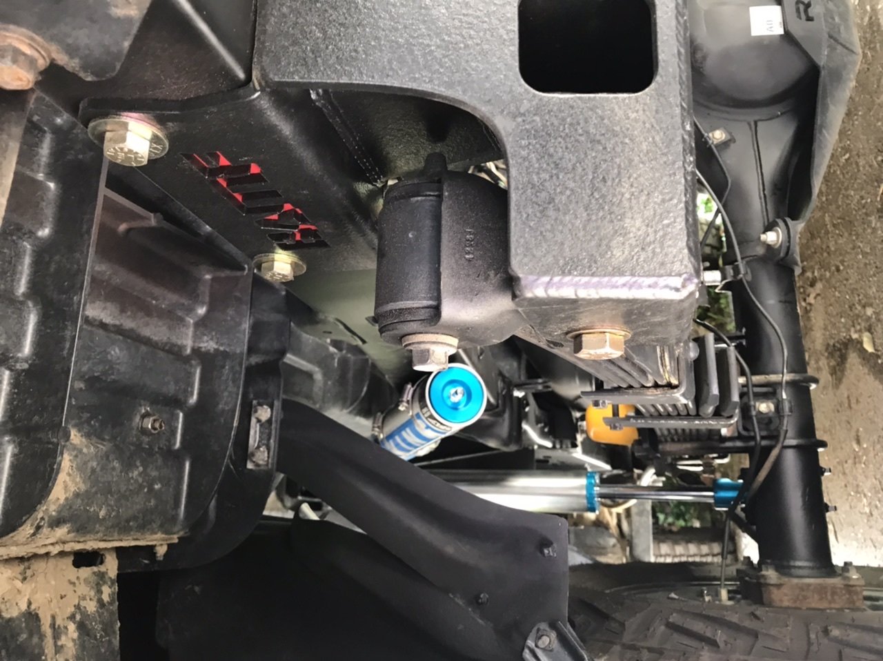

    A couple more shots of the back revamp..
    A little recap: Added BAMF leaf hangers, newer used set of Dakars with a new AAL with new energy suspension bushings, new Archive Speedbump bumpstops, Archive shock relocation and new King 12” 2.5 shocks with adjusters.

    Oh and you cant really see em here but added double shear limit strap eyes. Limit straps on order..
    edit: and added extended steel brake lines from Wheelers

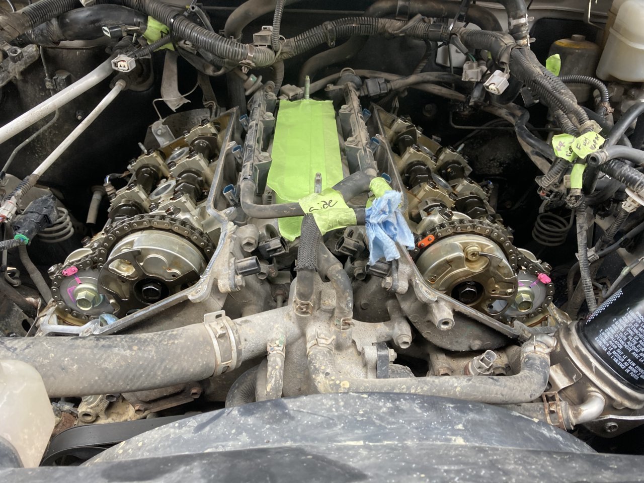

    Yesterday I installed a set of @mightytacoman exhaust cam gears, fixed my valve cover leak, and cleaned up my throttle body while I was in there. Test drove it today. Wish I had done this a long time ago, the engine feels much happier.

    how many miles? Top end looks clean

    147,000. I was pretty happy with how it looked.

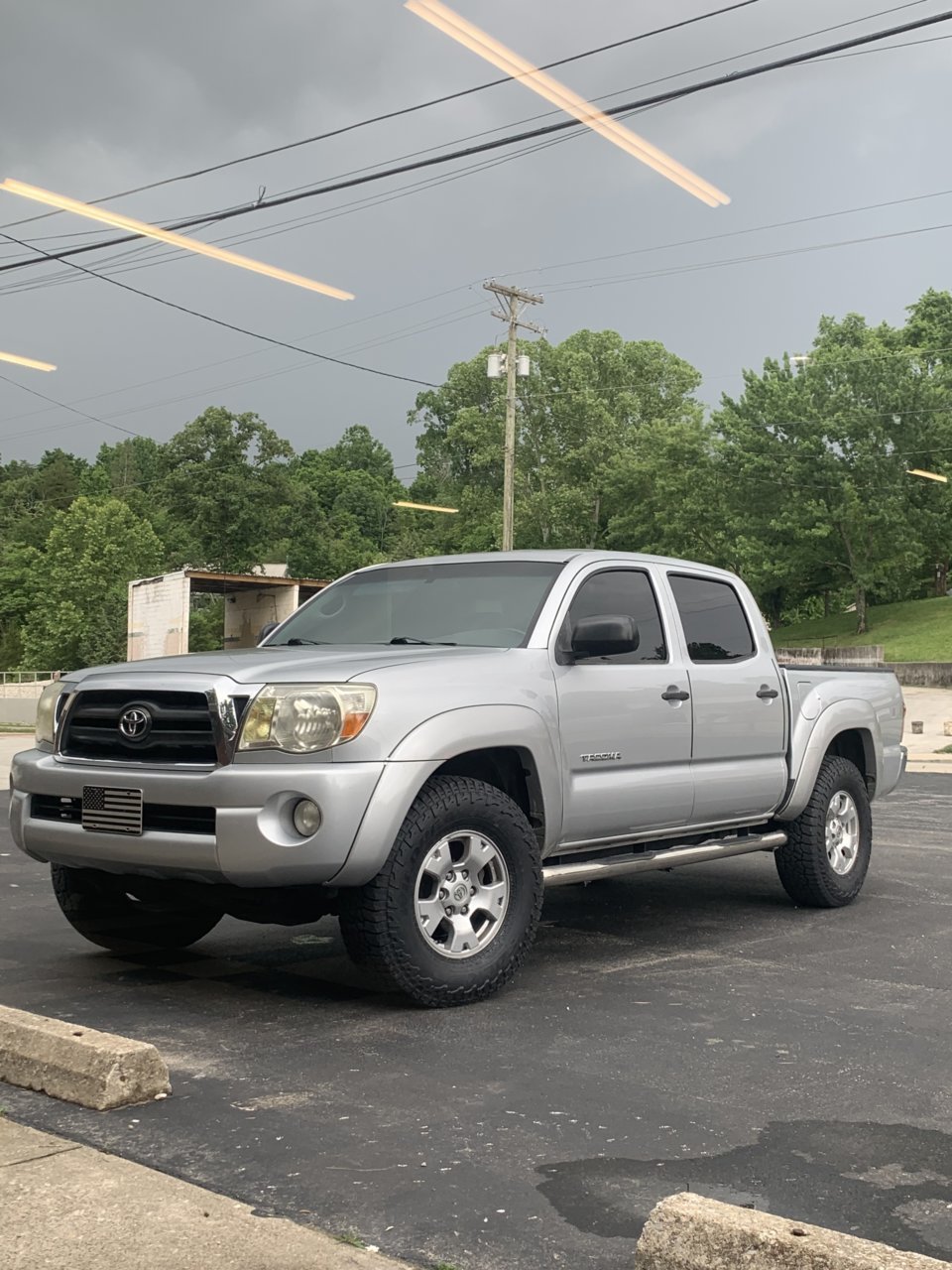

    Got a new set of tires on Friday. Great improvement from the bald ones I had before!

    why you go BAMF hangers over Archive? Just curious.

    When I installed mine it was because Archive had a design flaw where the shackle could flip to the bottom of the hanger but I think that's been fixed
