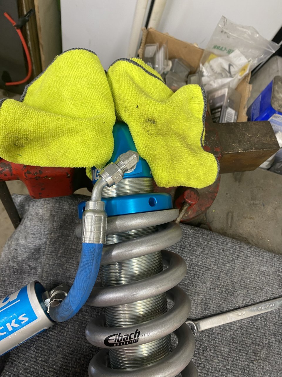

    It all comes down to block height of the specific coil you’re looking at. Block height is how long the coil is when it’s fully compressed and the rings start touching each other.
    When the shock is fully compressed, the two coil seats must be longer than the coil block height. That’s why I have so little preload right now. Any more and I would be bottoming out the coil before the shock.
    I was just discussing this with a friend earlier today. He’s going to put softer 16” coils on his fox mid travel. We pulled some measurements with the coilover on the truck and it should fit. We’ll confirm once he gets it off the truck by taking more accurate measurements.

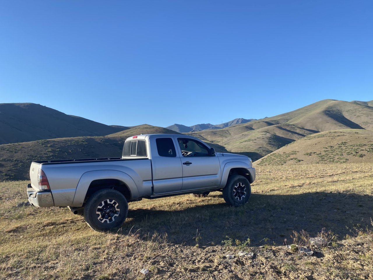

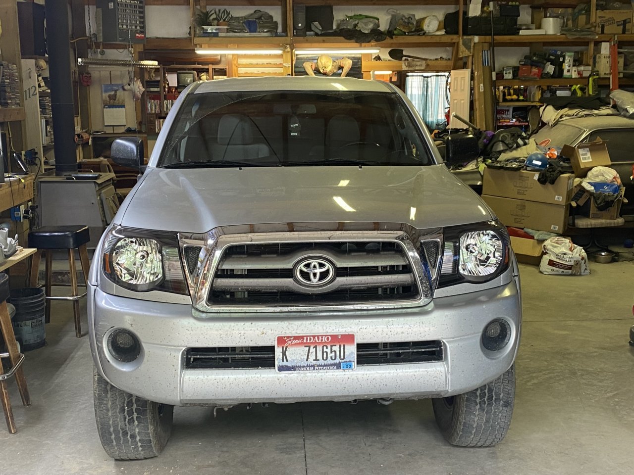

    Been busy the last couple months. But here’s what I’ve accomplished on my truck. Installed bilstein 5100s on it. With eibach 2.5” lift coils up front. As well as a Icon add a leaf. Pulled the factory overload and put the Icon set in. Lifted the rear 1.5” so she sits pretty damn level. Maybe a 1/4” higher in the rear.
    Today I installed some Amazon sourced headlight housings and led bulbs. Will see how they hold up. Spent like 180 on the setup. So if the new headlights suck I’ll figure out the next move. Should be a giant improvement over the stock ones!! Also ordered new wheels and tires. Will
    Update pics and offset info once completed!!!

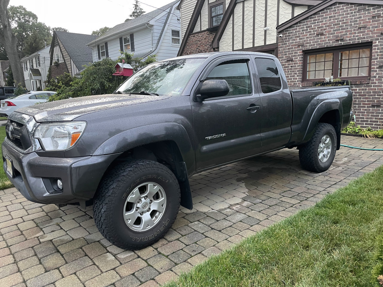

    Putting on TRD pro wheels in the morning!

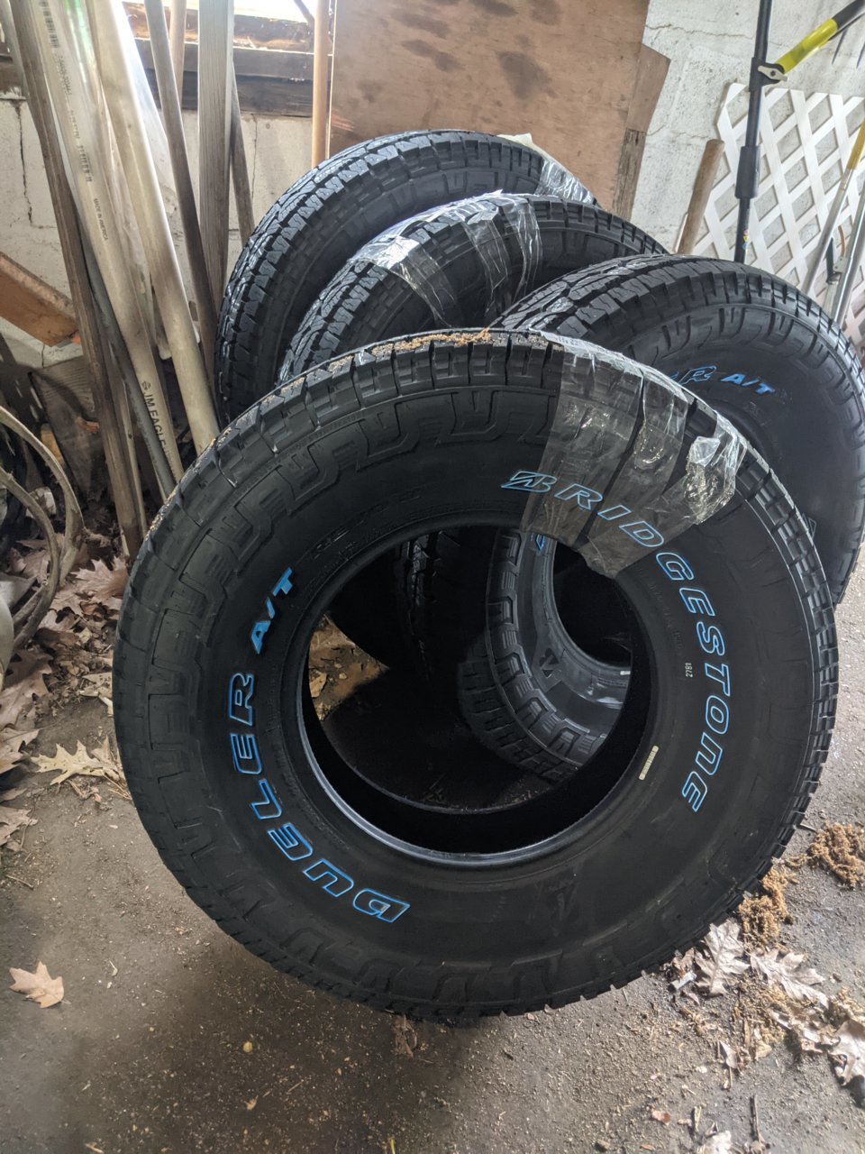

    New sneakers... Psyche!

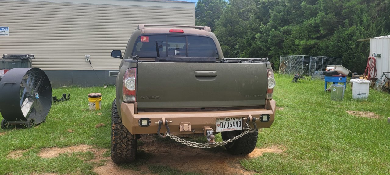

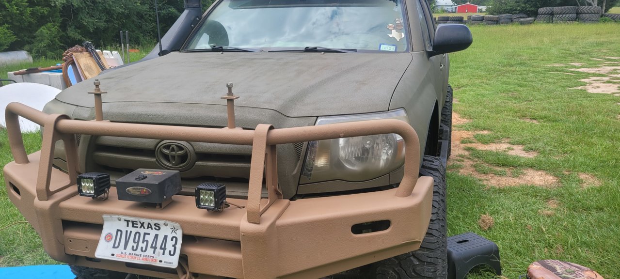

    Pro Comp 6in lift w/ Icon Coilovers,AllPro UCA's, AllPro Baja Leaf pack, Bilstein 5150's in the rear. Tires Mickey Thompson MTZ 275/70R18 w/ procomp 7089 wheels. ARB front bumper with mile marker winch, Custom made all quarter inch steel rear bumper. Demello rock crusher slider's. CoverKing neoprene seat cover's, AllPro trail armor All-pro U-bolt flip kit with Timbren bump stops and many many many other mods, way to many to list.

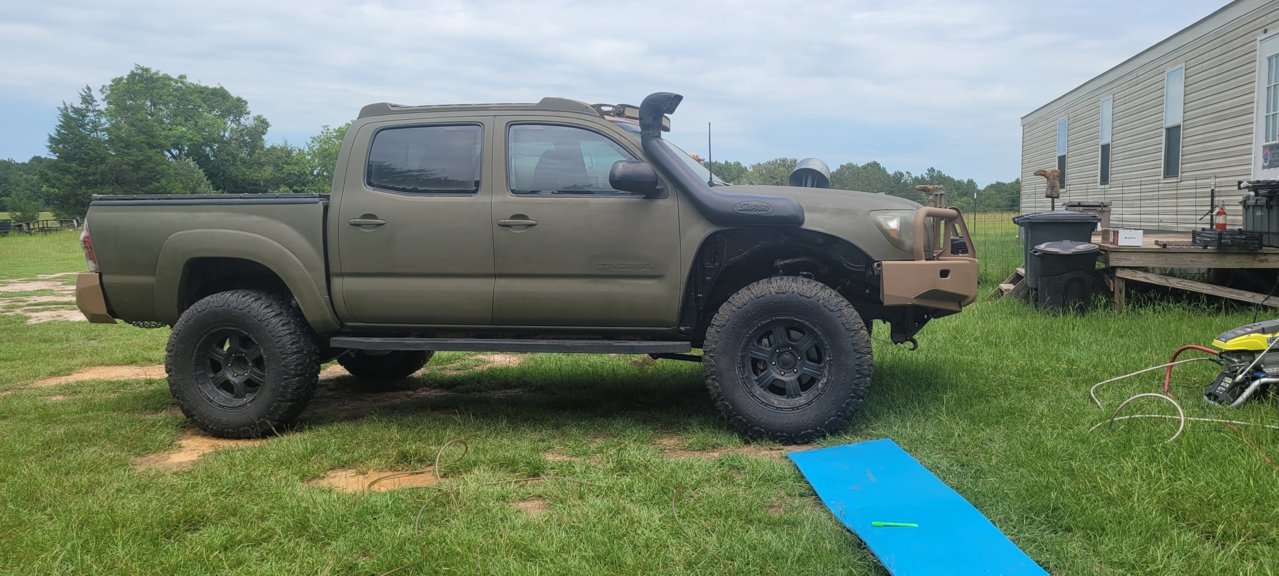

    I cerakoted my truck in air cure OD green and DOD 20150. Also cut tye front fenders.
