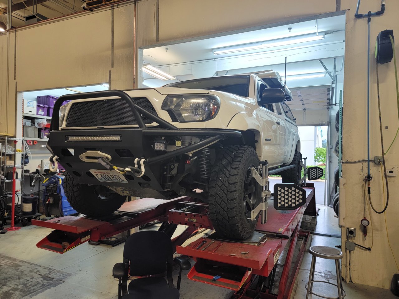

    Me too. Ordered some and the Marlin crawler kit. Got alignment the other day and smooshed the tabs and seized bolts

    Yup I knew mine where bad but last time I brought it in they told me they wouldn't be able to really do anything with the cam tabs, over half are bent and wont contact. and the bolts don't want to move. That's the kit I'm going to go with also. Seems way stronger then the Total Chaos ones for a couple bucks more.

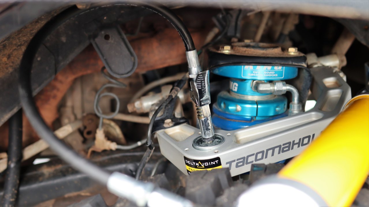

    Thats where I am at. I did my LCA ball joints in the spring and now the bushings are shot. I also need to do the cam bolts so I figure just do it all. The ball joints I got are Moog and greaseable which is just pointless due to the front drive shafts being right on top. There is no way to get a grease gun on them. I would have preferred a sealed one. Also why I am leaning towards all new ones.
