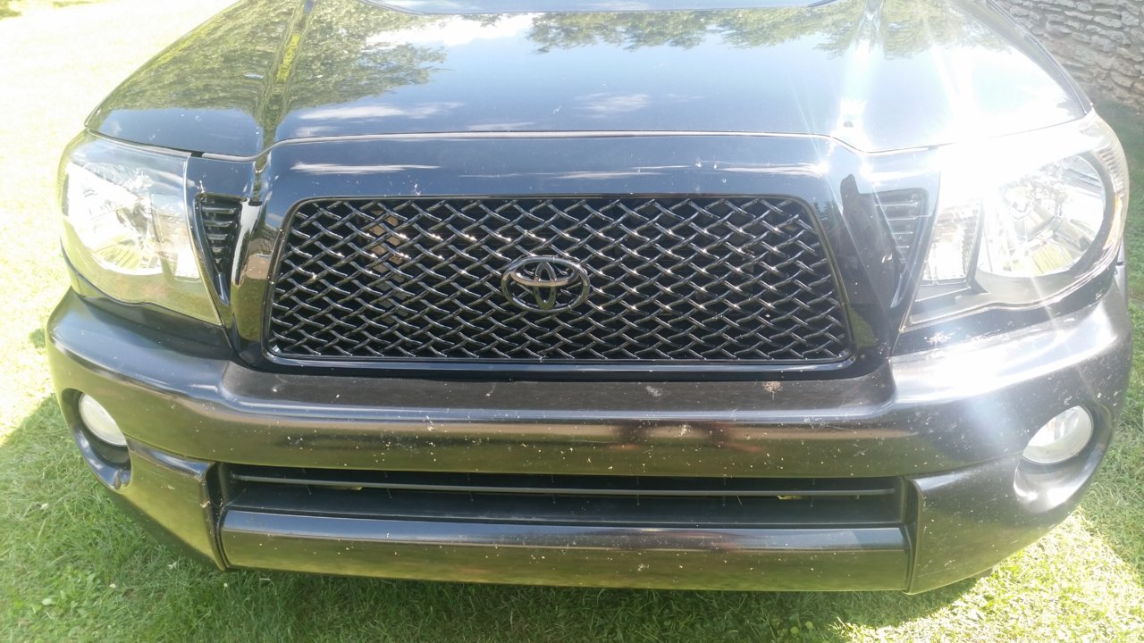

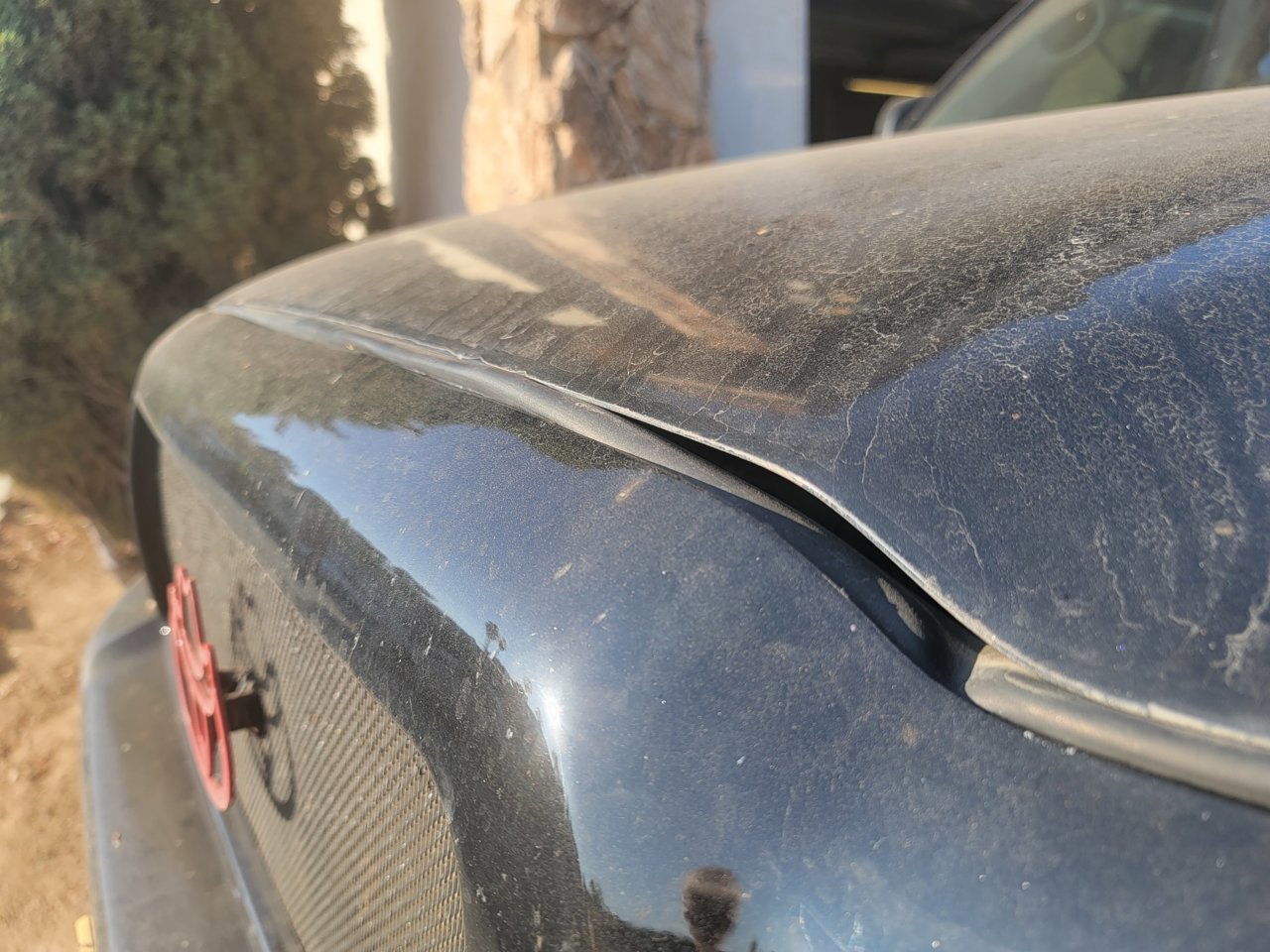

    That's the same grille I bought. I built a custom insert and emblem for it. Now about a year and a half later it's warping really badly. But damn that thing was inexpensive!

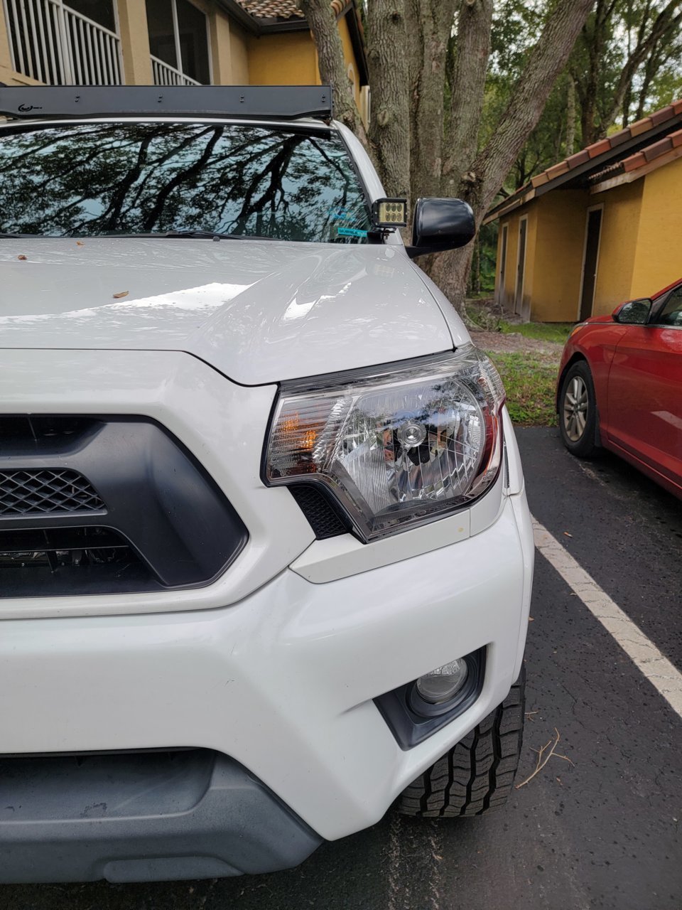

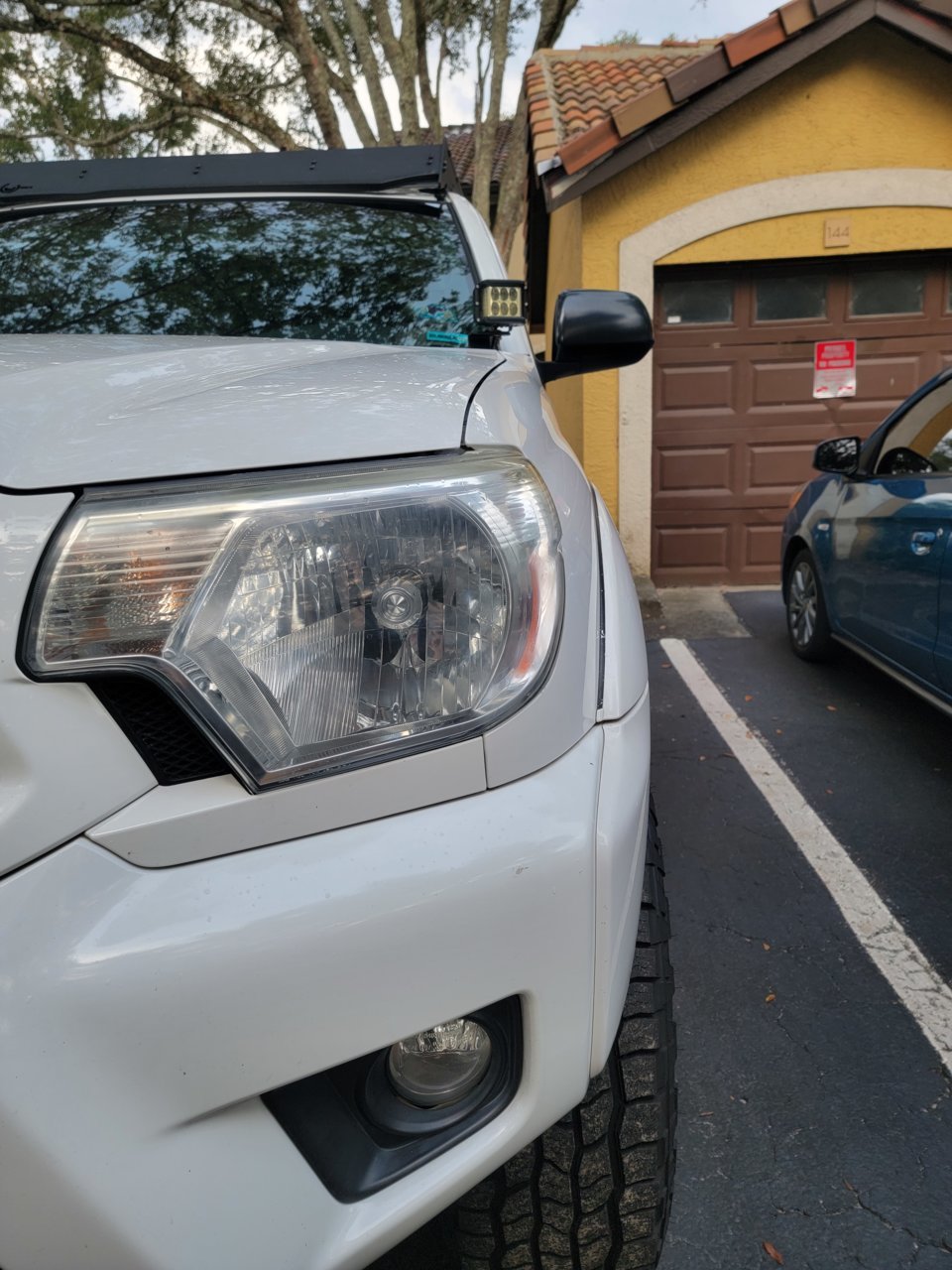

    Purchased TRD Pro Headlights + Ultimate Headlight mod from a tw member. Really happy with the light output!
    Old
    New

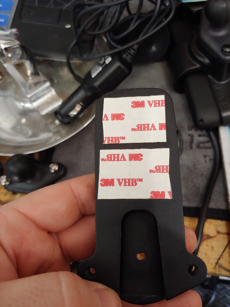

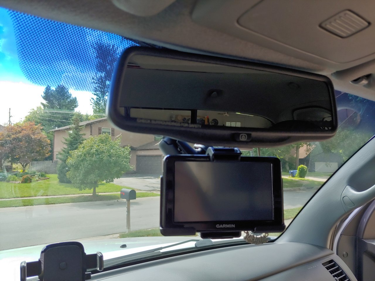

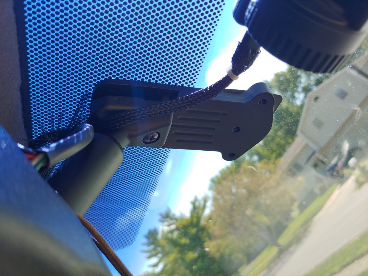

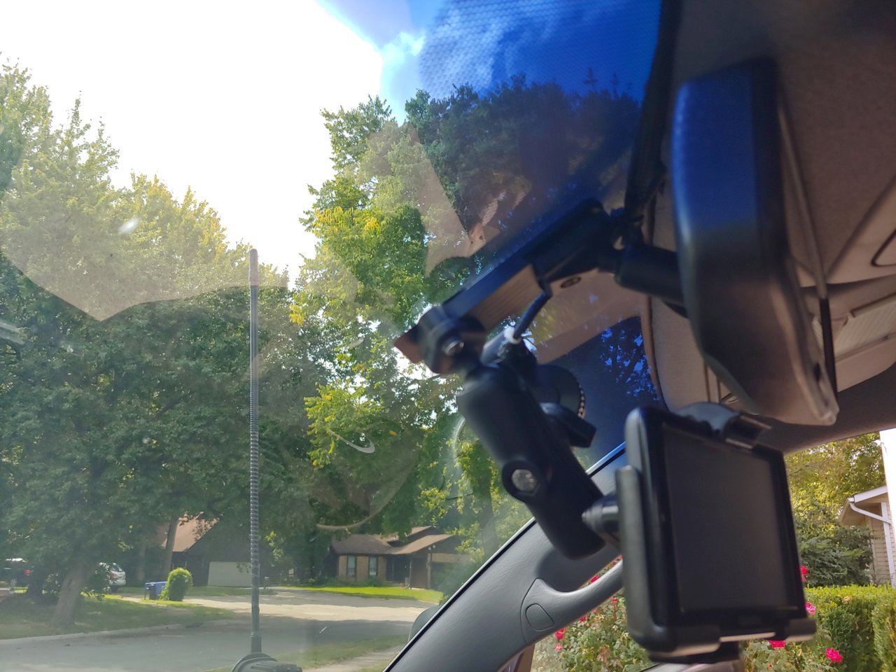

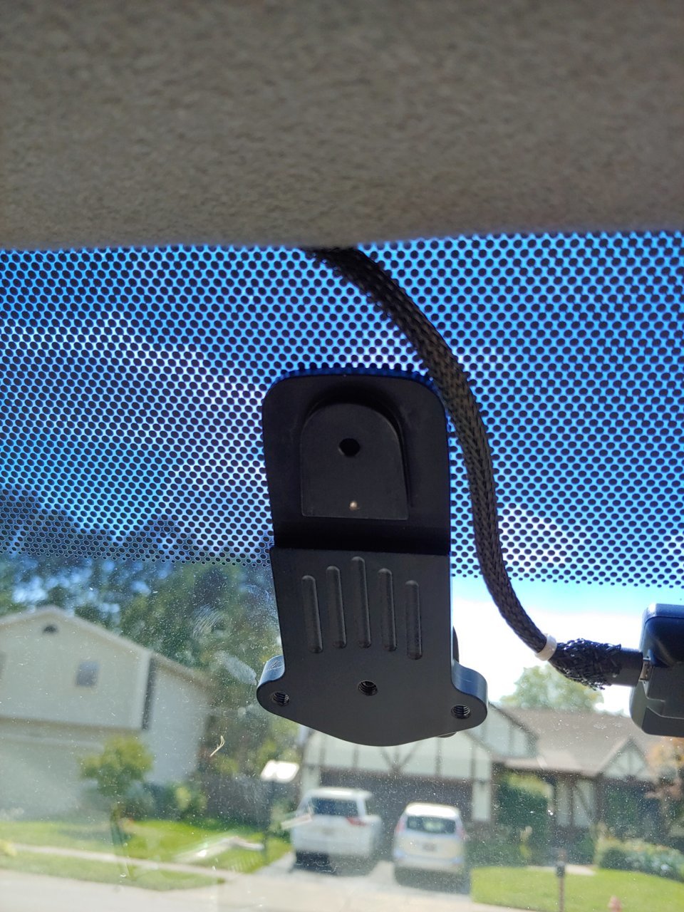

    Nothing too ground breaking. I made a small change to the BirdDawg riser I have, I saw the failure modes where it cracked at the attachment point on the windshield. They all looked like over-exerted pressure at a lateral angle, basically the riser looked like it levered the glass laminate apart. So I added some VHB to the back of it so it exerts pressure more evenly across the surface area of the riser, holding the weight of the mirror. I also added a diamond and attached a GPS I'd previously given to my wife, that she no longer needs since her new Highlander has Navigation built-in.

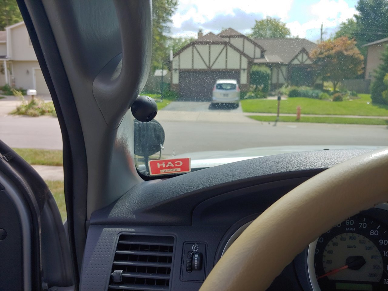

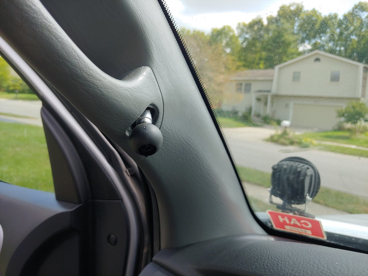

    I also added a RAM ball mount into my grab bar. I was going to use a long M6, but couldn't find one long enough. I was then just going to use one of the M8s it came with - but that meant drill out and installing a rivnut. So I started doing that process and ended up eating a drill bit. So instead I walked over, grabbed a tap, tapped it for a Helicoil since it was already drilled out bigger than M8, installed the Helicoil and then installed the damn mount.

    I did the same thing in a way. Be careful of the weight you put on the risor and don't over tighten screw, you'll immediately regret it.
    I use to hang a dash cam from there but I opted out from that mounting point when my new cam made it impossible.

    Yea, I only put the set screw in just enough to lever the top against the glass so the VHB could set.

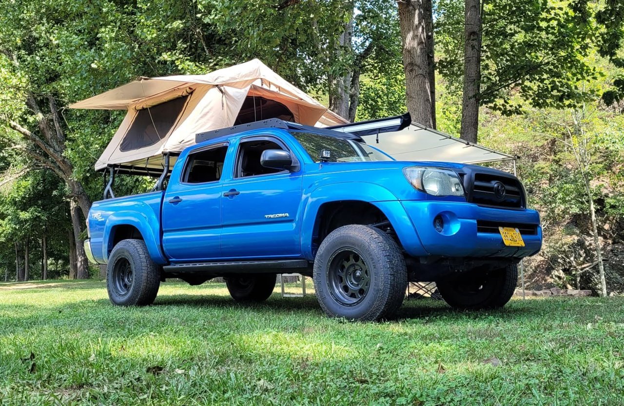

    It's been quite a while since I've posted but since my last post I have added the 16x10 KMC KM522'S, universal bed rack, Hooke Road roof rack, Smittybilt XL tent, and a cheap Amazon awning. Also added some Harbor Freight ditch lights that are 2x brighter than the Caliraised lights were.
