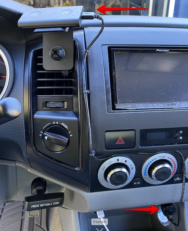

    Echo auto install

    I've been thinking about doing the same for the rear seats. Where did you pull the power from? Did you just run the wire under the center console pieces? Looks great!

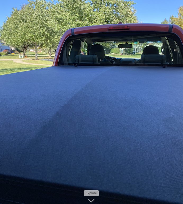

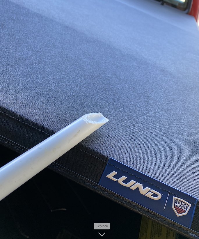

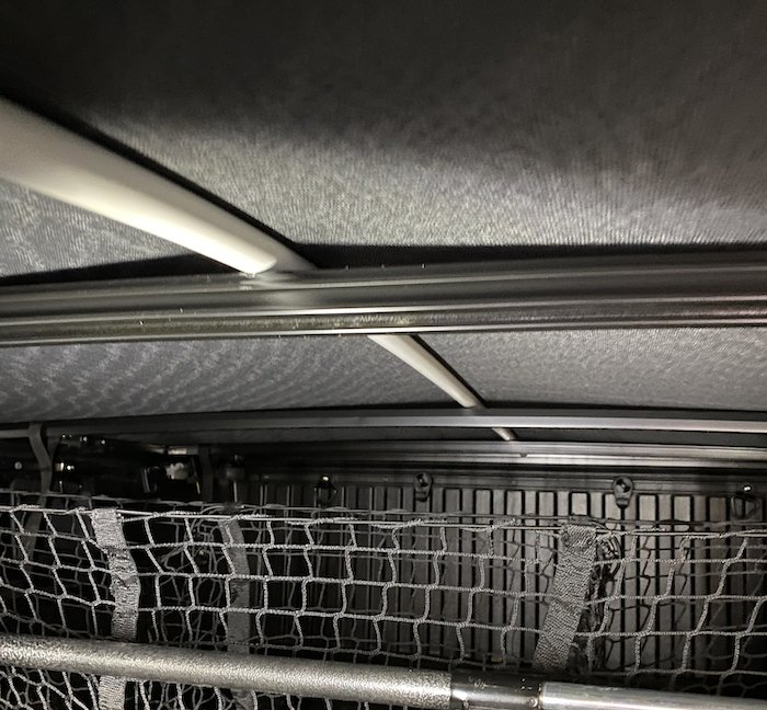

    Installed a make-shift center brace for my Lund tonneau cover to keep the rain from collecting.

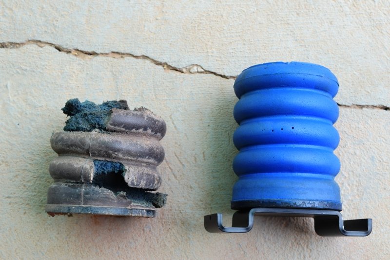

    Installed new Sumo Springs; the old ones lasted 3 years, not so bad in permanent off-road conditions
    I guess they should last 5 or 6 years in normal conditions / paved roads

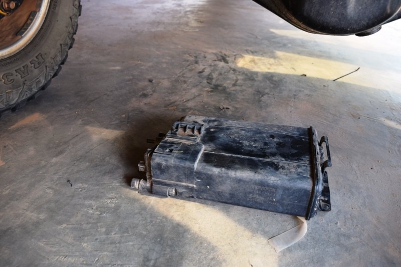

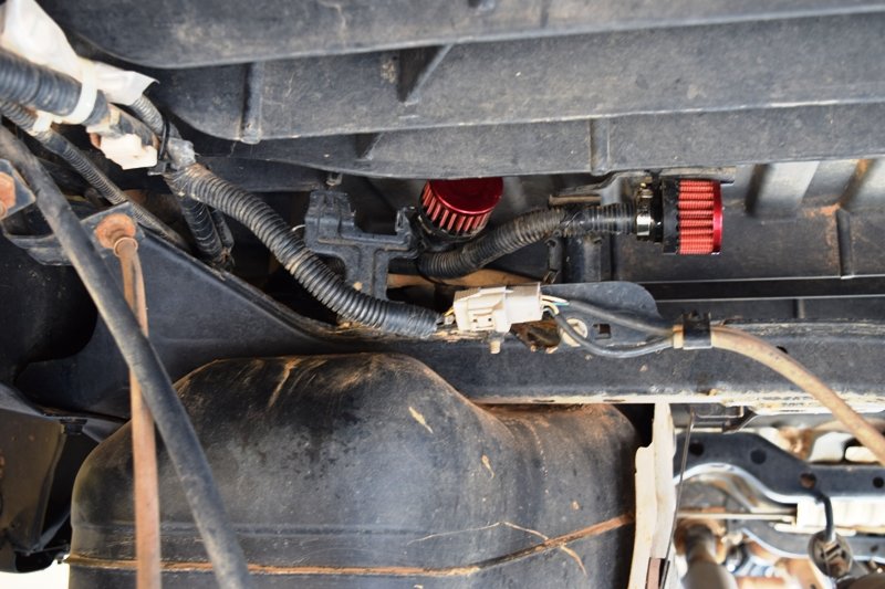

    And got rid of the problematic canister

    if i remember correctly, you have posted some seriously muddy conditions you deal with. Don't think those little filters are gonna cut it:oops:

    I'll give particular attention to that :)
    Thanks

    I’m not 100% sure, but that also might be a safety hazard as fuel vapors will come directly out of the gas tank and through one of those filters. I too have eliminated the evap canister but my fuel tank vent is in my filler neck and all lines running to or from the canister are sealed.

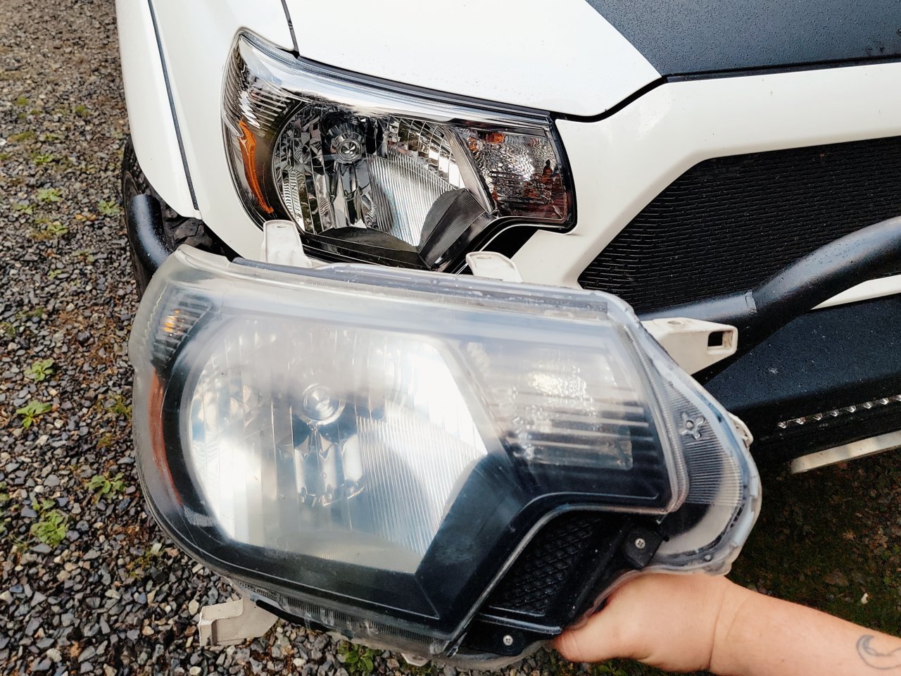

    Std or Pro lights?
  18. Sep 29, 2021 at 1:47 PM
    Wyckedan
    Wyckedan Well-Known Member
    Oct 23, 2017
    #233922
    5,523
    Dan
    Woodinville WA
    2014 Stormtrooper AC 2009 Ducati Hypermotard 1100s.
    1 fully operational Death Star
    Pro. Looks so much better

    Thanks . So, it means that I can seal all the hoses I removed from the canister, with no issue ??
    It would be better, if it works
    Did you eliminate your canister for a long time ?

    I would recommend sealing all the lines. You will have a check engine light because the evap canister is removed, but no drivability side effects. I removed my evap canister a year or so ago.
