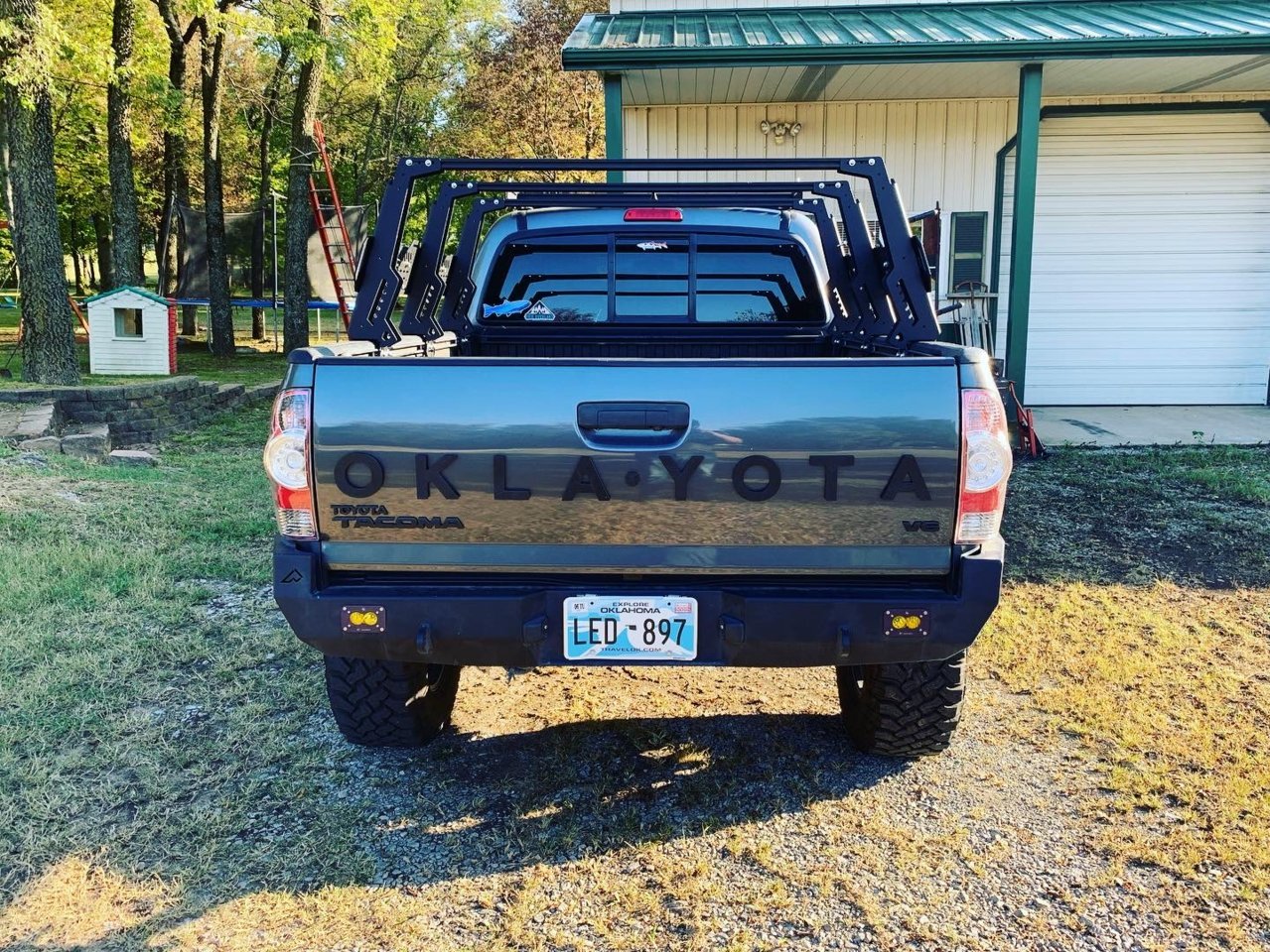

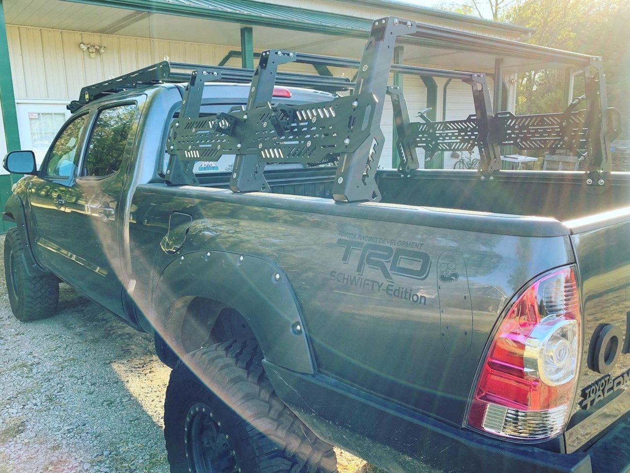

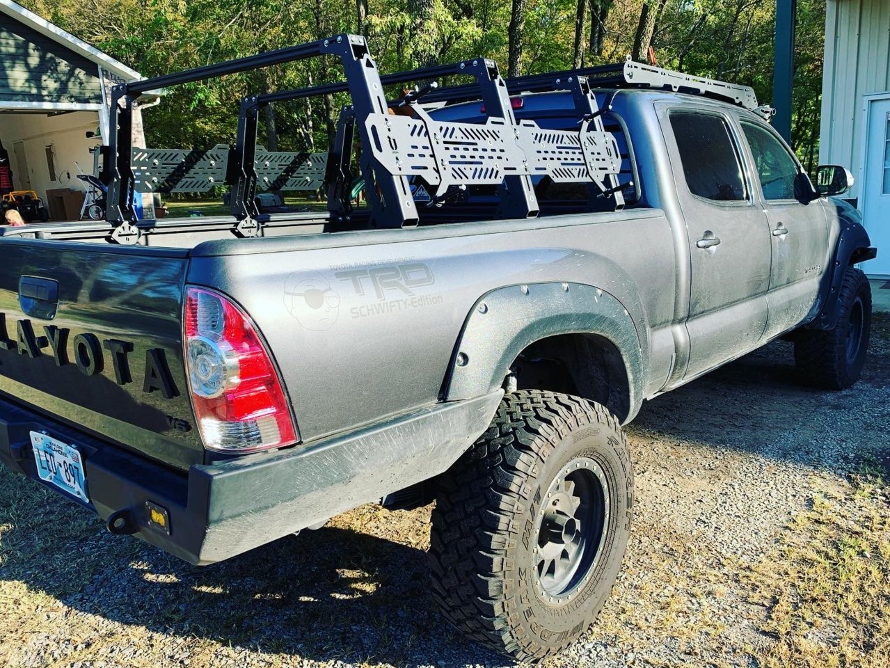

    Made a 6 hour round trip and added an Uptop Overland Truss Rack. The guy I bought it from has his pictures on Uptop’s site of this rack on a white 3rd Gen. I think it’s awesome they’ll fit 2nd or 3rd, not a lot of that crossover that I’ve found so far.
    He threw in the monkey fist and MaxTrax mounts, so now I guess the decision is made on what brand of recovery boards I have to get.
    This seems to be an amazingly sturdy rack for being aluminum construction. Planning on getting a rooftop tent around the new year if work gives us a good bonus.C46A6E9C-B2C8-420A-A530-F29550D7B7A9.jpg 846172B4-B6E1-4284-A11C-070BA21453FC.jpg 1C234A9E-A445-4738-8FDA-EC1C070617E3.jpg 3620DC42-90AA-4DCC-A218-CE02F253EEB5.jpg Picked it up yesterday but was too dark by the time I got home.

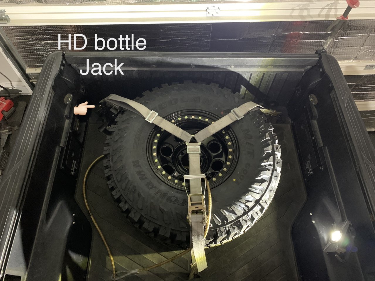

    Grabbed one last matching tire (while I still can) & mounted it on my matching spare beadlock. Locked it up & strapped it down with my bottle Jack in the bed. This time I used ring spacers from Battleborn & I like the fit of the ring down on the wheel a lot better. Thankful to grab one of these tires while I still can. Seems like all tires are going up in price and down in availability.

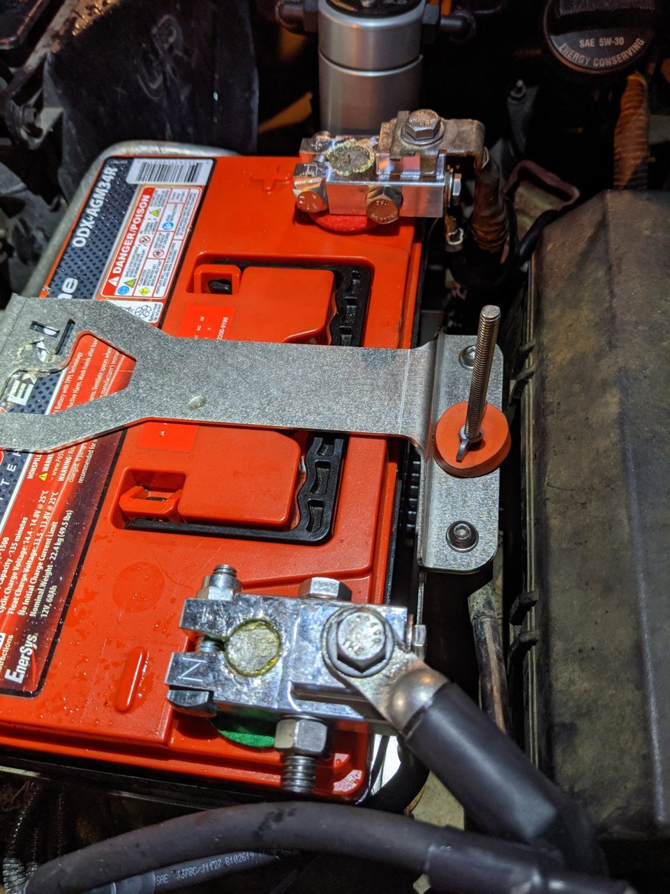

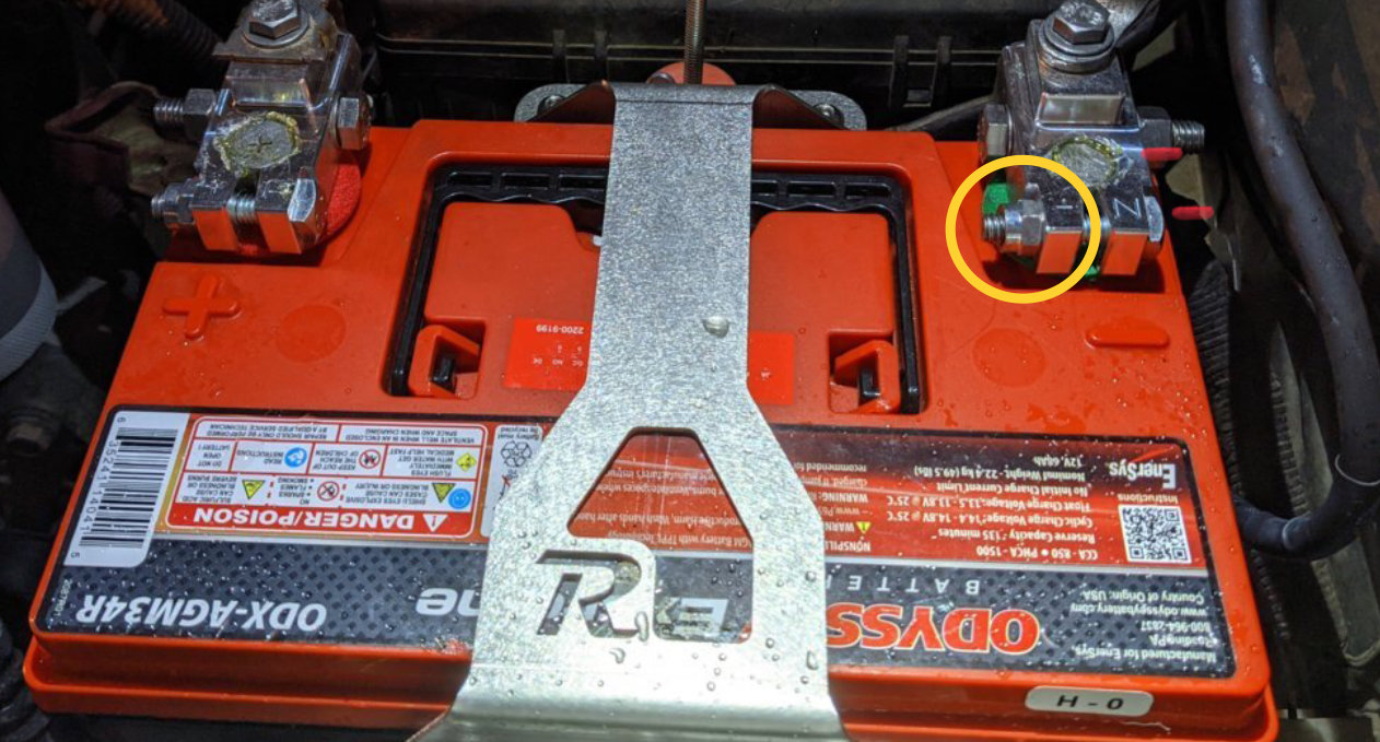

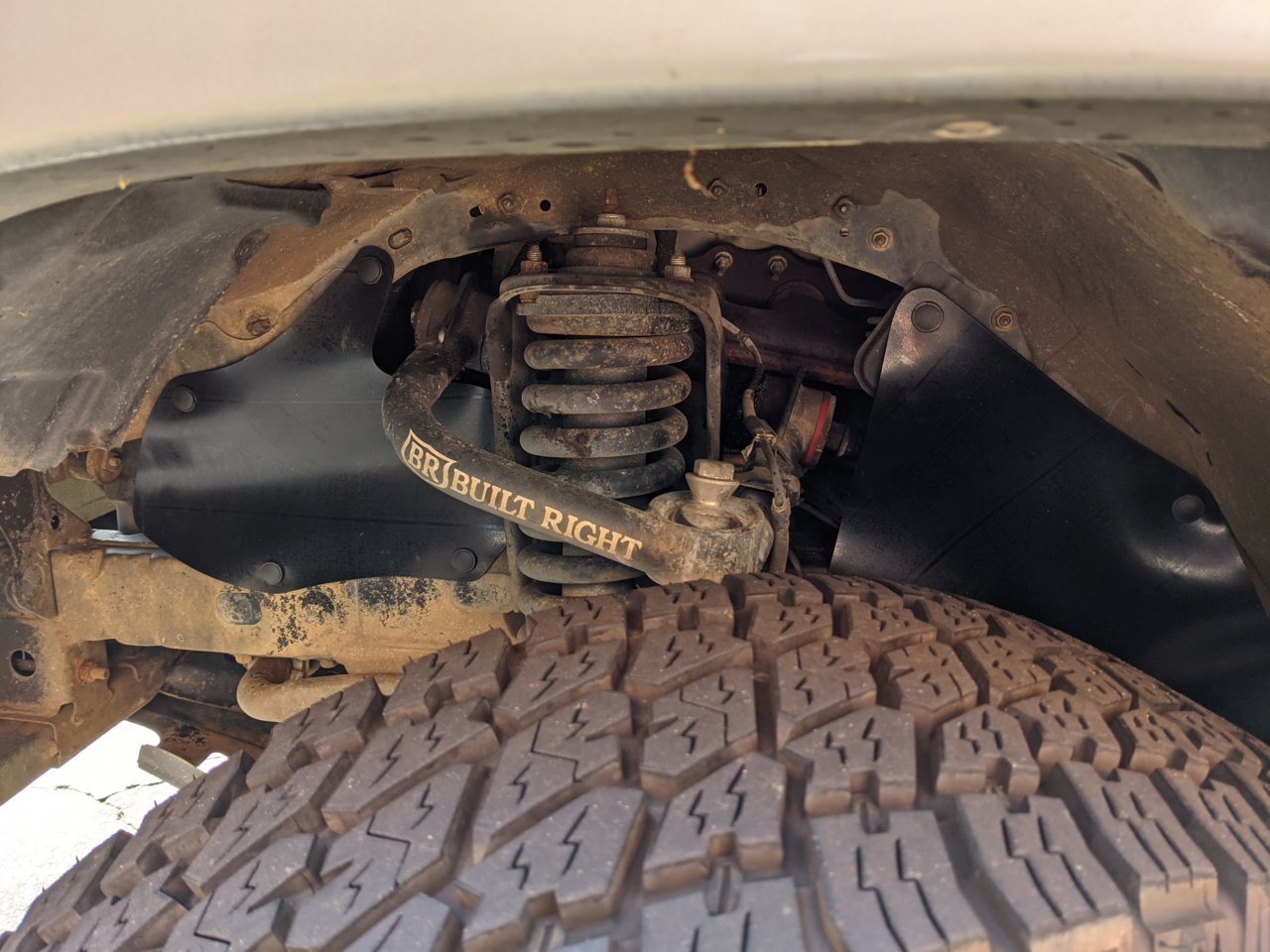

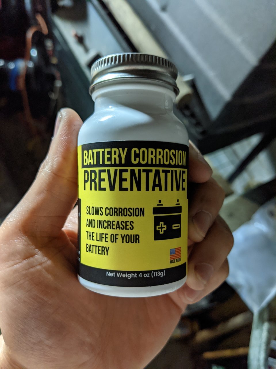

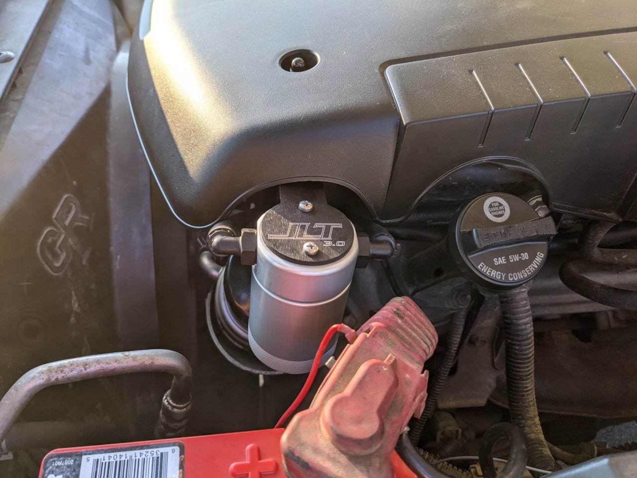

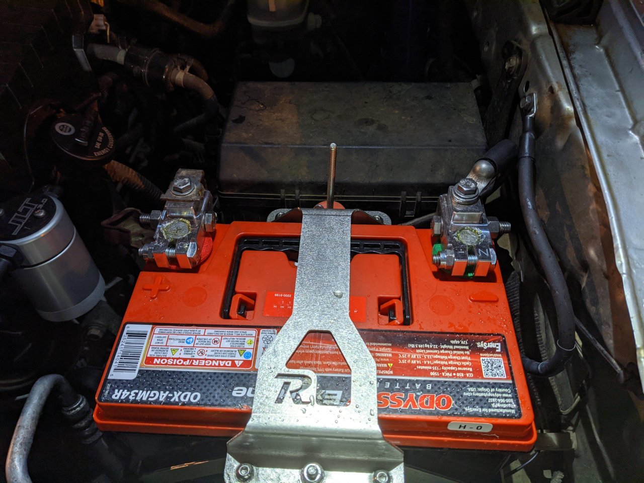

    Did a radiator coolant flush today, and installed my new SDHQ Billet battery terminal upgrade! Also installed the JLT 3 Performance Oil Catch Can a couple of weeks ago and new splash guards! My new pair of Nitro Gear Upper controls arrive tomorrow. I'm also saving up for a Toytec Lift kit (Leaf spring package included) for the holidays. I'm going crazy with my Taco! :yay:

    Your nuts are upside down. How’d you even tighten that? Also that corrosion preventative suppose to go on top of the terminals not between post and terminal.

    I was in a hurry and it was raining! I used two wrenches (Used one to tighten and the other to hold the bolt)

    Thanks for pointing out the bolts being on backward. I'll re-adjust them when it stops raining in my area. About the anti-corrosion stuff, I was always told its good to usually spread it on between post and terminal so it doesn't make a big mess. Maybe I should apply the rest on like you recommend?

    The connection between the terminal and the post should be clean. For something to corrode it needs oxygen and oxygen can't get between the terminal and the post if the terminal is tight.

    Been using petroleum jelly between battery posts and cable clamps for nearly 50 years. Use anti-corrosive washers between battery and clamps. Best cheapest way to prevent corrosion.
