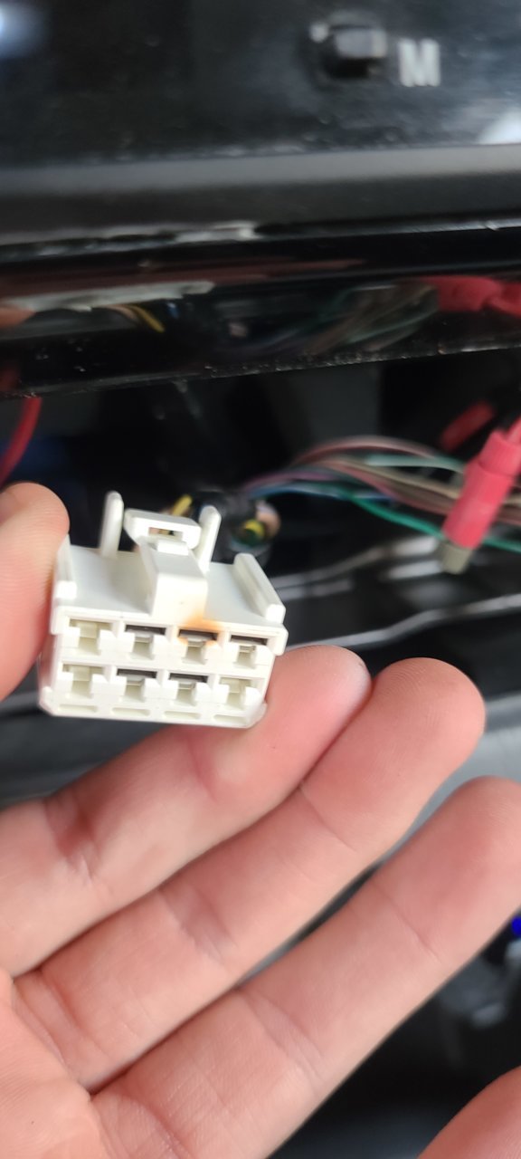

    Toyota has a new resistor (I believe for a 3rd gen) that I used after my replacement burned out and haven't had any issues in about a year. I just used dielectric grease and all has been well.

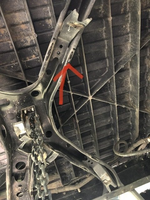

    Am about to do this right away... any pointers?

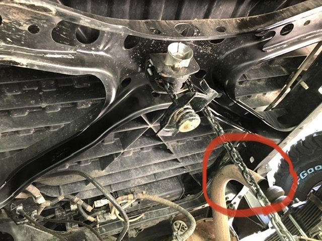

    I cut mine out with an angle grinder. Just cut the short weld out and they pop right out.

    You cut the whole "teeth" out?
    I know some people bash them with a hammer.

    Yep just cut them out. Bending them will fuck it up too, and could be bent back I suppose, but they’d be ugly and mangled. The spare tire stays put without the tabs just fine.
    Side thought… you don’t have an tail pipe chop do you? I had my exhaust chopped. It’s output was very close to the spare that way and fucked up my larger tire I had stuffed in there.

    Yeah I have the stock exhaust on still. It's not chopped or anything.
    I wonder if there is something I could do to not chop it?

    To not chop the tabs for the spare or not chop the exhaust? I didn’t chop the exhaust to fit the spare, I chopped it for my rear high clearance bumper I think a bigger tire would fit with stock exhaust

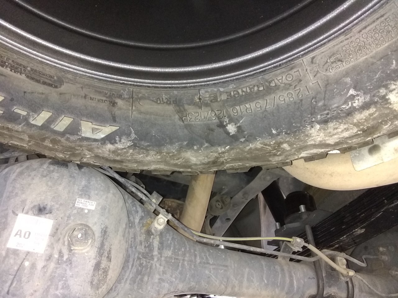

    Ohhh, are you saying the chopped pipe fucked the large spare?

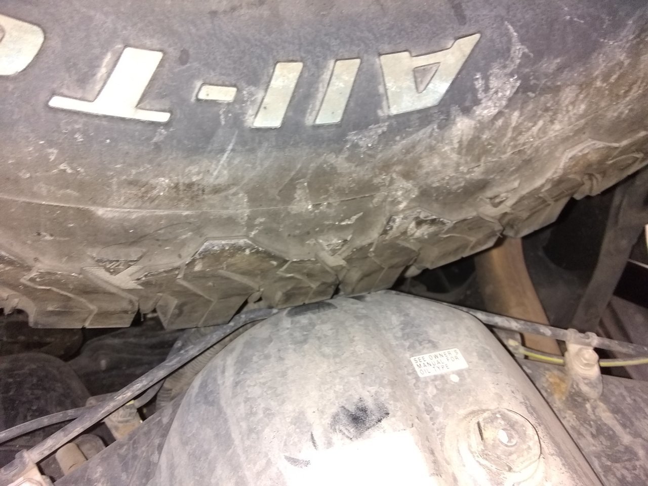

    Yes. Chopped exhaust dump super hot air for like a year right on my 295/75r16 I had stuffed up there. 3 lugs pretty much disintegrated. Spare still held air and stuff but it was rough.

    You're incorrect. Opium isn't the right answer for children with aches and pains and putting anything between an electrical connection isn't the right answer for fighting corrosion in/on an electrical connection.
    Corrosion requires oxygen and if the terminal connection is tight there is no oxygen between the connection. Electrical connections should be clean and dry. Corrosion can be avoided by putting a barrier (such as petroleum jelly, grease, liquid electrical tape, etc...) on the outside of the electrical connection.

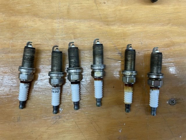

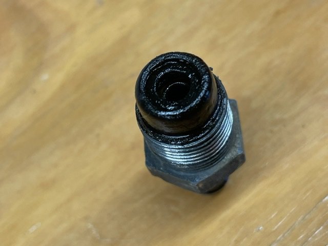

    Did a little maintenance… two weeks ago I changed the oil/greased everything/ air filter/ rear diff fluid.
    Today, cleaned the MAF sensor, throttle body (replaced the O ring), changed the spark plugs, and the PCV valve.
