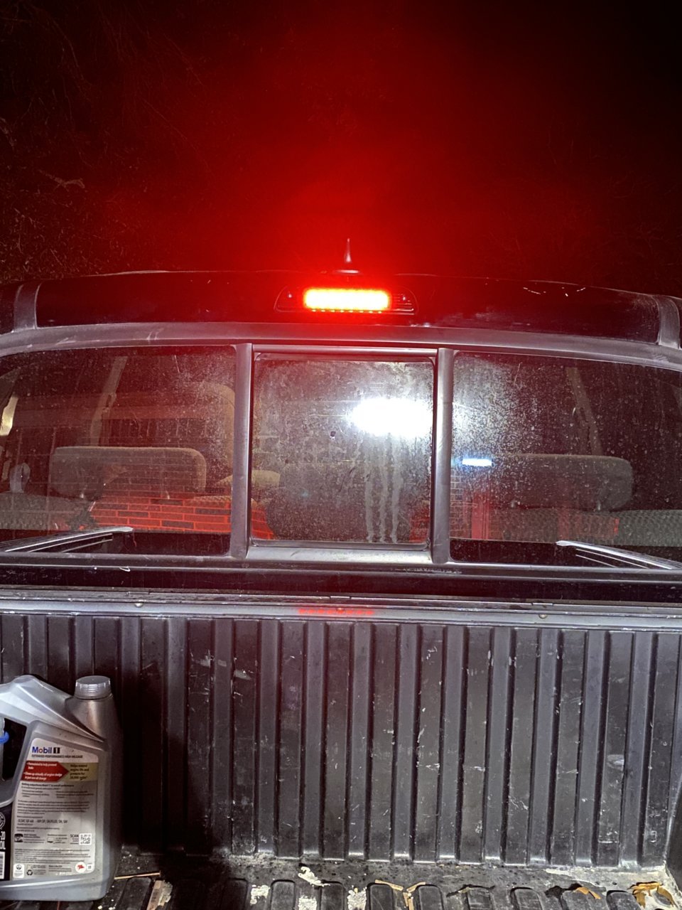

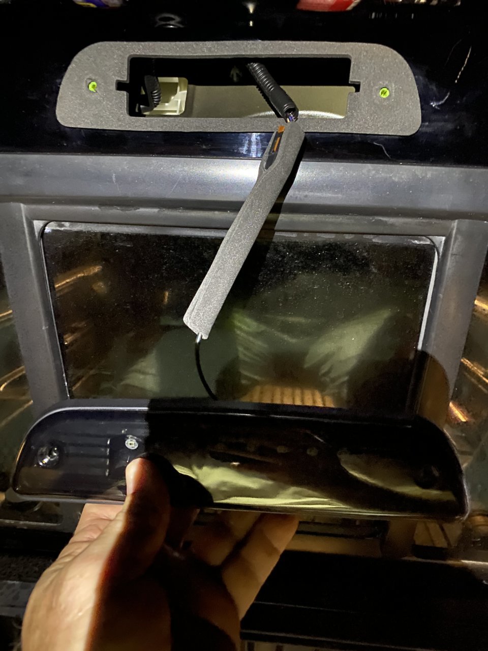

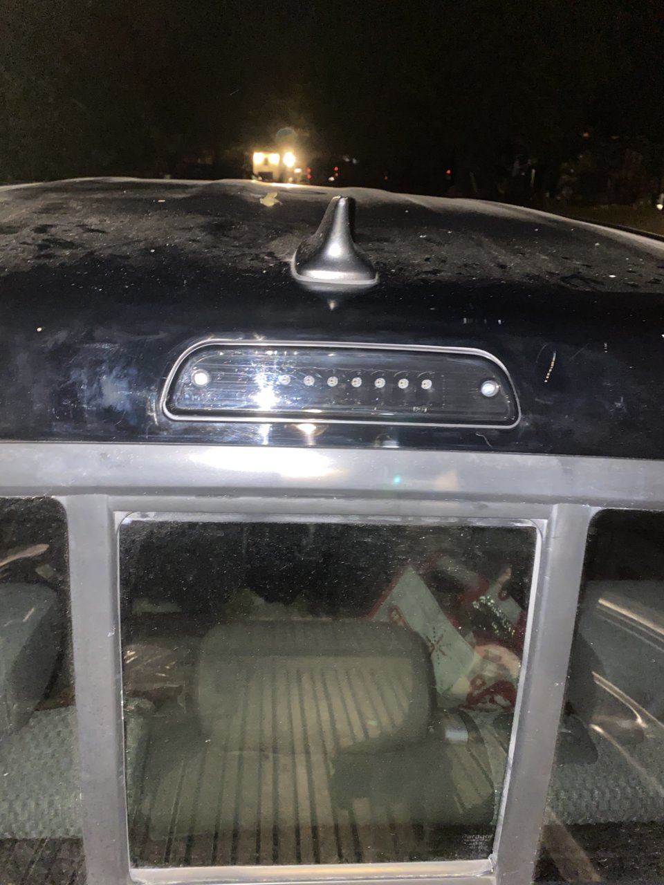

    Took a chance on this Amazon offering.​
    High Mount LED 3rd Brake Light Third Light Brake CHMSL Center Light for 1995-2015 Toyota Tacoma (Black Cover Smoke Lens) https://www.amazon.com/dp/B07GYJ73LG?_encoding=UTF8
    The biggest job is the clean up of the old seal material and adhesive left behind on the paint.
    One thing I can recommend in perpetration is to find and purchase a black or appropriate colored replacement torques head screw about a 1/4” to 3/8” longer than the factory.
    This is really the only thing I don’t like about the light kit. It comes with generic wood Phillips head screw or a machine screw with backing thread that looks very plain compared to the design and color of the light itself. I will be replacing mine first stop at a fastener store next week.
    The only thing other than that that I can offer that might be considered an improvement of value would be the use of the foam backing gasket center punch out that would normally be discarded. Here I used it to wrap around the extra wire to act as a possible preventative buffer in case there might be vibration and or tapping sound from the extra wire laying in the mounting relief.
    Before
    The punch out of the foam gasket is being used as an insulator.
    forgive the poor quality of the shot it got dark on me.

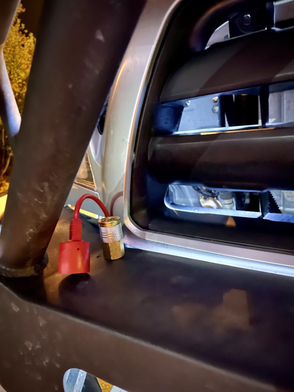

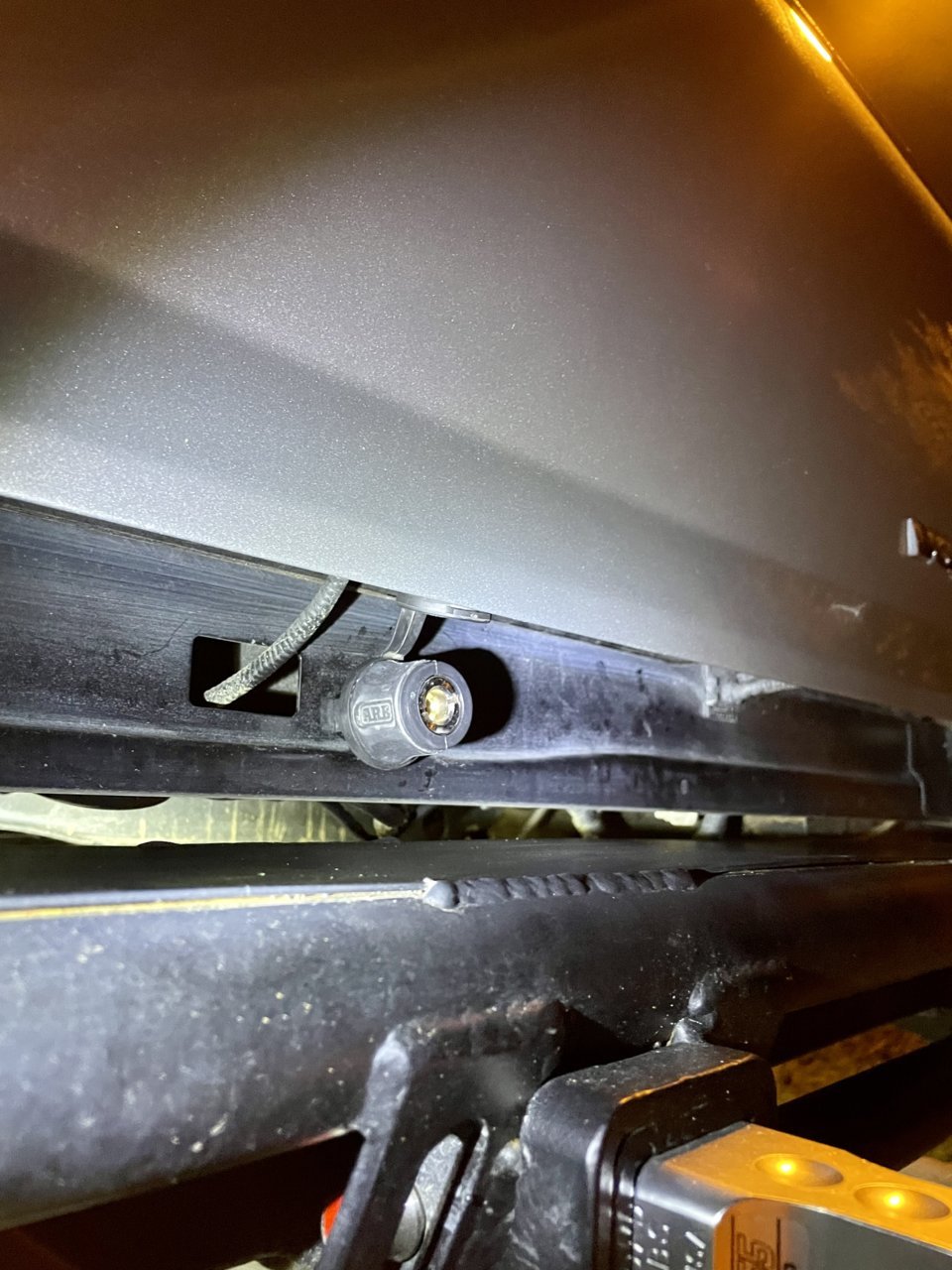

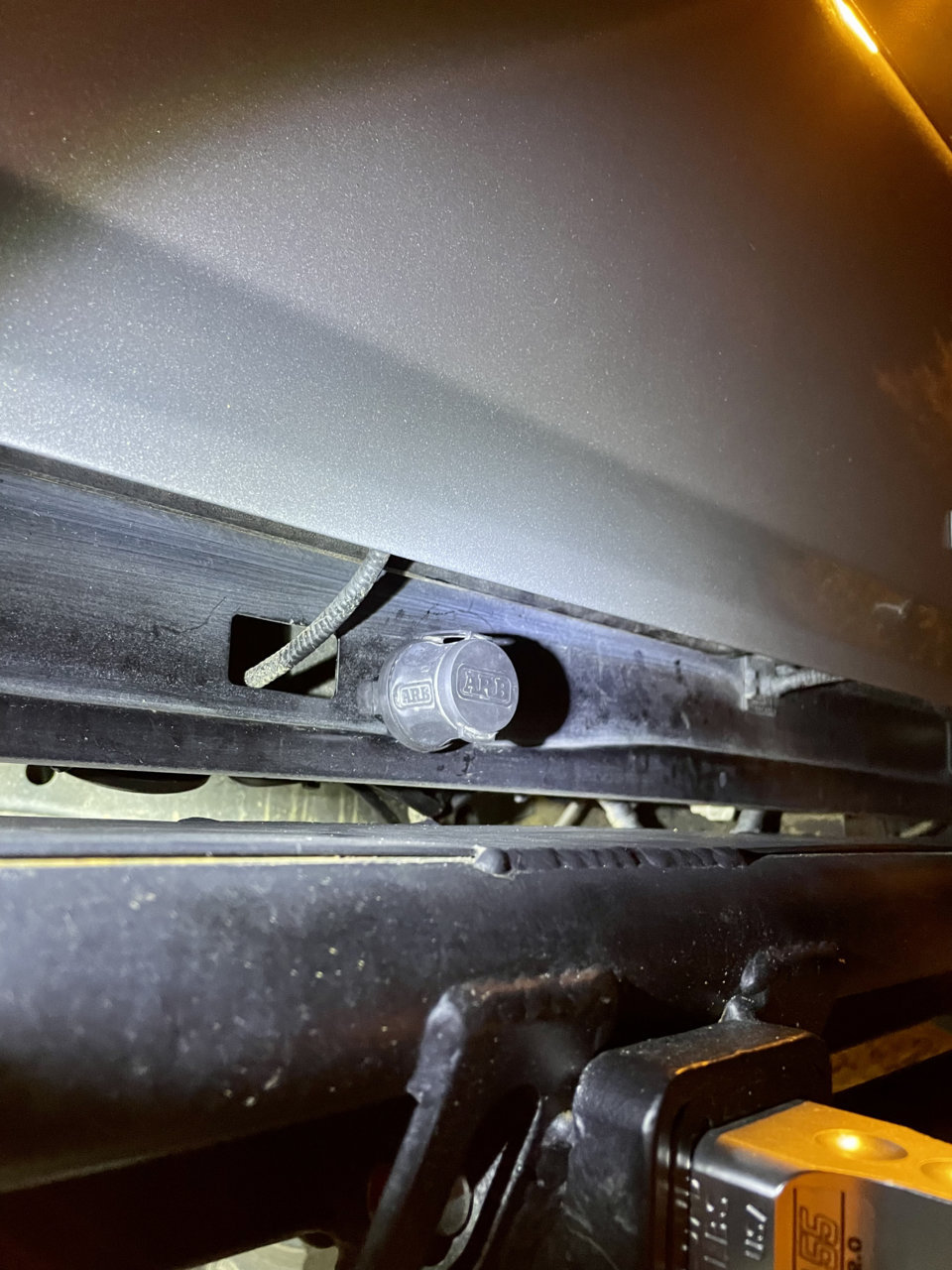

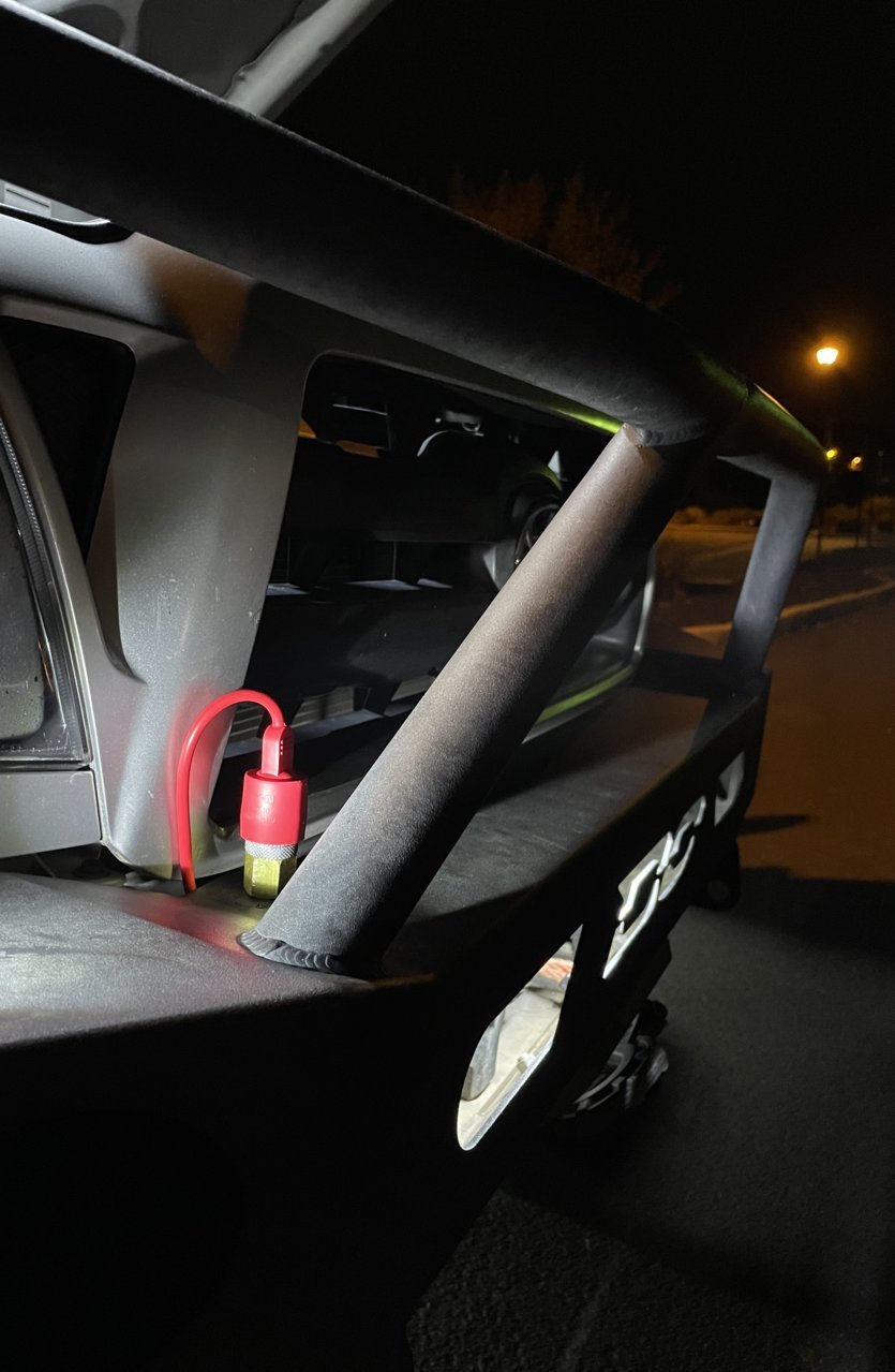

    Installed some air quick disconnects front and rear. Planned on using the same setup in the rear but ended up over torquing it and snapping the fitting. I’ll have a replacement shortly.
    FFEF1D84-F232-4955-89A9-274DBC16D1BC.jpg C59F6EDD-E678-4EBA-BE86-AD0832D0D4E3.jpg 7A365BAD-1404-4794-8775-5C61AAEF5558.jpg 8F2C8C74-FDFE-464B-A595-A74602F0DA2E.jpg

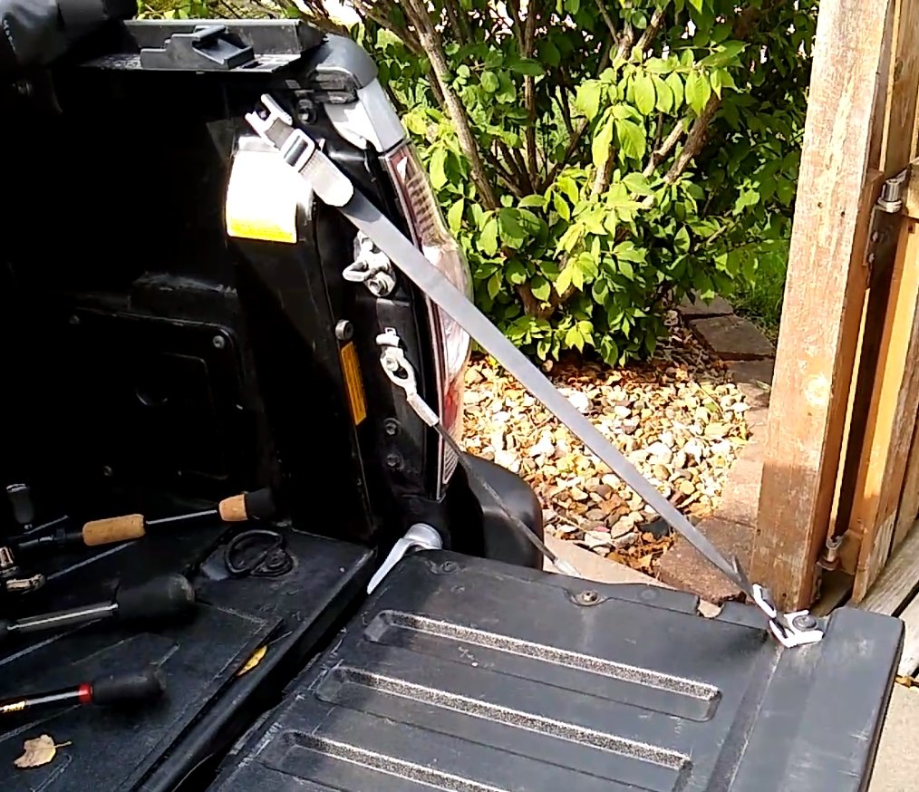

    Browsed forum yesterday to see what owners are doing to fix the tailgate slam. Decided to try something with materials I had on hand. Used 30" long x 1" strips of heavy equipment inner tube and strap clips from a car seat to make. Got the used inner tube from a tire supply dealer. Drilled holes in clips so I could use existing bolt and tailgate screws. Took some testing to get the tension right.
    90% of time I drop the tailgate to remove my fishing gear. This is going to work! Near soft landing without much bounce. Nice assist to lift and latch. I use this inner tube for many other purposes, tie-downs, storage box straps, material straps. Heat and cold resistant but not UV resistant for very long. Free! Straps fold up nice and I can still access tonneau cover release lever. Shot a phone video, maybe it will go on YT.

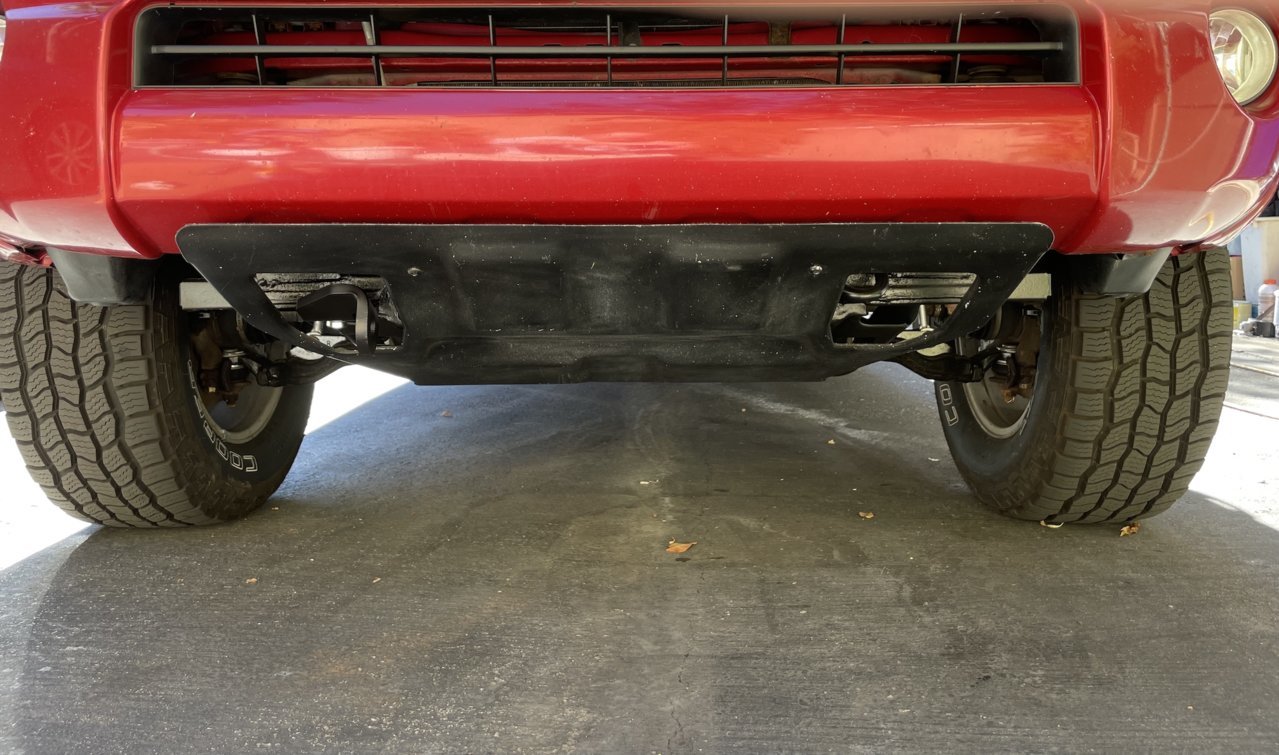

    Finally installed the BPF skid that I bought from @loyaltothetaco. Bought the BPF recovery point as the ones I had previously installed didn't line up with the access holes.
    Also changed the oil/filter and lubricated the u-joints. Lubed the joints a couple of months ago but I hadn't pushed enough old grease out so decided to hit 'em again.
