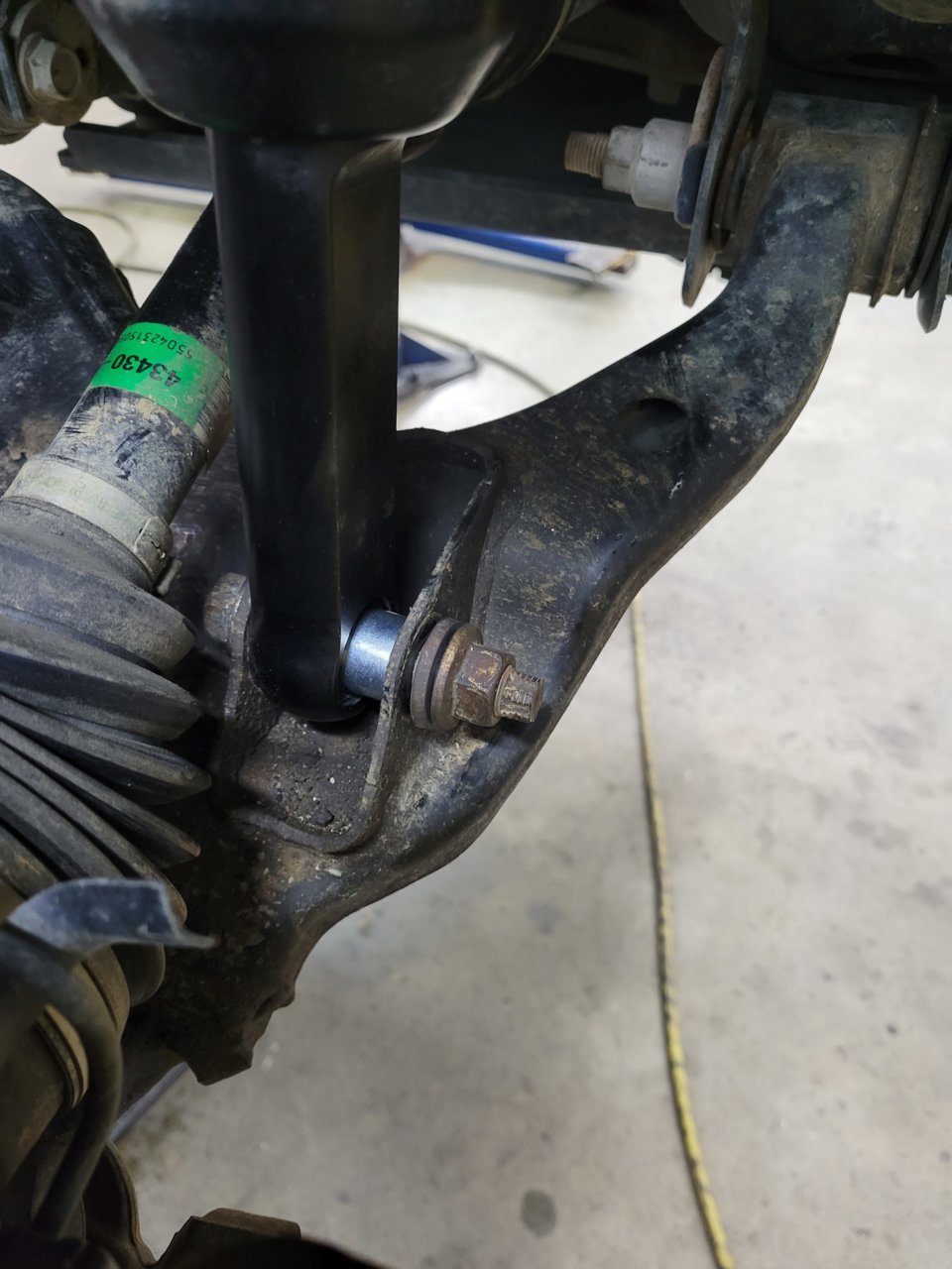

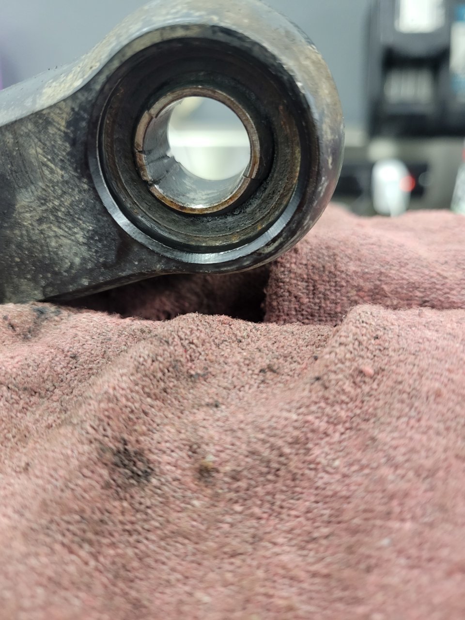

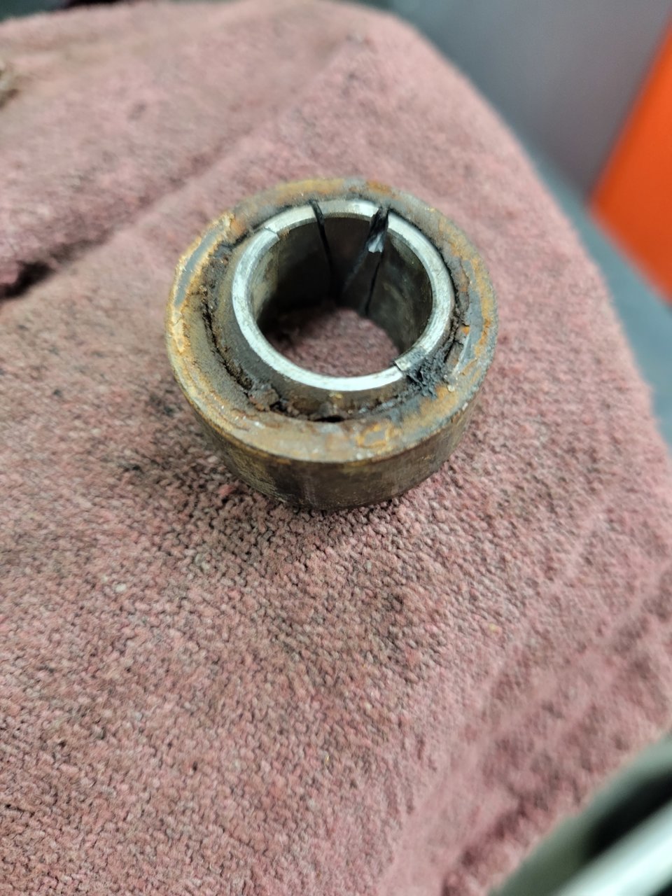

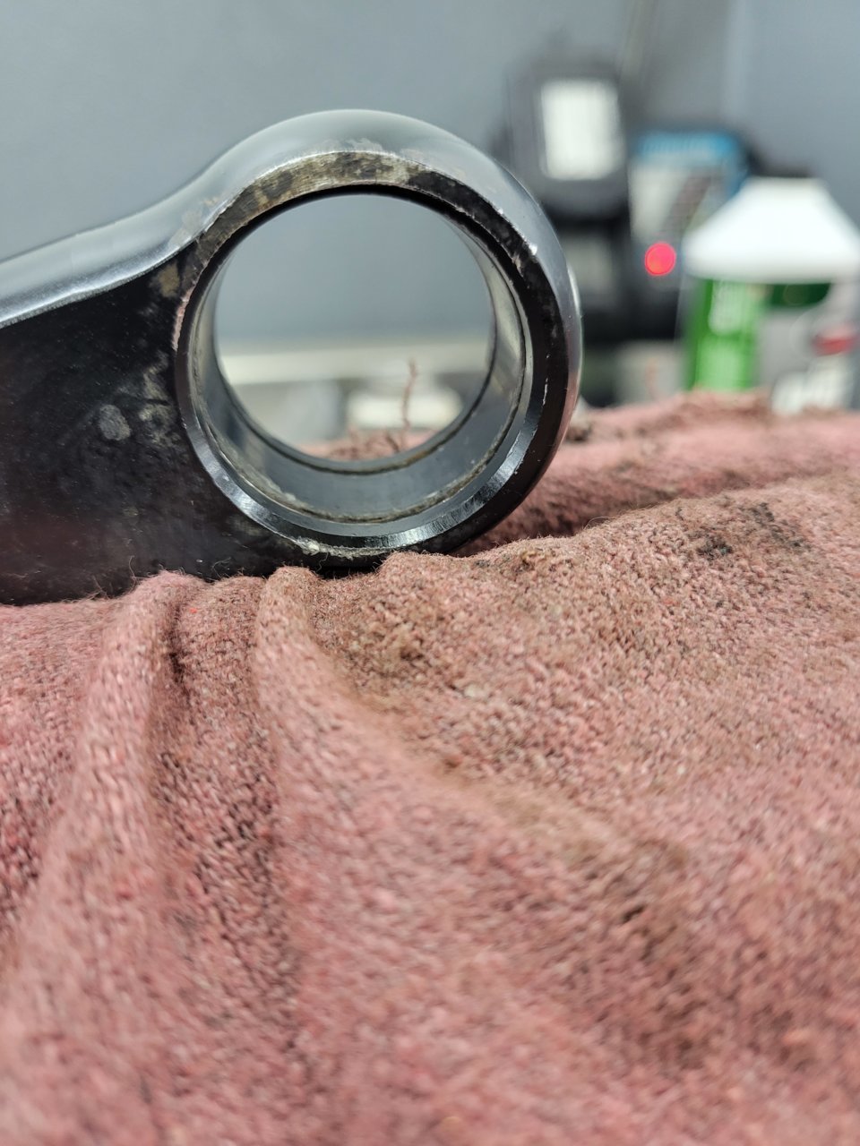

    Replaced the lower heim joints on my ICONs today. I had been hearing a loud creak from the front for a few months, the spherical bearing was cracked into a few pieces

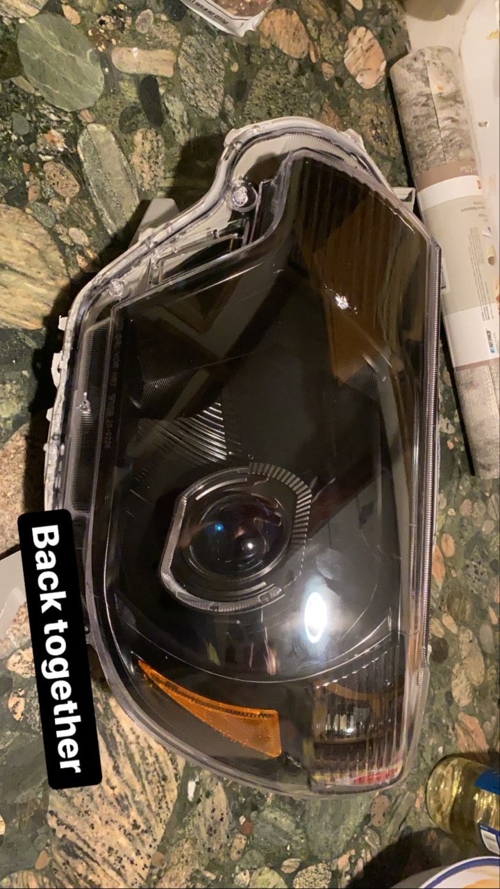

    Fresh out of the oven

    I'm feeling your pain! I had the same thing happen to mine 2 weeks ago. I've been putting off getting it fixed because I heard of them same horror stories!:mad:

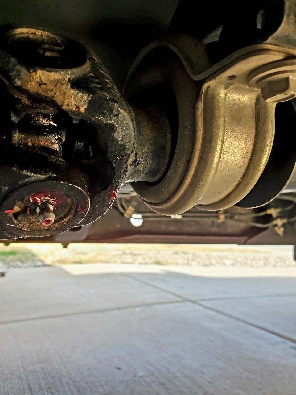

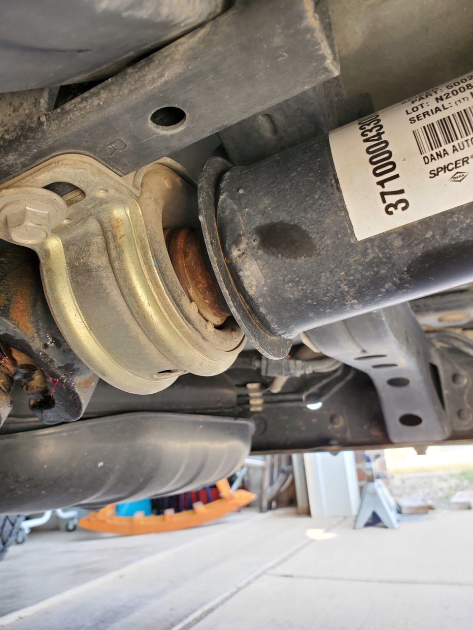

    Nothing exciting, greased all the ujoints (the one closest to the T-case on the front drive shaft is a little bit of a pain) and discovered that my carrier bearing is looking a little sad and worn.
