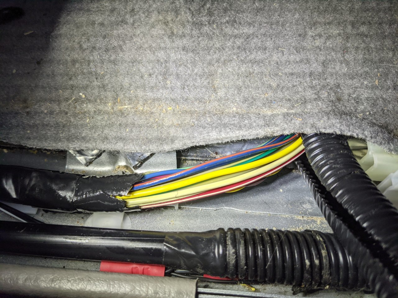

    Sorry about the lack of pictures. I am terrible about documenting what I do with my truck.
    Pulled the DS door sill proctectors
    Unsnapped the white plastic retainers that hold the carpet, then raised and stuck a small block of wood under the carpet for better accesss.
    Peeled back the wire sheathing (pictured in previous post) on the large bundle of wires that goes under the DS seat and through a rubber grommet.

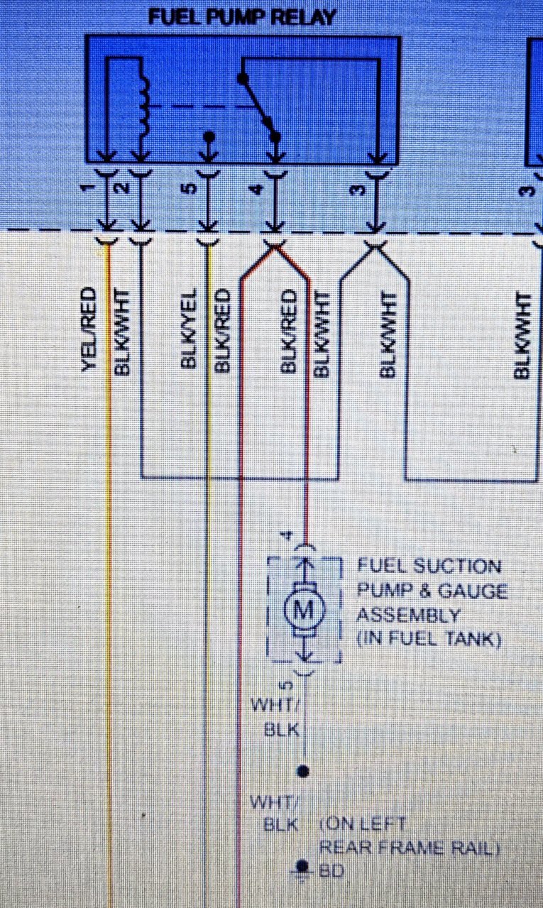

    Located the black/red wire that supplies power to the fuel pump NOTE: the black/red is for my truck 2007 V6 other years may vary.
    Before I contiue, I had heard that interrupting the ground wire to the fuel pump would also disable the fuel pump. I located and disconnected the grounding point on the frame (indicated in the wiring diagram picture in my previous post) but the truck fired up three different times. Since this did not work, I went ahead with using the power wire.

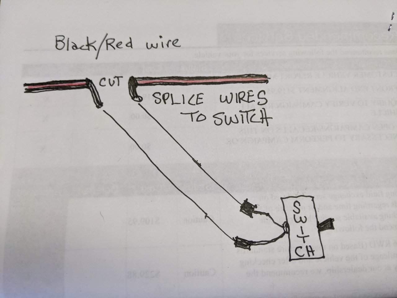

    Once I located the black/red wire I used a test light to check for power. Key off - no power. Key on - no power. The black/red wire only had power when I started the engine. For me this confirmed it was the power wire for the fuel pump.
    Cut the black/red wire and tried to start the truck. No start which meant success.
    I used butt splices to attach wires to each end of the freshly cut black/red wire(s)
    I ran these wires through the rubber grommet. Once through the grommet the wires were loomed to the location of the switch.
    I used a two pole water proof switch. Wiring the switch is a no brainer, doesn't matter which wire goes on the top or bottom pole. SEE picture of my rinky-dink hand drawn diagram.
    Put back in place the sheathing that I had peeled back, added some black tape for reassurance then pulled the wooden block that was holding up the carpet. Reconnected the white plastic clips on the carpet then replaced the door sill covers.
    Tried to keep it short and sweet, hope it helps.

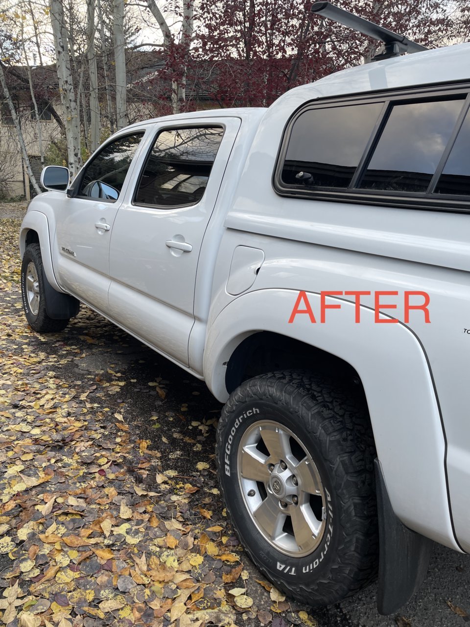

    Nice Set-up. Just curious, do you spray your frame to prevent rust. Things look not bad for living in Vail CO.

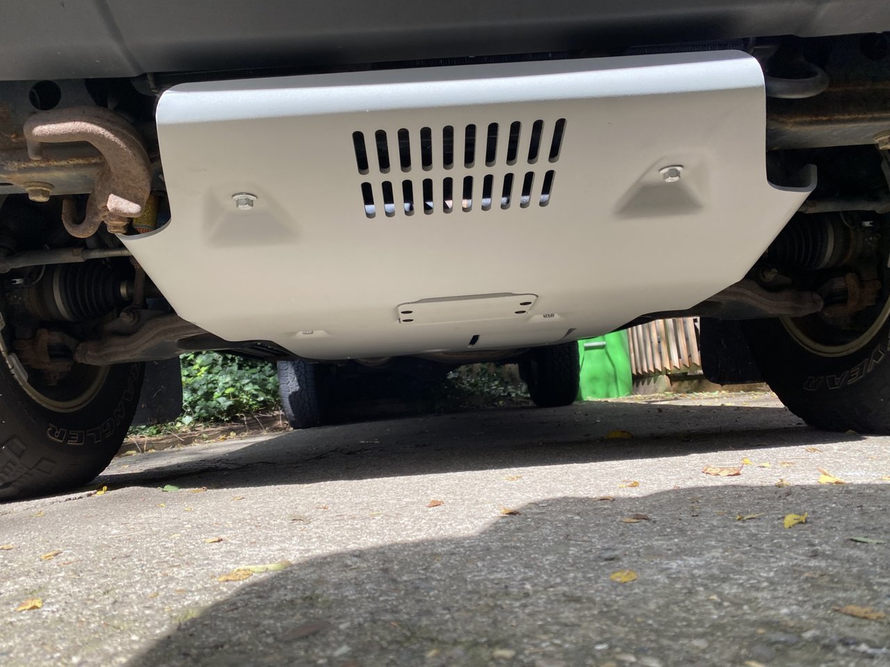

    Leo
    2011 Tacoma TRD Sport DCLB v6 4x4
    All stock, baby!
    Looks good. From your installation experience, can you tell what it is about the fitment that would prevent the sellers of these 3rd gen skids from advertising them for 2nd gens as well? If it fits so easily I'm just shocked they haven't figured this out by now. One of the Amazon pages I looked at says "TRD PRO and Off-Road models ONLY", another "Will fit sport and SR5 models, just need to remove air dam/deflector to fit plate" which I assume refers to the factory splash shield. But still this latter one is still saying 3rd gen only.

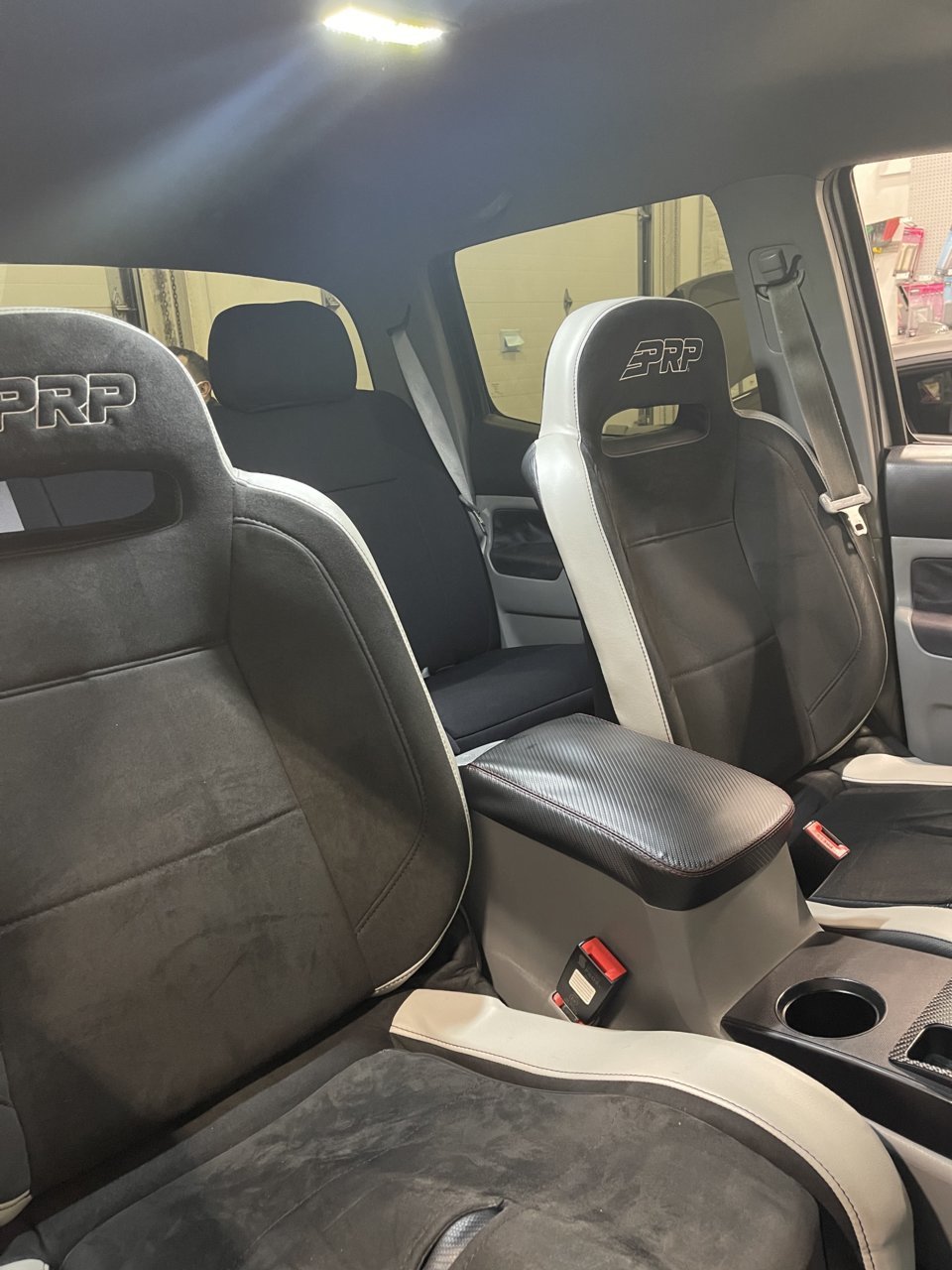

    What are you doing for the mounting points for the PRP seats

    2015 DCSB OR
    I had absolutely 0 issues. The skid replaces the 2 factory “skids” using the rear 2 bolts and then 4 bolts replace the front brace bolts. The directions mine came with were an exact copy from Toyota’s. I think it would fit all 2nd gens but I’m not positive. My instructions said 2014-2020.

    which one was it? KUAFU, LOSTAR or LAFORMO?
