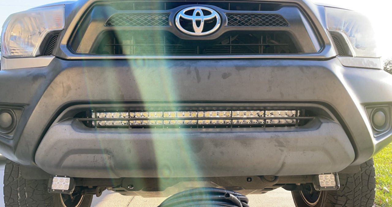

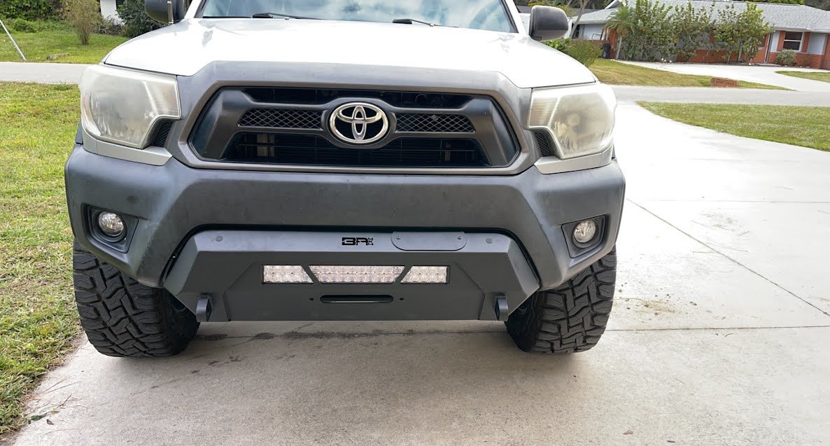

    Just got Body Armor TC-19340 installed today, hopefully winch coming soon. Heres a before and afterIMG_1290.jpg IMG_1669.jpg

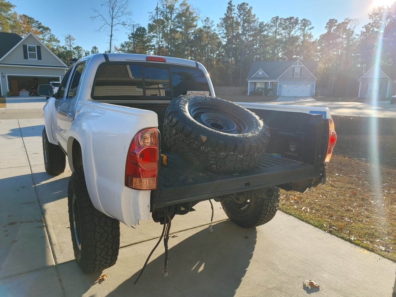

    Does anyone know a good kind of mount for bed for spare that can give me this result?
    Im either going to have to ditch tailgate or conpletely rework these mcneil bedsides to get my tailgate to close. Not a big deal truck is nothing more than a toy and mulch hauler when needed. My wife suggested a skeleton type tailgate that swings open. Something like that I could easier modify to fit instead of grinding on my mint tailgate. Any suggestions?

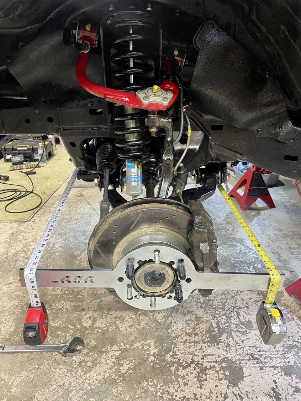

    As far as aligning with the plates I did it like the following picture. Two tape measures and just adjust until you get equal measurements.

    That is simple and very functional. Add a bubble or digital inclinometer and caster and camber could be a breeze to dial in. I may end up making one similar. Is that one steel.

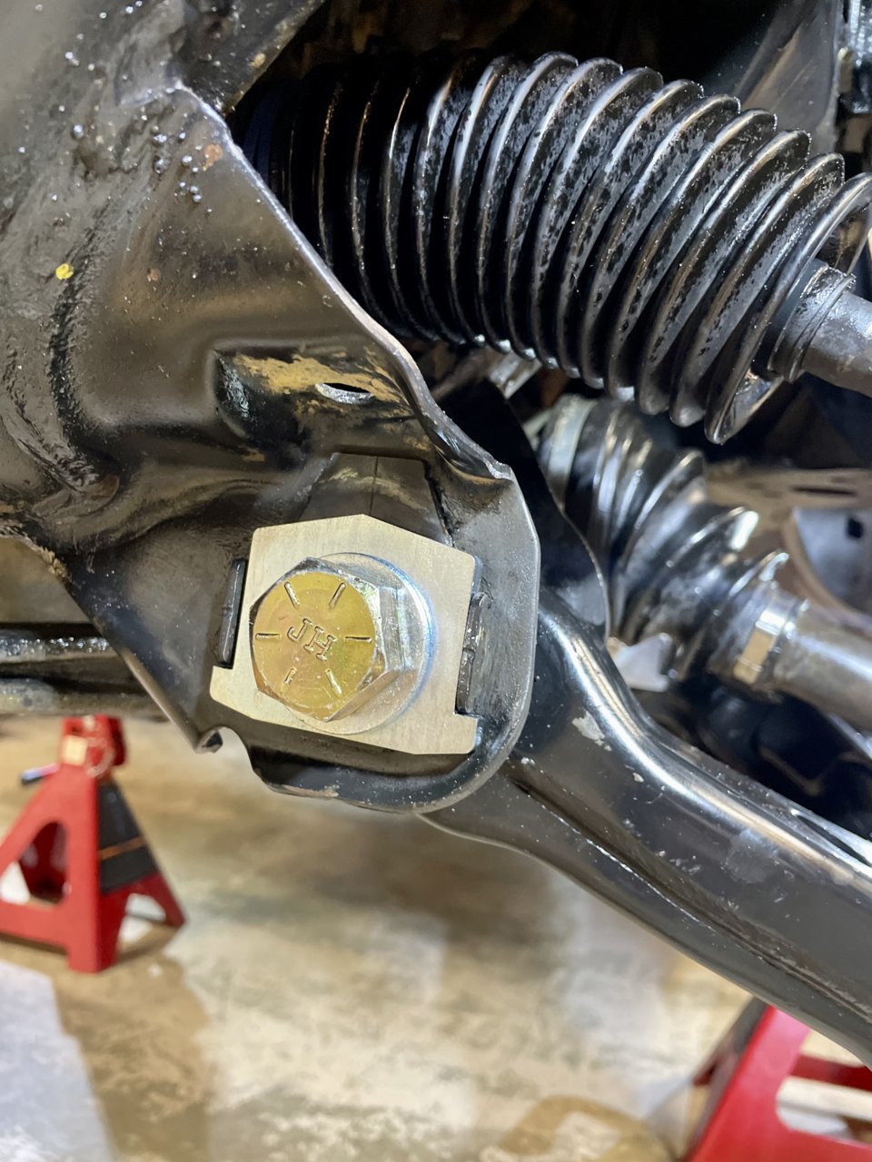

    Caster/camber is all fixed with the taco tab kit. I set it for max to clear the 35’s better. Max in the rear of the arms and neutral in the front in the taco tabs.
