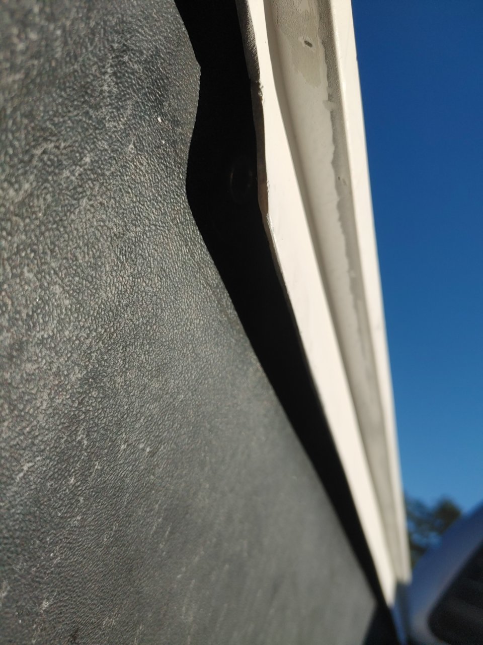

    Try a heat gun and heat up one spot at a time and bend it towards the bed so it can be attached? I had to do this to bend fiberglass over fenders for a car a while back.

    Heat works on fiberglass like that? Ill try it for sure

    Yeah it will actually move quite a bit for you. From the pic I believe it will work for sure. I had a much larger gap that I made work.
    Sorry about the product though. Good you’re letting people know though so further money isn’t waisted. The average person wouldn’t be able to make that work at all.

    The fronts are good. You can tell they are new. The bedsides have clearly been on a different truck and returned. I have read their stuff is made in mexico and not usa anymore as well.

    But I will def try heating it up, thanks again!

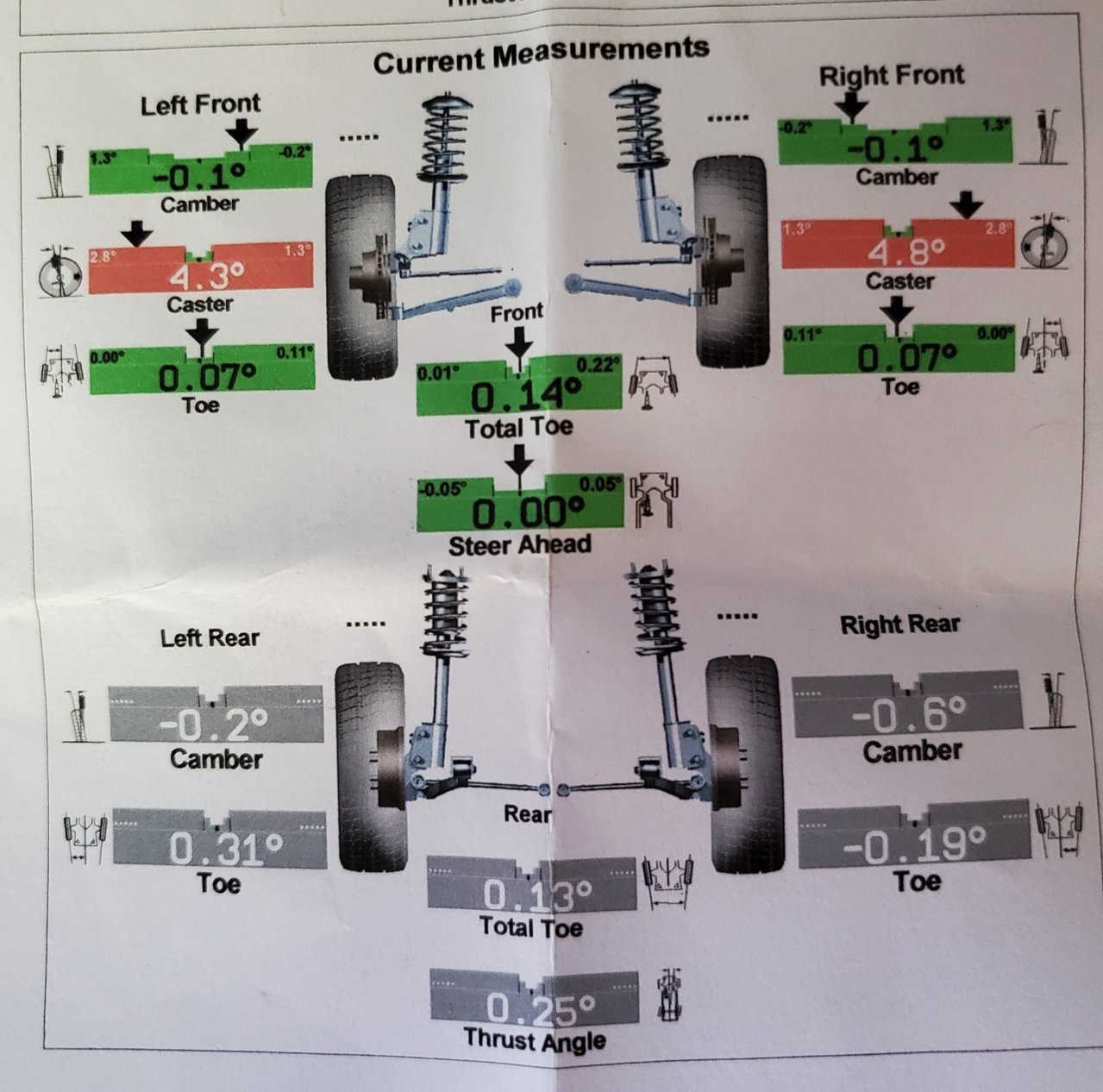

    The measurements are not supposed to be equal. It's supposed to have a shorter measurement in front than the rear. I think it's a 1/8th inch difference. Modern alignment machines measure it in degrees.

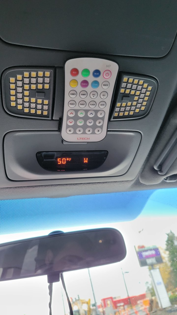

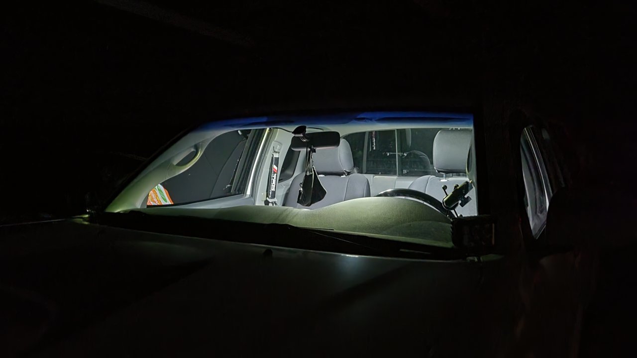

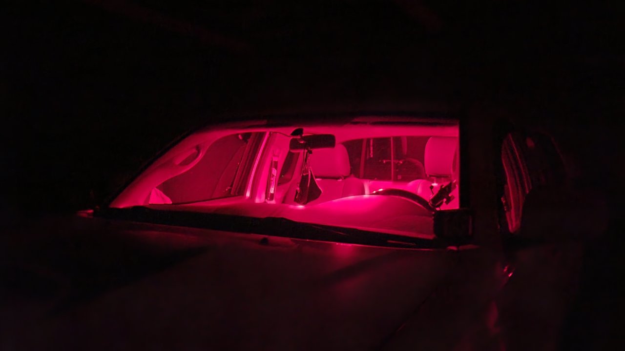

    Installed the @MESO customs map lights. Can't wait til the domes are back in stock!
    Also ordered bed stiffeners finally.

    I set the toe to 0. I should have specified that when I was explaining the process.

    You did, it was just worded differently.

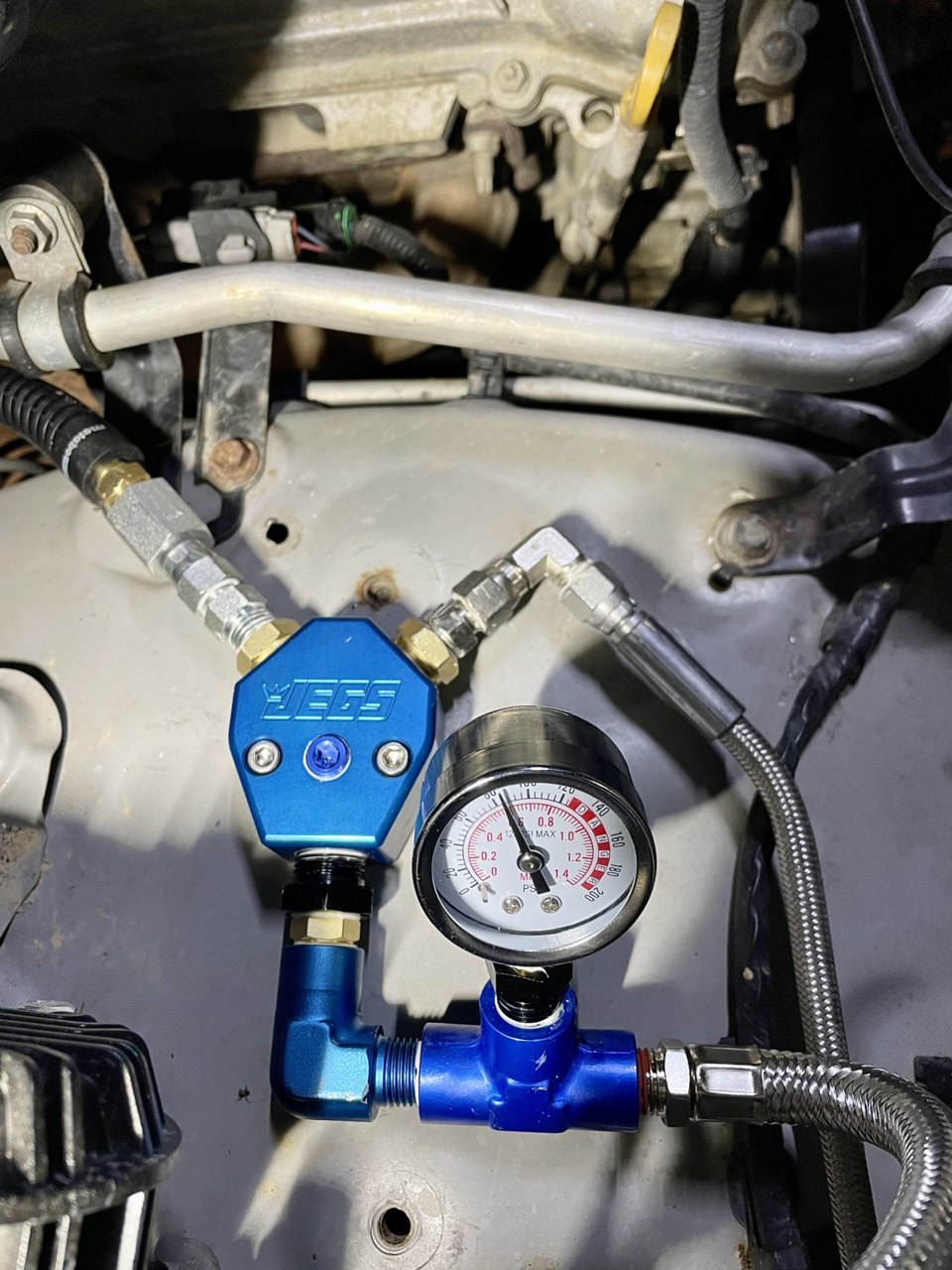

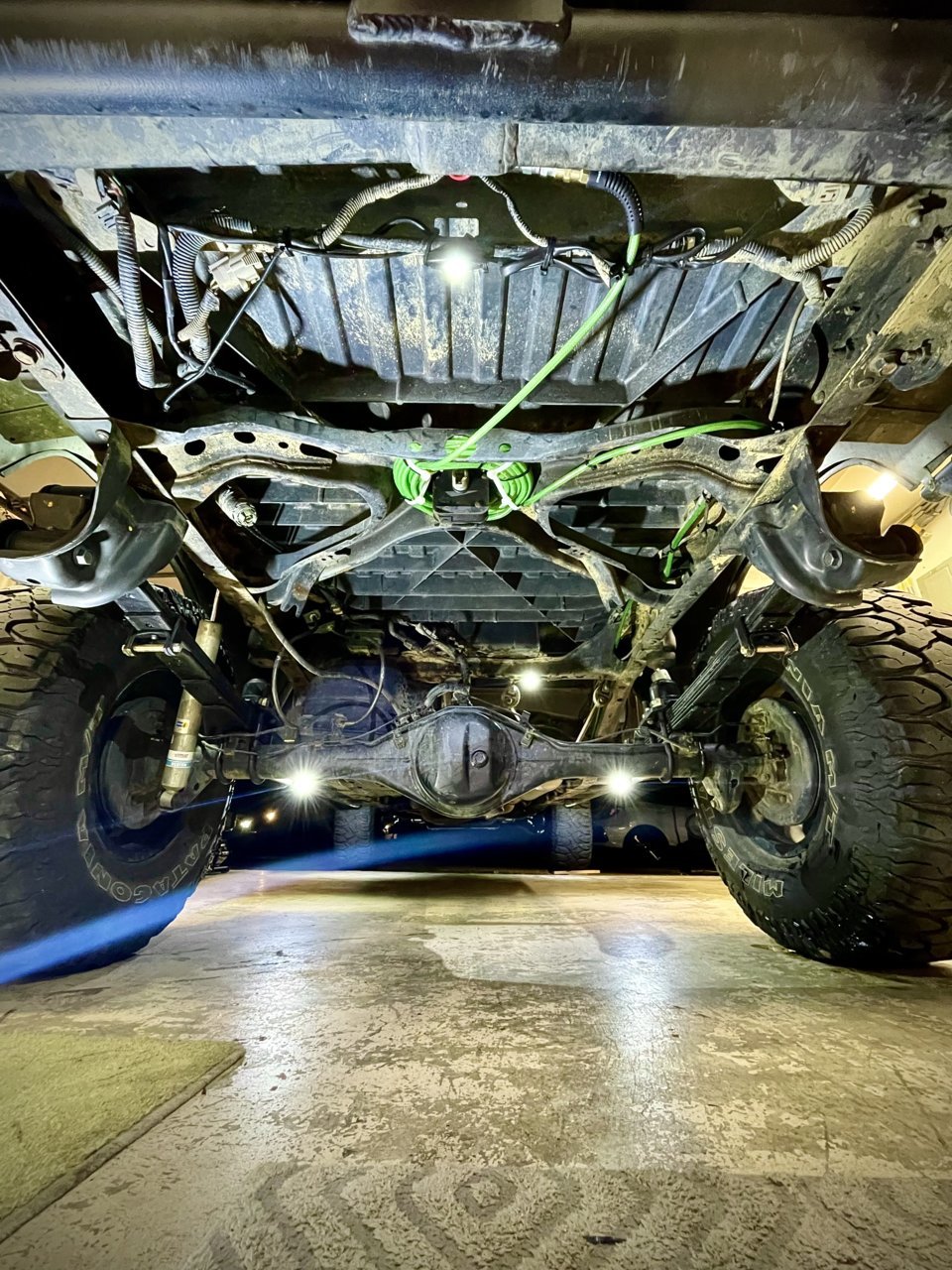

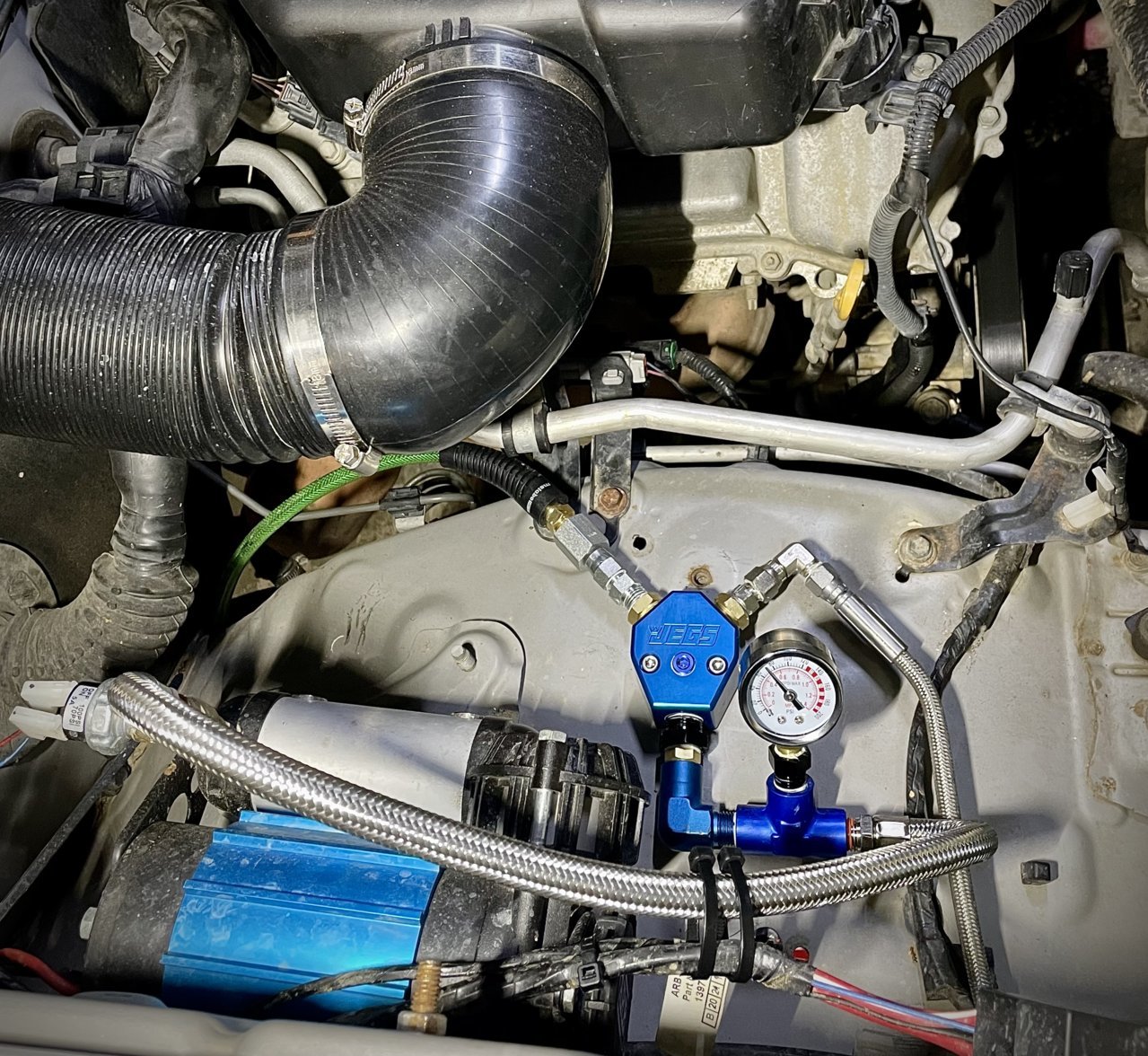

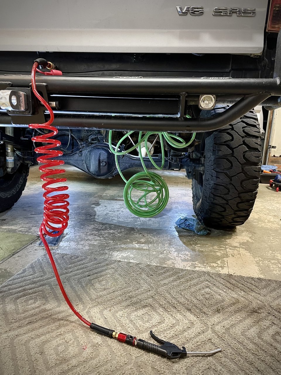

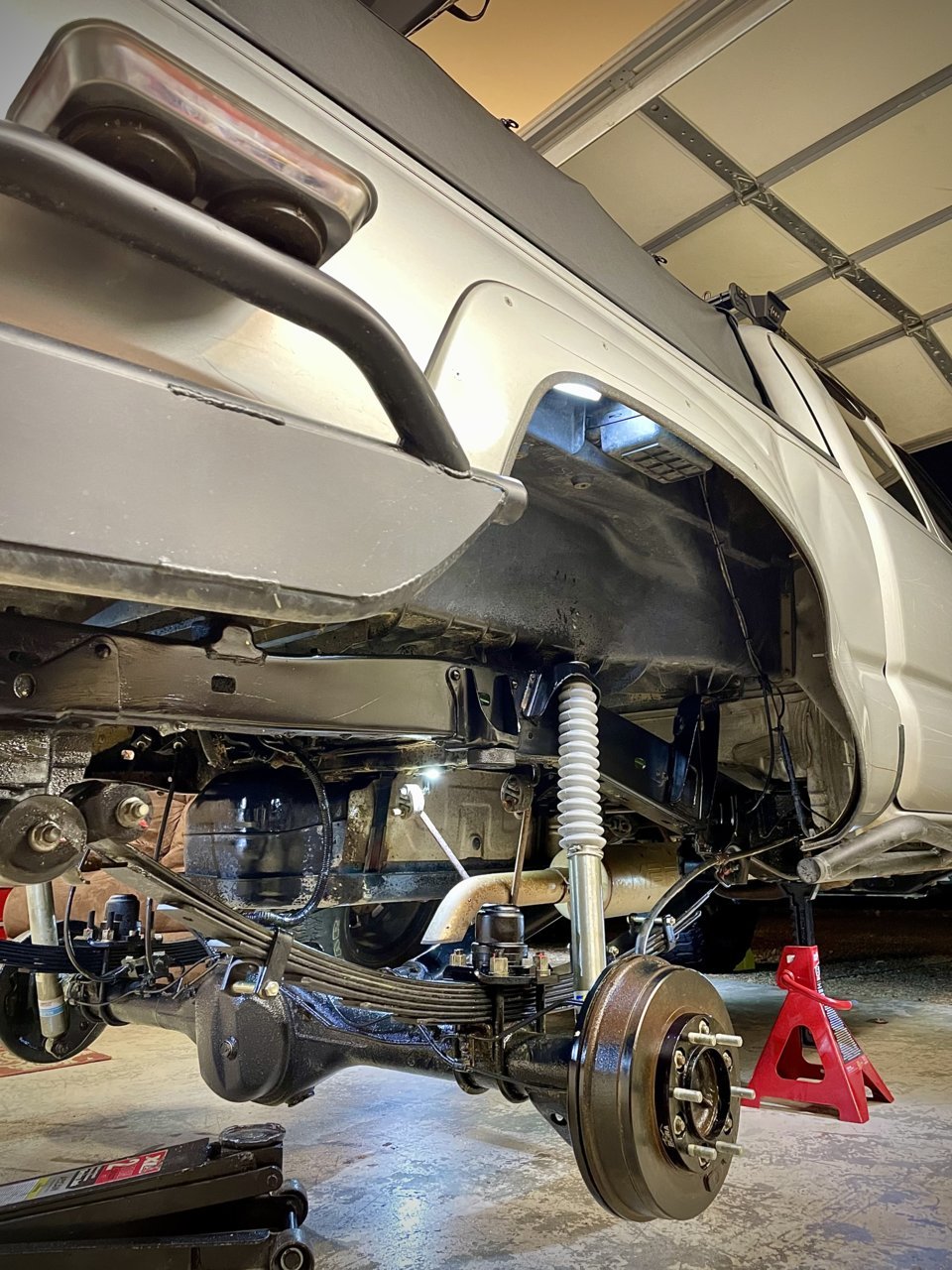

    Made up an air distribution block and ran the line to the rear fitting on the truck. The front bumper fitting had already been ran. Now I can keep a shorter air line to air up the front and back separately. Also prepped the rear and of the truck for winter.

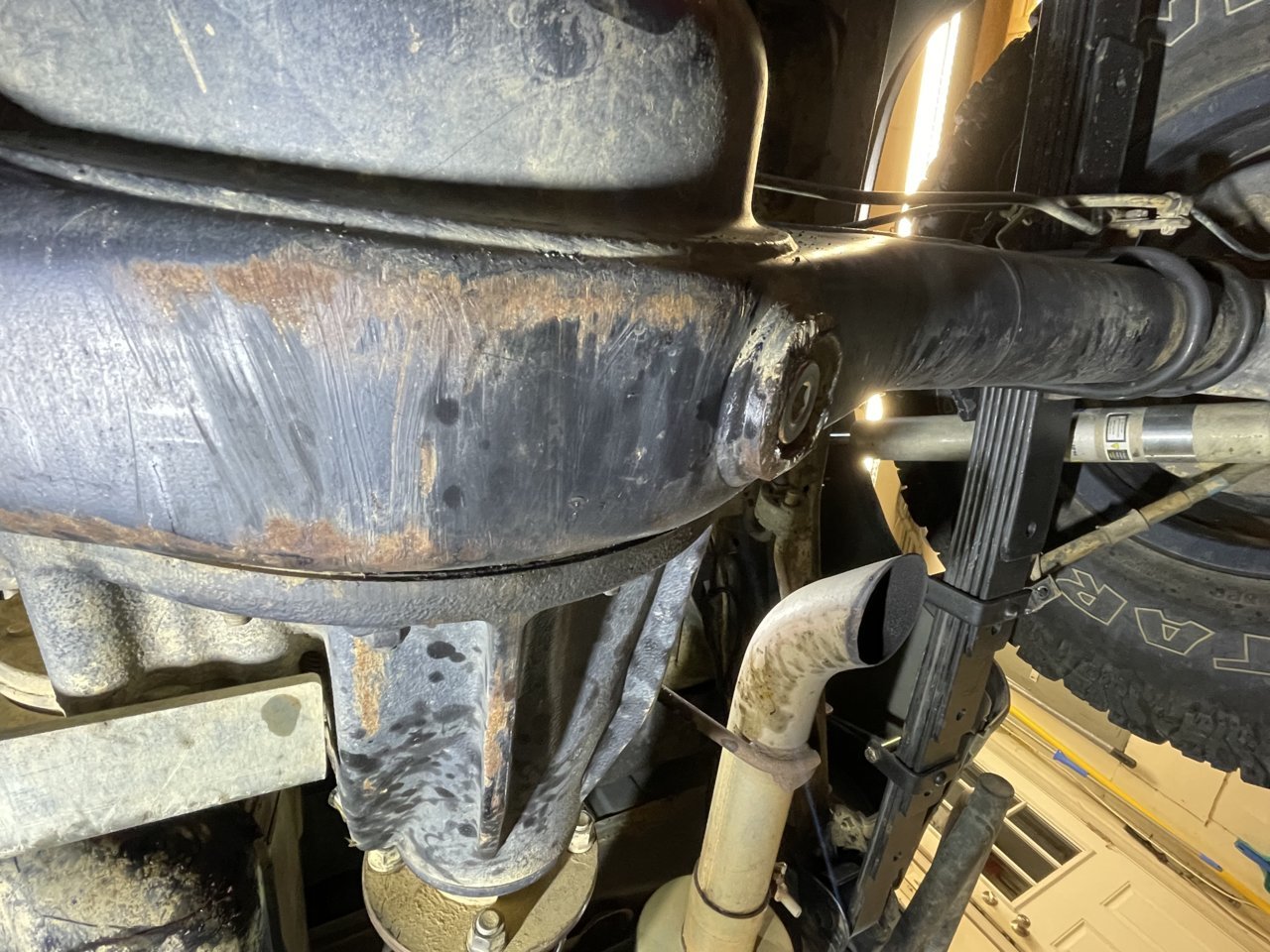

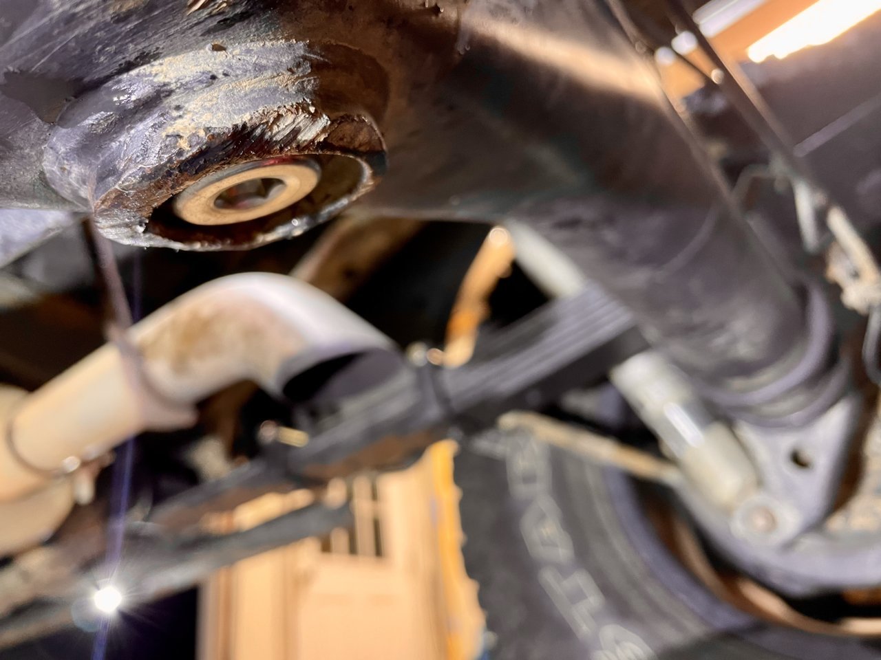

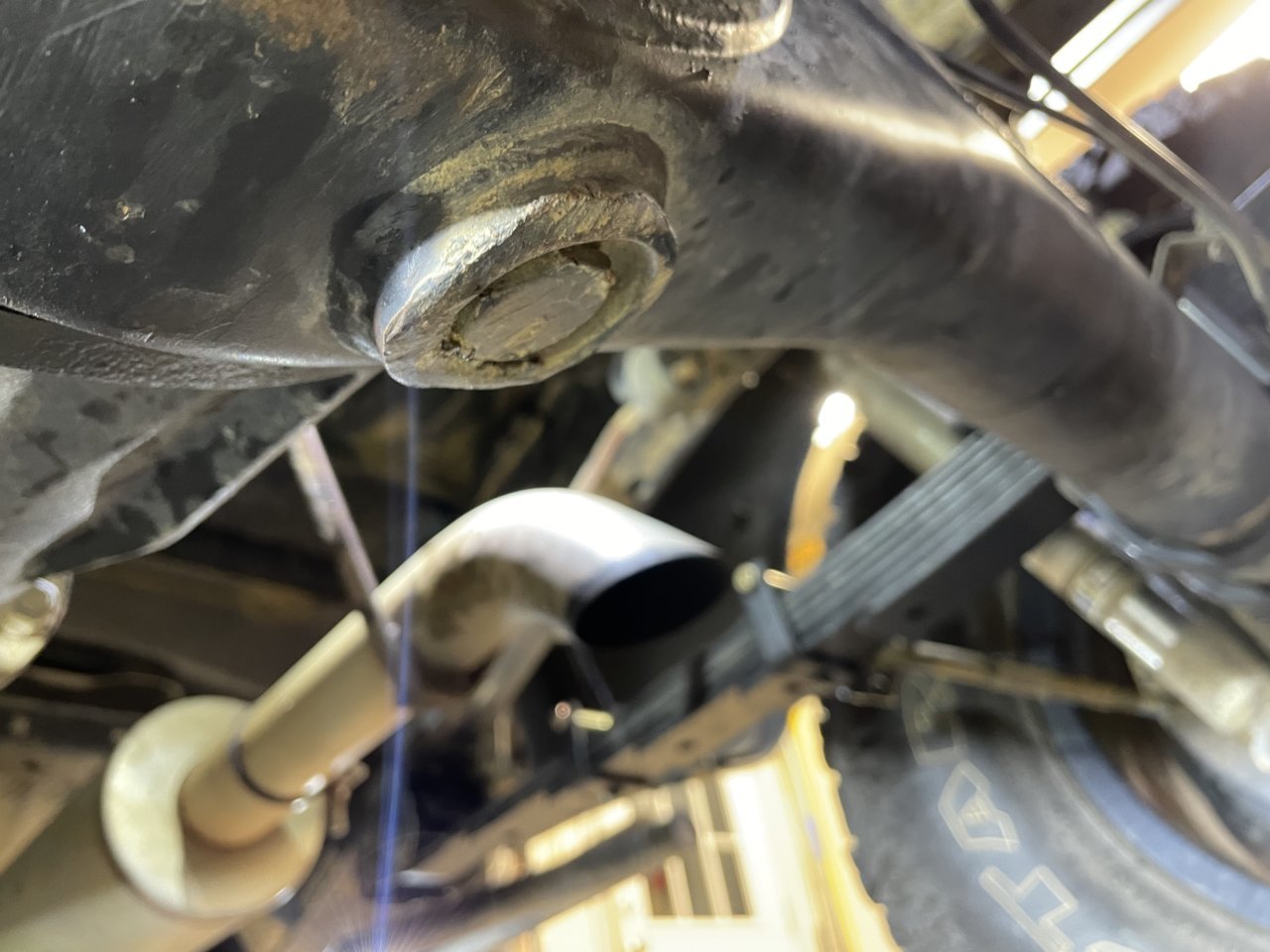

    Changed the rear diff oil and added a Lexus drain plug so that I don’t have to keep chiseling the stock bolt to come off from dragging her ass around.

    what rear bumper are you running there? Looks great
    DG92071 likes this.
  19. Nov 27, 2021 at 12:39 PM
    T.Barn
    T.Barn Well-Known Member
    Sep 1, 2020
    #339422
    695
    Todd
    Hampton Roads, Virginia
    2010 AC 4x4 6MT
    I appreciate it. It’s a warfab high clearance that I had them add side tubes to. Awesome company and great products. It’s took quite a bit of abuse already.
