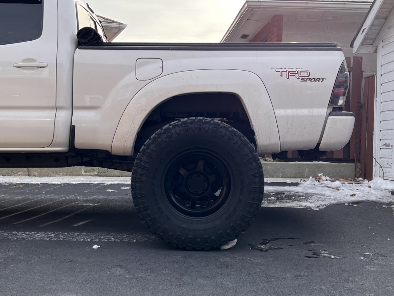

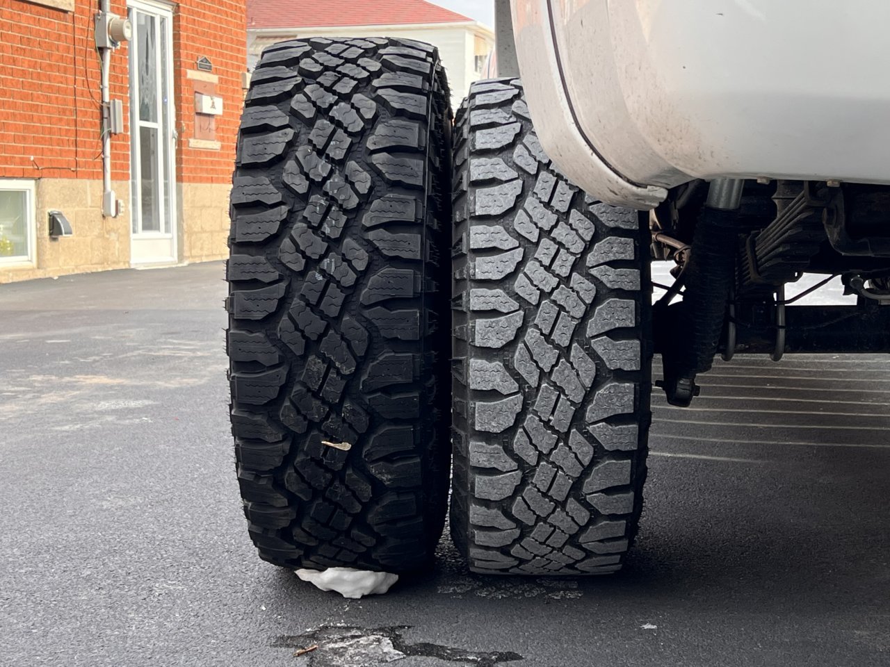

    Soon to join the 35” tire club…
    47C0F0A6-FBED-47D7-8D63-B14B59BE54B7.jpg 8EECB1F5-D558-4EB5-997E-6F615CDB0823.jpg 59FC856B-B813-451E-BD79-211BED14141B.jpg 24BB958C-F5B1-4EA8-81DC-9D80B53C374A.jpg

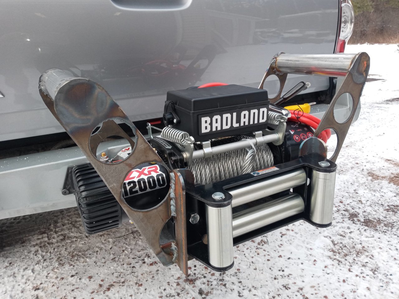

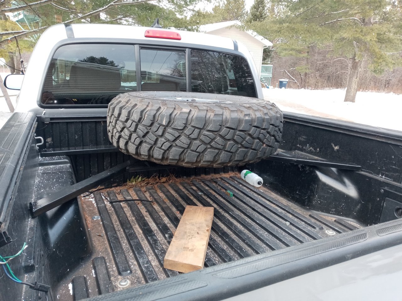

    Busy week! Bumper got installed, winch plate fab'ed and new tire mount...
    Oh, and I got my rock slider plates cut and bent... now for the tubing!

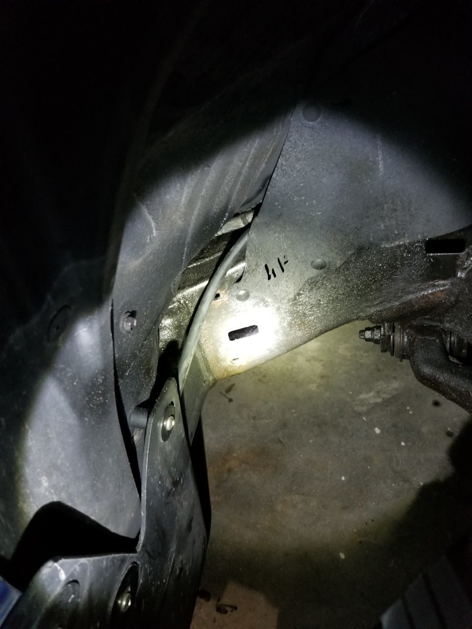

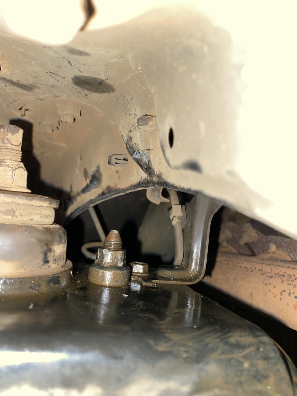

    So I installed 2021 TRD OR suspension on my 2006 AC last weekend. Drove about 20 miles on it today for the first time. Heard a noise from the front, checked it and realized I forgot to tighten my sway bar brackets all the way. So I tightened them up and then I notice something. My sway bar is touching the bottom of my shock on the front driver strut. I checked the passenger side and there is probably a millimeter of space on that side. What's the recommended fix for this?

    Did you install the coils on the correct sides? They are side-specific.

    I knew this, but now I can't remember if we double checked. Oh boy...

    Take it out :spy:

    Or you could take the sway bar off until you have time to swap the shocks around, you might actually like it without it on.

    Not saying that is the cure but that is where I would look first before taking things apart. I can't remember if the red dot is on the drivers side or passengers side, and if I remember correctly the dots face the front for the correct orientation. There is a whole thread on here that details the procedure. I put a 2019 on my 2009 with no issues.
    Or you could just delete the sway bar like others have said. The side-specific was to correct the Taco lean I believe.

    Would the swaybar spacer work for this?

    Im not sure, my sway bar is removed, but it might

    You need to install a sway bar relocation bracket. There are also several of them on Amazon
