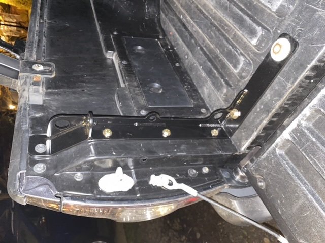

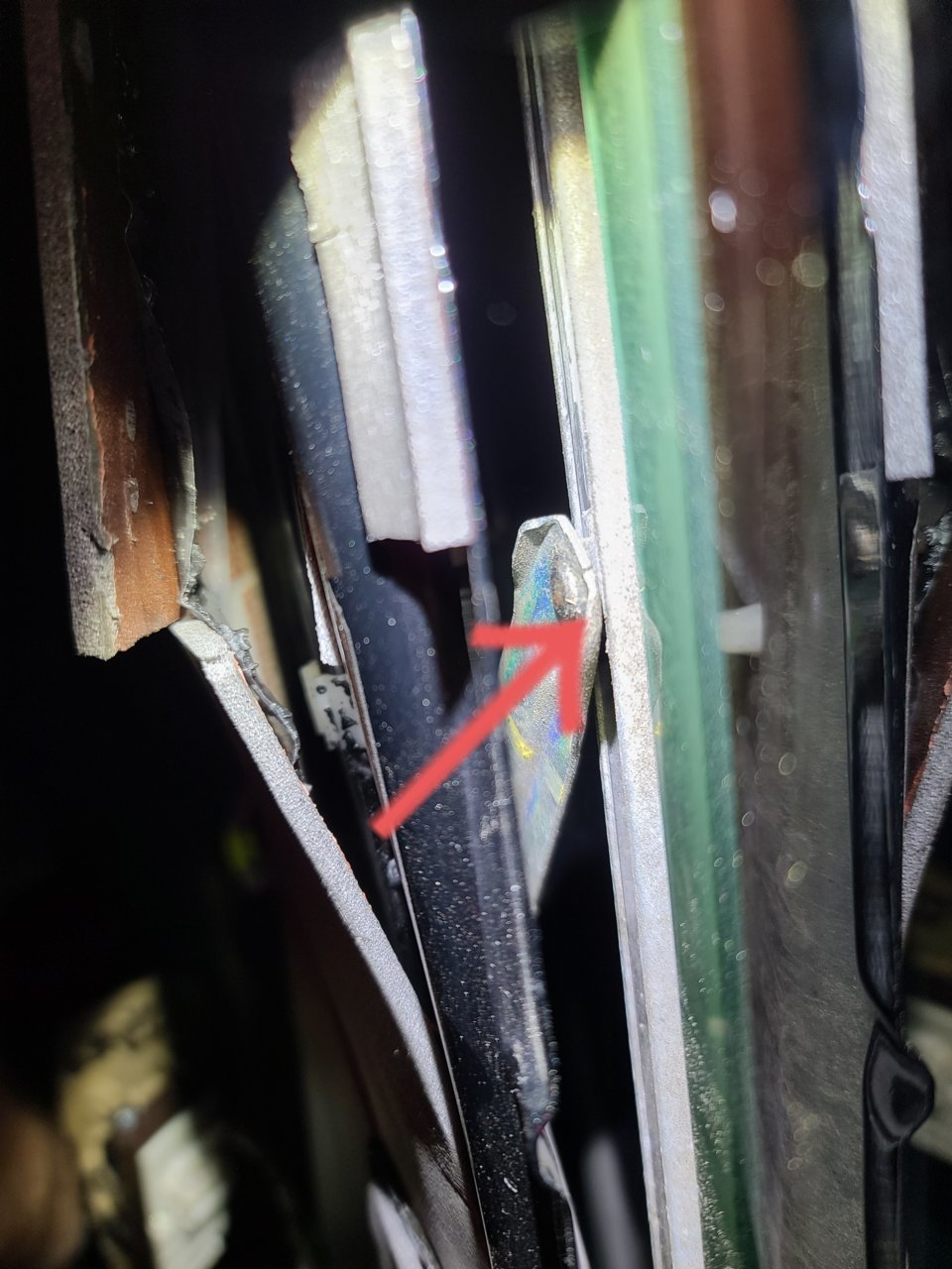

    Tore my driver side door apart today in hopes of chasing down a super annoying vibration/rattle. (Imagine a bunch of screws rattling in a aluminum can to beat of your favorite tune.)
    To make it even more annoying, the vibration would only make it's self known when I turn up the volume on HU to 20% or higher. To top it off, I have sound dampening and insulation all around making this PITA.
    After begrudgingly removing the dampening & insulation to access the channel, I first thought it could be a peice of broken plastic rattling around near the speaker but that wasn't it.
    I then checked the door cable. It was rattling a bit but turned out not to be the culprit either.

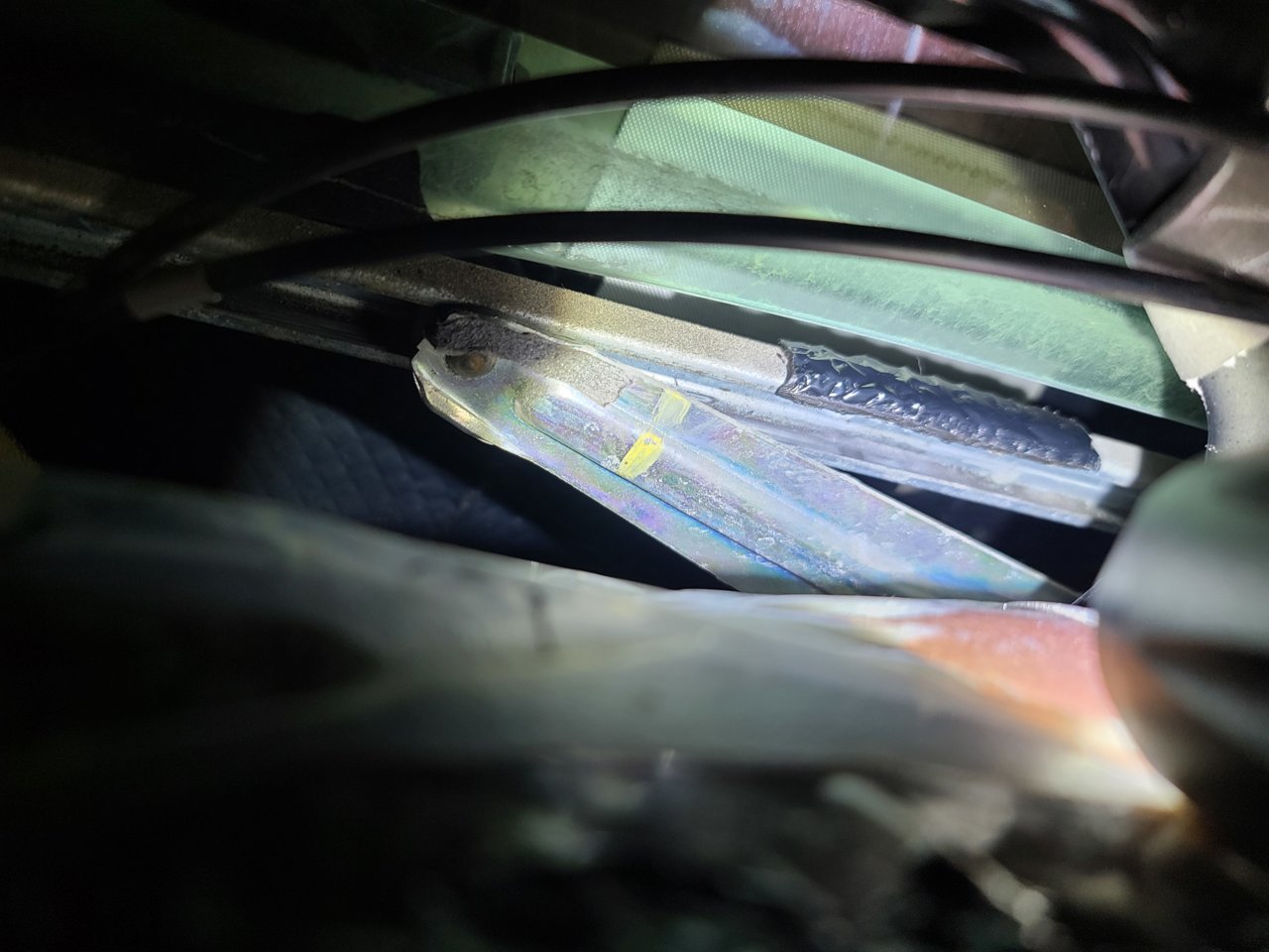

    While trying to recreate the noise, (Bare with me, I'm not familiar with the technical term for window each piece) I pressed a flat head into the window rail and luckily found the f@$king culprit. The bracket that's mounted to a roller which glides on the window rail is starting to get old and loose.
    Not wanting to replace the whole damn assembly, I used a strip of 80mil dampening and applied across the rail to help eliminate any play. So far it's working and hopefully it stays that way.

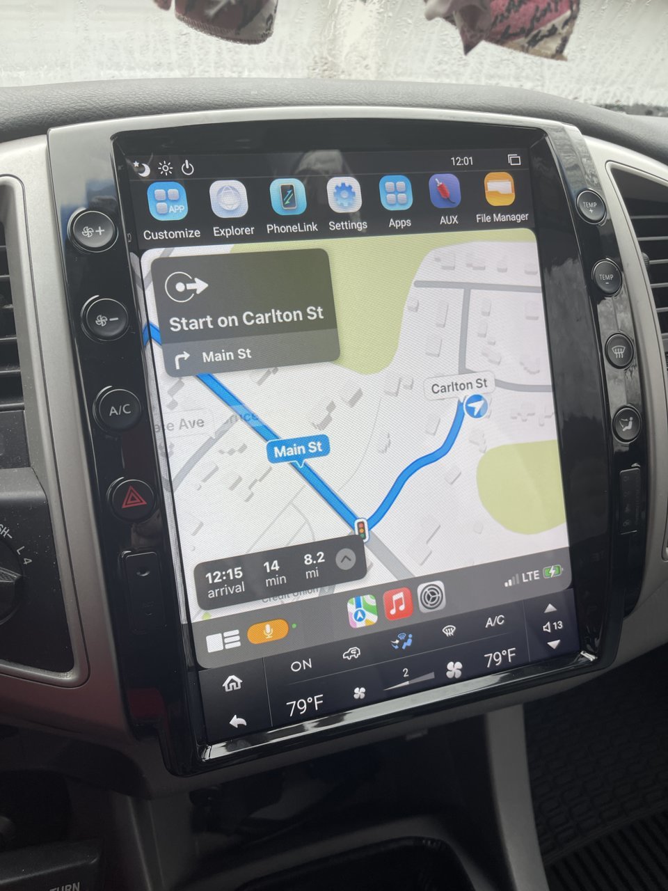

    These are becoming very popular. Assuming easy install?

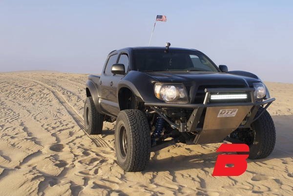

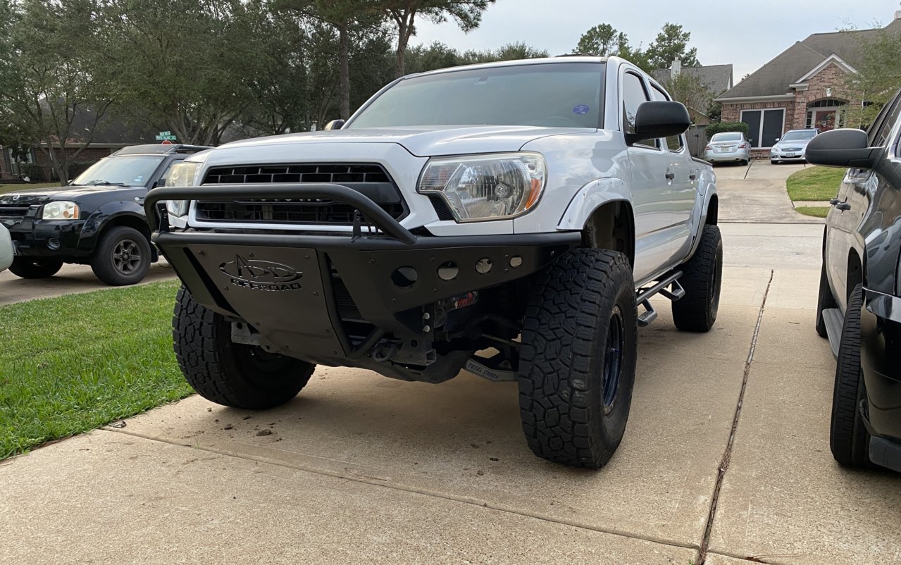

    thanks..this is like a Bro bumper, wannabe prerunner style bumper..
    Hybrid is a cross between a plate bumper Pre runner/Baja style bumper. The inner portion tends to be plate and winch ready, with the sides being tube style.
    Plate bumper
    PreRunner or baja bumper
    Hybrid

    I bought this one. But was gonna build one. I just don’t have the time and didn’t wanna be running around without a bumper. Seems my wife drives the truck more than me, I have a company ride.
    building one, you need the tools and knowledge. So DOM steel tubing, pipe bender, mig welder, plasma cutter or CNC Laser cutter would be nice.

    Yes very easy all plug and play. The UI is a little tough to understand all the settings but if you watch videos and read the thread here you get to know it fast. I love mine. drove 2 hours with car play on no issues using navigation and Apple Music. I added my truck to the boot screen and themes. AE5E711B-7746-492A-A2F6-6A918F8C257A.jpg
