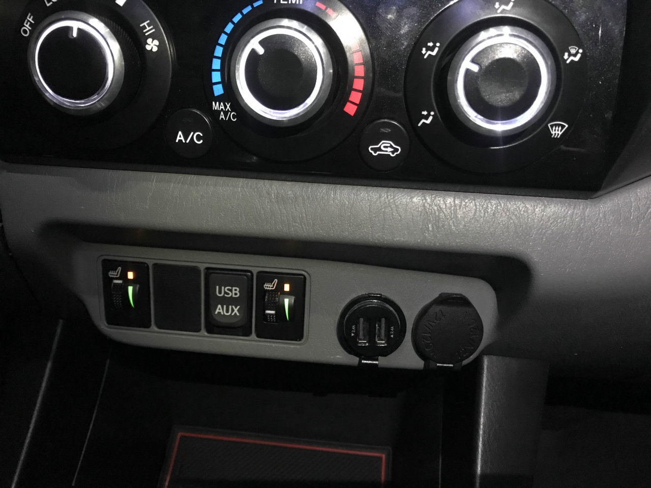

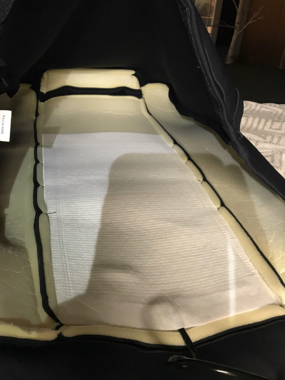

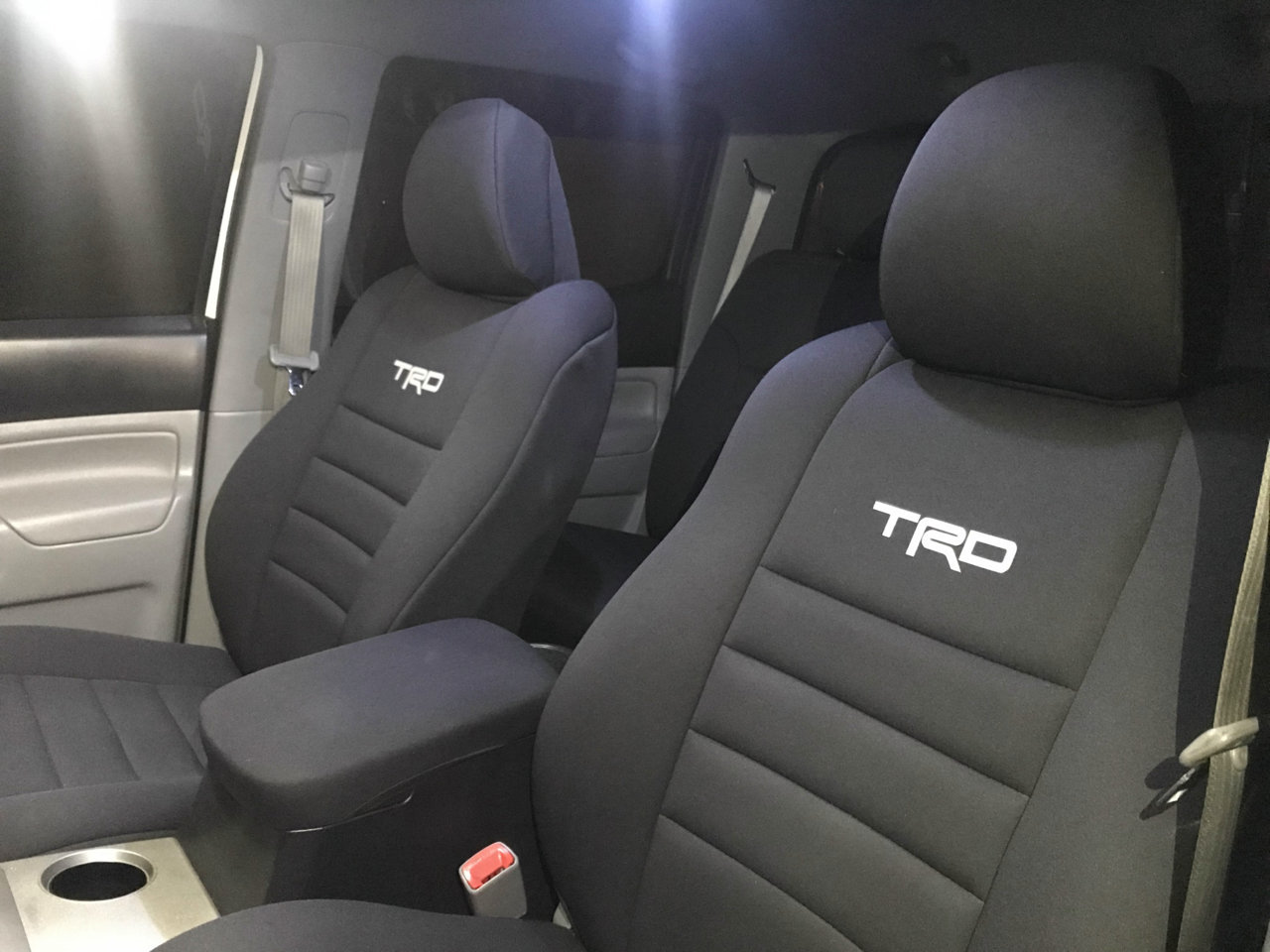

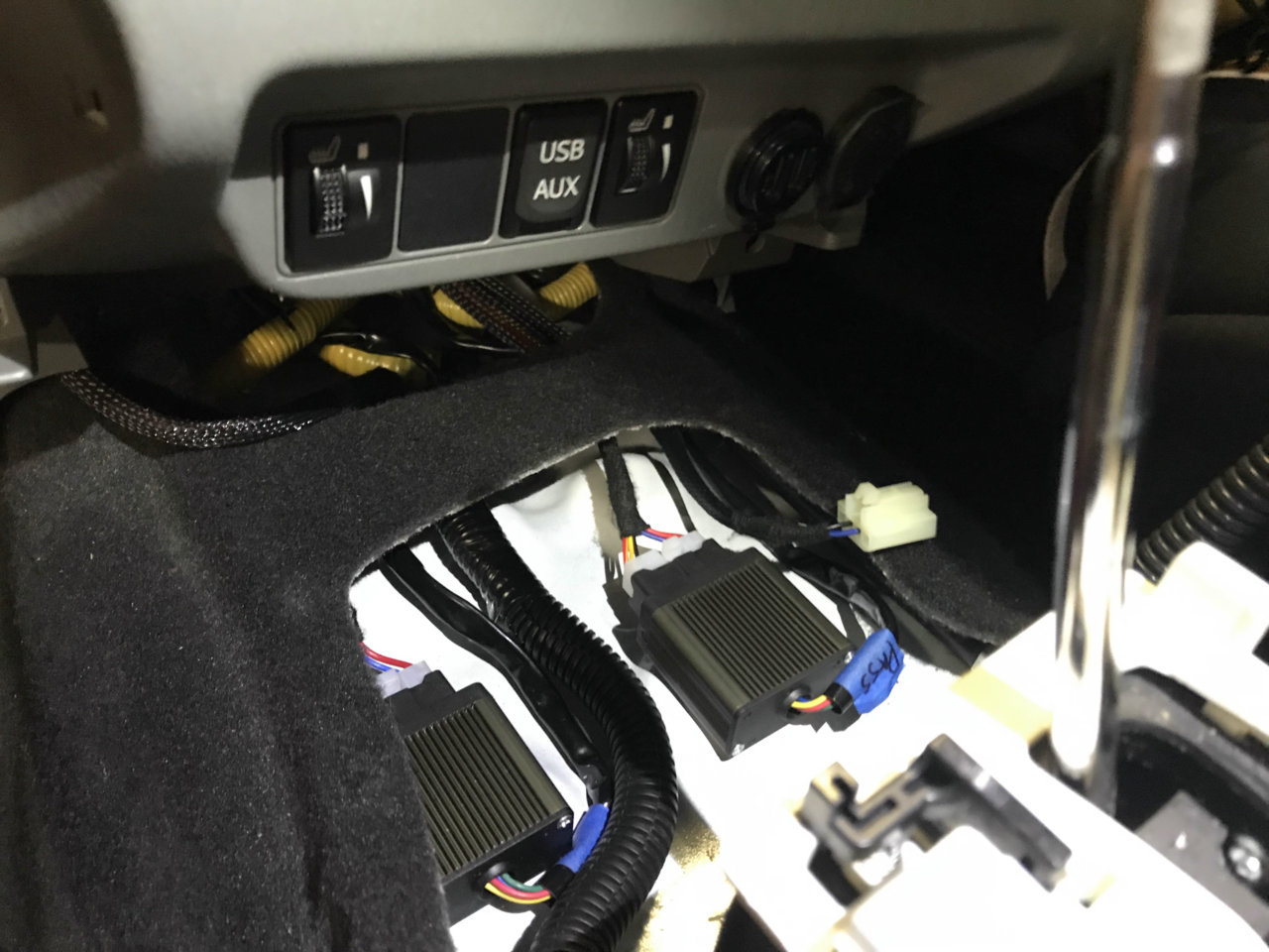

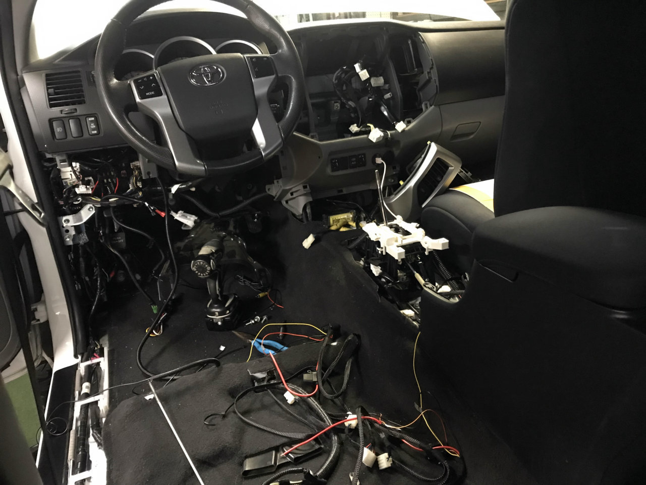

    Installed some heated seats in order to survive these CA winters :p Digging the factory-looking, 5-level switches.

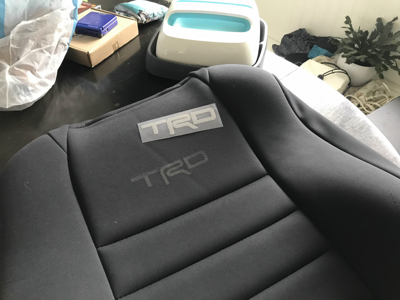

    Also showed my 6-year-old Wet Okoles some love since the original TRD logos had peeled off. Being a crafty school teacher with a Cricut cutter and heat press, I cut and applied some new iron-on vinyl logos.

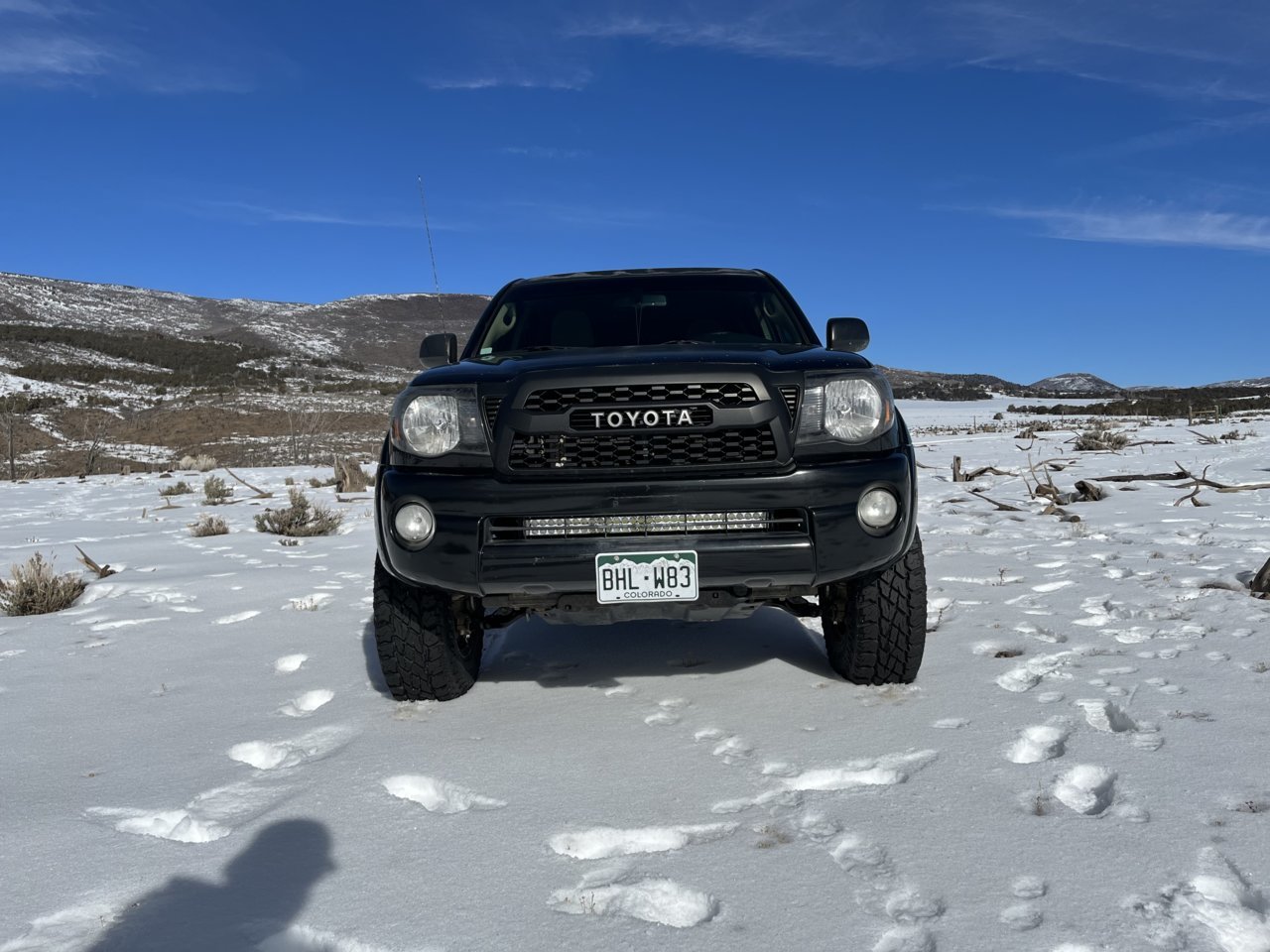

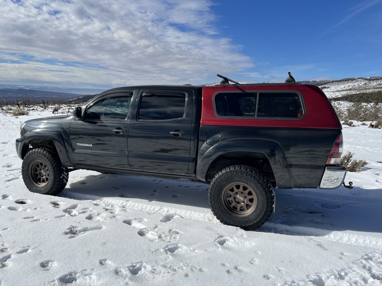

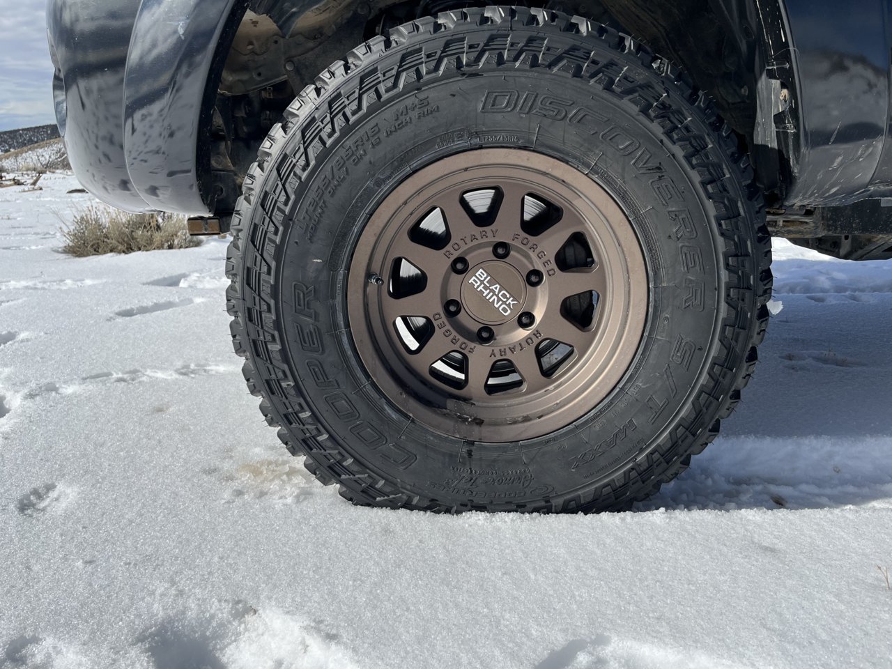

    Got some new shoes, 255/85/16 Cooper st maxx on Black Rhino stadium matte bronze 16x8 -12 offset. Loving em so far!144DCD30-97BE-4022-B3C4-4E6554BF35E3.jpg
    Installed my light bar that has been sitting around my garage for a year 43C9221C-90CF-44EB-B1AD-CAA60DCA142C.jpgalso put on some new lower control arms and changed the oil. Big weekend.

    Where did you get that seat heater kit? I need to do that to my rig!

    I want seat warmers soooo bad… But man, that install looks like a pita! How long did it take?

    A few hours, but I’m pretty familiar with the seat/dash/console removal, which isn’t fully necessary, but I wanted a clean install with wires running under the carpet and up through the dash to the fuse box rather than just along the edge of the shifter console. It also made it easier to tap into a green wire from the A/C for switch illumination and off the cig for 12v+ to activate the relays. I ran the power wires to two separate add-a-fuses.

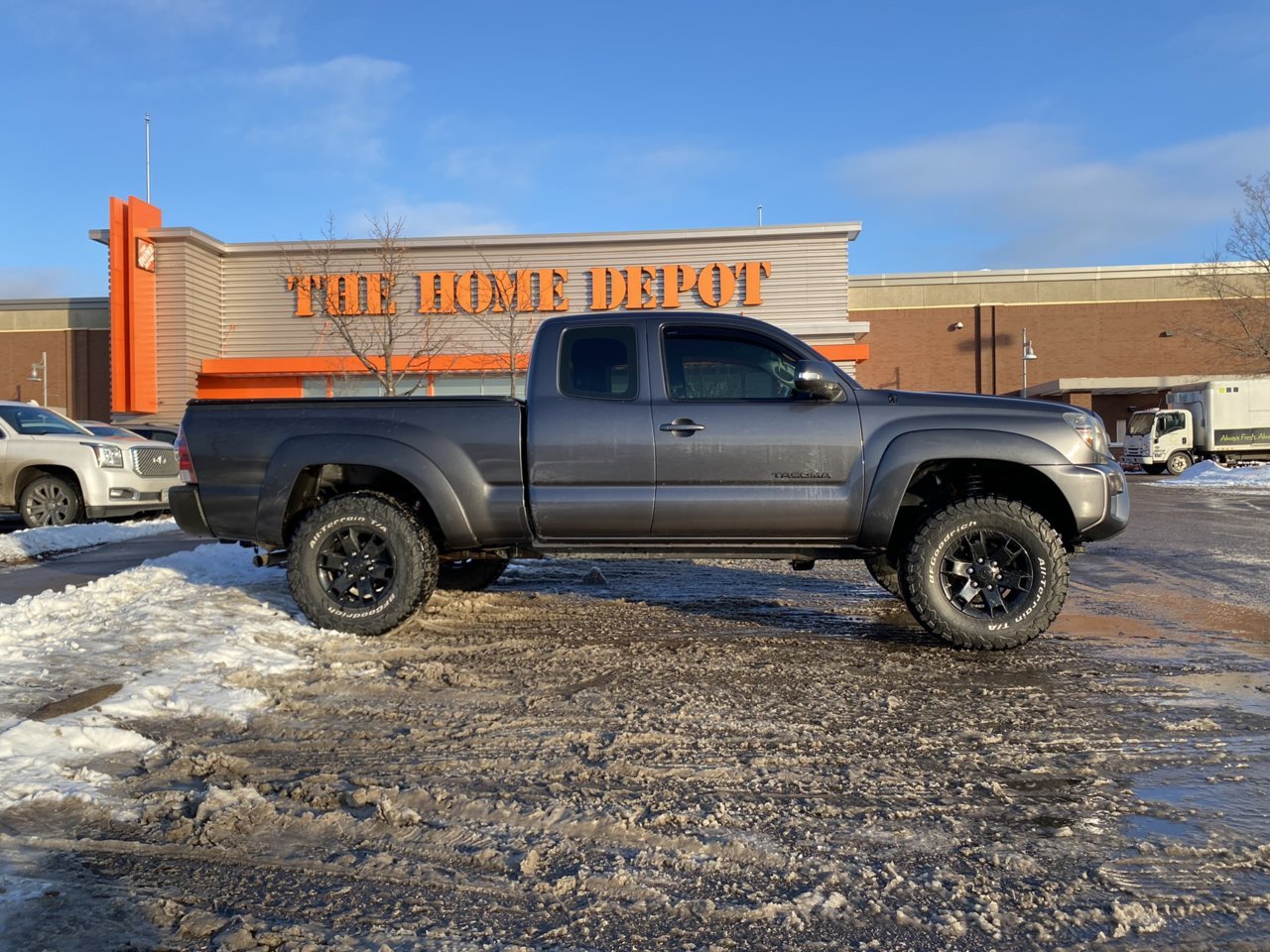

    AAL comes in today. I’ve been “enjoying” my squatted Taco in the meantime. It’s -10 degrees in Minnesota today so will have to wait a little longer to do the back.

    I opted for the Icon AAL in hopes it would level out my lift using Bilstein 6612s on the 4th clip in the front. Unfortunately, it was still squatting, so I picked up some Icon RXTs and swapped leaf packs.
    Hope the AAL you’re using gives you the lift you’re looking for!

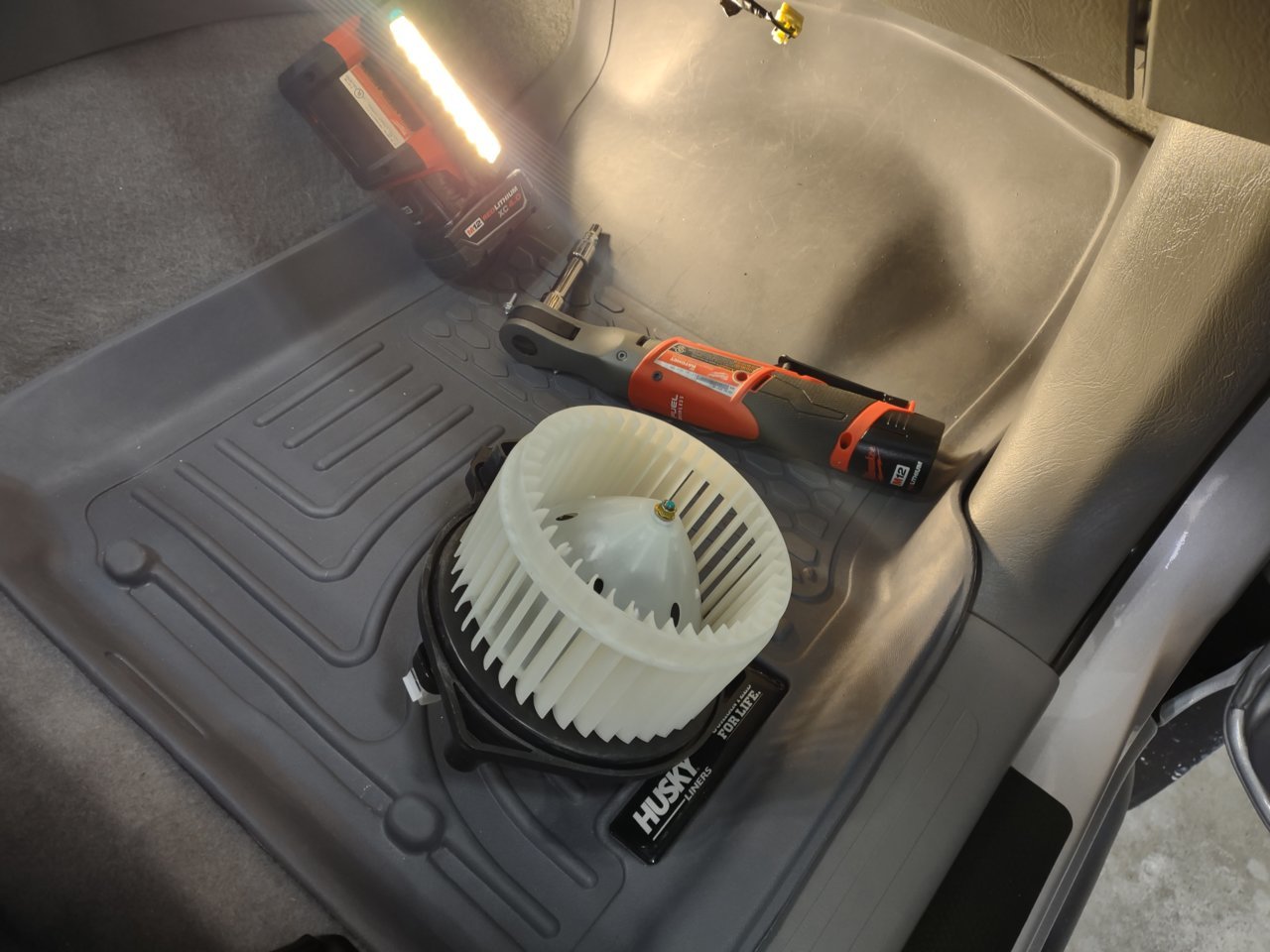

    I replaced the blower motor today. I got tired of hearing it squeal. Lubing it up only lasted a few months. IMG_20220119_160434714.jpg

    I need to do this too. Mine gets really bad at times.
