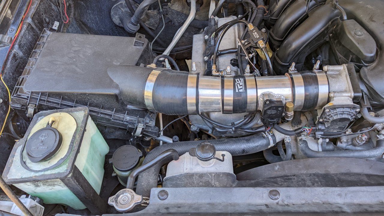

    I did a similar version on my truck when I had it. It comes in over top of the radiator and fan shroud. I did a piece of 3" aluminum with a 90 degree bend though. Full 3" all the way through. Never had single issue with it through torrential rain, blizzards, mud, dust, dirt, etc.
    My reason was more to free up near the ABS module to try and fit a second battery, but never got around to it before I sold the truck.

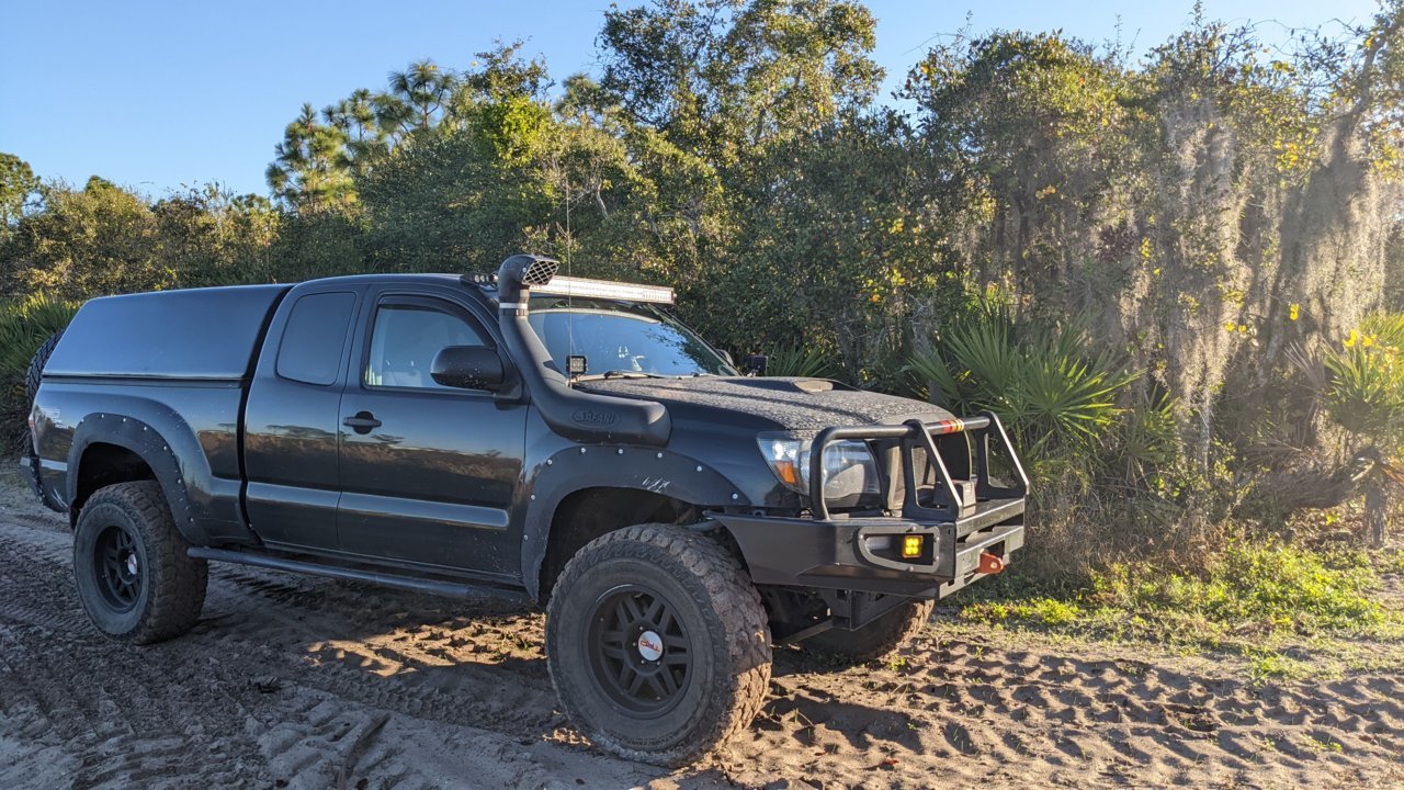

    Here's mine:
    I hated the tiny triangle filter shoved way up high hard to reach over the engine and the massive silencers and unnecessary bends in the intake so I got a FJ cruiser box big beefy filter with cyclonic separator in it, 4" to 3.5" cocktail shaker tube with airflow straightener 3" MAF tube, eventually want to do the 76mm (3" ish) Tundra throttle body over the factory 2.65" TB.
    I did have to relocate and trim my washer bottle and build a bracket for it and the PS res.
    Worth it.
    Throttle response improvement and MPG improvement.
