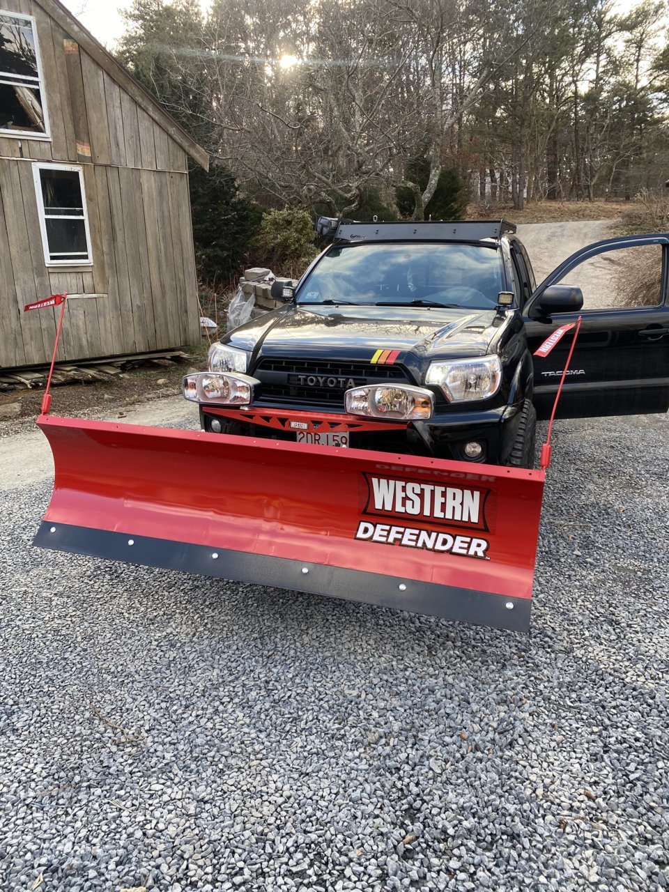

    Picked up a plow

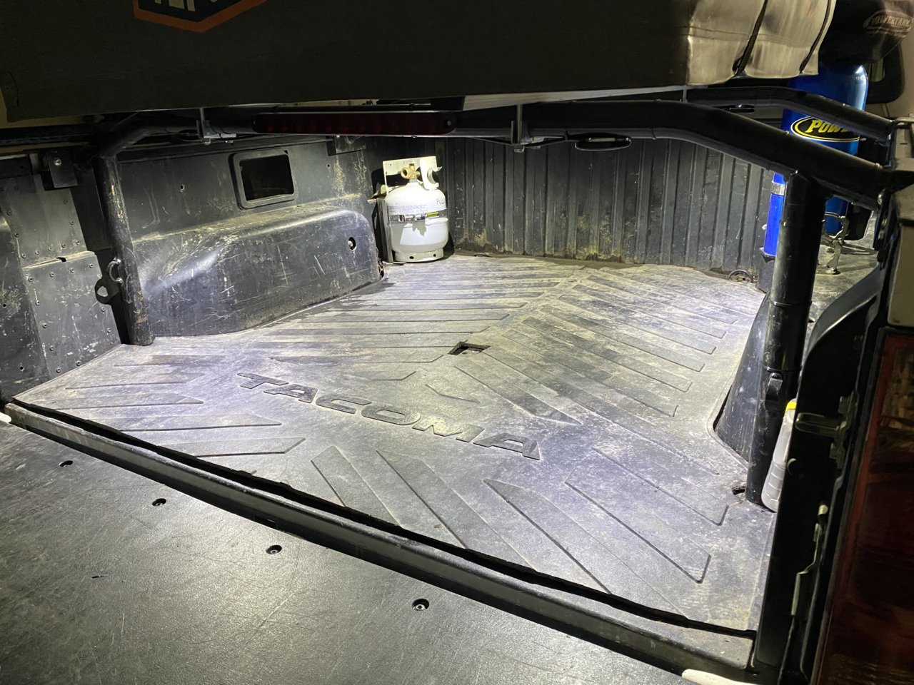

    What bracket do you have for your propane tank? Is it just sitting in there in that pic or did you mount it to the bed mat or truck bed?
  10. Jan 26, 2022 at 1:52 PM
    EatSleepTacos
    Mar 24, 2015
    #151688
    59,841
    Randy
    West Valley, AZ
    2017 4Runner
    https://powertank.com/products/bkt-2285
    I drilled some holes in the side of my bed and used fender washers on the back.

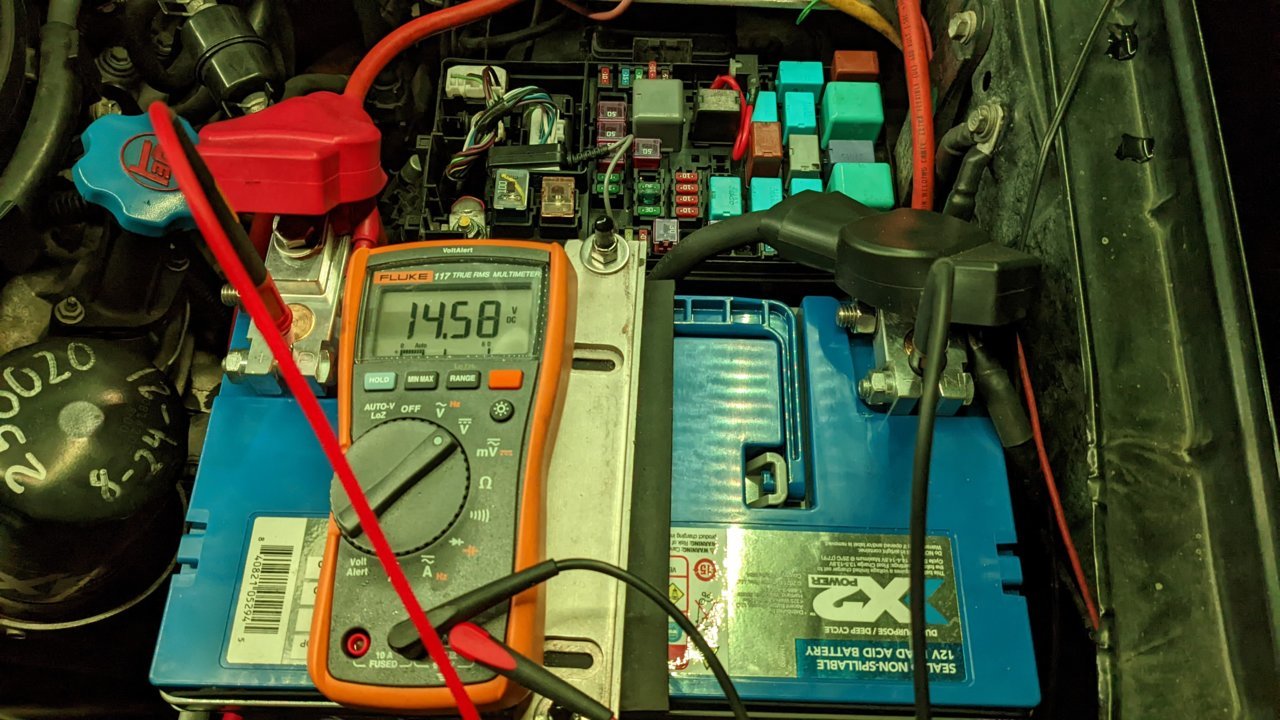

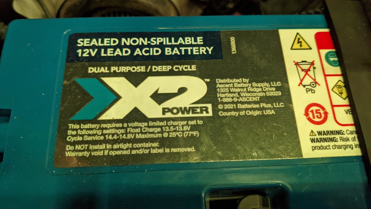

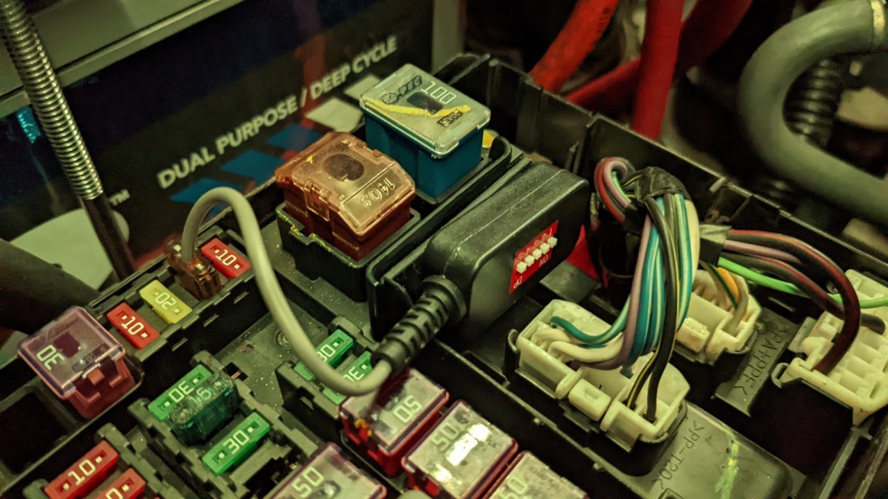

    HKB adjustable voltage booster for AGM batteries.
    Thanks @crashnburn80
    PXL_20220126_233145788.jpg PXL_20220126_233154999.jpg PXL_20220126_233222755~2.jpg

    Thanks for the teaser, now give us the info....where can we get one of those buggers?!:spending:
  13. Jan 26, 2022 at 4:10 PM
    Key-Rei
    Key-Rei Well-Known Member
    Jun 20, 2017
    #221942
    7,863
    Key
    Florida
    2010 TRD Off-Road 6Spd 4x4 209BSM
    Locker anytime Fog Lights anytime Full LED light conversion TRD cat back Rear cat delete Exaust Y reroute away from actuator Alloy Clutch master 2000 4Runner "Dog Leg" shift leaver Marlin shift seats and bushing Rear seat delete Rear diff breather extension Chrome grille swap Debadge Rear seat delete Honda blower motor beefy plug and wire mod Anytime 12v and USB with volt gauge in bed Blue Sea fuse box Hella AND 70's Caddy horns Low profile recessed hex drain plug swaps Alluminum battery strap 7pin relocated Backup cam on anytime Various other creature comfort and personal taste mods.
    :rofl:
    Here:
    https://www.hkbelect.com/
    Staight up from Down Unda!
    Fast shipping all things considered, about 3 weeks to arrive.

    Awesome, I thought that was the seller. What AGM battery provides the best bang for the buck and also fits in the standard battery tray, and/or which battery tray is best to support this battery setup?
  15. Jan 26, 2022 at 4:23 PM
    Key-Rei
    Jun 20, 2017
    #221942
    7,863
    Key
    Florida
    I have an X2 Power 27F (NorthStar Rebranded for Batteries Plus Bulbs) NorthStar is the best battery right now period, and buying it in Blue Batteries Plus Bulbs flavor is best price and warranty, 5 years no questions asked full replacement not a prorated.
    This battery, the big three(5) upgrade and a new starter about flips my truck over when I turn the key.
  16. Jan 26, 2022 at 4:47 PM
    fasteddieyj
    fasteddieyj Well-Known Member
    Nov 25, 2018
    #273740
    859
    Ed
    Hanover, PA
    2015 camping/mild wheeling rig. 2014 DD
    Second the X2 Power. They offer 10% off I believe from time to time if you keep an eye on the website

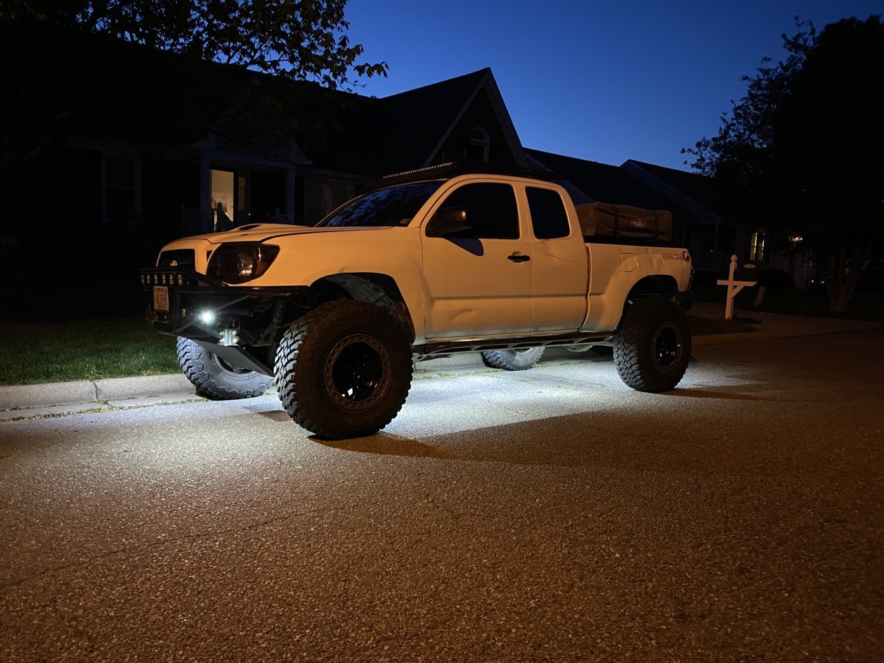

    they look bright! link saved, might consider this.
  20. Jan 26, 2022 at 7:04 PM
    EatSleepTacos
    Mar 24, 2015
    #151688
    59,841
    Randy
    West Valley, AZ
    2017 4Runner
    They’re great! I have 12 of them under my truck.
