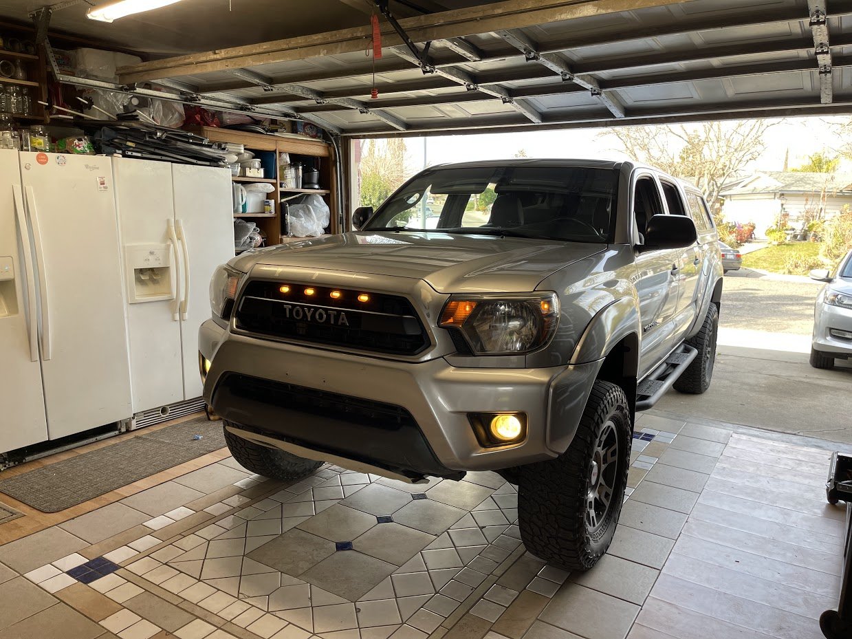

    I took them apart and painted them myself. I didn’t paint the black but more of a gunmetal color. Used spray paint from when I painted my g37 rims. Turned out great.

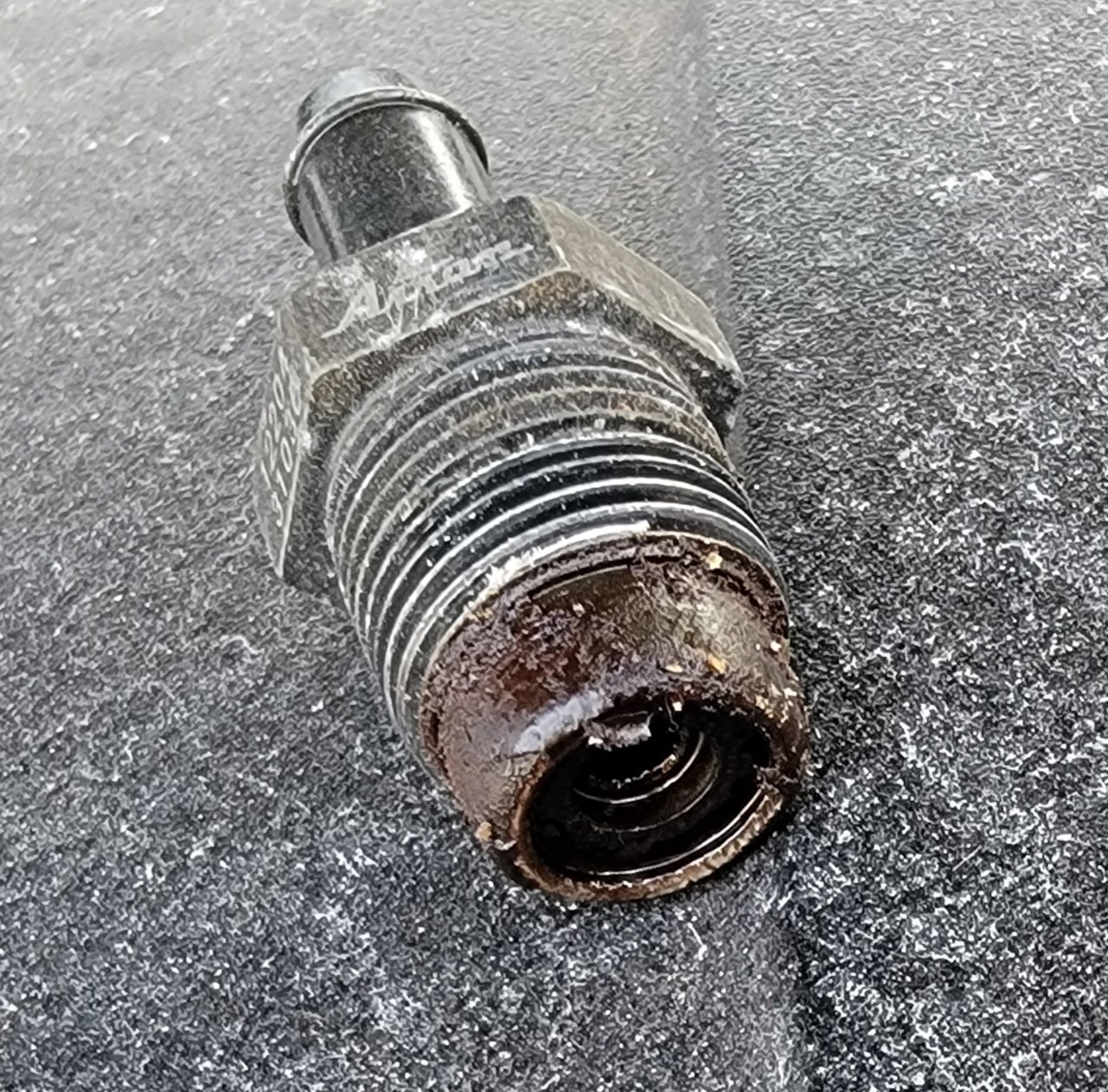

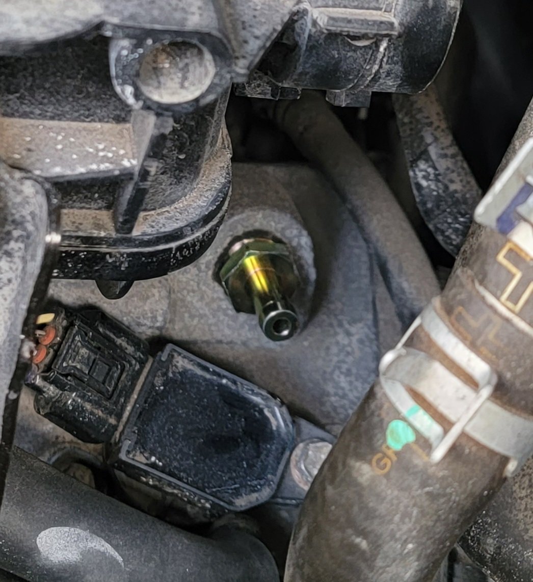

    You guys gave me something to do today. 182k on the original. Out with the old. In with the new.
    No breaker bar needed. Came right out with a ratchet and 19mm socket.

    that it did, nice work. i have an extra set of headlights laying around after i swapped and was thinking of doing somewhat of a bhlm. what did you use to reseal the housings?

    That rascal is well used. A new one certainly wont hurt.

    Ummm I just baked them in the oven to open them, and then baked them again to seal them. No leaks so far. 2 years and counting.
    When I put them back together before the oven, there were multiple screws that secure the housing and the front lens. So I made those as tight as possible and then baked them. That way the factory glue got soft and formed a nice seal again.
