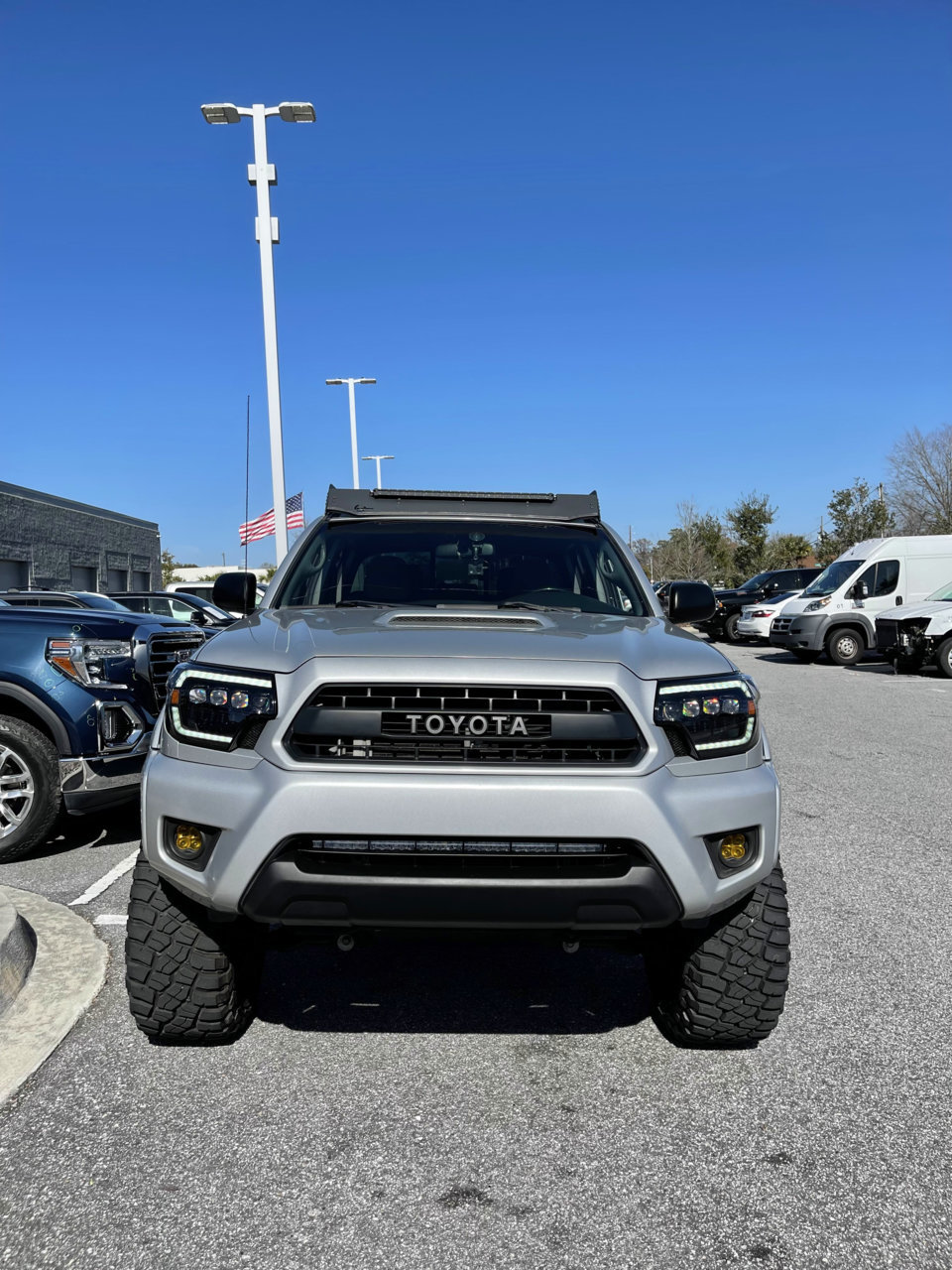

    Roof rack is Prinsu, had it for 4 years. It's held up nicely.

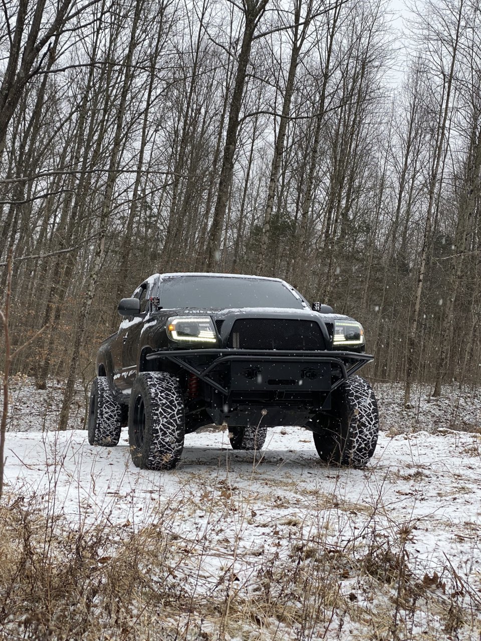

    Full trd pro suspension. Toytec progressive add-a-leaf pack (with overload in). Sema trd 4runner rims. 285 70 17 ridge grapplers. Satoshi grill.
    What headlights?

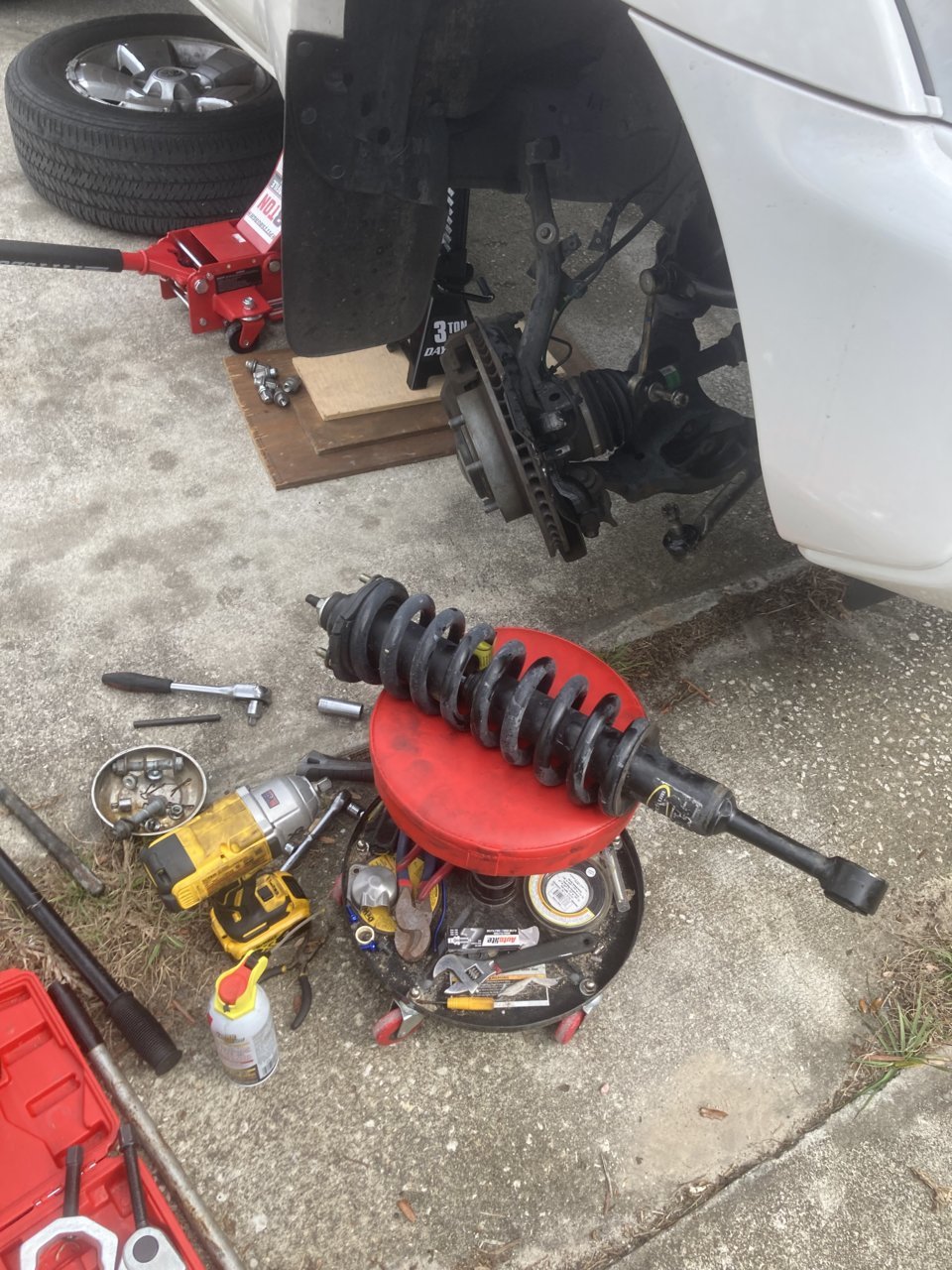

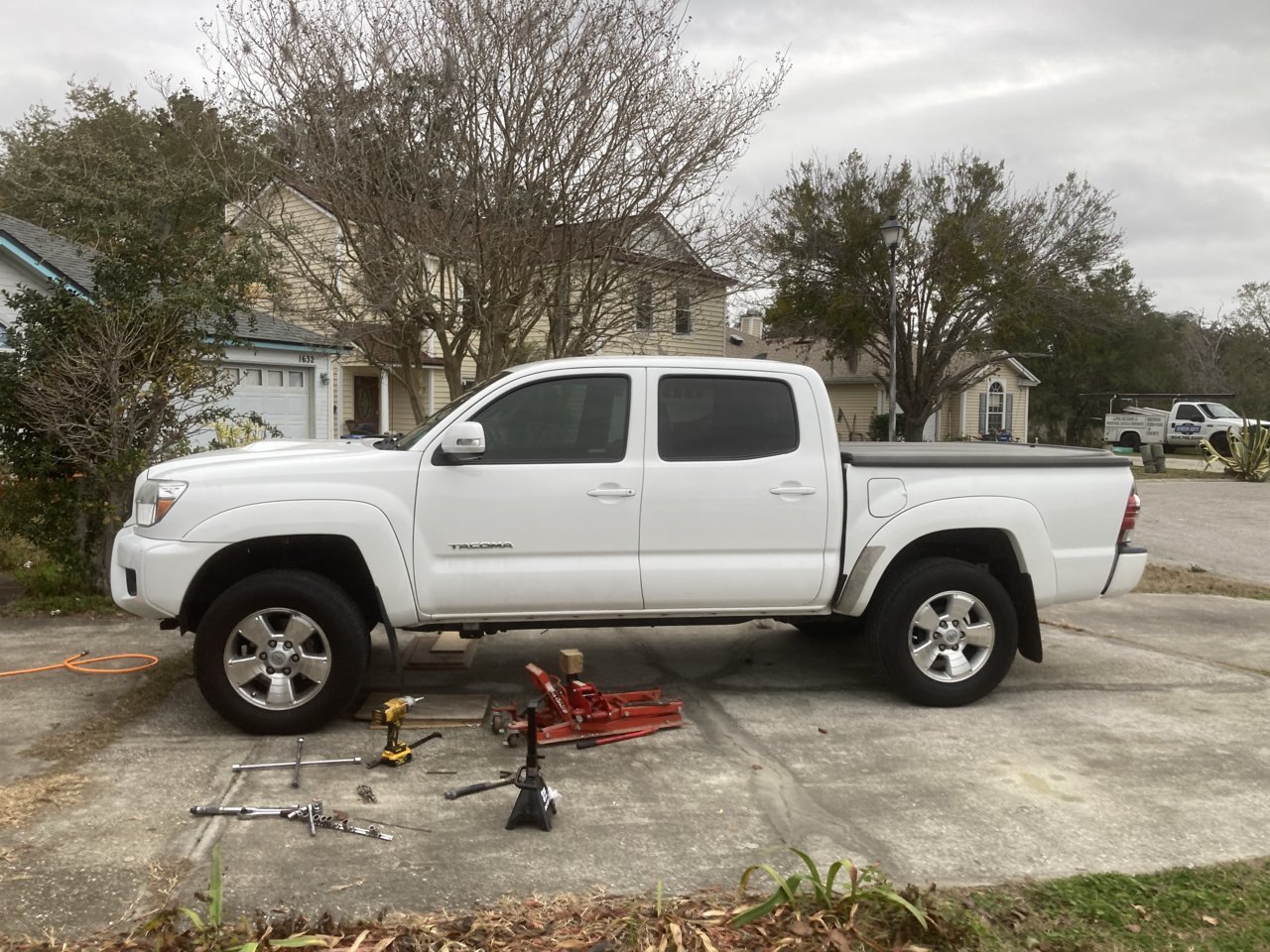

    (Truck only goes on the beach and the streets, so don’t hate ) I challenged myself to do a 2.5 inch spacer lift so I can get 265/70/17 all terrain tires without rubbing. I did the front yesterday, and didn’t need to do the diff drop because everyone is still aligned nicely. The cv joints look almost exactly the same. Haven’t done the rear yet, but I kind of like the stance right now, it’s pretty level and rides just the same with a little extra clearance up front.
    So my question is do you think I could get away with putting on those tires without doing the 1.5 inch rear lift?.

    Yes the tires will fit. Unless you have crazy low offset.
    And dont bother with the diff drop. Doesn’t really do anything.
    truck looks great

    my truck came with 265/70r17 A/T on it already from previous owner
    with zero lift installed. It did not rub
    that 31" tire size is barely bigger than stock
    right now I'm at 2-2.5" with excess positive camber and worse ride quality. There is barely any downtravel. I would not do that.

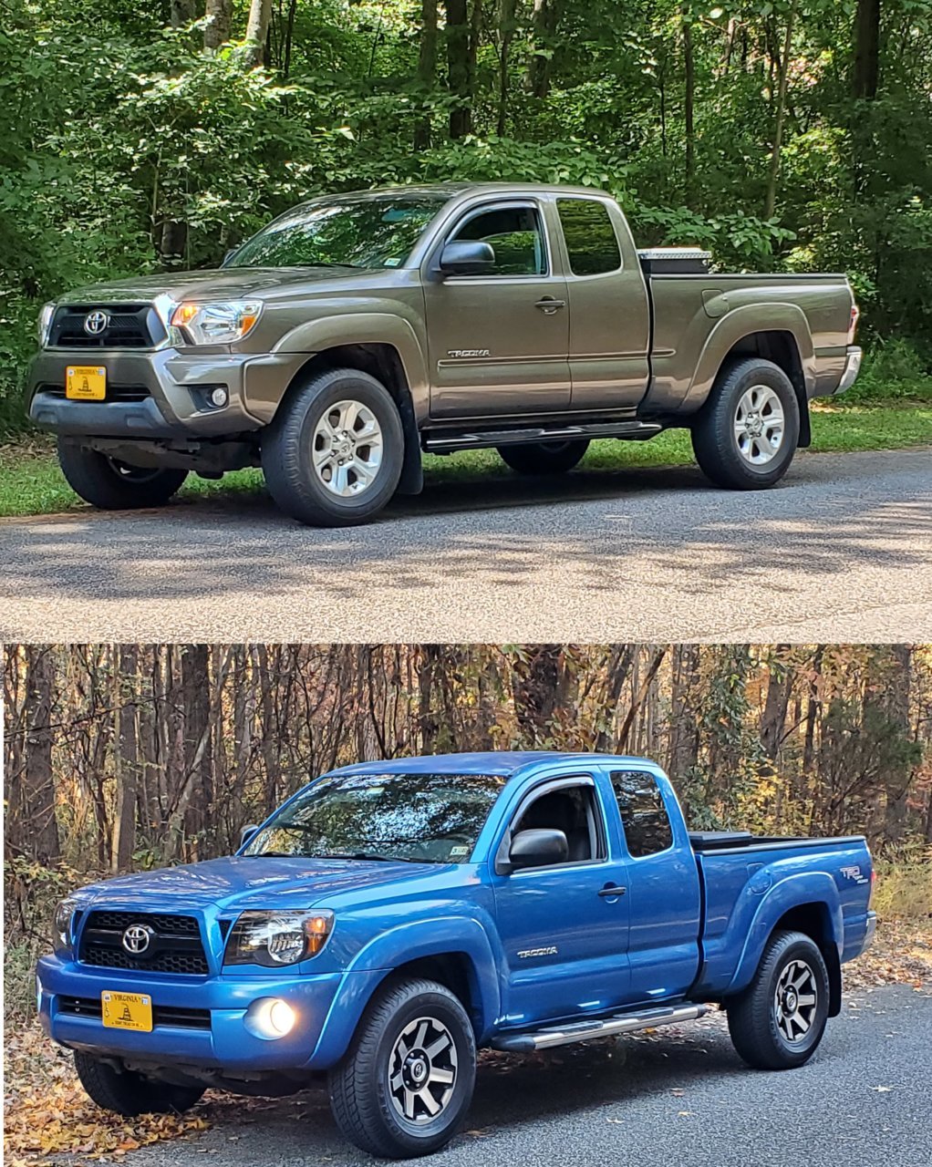

    I have had 265/70/17 on a few Tacos with no lift. I did put 5100's on my 3rd gen to level with KO2's but none rubbed stock on any 265/70/17. I used 4runner wheels on the last 3 so no offset issues.

    When I ran that size tire on stock suspension it only rubbed on the front mudflaps. No clearance issues in the rear.
    Spacers aren't a great way to lift IFS. If your spacer is on top of the coilover you will be bottoming out the shock without hitting the bumpstop, which can bend or break the strut. You can also be pushing the control arms too far down when the shock extends all the way, beyond the limits of ball joints and CV's, which is hard on those parts. You'll have less total suspension travel available too - there's about 1" of extra droop available before things bind up so you'll get that, but you're losing on the top end. You should add limit straps to prevent the binding, and add bump stop spacers to avoid harshly bottoming the shock.
    If your spacer is inside the coilover assembly it's increasing preload which is fine as long as the coil doesn't bind in compression. Limits of suspension travel will still be the same but your ride height won't allow for as much downtravel, probably noticable over potholes, but at least it wont break anything.

    I know and have read many reviews from both sides. Since it’s only a small 2.5 inch it’s not really making a huge difference to me. The suspension still feels the same tbh. When I need new shocks I am going to buy a full 2.5 inch suspension lift. Just putting money aside for it for now because I want a good quality brand.

    2.5” might be too much lift.
    You could get Bilstein. 6112/5160 combo for a much better ride and some lift if you put Icon progressive AAL.
    Problem is 6112 front seems to be on a long backorder.
    I don’t know why every off-road company website says In Stock. When you call them to check they say they’re out.
    I imagine this is the type of thing that will charge your card $700 immediately and then you won’t actually see anything for 6 months.

    To each his own I suppose. 2.5" isn't a small lift on these trucks though, it's actually pretty close to the limit unless there are drop brackets or longer control arms involved.
    You could do a 1" spacer lift (0.5" spacer) to use up that 1" of extra droop capability in the rest of the components without over extending them. That would be just a small lift that wouldn't cause so many other expensive problems.
    I guess if you're just going to baby it on the road and avoid all those potholes as if you were driving a prius, then whatever
