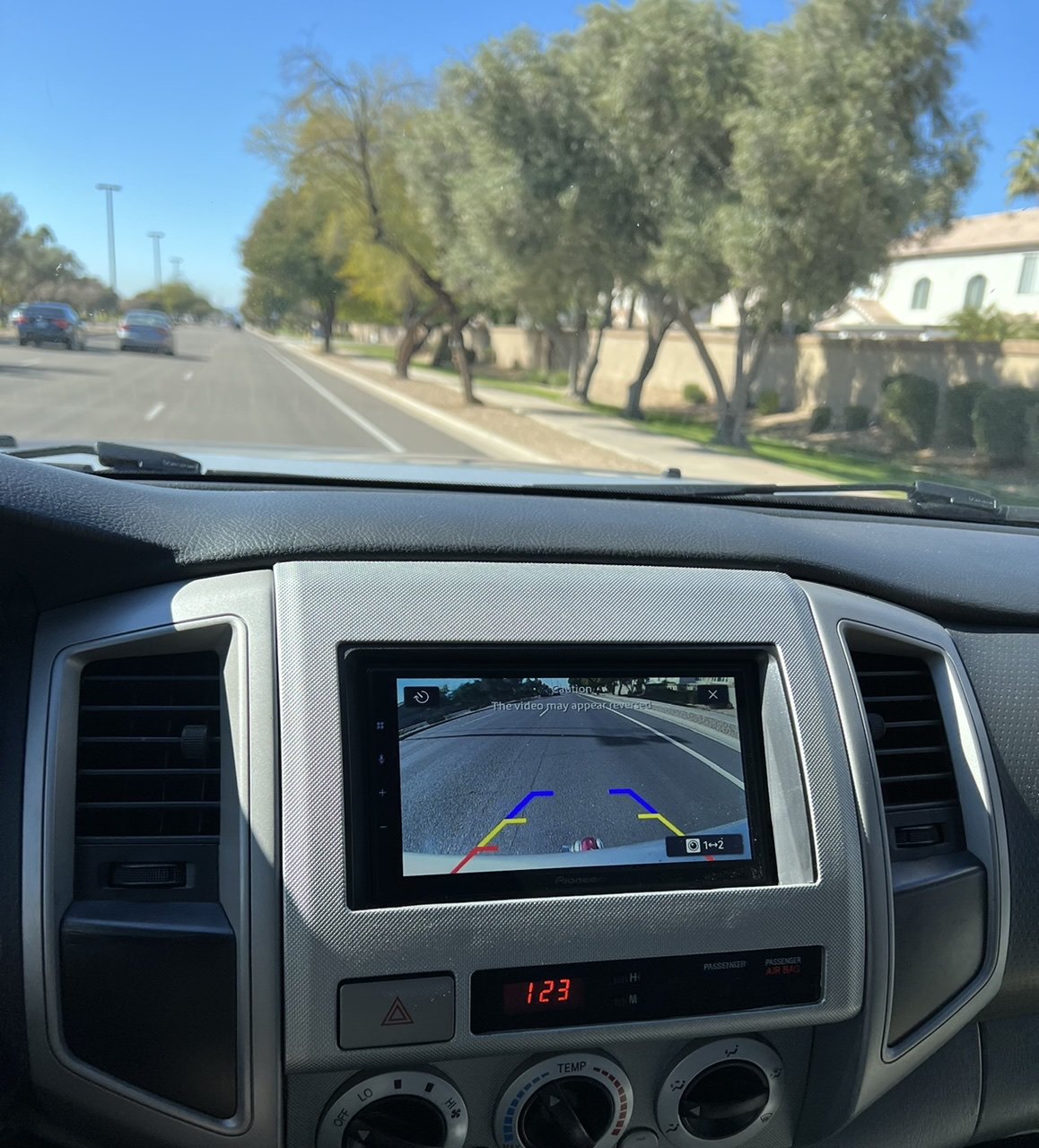

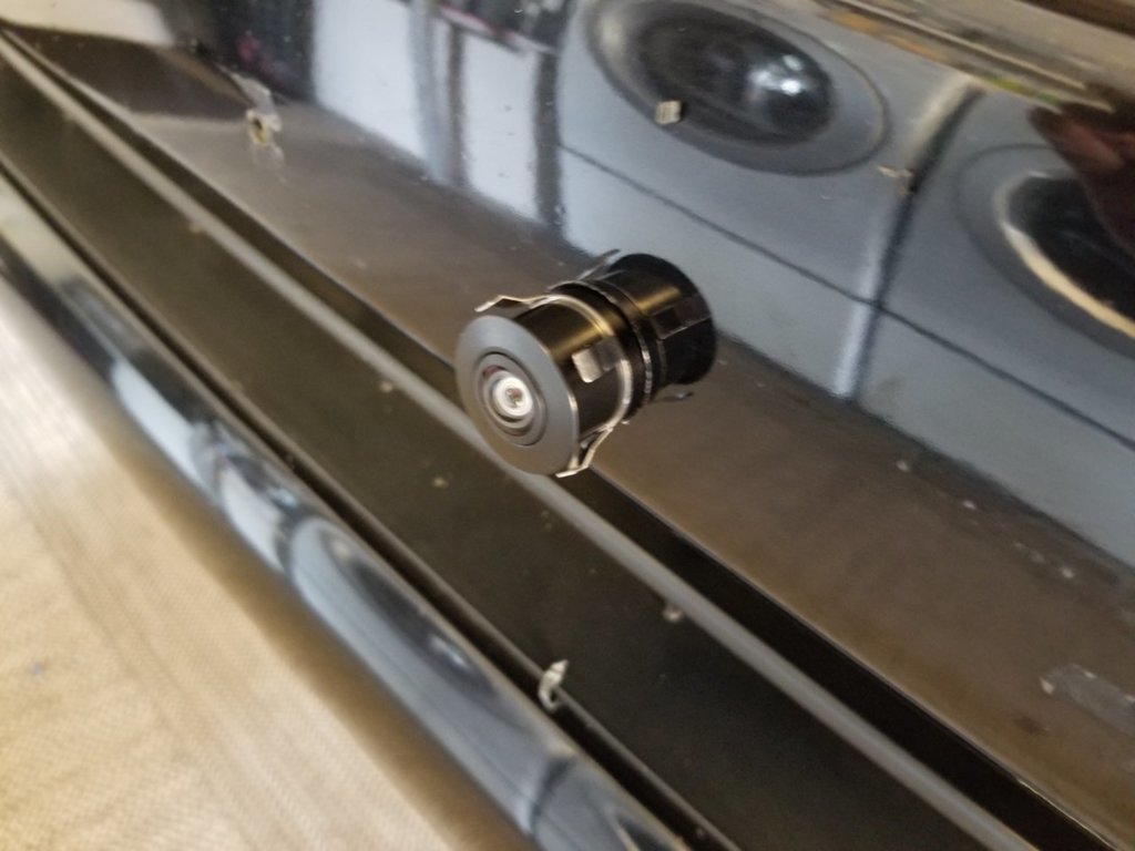

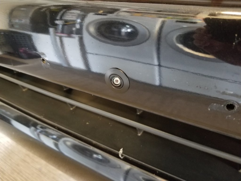

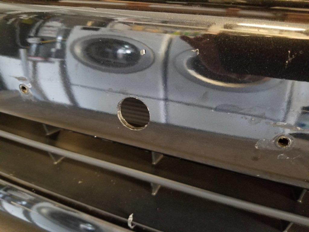

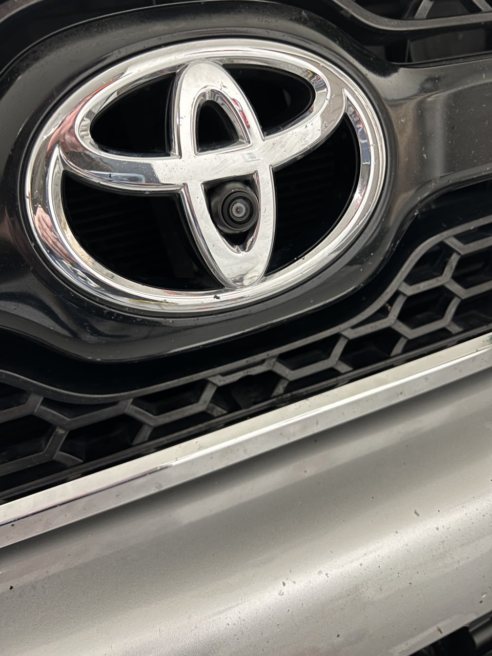

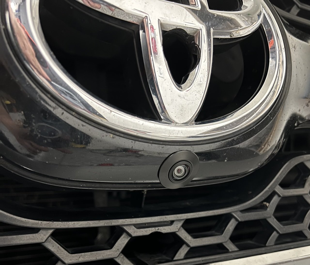

    I had to adjust the mounting. I wanted to be able to see the edge of the bumper so I knew exactly where I was at for parking. Didn’t really matter if I experimented on this grill because I have a painted grill ordered because I don’t like the chrome anyway. I’m going to roll the bottom edge of the camera flange to match the grill but it actually works out pretty good nice front view.

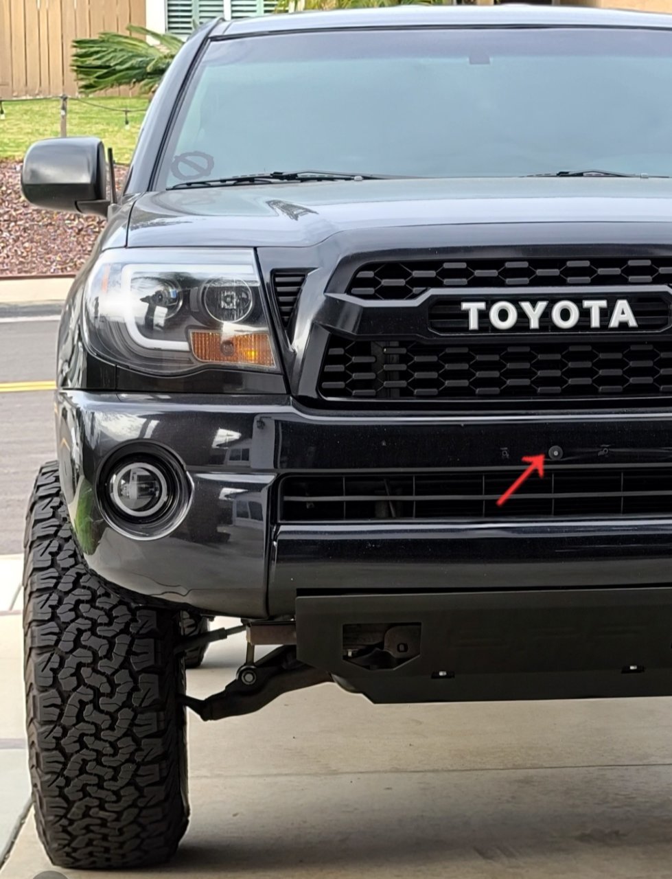

    Very nice. I put one in my front bumper and one facing the rear on my roof. Very helpful on the trail, camping, parking etc

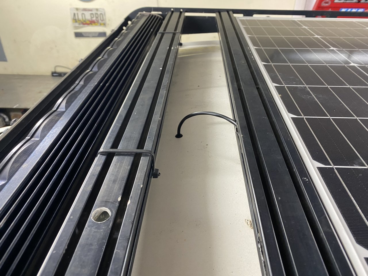

    I completed my chase bar install today. I used edge trim to clean up the cut on the console, made some tabs out of sheet metal and epoxied them to the inside of the sunglasses holder. Pay no mind that it's slightly off center. I totally did that on purpose to put it closer to the driver to make it easier to activate.
    To route the wiring, I drilled a hole directly over the sunglasses console, that way I didn't have to drop the headliner at all.
