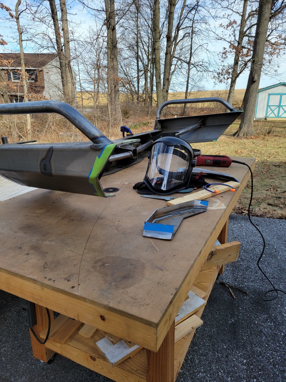

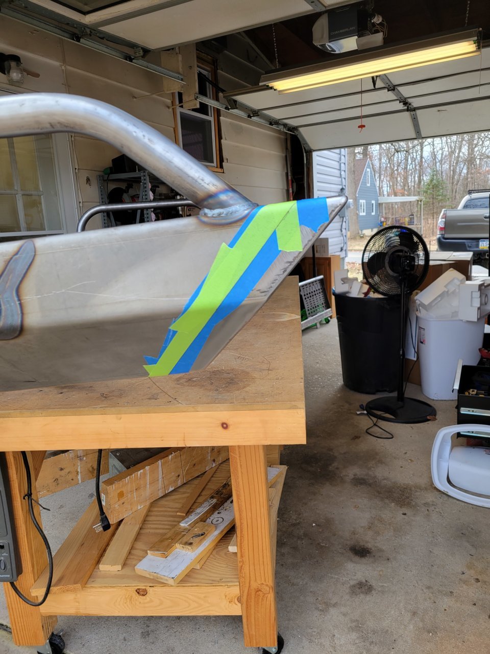

    3 coats of flat black Rustoleum high heat grill paint on my stainless steel exhaust tip.
    Started the process of trimming my Brute Force Fab hc rear bumper. I'm planning on trimming for 35s later this year so I figured I might as well get this done before I paint and install it. Took off 2". Still need to finish getting the bumper and cutoff piece cleaned up so that I can weld the end piece back on to box it back in.
    Taped up and ready to cut.
    After cutting.

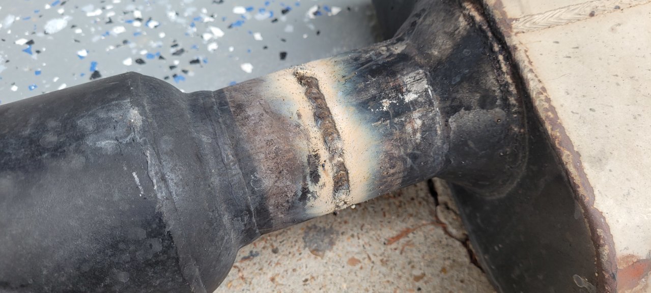

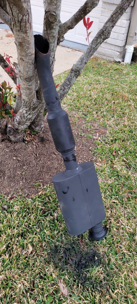

    Welded up my exhaust that was just held together with couplers the last few months...
    Found out last minute nthe diaphragm in my gas tank failed so I had to flux core weld. Was a bit sketchy but i did what I could lol

    Did you have un burnt fuel in the exhaust?

    I have long tube headers and no cats so it does smell like it at a stop light haha I'm curious as to what you noticed for you to ask that?

    Thought you had trouble lighting fuel when you struck an arc.
    I had a 67’ Jeep pickup with an steel aux tank in the cab. It had a leak. Took the tank out and filled it with water so I could solder the seam. Luckily I left the cap off. A small amount of air was in the tank as I had to maneuver to solder. I got a couple of nice burp-wooshes from the open end of the tank. Your exhaust just brought back a memory. Good job on the weld.

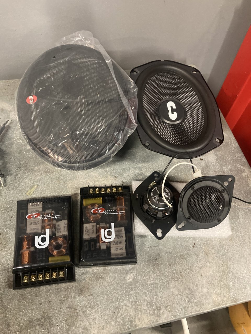

  19. Feb 12, 2022 at 4:33 PM
    hyper15125
    hyper15125 Headlight Retrofitting Hobbyist Vendor
    Feb 11, 2015
    #148420
    2,235
    NJ (609)
    Some new front speakers. CDT Audio Unity 8.0 Widebands, U500 crossovers and HD-690CFS 6X9” SLIM Mid-bass/Sub drivers
    Sounds so much better than the Kicker separates i had.

    I prepped the edges very thoroughly but all the carbon build up makes it pretty difficult to strike an arc. I had to do small 1/4" sections at a time and keeping the pool consistent is nothing like a normal GMAW 3/16" plate weld. I dont prefer FCAW at all but it was really windy today so it worked out pretty good.
    Sounds like you tickled the edge of an explosive situation lol glad you made it through :D
