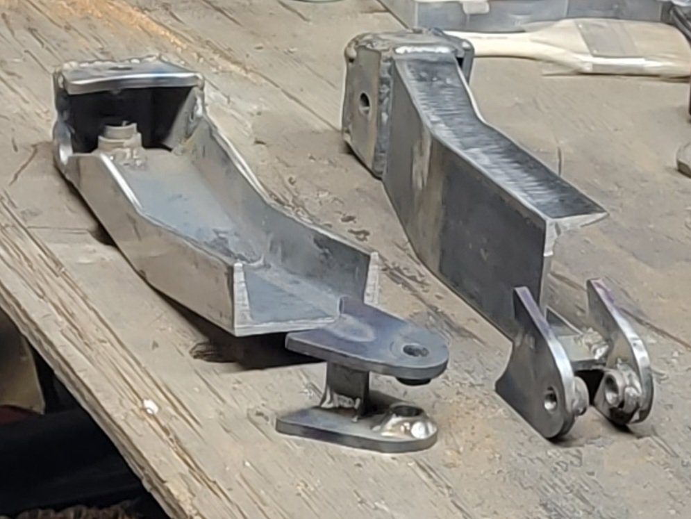

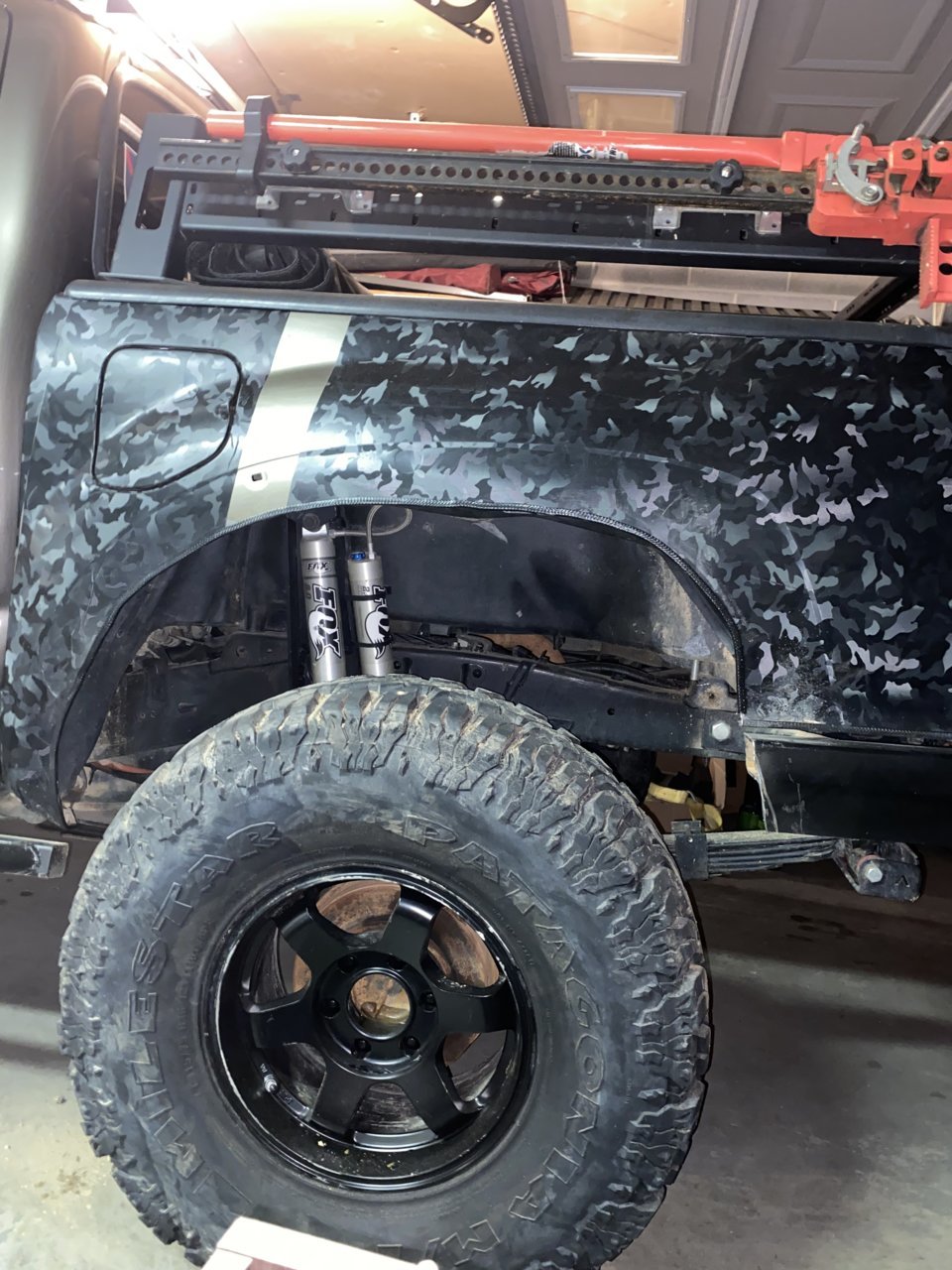

    Rear shock brackets almost done.

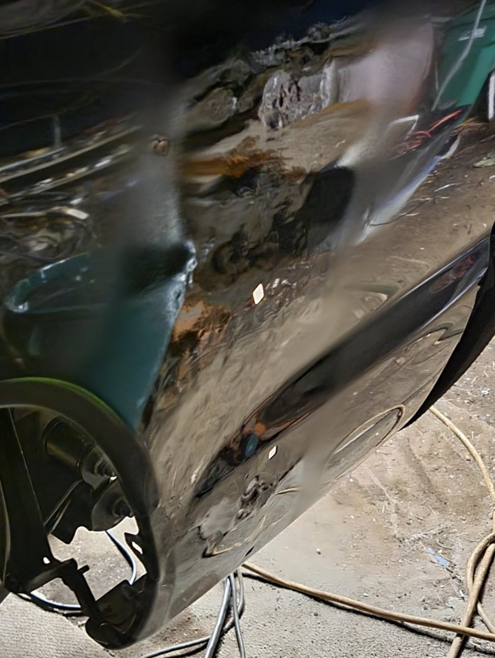

    A bad picture of some bodywork. It needs more hammer and dolly but it's getting close.
    I'm tempted to plug the holes up for the flares, flare the steel fenders, paint the truck, and lower it a bit but there's too much on my plate right now.

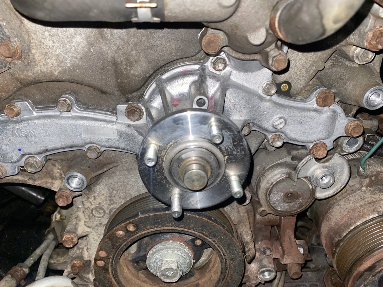

    how hard was it? How many hours did it take you?
    Might not be a bad idea to put a new radiator and upgrade to the poly radiator bushing mount kit which I think comes with body mount bushings, I forget the company name

    The water pump is pretty easy, couple hours. The tensioner sucks, it’s really tight getting that out. That’s true not a bad idea to do while everything’s open

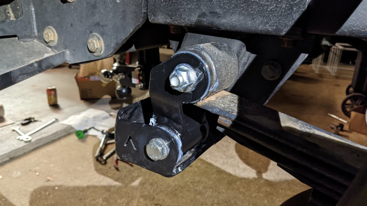

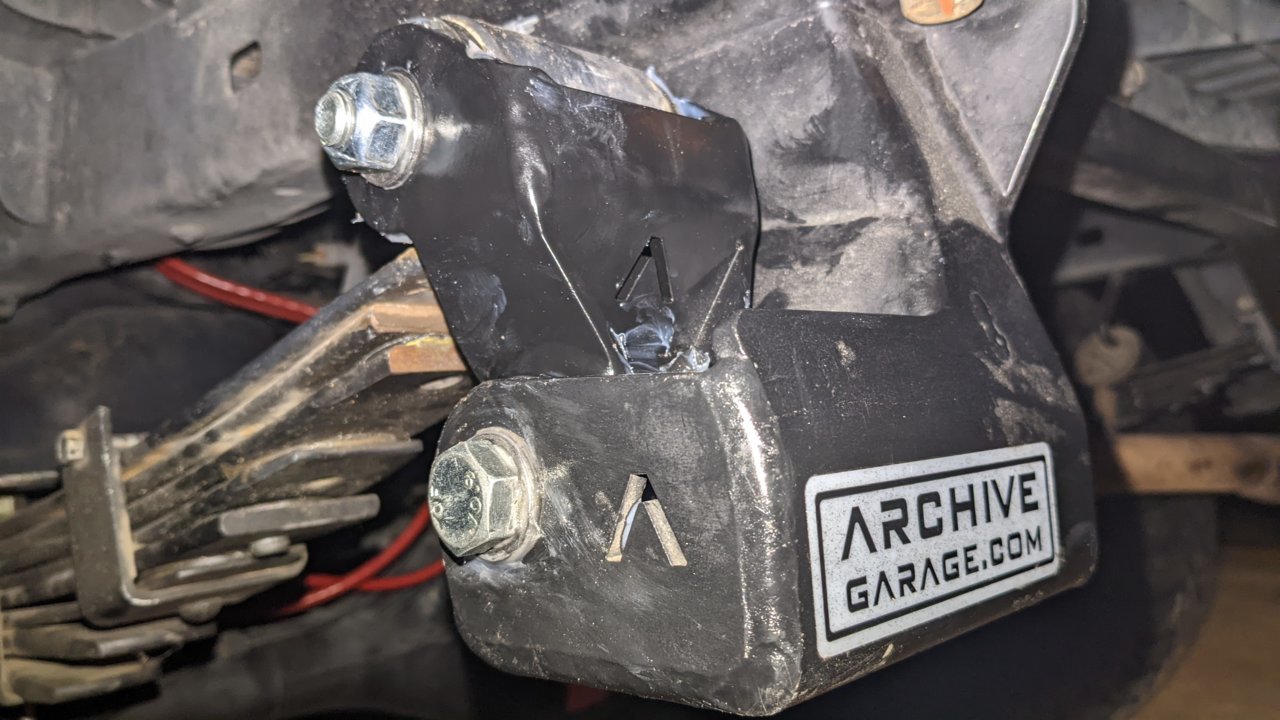

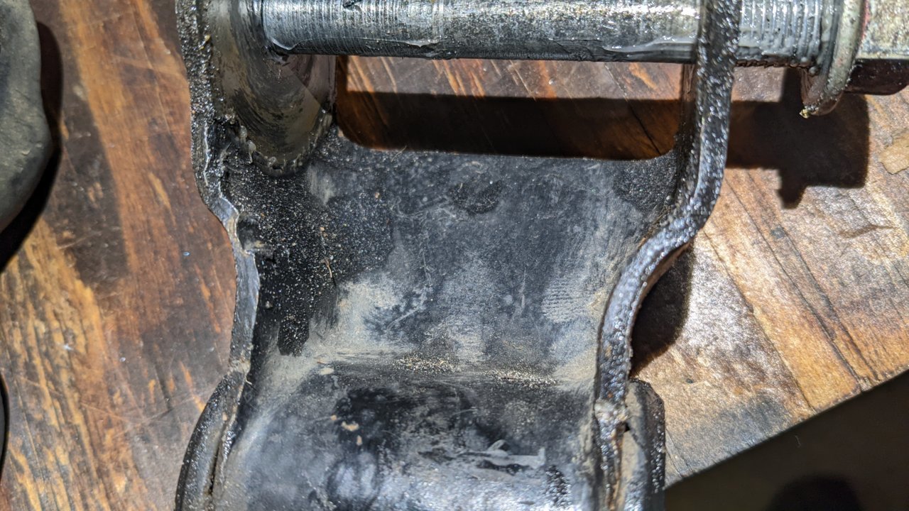

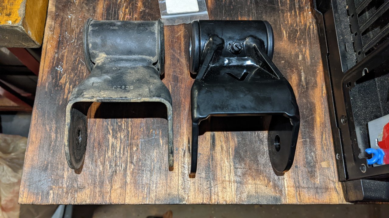

    Got some 3.6" Archive Fabbed Shackles to replace the last of the chincy in the rear, my factory ones were getting ate up and bendy.

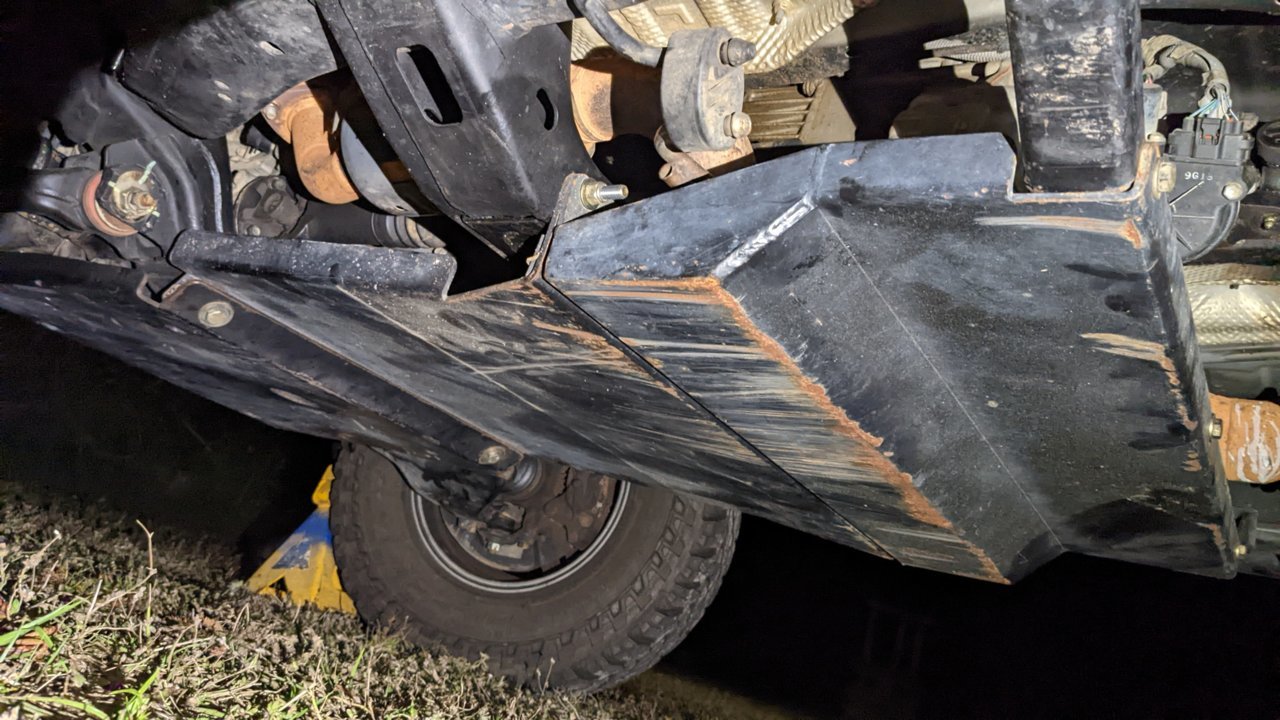

    Also threw the skids back on, planning to go see some dirt next weekend!

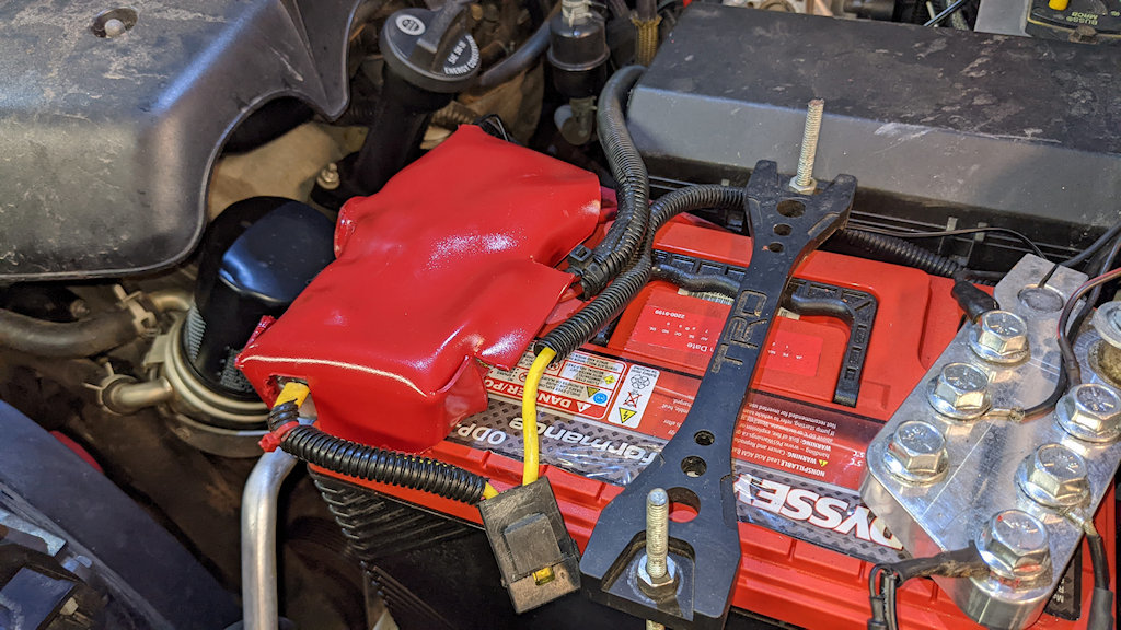

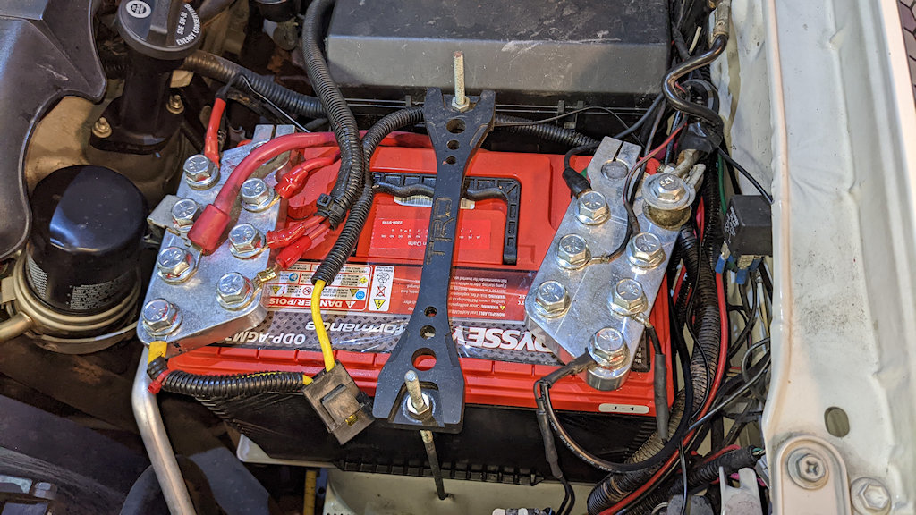

    A few months ago I installed some super duper battery terminals because I was running so many accessories that it was becoming too difficult to connect them all the the regular terminals.
    They work great but I was always worried that I might accidently drop a wrench or something across the terminals causing bad things to happen. So I came up with this.
    I found a piece of 12" x 12" red Kydex plastic on Amazon. (The same stuff they use to make gun holsters).
    https://www.amazon.com/dp/B0777V7X27?ref=ppx_yo2_dt_b_product_details
    Then I cut out an 8" x 5" piece that roughly covered the whole Positive terminal. Then with a Heat Gun and a small metal putty knife I heated up the Kydex and with the putty knife began shape it to fit. Periodically I would stop, allow the Kydex to cool down to retain the shape, and make little cuts here and there to make it fit around the wires.
    Well it ain't exactly pretty, but it's functional and stays in place rather well. I still have some Kydex left over so I may take another shot at it since I've had some practice.

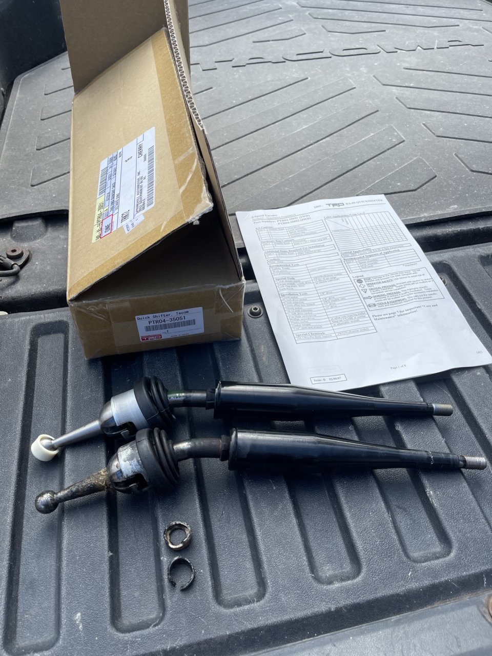

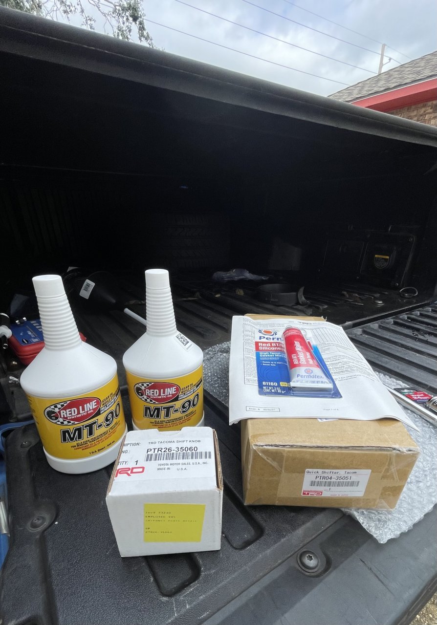

    Installed the TRD Quickshifter on the X-Runner; since I was already doing that, went ahead and drained and filled the transmission with MT-90. Turns out the truck already had the quickshifter but it's pretty much destroyed. Didn't take pics as I'm in a hurry but I followed the instructions included, everything went smooth.
