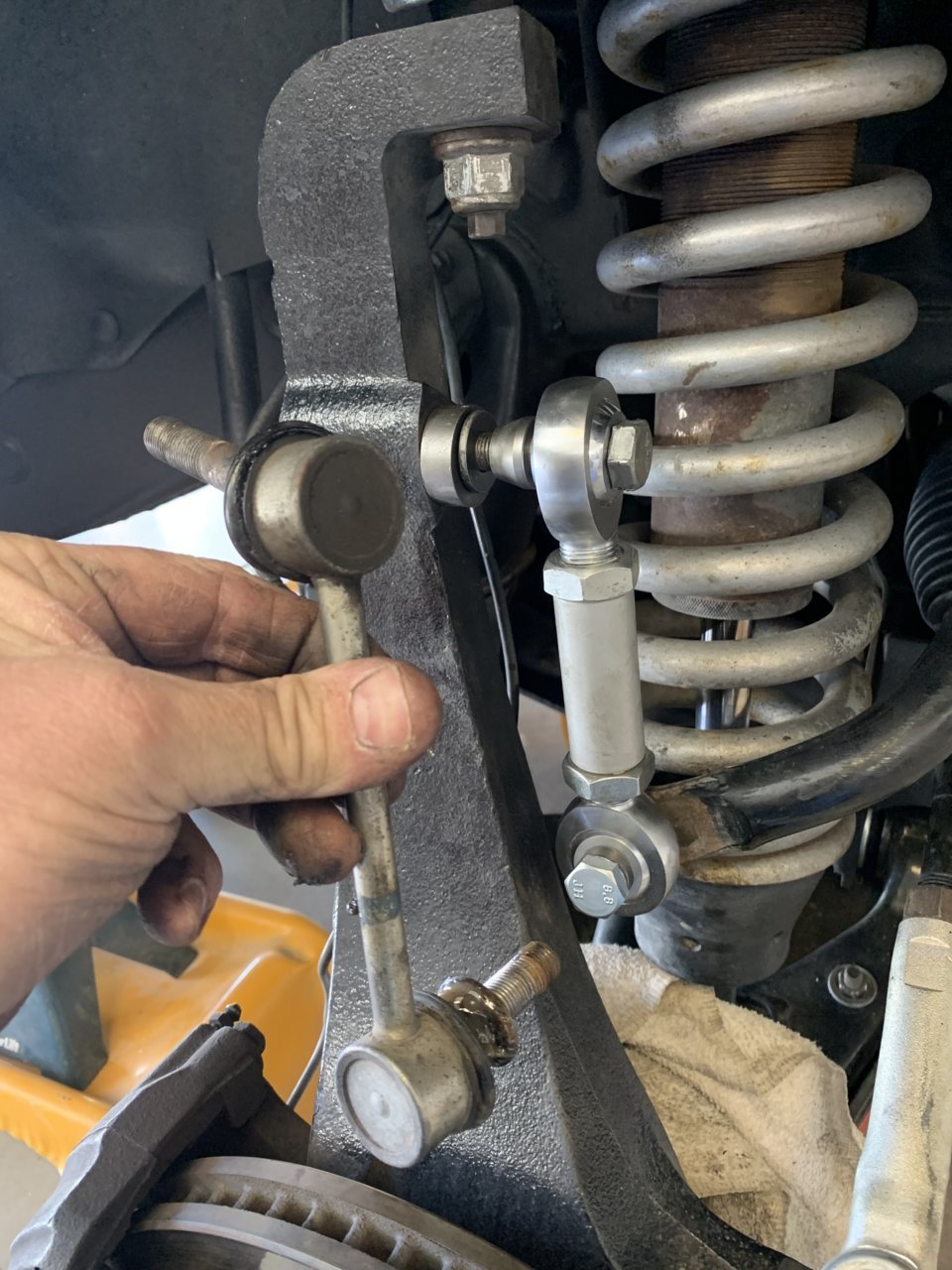

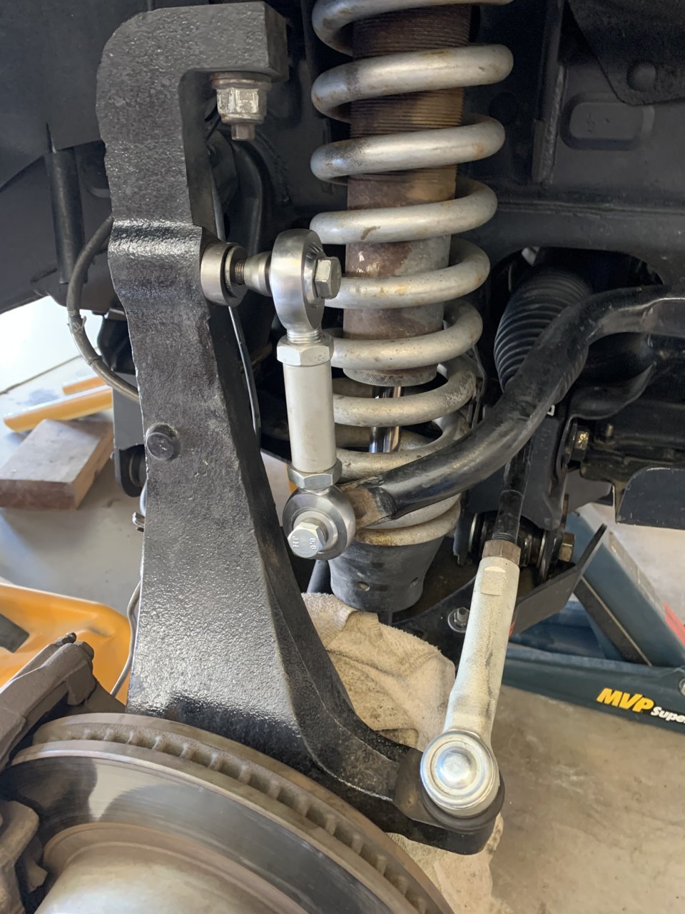

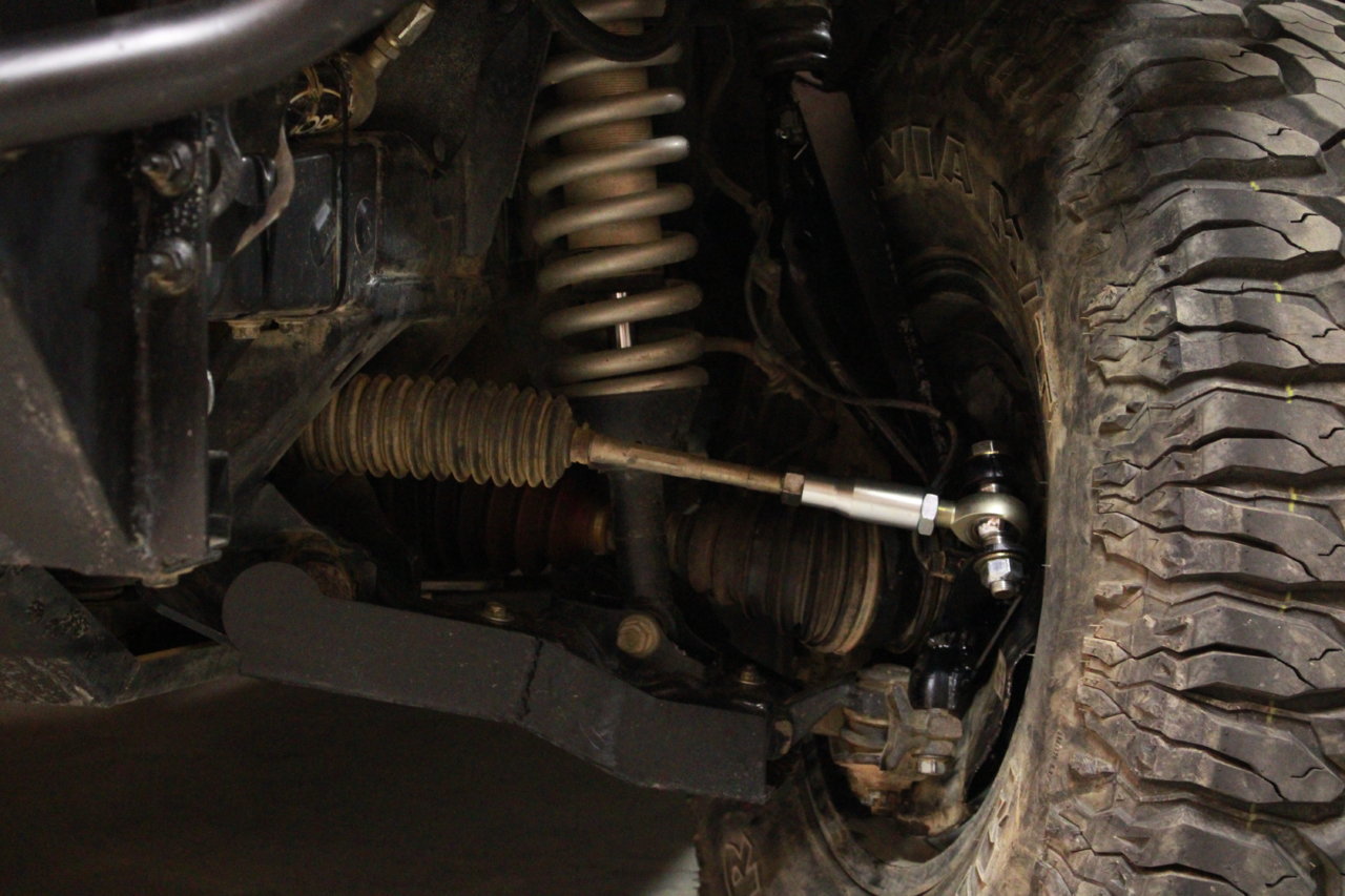

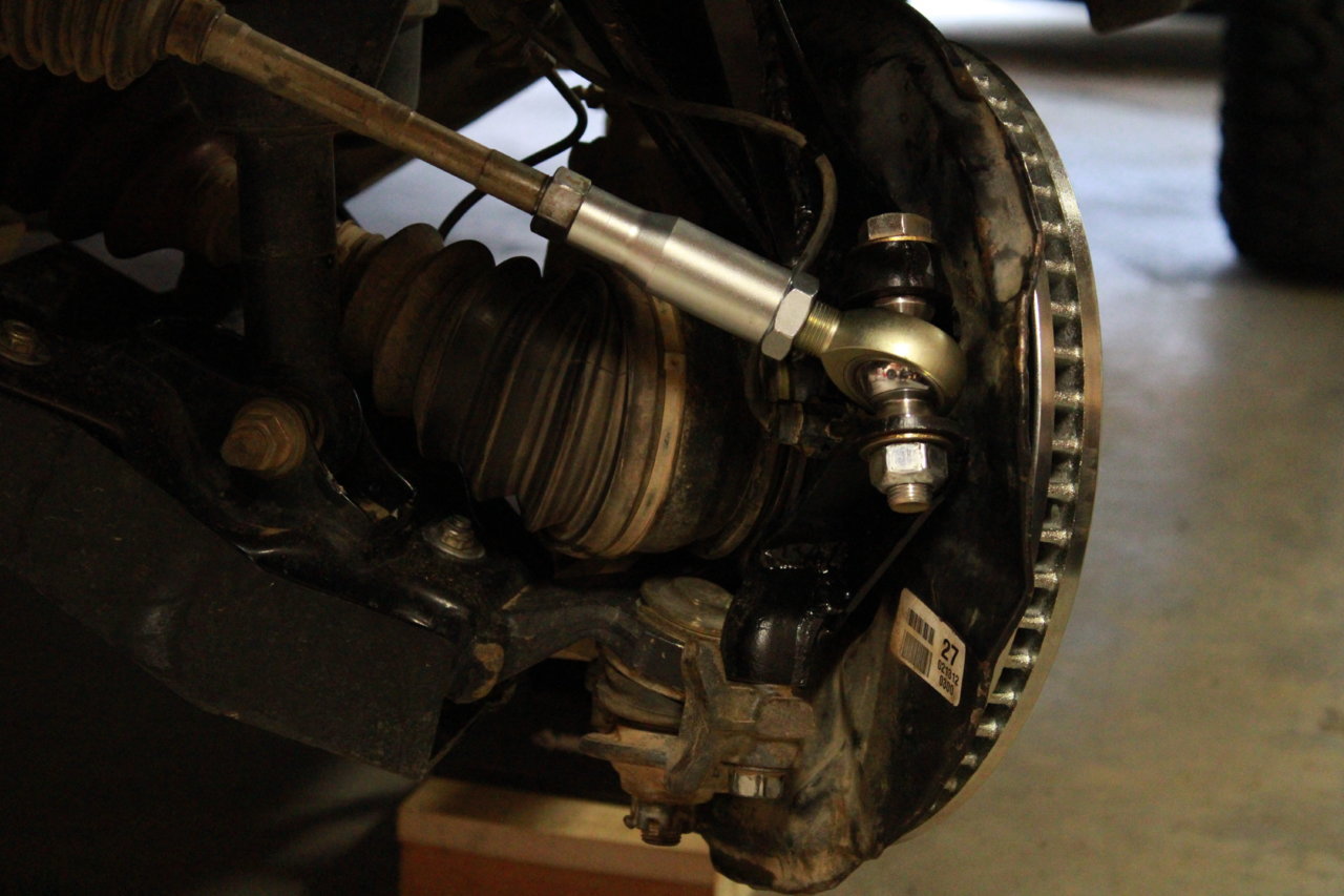

    Installed the JD fabrication gussets spindle and double shear steering kit today! Nice upgrade in strength!

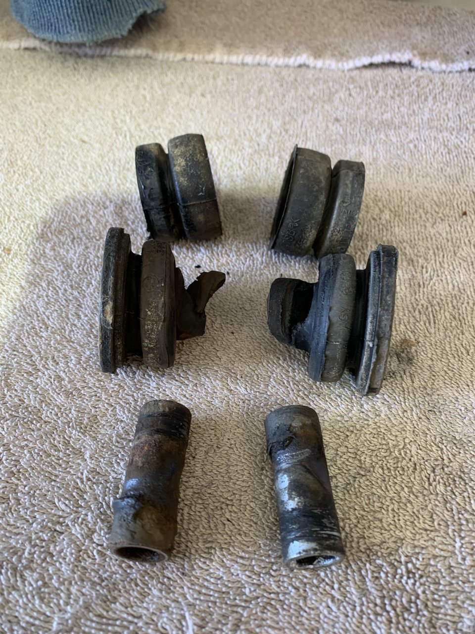

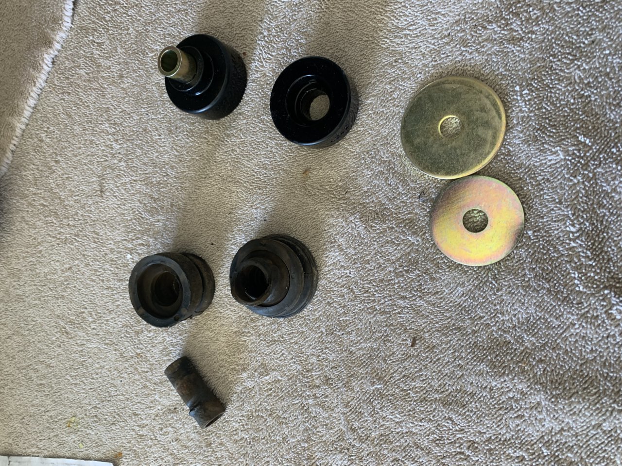

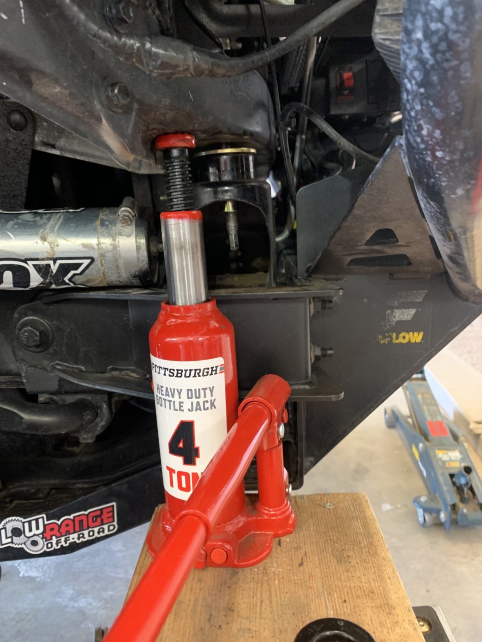

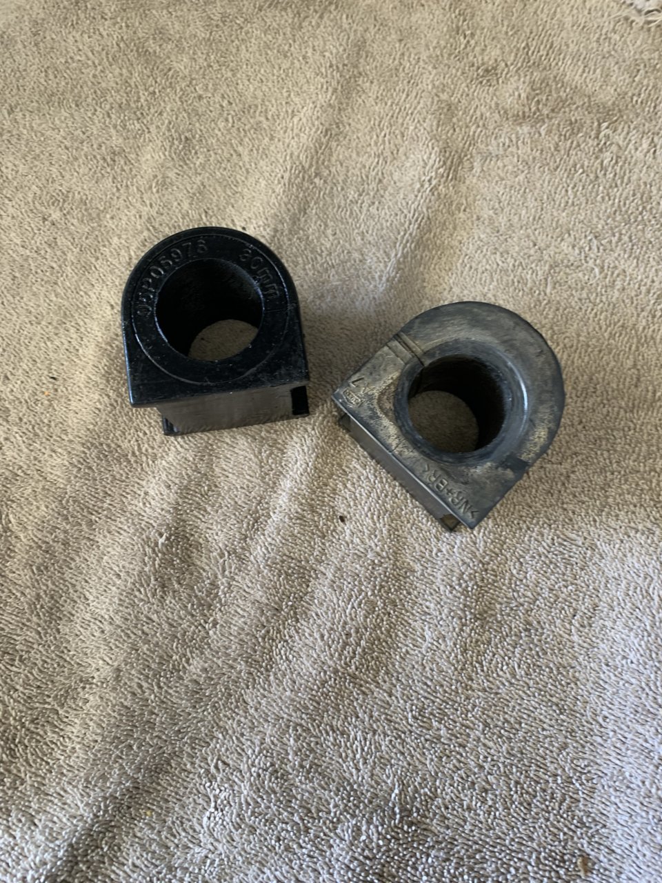

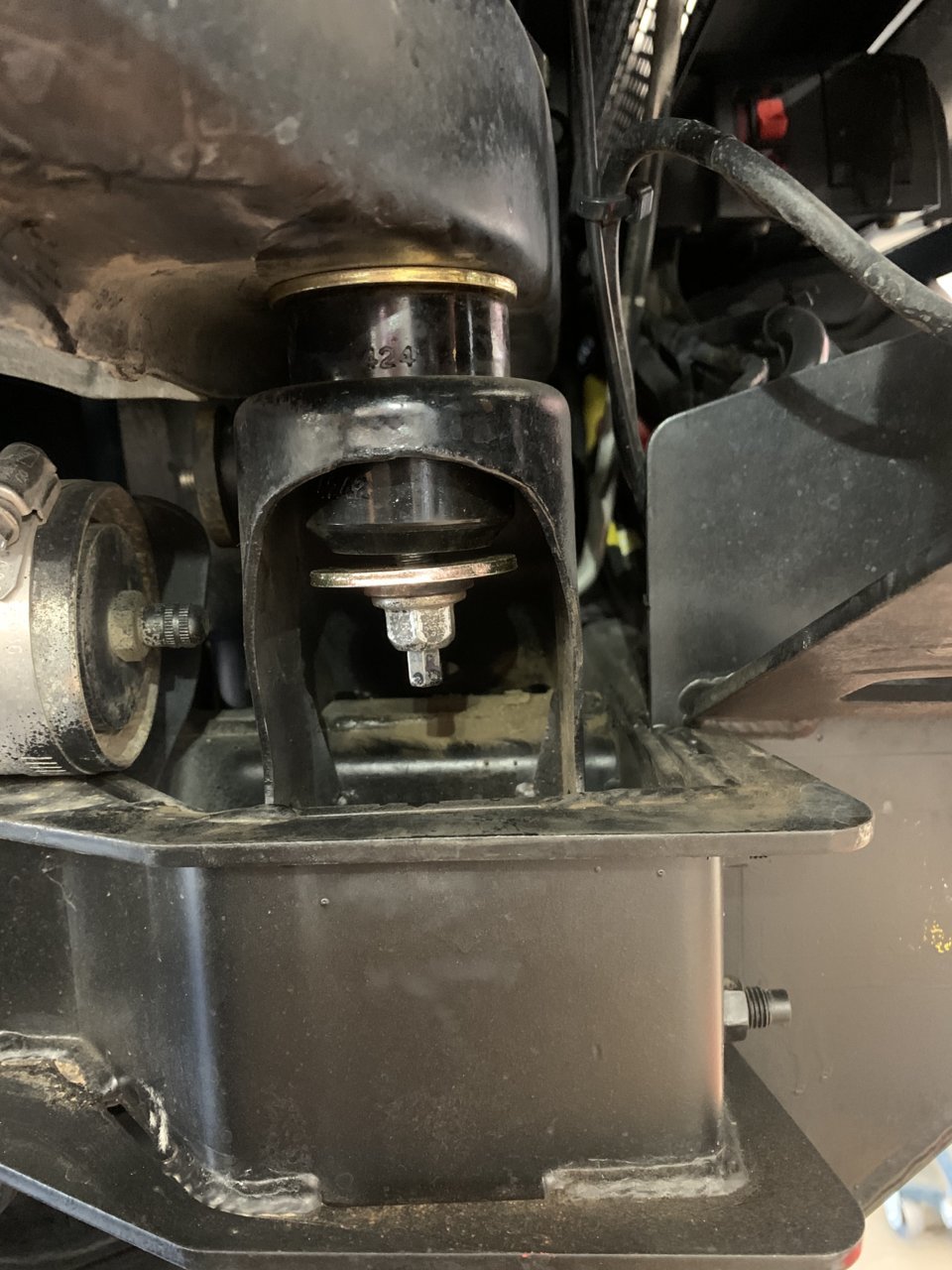

    Did the core support energy suspension bushing upgrade! Absolutely one of the best upgrades yet.
    also upgraded my sway bar bushings with ES poly bushings and upgraded the sway bar links to all pro HD links.

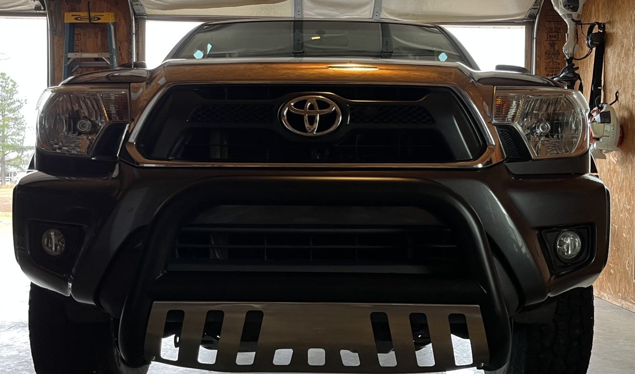

    I put a bull bar on my daughter's Tacoma.

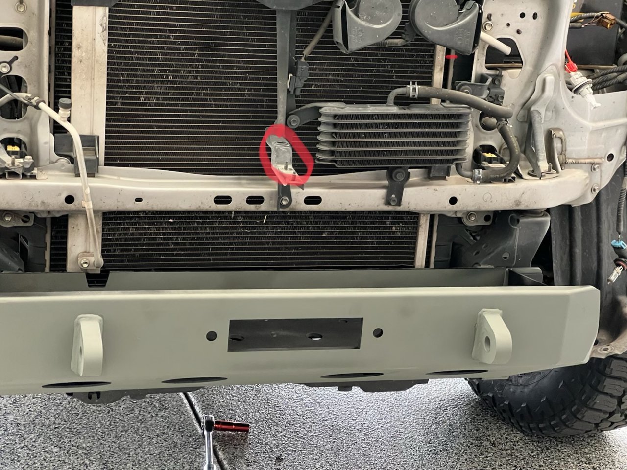

    Fitting the winch was not too much of a problem. With the grill out in the bumper off it’s relatively easy there is a center support that runs from the lower core support up you just have to remove part of it. The bolts were a little bit of a bear to get in through the small holes underneath and get lined up but once started pretty easy.

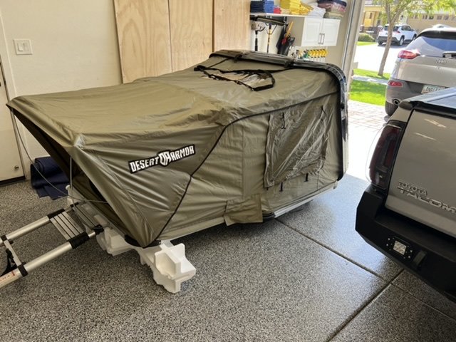

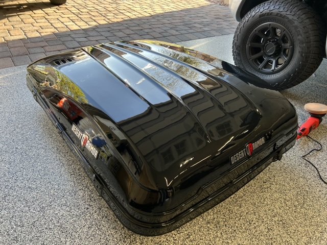

    Picked up a Desert Armor Soldier rooftop tent. Just waiting for my bed rack to show up on Monday to get it installed.

    Looks good! How does the steering feel with the heims?

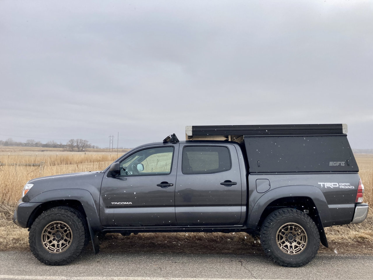

    I ordered them through the dealership.

    Smooth. It’s a little smoother than before but not a massive improvement. The improvements come from the strength.

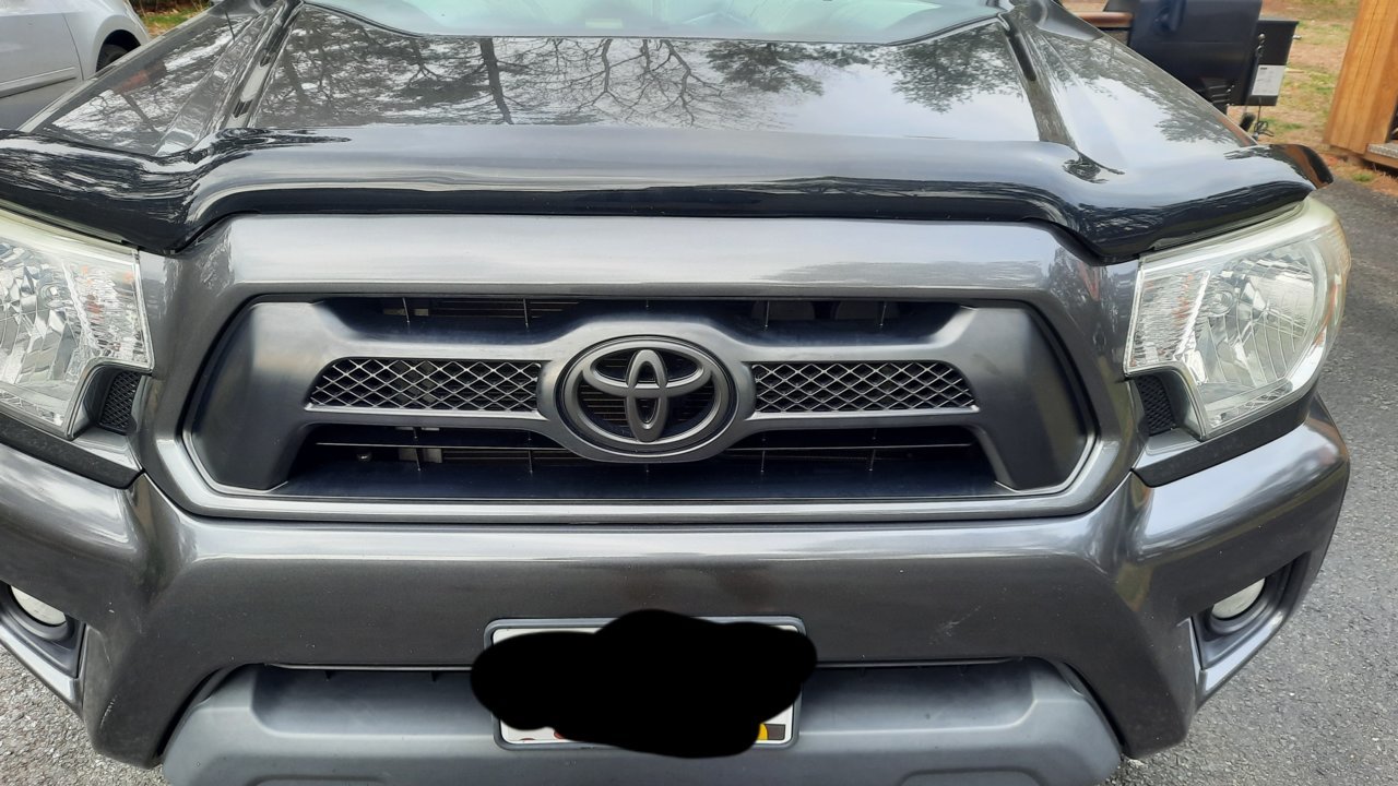

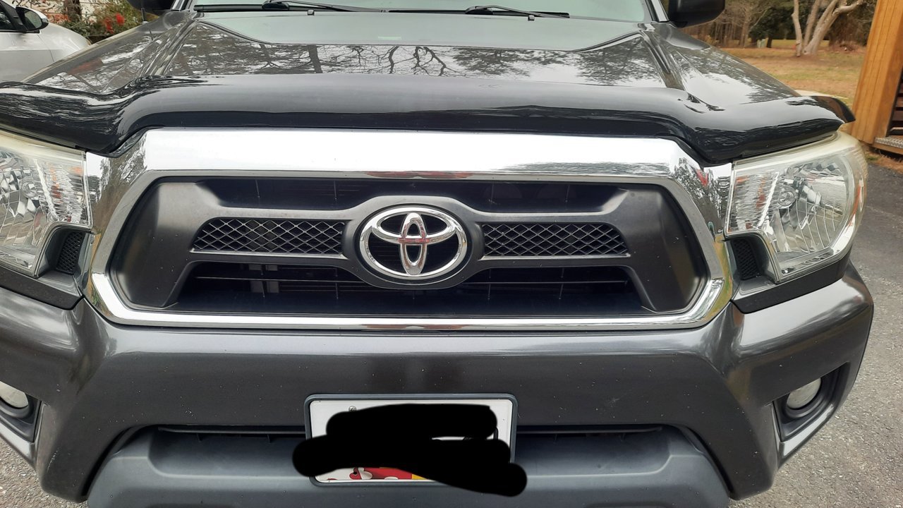

    Continued the battle against chrome with a TRD sport MGM grille I found on Craigslist and a little plastidip.

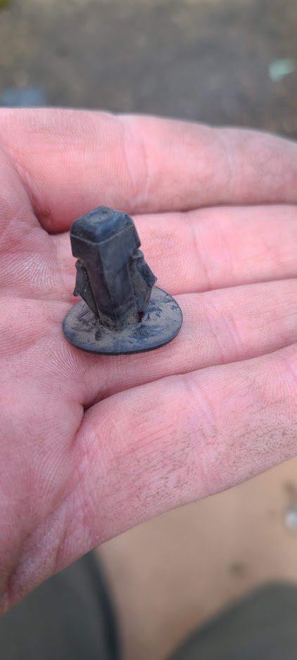

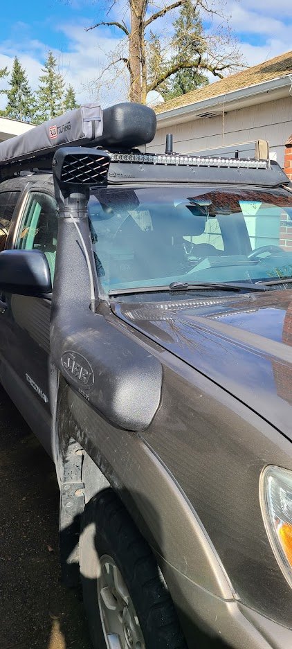

    Finally got it on, you do really need oompa loompa sized hands under that fender..
    z8iSe98t0bC3_SxakWgUKOb1Azo8a5Fh2wwd7f2o_321f17d574f914a30188816de1df251a408d0d25.jpg

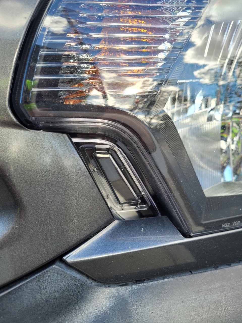

    If I ever see another one of these in my life I will just quit before starting!!
