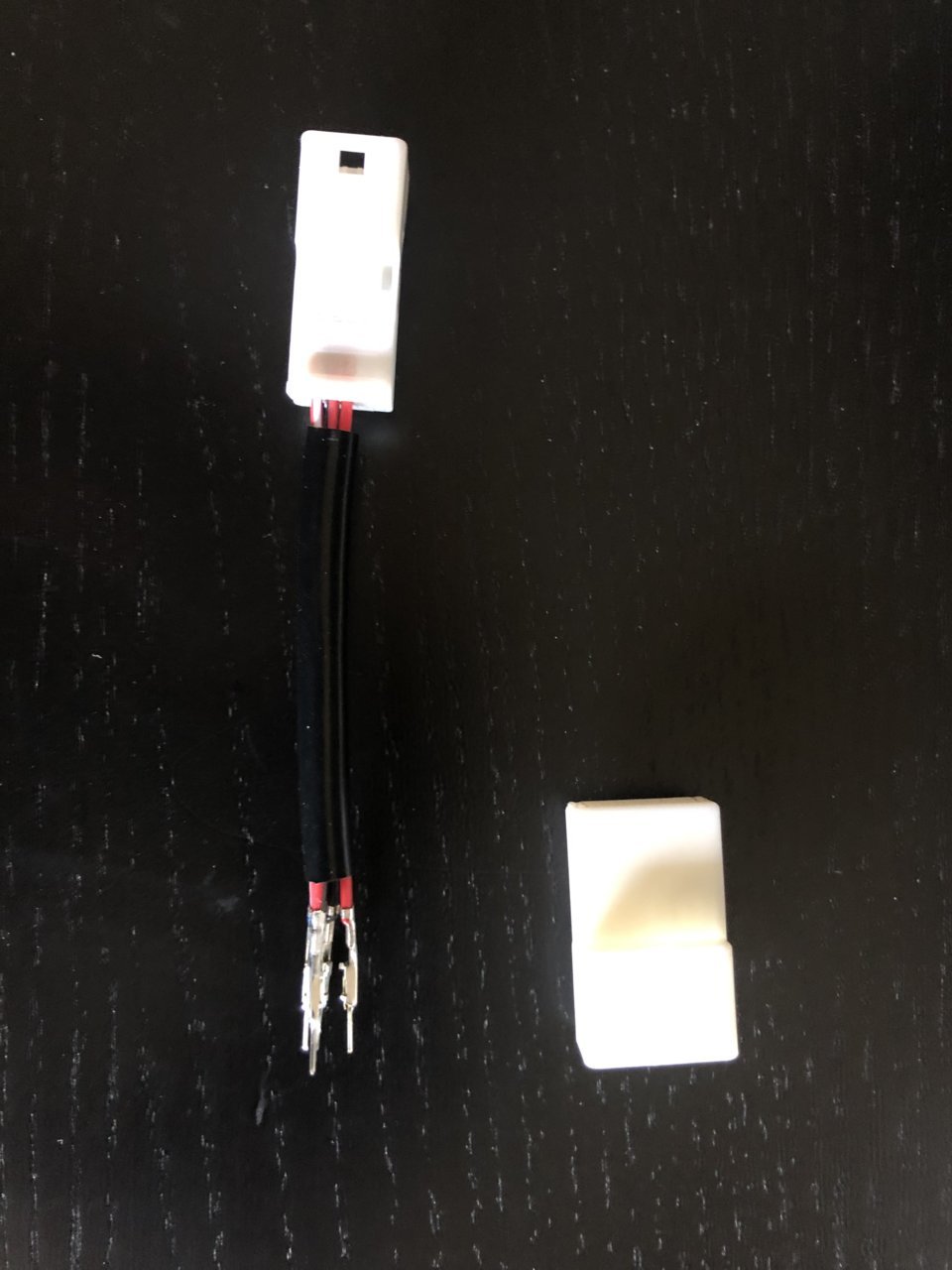

    Microphone adapter.
    5 pin Scion mic to 14 pin Tacoma connector.

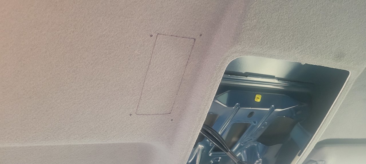

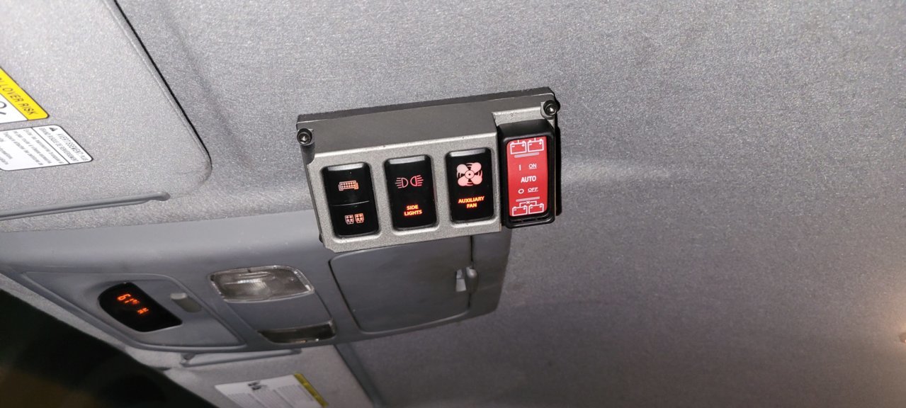

    Finally got my CH4x4 switches installed in my MESO customs overhead switch console.
    The Yaesu FTM400 mount is a custom unit I had MESO make for me, both turned out awesome.
    Switches are wired to some speedwire to the engine bay where I have a Bussman fuse and relay block that I purchased pre-wired from a now defunct ebay vendor. That was mounted to a panel that I got from BAMF that fit my manual transmission engine bay. That was also from the now defunct Pelfreybuilt. Everything has a relay, these little bussman units are awesome!
    Oh, and Deutsch connectors are my new favorite. The crimper tool and the connectors themselves are a little expensive, but they are so easy to build and the waterproofing should work well. I wired in a Winch in/out circuit and the Deutsch connectors made it so slick. When I eventually get my nice bumper I will wire in the lightbar with the DTP size (#12) with them. So much easier then metra/weatherpack connectors.
